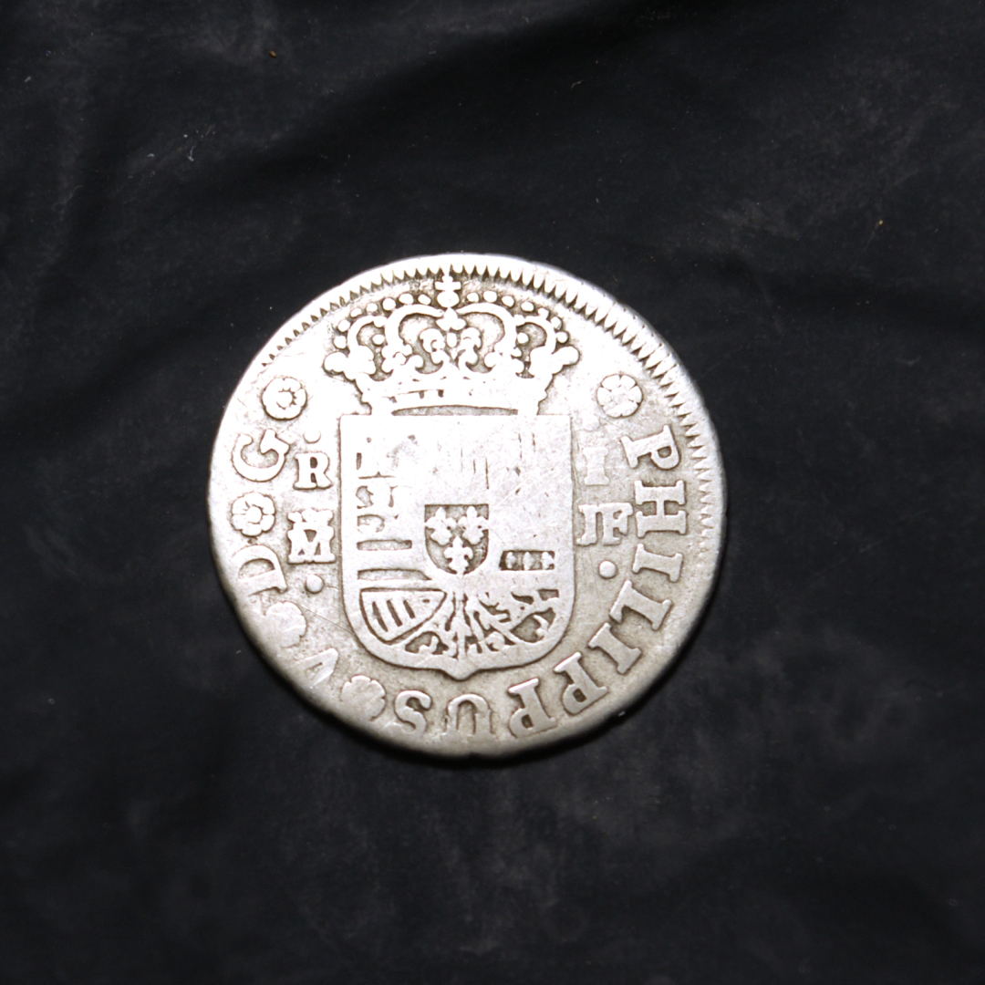

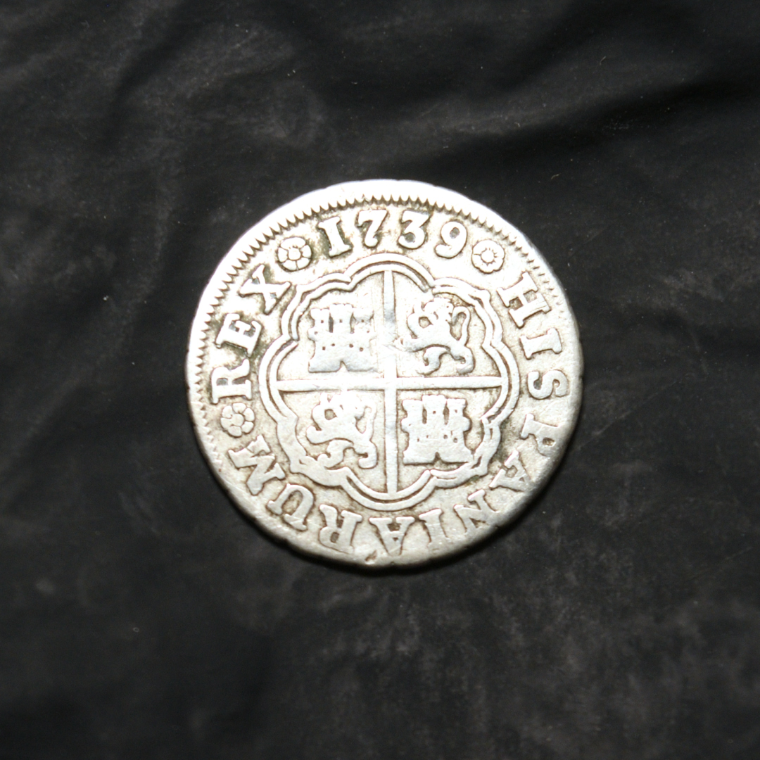

          This is my find that got me wanting to go down a little deeper.

            • Originally posted by Tibuck19 View Post
              That is a very nice find! 20 inches? that's almost 2 feet! lol my TGSL will find a zippo lighter at 2 feet but something like that so deep I doubt it. Then I shall have to give it a try, PIC base VID or Arduino Uno based is just as good??
              [ATTACH]42877[/ATTACH]
              [ATTACH]42878[/ATTACH]
              This object is about 4 cm in diameter, so it is bigger than almost any coin and in all metall is not a problem to catch.

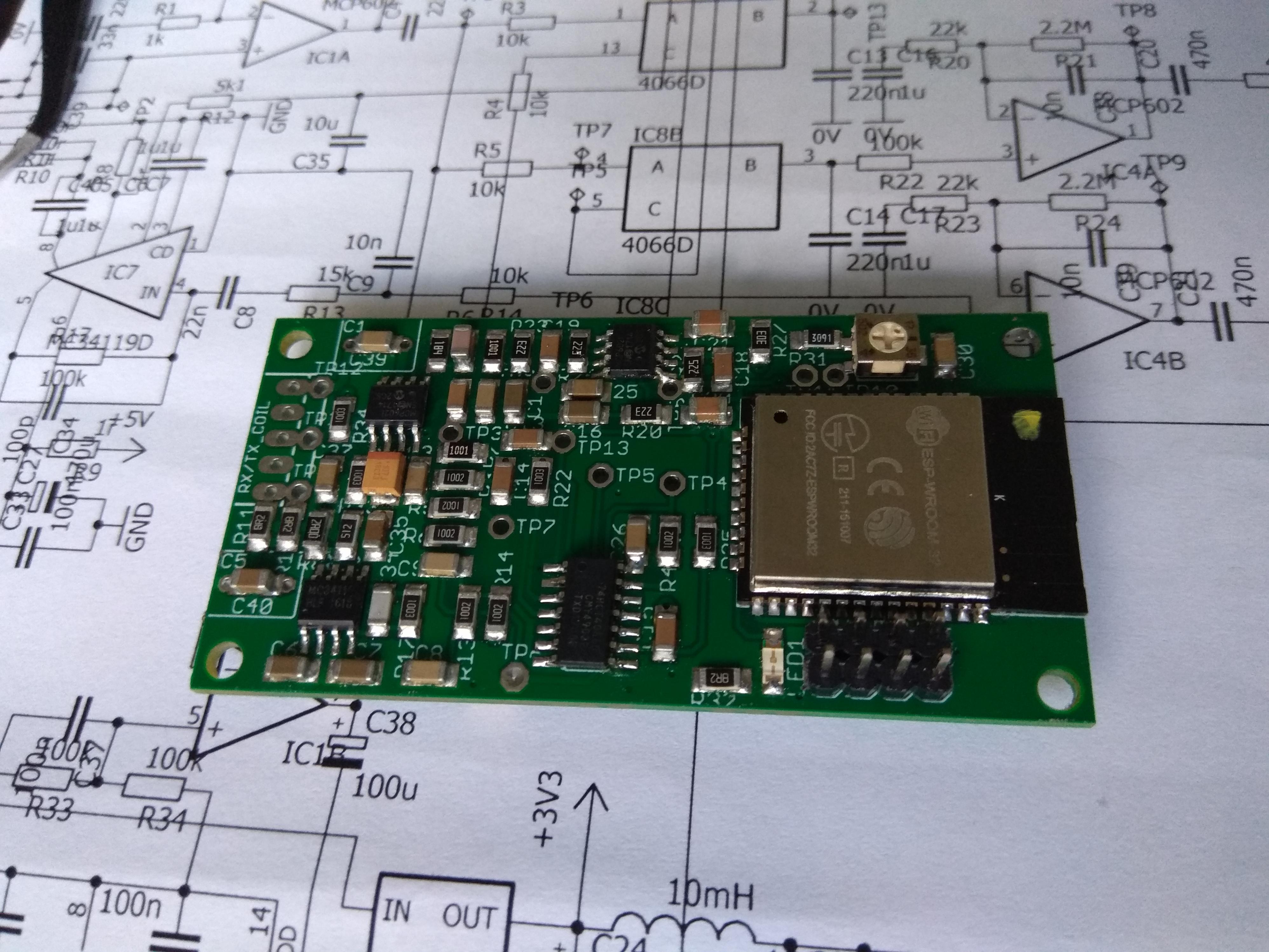

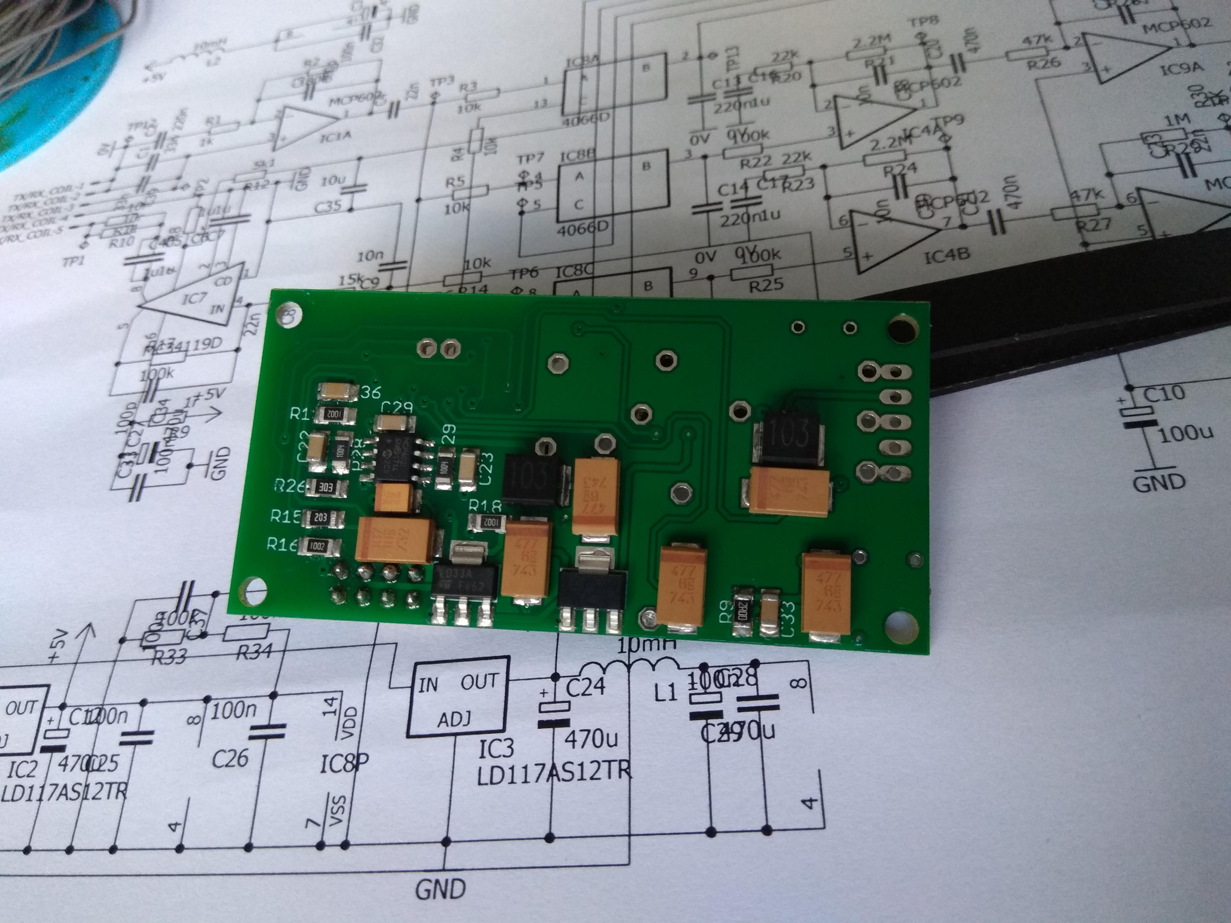

                          • My intention is to do a metal detector similar to the XP Deus detector, but with the difference of all the functions being controlled by a mobile application with Bluetooth, the project is still working would be great if someone help me me with a code for Arduino, for example Daren whose part I used this project. I've used Google MIT App Inventor for my Android App, but I would like to create an app on Android Studo in the future, but I'm not that good programmer so it would be great if someone finds out that my source code will be downloading soon on https://github.com I will add more information soon, here is the first PCB version.
ID:	351216Click image for larger version

                                Schematic and the required files will be available shortly after fixing a few bugs.
