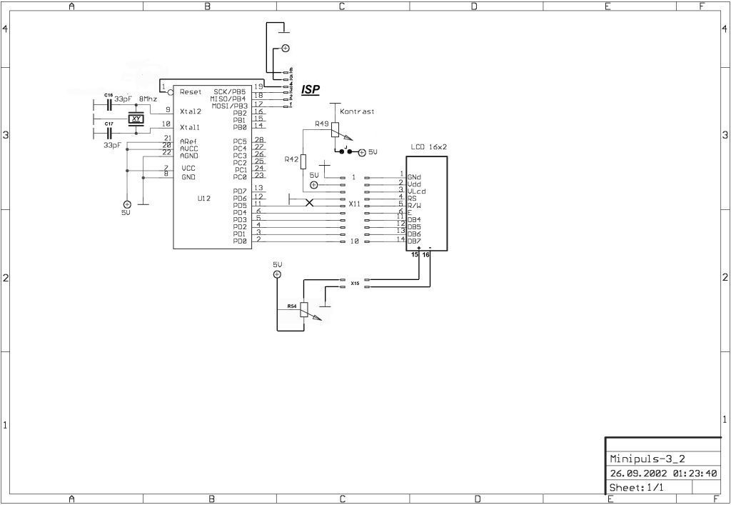

atmega8 programming
    Positively try with another chip, maybe you mess up IC’s due to some PCB layout problem. Only basic controls, RST, MISO, MOSI, SCK, +5V and GND are needed, try to program it stand-alone. (not sure, but clock components, Xtal and 2 capacitors are not needed for programming, not tried, always was ISP) If you try ISP, ALLWAYS remove 100n cap from RST to GND, this pin is used for programming and will not work when C is installed, check power and GND connection to the chip, famous criss-cross around middle pins on Atmega.Also check zenner diode orientation in programmer.

        I notice that the RS232 connection already has pins 6 and 7 joined together, which are Data Set Ready (DSR) and Request To Send (RTS). These signals also go to the ICSP connector, as does the Clear To Send (CTS) and Data Terminal Ready (DTR) signals. So presumably this means that a handshaking procedure is required programming. I assume this must be correct, since the Receive Data (RD) pin 2 is not used. If the programmer is not supplying the required handshaking, the PC will simply wait forever for a response, and no data will be transmitted. It looks to me like the System Clock (SCK) is generated by the PC using the RTS and DSR lines, and then it expects the programmer to latch in the data from RD and reply using either CTS or DTR. This appears to be the handshaking sequence. You should be able to check this with an oscilloscope.
        Also, it looks like the programming board is expecting the +5V supply to be supplied externally, as the 10k resistor is a pull-up to the BC549 transistor.

            The latest stand alone ATmega8 board i made is 100% copy of what ive posted here under circuit 2 pdf, only differences are no LCD connected and my 5v feed rather than from the in circuit regulator is taken from a usb port on the PC which loads of people have done in the past with no problems or so they say.
            The data cables Ive tryed have been 1: ICSP to RS232 serial port, 2: LPT printer port, 3: USB to RS232 serial port converter, 4: USB to LPT port converter, All give the same symptom.

                Ok will do standalone excluding crystal and capacitors and just connect basic programing connections, I see what you mean by excluding the crystal because the atmega chip has a built in clock.
                Now this is very important question.... you mention two times about 100nf from RST to ground needs to be removed, which I understand , but where is it? i do not see a 100nf capacitor going to ground on my project circuit diagram, or are my eyes tricking me?

                    Looking at the spec sheet for the atmega8 it should be set at 1mhz internal oscillator, fuse bit settings bootsz1 and bottsz0 need to be turned on ie tick in the boxs , all other bootlocks off. Bare in mind im a novice at programming so better get it confirmed by the more experienced programmers here.

                      I took a bit of a guess and burned the hex code with Burn o mat, this is the session, will check later today if it worked.
                      C:\WinAVR-20090313\bin\avrdude.exe -C C:\WinAVR-20090313\bin\avrdude.conf -p m8 -P lpt1 -c bascom -U flash:w:C:\Mini Pulse3\MINIPULS3PART1\M8HEX\MINIPULS_3.HEX:a

                        The first burn has failed no pulses

                            Just thinking, you say know pulses, what wireing setup have you done around the atmega8 ? have you got the circuit you can post?
                            • #44
                              I am useing this schematic, no pulses on PB1, oops maybe I need to check the reset pin,
                              • #45
                                Just tied pin 1 to +5v, still nothing.
