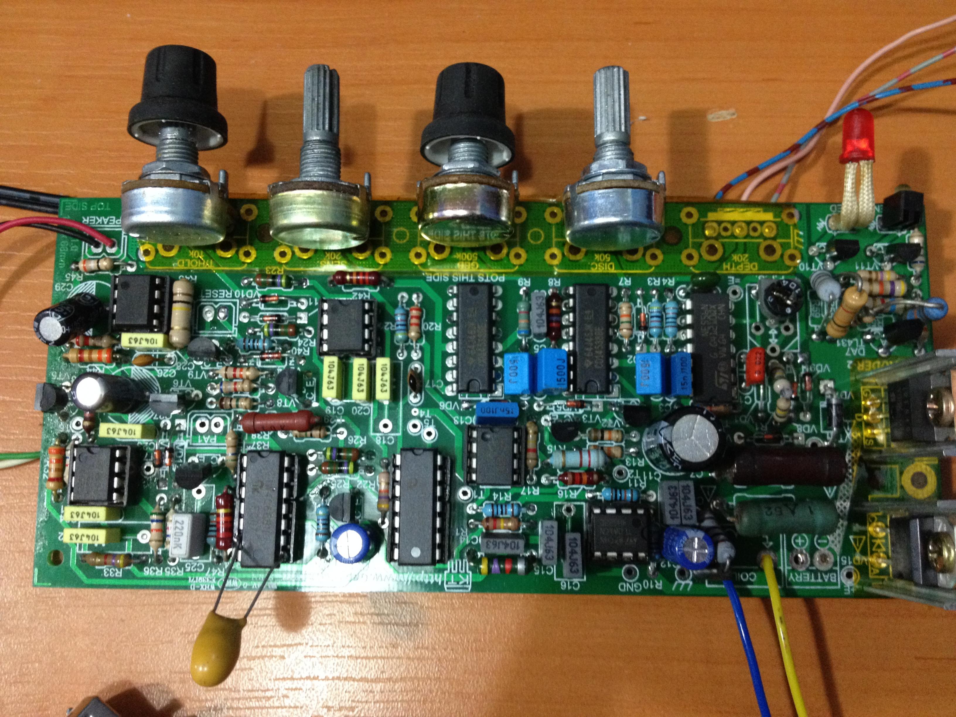

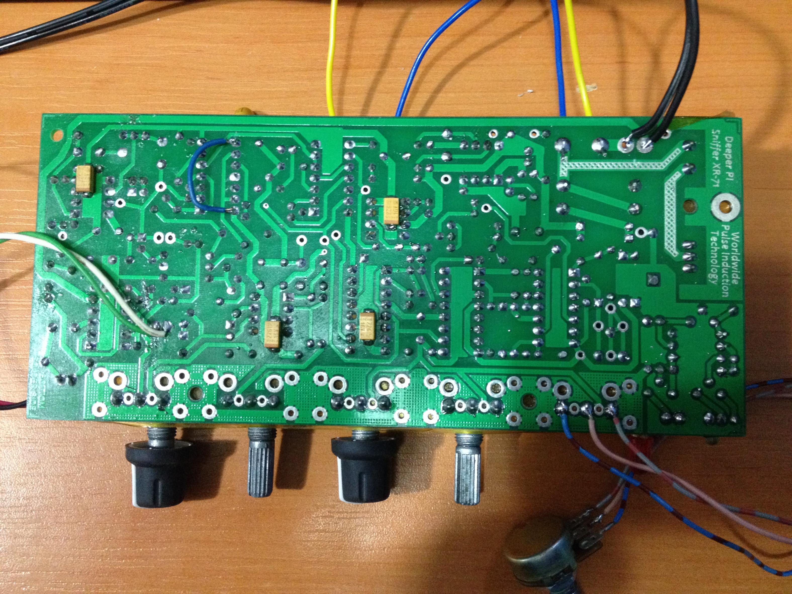

                        • dear kt315,
                          I've completed the circuit, I think there is an error! ,steady light green led,no sound
                          Where is the problem?
                          • dear mege,
                            where is error? is at the schematic or at the board? I did check the layot at study of P-CAD many times, 1000th times, by tools of P-CAD.
                            all errors are excluded.
                            had you measured all resistors before soldering as I asked all people to do?

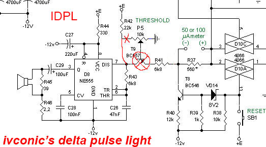

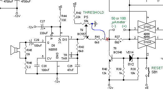

                            try to connect the input of NE555 to +E and get the sound.
                            desolder IRF740, connect a power supply to control part directly, connect cathode of VD9 to anode of VD8 by wire, -12V to -E point,
                            and try to find the sound.

                            • do you see or not? why you do mistakes? why you did not check what you do? why I have to find out your problems at YOUR PICS???
                              I ASK AGAIN AGAIN AND AGAIN NOT DRINK ALCOHOL YOU SOLDERING ANYTHING!
                              • Thank you for the answer, I will try to solve the problem as soon as possible
