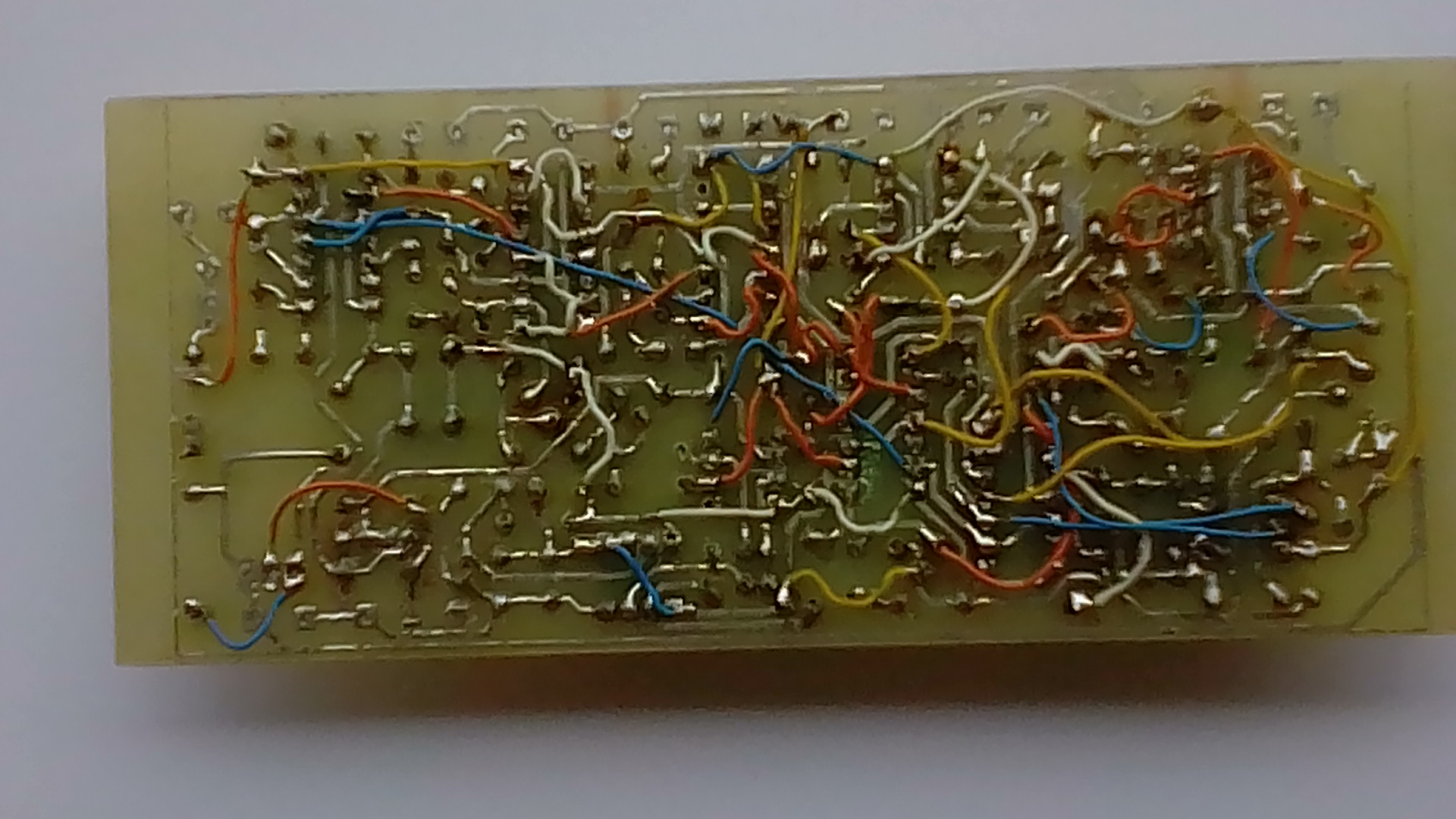

Wanted Please. Decant PI board to replace the One in This enclosure.
    i told many times modern chinese 1N4148 do not keep 100mA current. in DP they stay in power line. i changed them in my design on 1N4004.

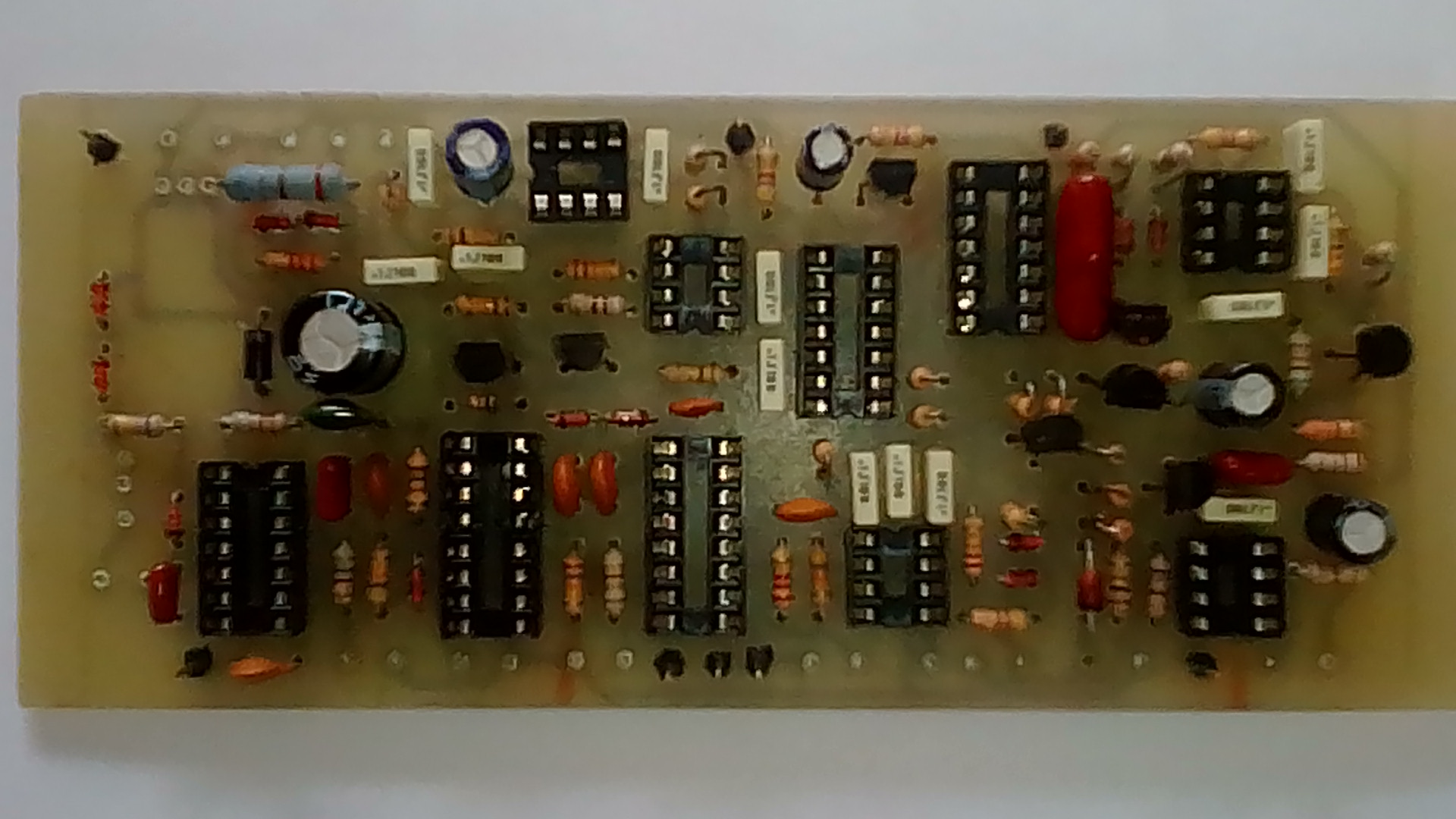

          In your case, replacing chips is easy, just remove them from sockets. No problem.
          i got a board in repair. whole board was in sockets. i found THREE chips bad. so sockets do not give nothing.
            My geotechenglish is bad. It is easy to change/replace chips when sockets are installed on PCB. There, that should suffice.

              I was not really serious. You can fix this board easily. Believe in yourself. You do not need scope or LC meter, just a regular multimeter would suffice. Step by step, methodically. Check semiconductors(diodes and transistors) easy to check, no problem. Then check integrity of solder joints, correct parts placement, hookup wires etc. Then remove and replace all chips, one by one. See what I mean. Logical and methodical. Do what kt315 said, replace 1N4148 diodes. Build correct coil. I am sure it will work.
                From what you stated earlier, you were getting poor detection depth. That's good news because it means that the thing is alive and kicking. Try replacing preamp chip, then work your way down the signal path, changing out the chips. I suspect your preamp chip is the culprit. That LF357 has many fake chips on the market.
