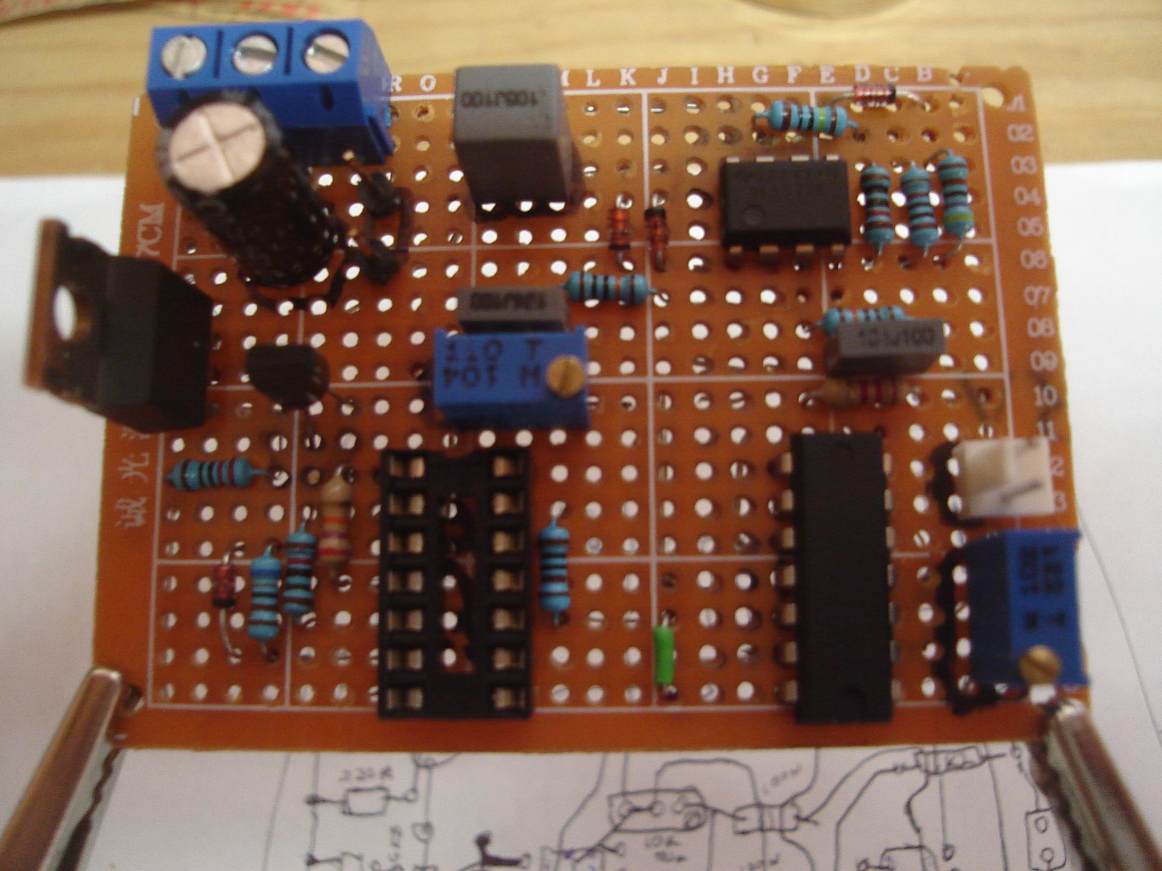

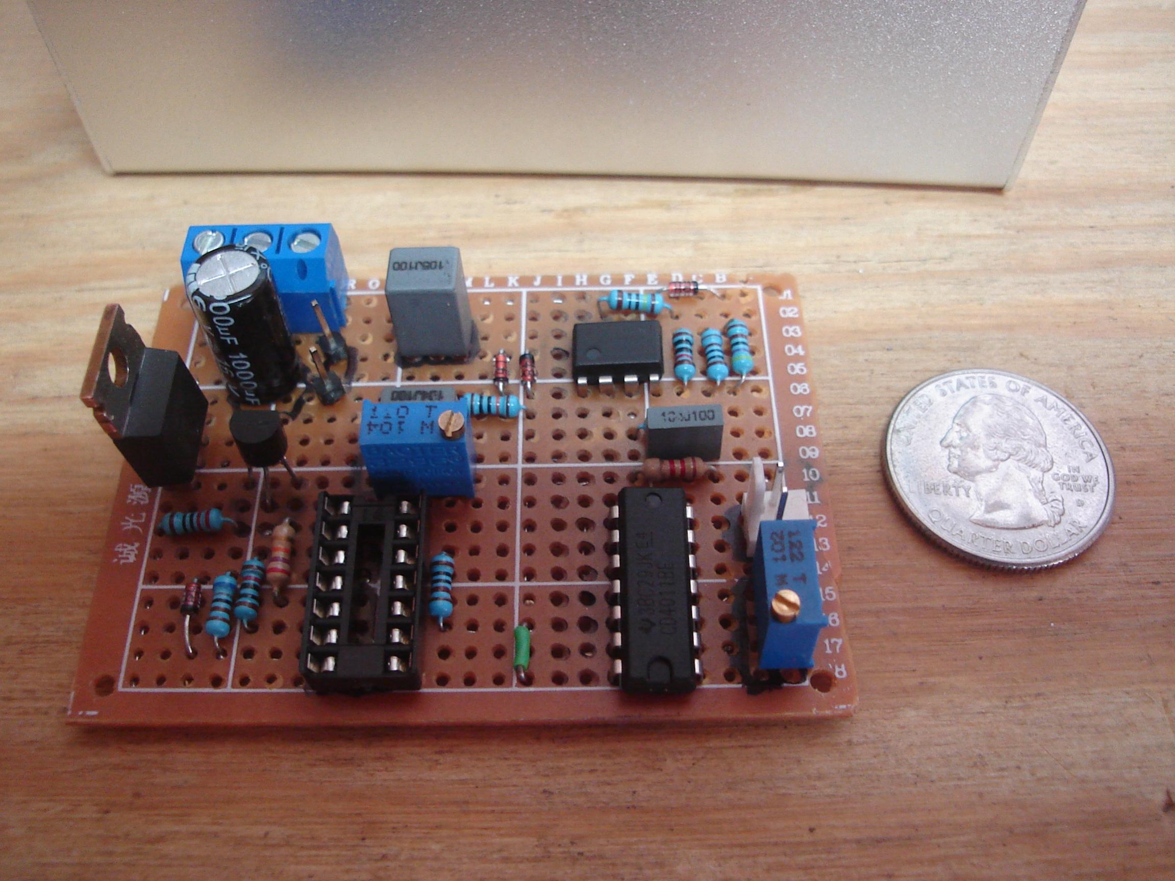

              My PI5 so far
              Oh ok, just wanted to be sure what exactly it was for. It really could be an off board pot adjustment then if its something that's wanted externally.
              Well this is where I'm at so far, I was short a few (three 100N's) caps so its unfinished but its almost done, have to wait on the caps now and my 556's...

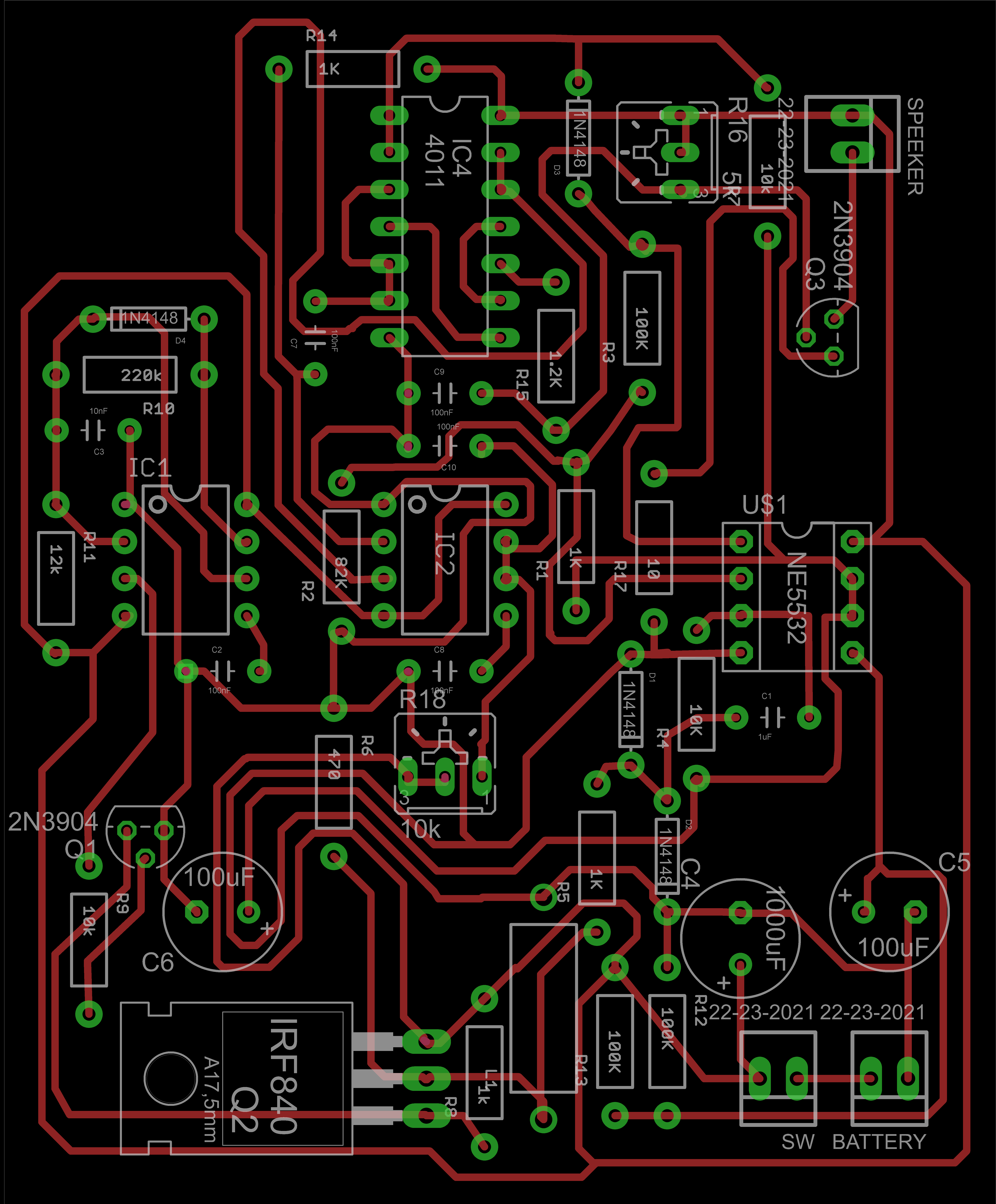

                    has someone drawn a pcb layout with the new schematic?
                      I built 2 of these on the original design that didn't work but that was before Qiaozhi sent over the new schematic. I'll give the new one a whirl and try if I can to get a layout
                      done. I don't use pcb software and draw by hand so it wont look beautiful but it will work.
                        hello geocash
                        if you would makea pcb layout by Hand drawing and can redraw it with software
                          Hey bernte,
                          I have one done that a buddy did for me, but would like someone to go over it to double check it. I know its not beautiful but i'll tell ya, this was a little pain
                          to layout. Maybe you can simplify it. I am in the process of building it right now but it takes me a while longer because I use perf board
                          for builds.
                          Anyway, here is a pcb you can try or modify if you want.
Name:	ITMD PI5 single side pcb.png
                            thanks, not bad
                            will see what i can do, maybe i will post first results next weekend
                            many thanks
                            p.s. i love your avatar it reminds me of my wife 12 years before
