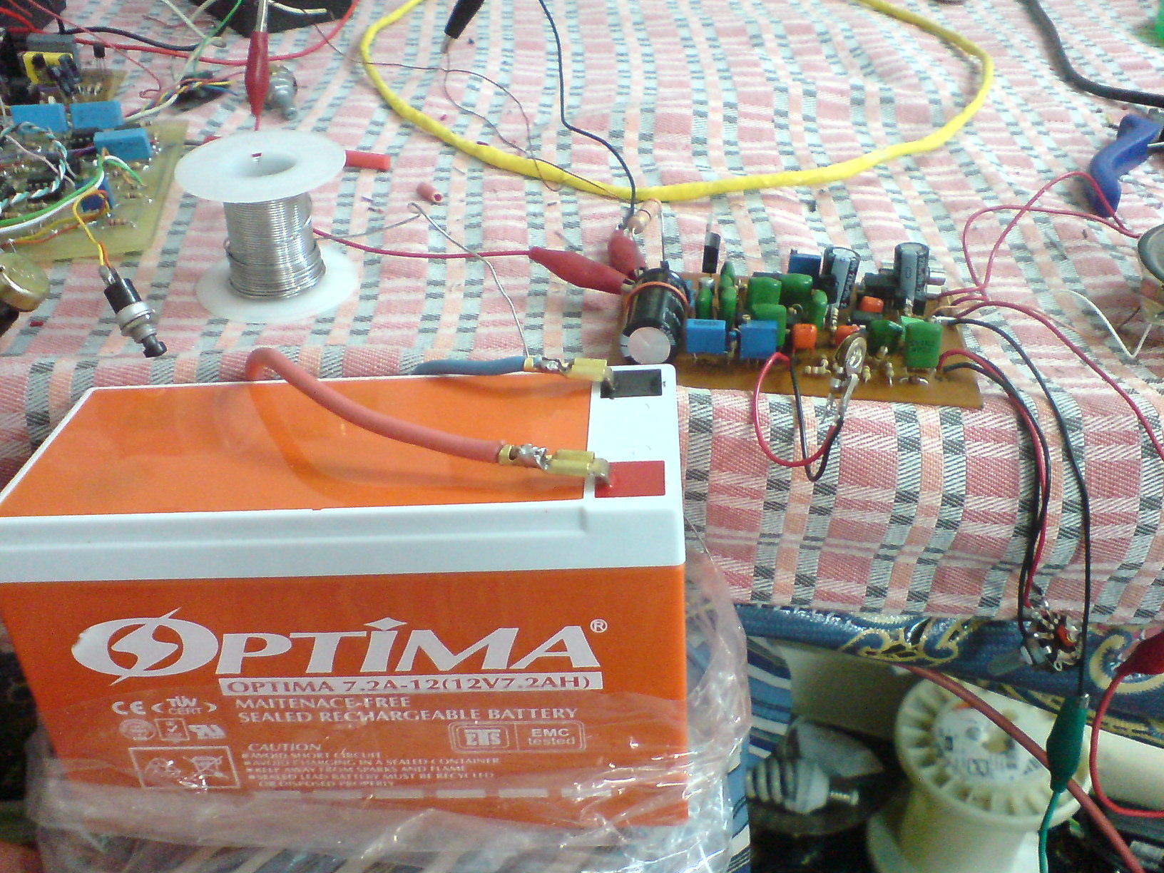

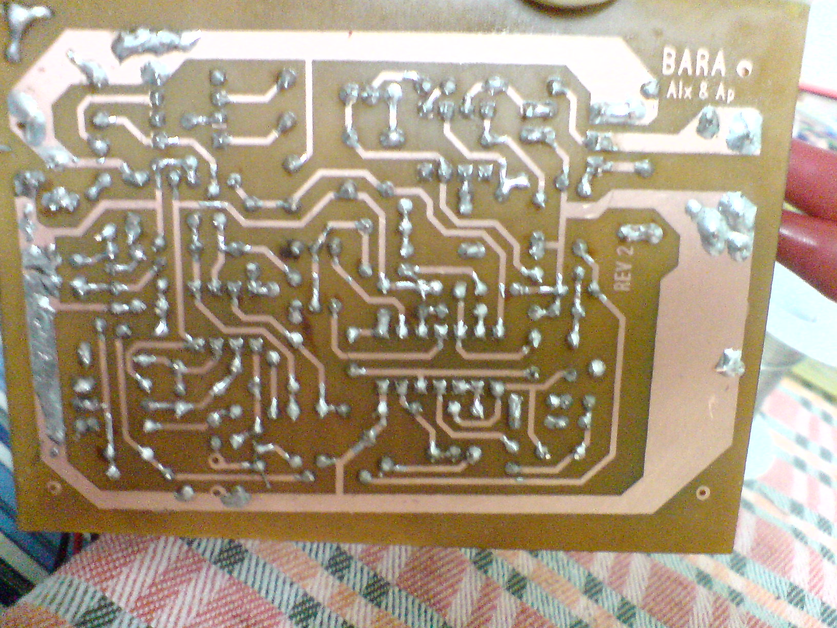

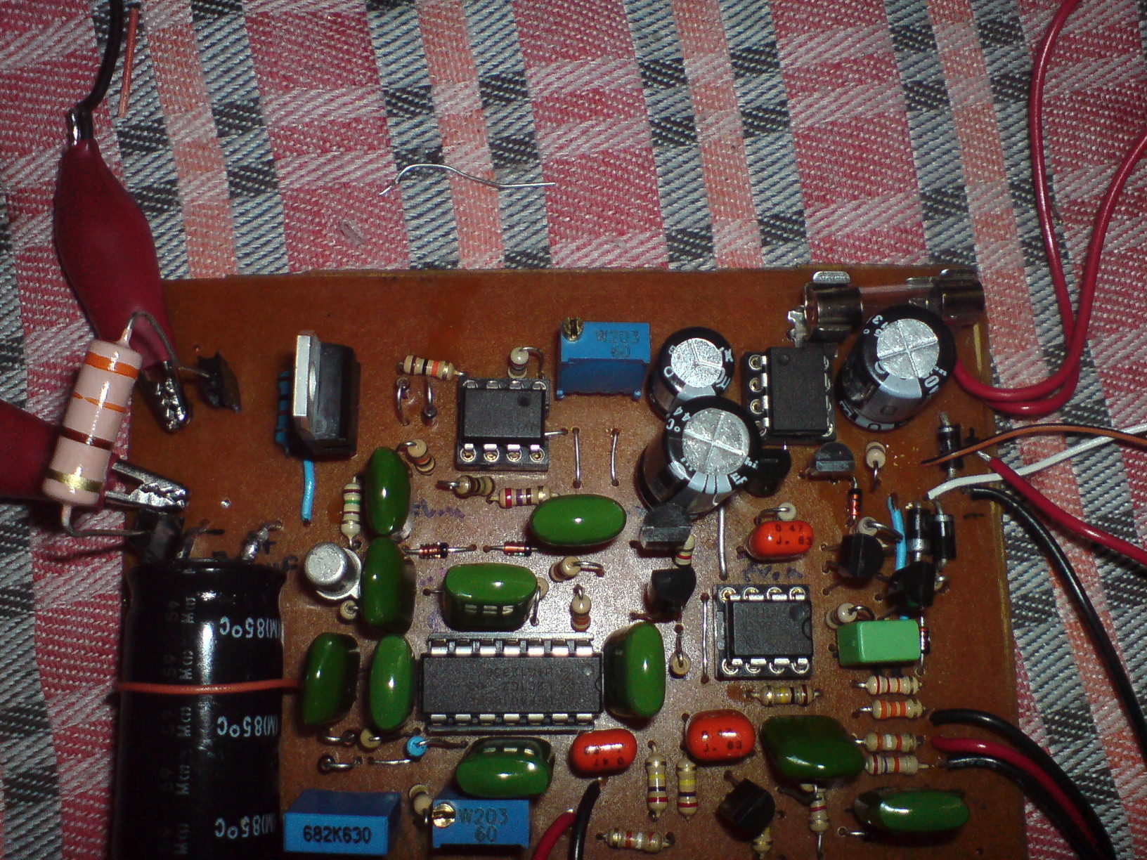

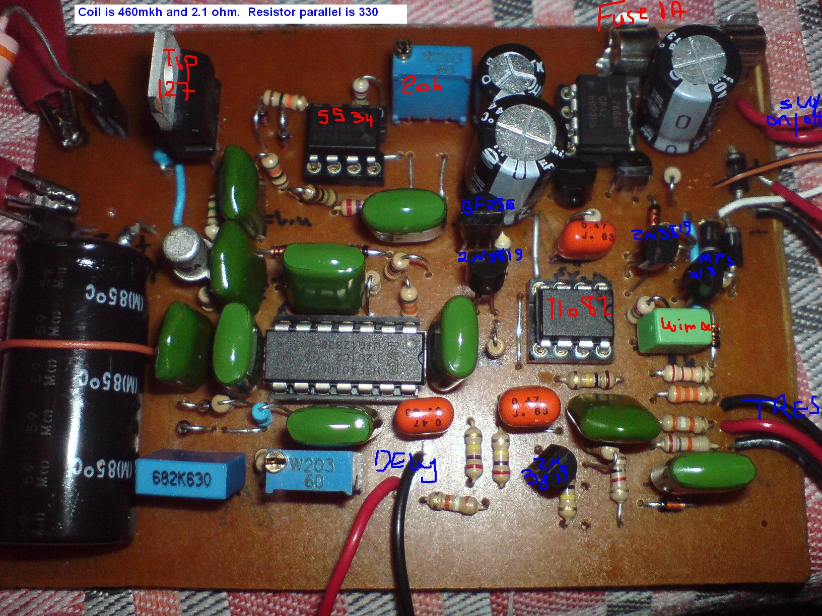

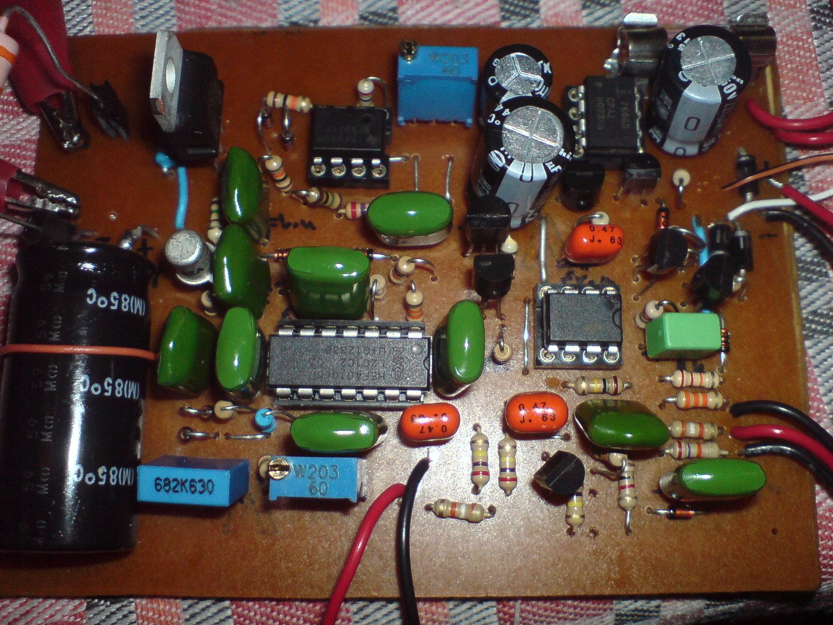

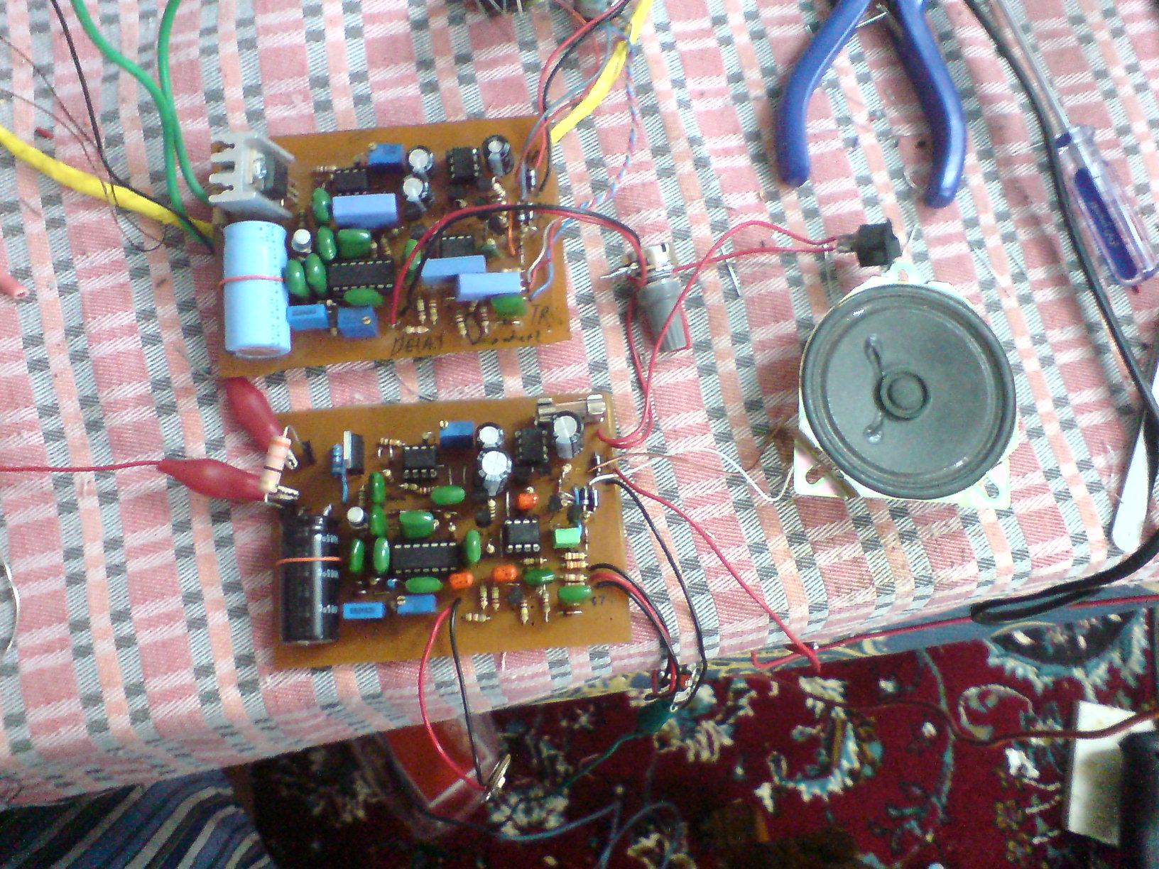

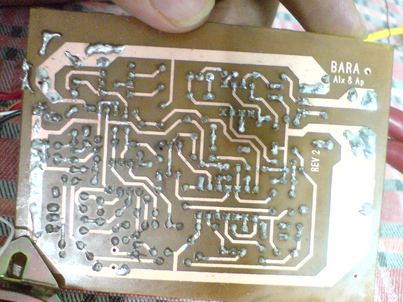

                      • Hello, I ask some question about building my Baracuda. Here in my country i have not find Q3 - 2N5485, can I use MPF102? (q4,5,7 i use MPF102)
                        • HI gurus
                          now i finish the new baracuda detector but i use 2n3819 instead of MPF102 and bf256 instead of 2n5485.
                          just know that i return 180 deg bf256 and i have to change the pin of 2n3819(look the datasheet please)
                          But speaker dont have sound when i return delay and treshold .WHY?
                          coil is 460 mkh and 2.1 ohm and the res is 330hm 2watt.i get the voltage of the coil and it is 0.1v ???
                          i have 690hz on pin8 40106 and 11.9v on collector 2n2222 and 635hz.
                          I check other points (votages)and are ok, why the speaker have not sound????????
                          thanks friend

                          Edit : 2n3819 is D,G,S but MPF102 is D,S,G.
                          bf256 is G,S,D but 2n5485 is D,S,G.
                          i wait for your helps.
                          cheers

                              • hi stadaveuk and gurus
                                sorry me my english bad but i think you say the green caps are ok!!!
                                but my ? are:
                                have good equivalent for the mpf and 2n5485?
                                whay the speaker dont work?
                                why i havenot 2.9 volts at the coil ?and another say in last post
