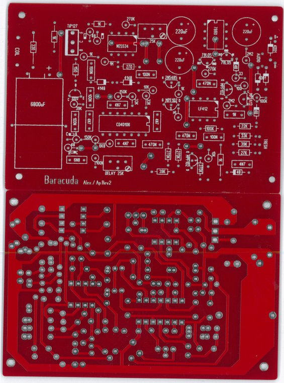

    Baracuda PCB
    I got a few pcb's made, not that I thought there was an error, more because I wanted to build one and I keep getting requests for a simple Pi but not the longboard surf, something that will fit in a more traditional housing.
    The Baracuda board is another great design by Ap, at just 97 x 66 mm it does the job nicely
    I have ordered a batch of boards which should take about a week and I'll get the parts to offer some kits as well

      and how about this coil details?? what kind of wire? what induction and resistance?
      and what is the way to make this coil?

          You can use any standard PI coil of say 333.33uH.

            Got my Baracuda working last night
            I must say I'm impressed, a quick and dirty coil made from 7 strand equipment wire diameter approx 20cm was picking up my wedding ring at 20cm and that was on the noisy bench with the coil on my lap - I will be experimenting more with coils over the next few evenings

                The schematic show 453uH, 1.4R with a 330R damping resistor
                Its a simple mono loop - see ApBergs red wire picture earlier in this thread
                My test coil was simple cheap 7 strand equipment wire, approx 24 turns around a paint pot - maybe 17cm diameter ? - I'll try some different coils over the coming days and try to post some pictures with the results

                            got my baracuda working yesterday for a minute then i touch my coil and it was very warm als my tip127 was hot too i think the problem is caused of all my substitue transistors or something is damaged
                            waiting for the full kit now
                            (my coils are waiting for get pulsed)

                                Baracuda PCB's
                                DHL man has just delivered the boards, and lovely they are too
                                As promised I have put these on special for the rest of June, and recommend building
                                one for some fun on the beaches this summer
                                I love the Surf Pi, but I think these could be even better
