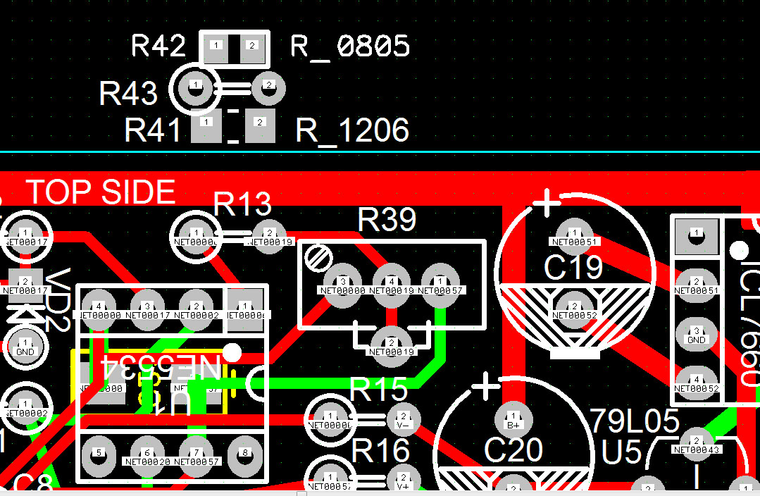

            • use SMD parts for the Bara and you'll get SMD board. thats is NOT hard you think about.
              my board is UNIVERSAL to do both types of placements.

                              a buyer asked me in PM. who can help this collegue in United States to build bara on mine board?
                              sincerely yours
