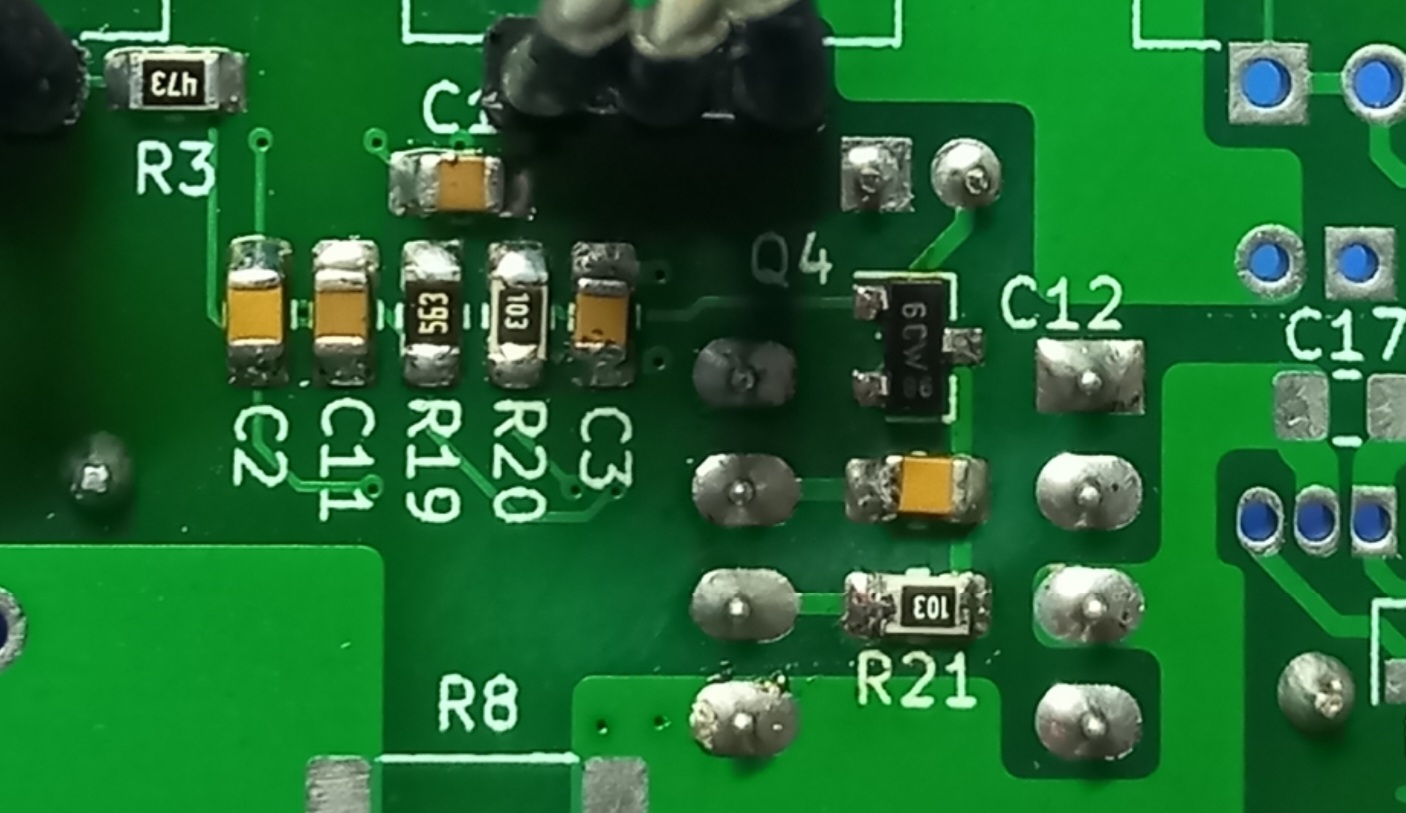

    Zoomed in on the photo of the bottom of your board and you have two resistors in series for R21, they appear to be marked '010' which is 1 Ohm... R21 needs to be 20K.
    Unless the marking is 01C, which then is actually 10K (EIA-96 markings)
    • #92
      Double-check your R21 - see above reply.
      I'd be surpised if U1 was defective, although anything is of course possible.
      Originally posted by hamedtaran View Post
      I checked all the parts, I used two 10k resistors instead of R21, the value of c3 is correct, about 91nf, do you think U1 could be defective?

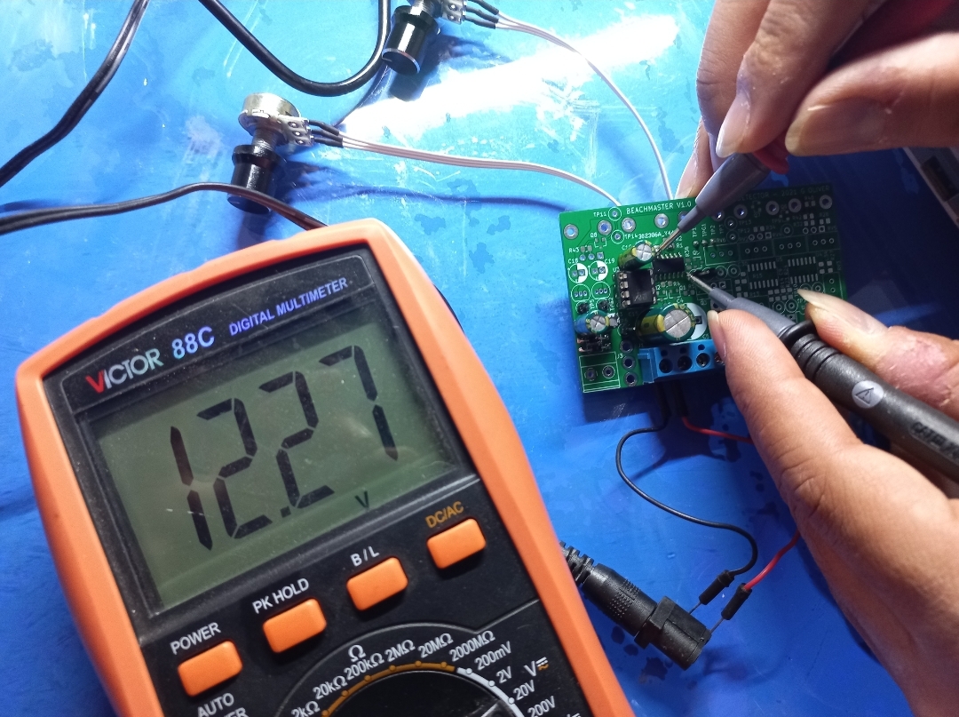

              Actually most of your soldering looks very good , just one or two joints looked a bit suspect...
              The pk-pk at TP1 should be pretty close to U1 supply voltage (around 12V). If you measure across pins 7 and 14 of U1 what voltage do you get? (It should be around 12V) and comes directly from your power supply through the switch. You've bridged the switch out so it should be direct.
                Yes I use a piece of wire instead of power switch, Tomorrow I will replace the u1 and test again, I will also implement the tips you said. thank you for your attention

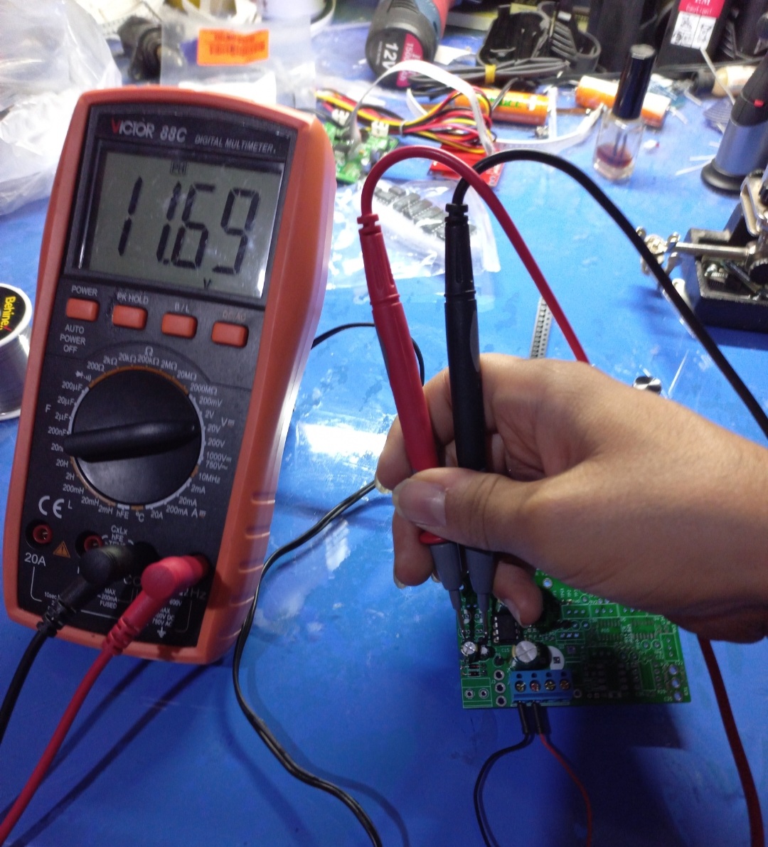

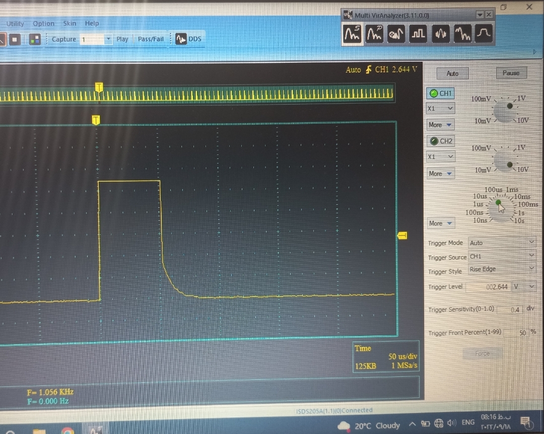

                        • Hi,
                          It just doesn't make sense!
                          U1 has a 12V supply, but its output at Pin 4 (TP1) only appears to be swinging to 5.5V
                          The falling edge is also very slow, what kind of scope probe are you using and do you know its impedance?
                          Also, how confident are you in the accuracy of your scope's calibration? Does it show 12V when hooking up to your 12V power supply?
                          Did you manage to get a scope trace from U3, Pin 2 to confirm that it's running at 1 kHz and not periodically at a much higher frequency?
                          Apologies for all the questions but it's very important that each section is working as expected before moving on to the next.

                            you're welcome! I have to thank you for giving your design to people for free.
                            The frequency of U3 pin2 is 1KHz
                            My scope channels impedance is 1MΩ 25pF and I tested it with 1khz output on the device panel and there is no problem
                            I will replace the U1 IC again tomorrow, I feel that they are all fake, of course your opinion is important to me.
