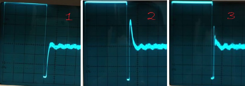

                    • output ne5534 with different values using the dumping tool. in the picture nr 3 i have the best air results. is this signal correct?
                        [ATTACH]39225[/ATTACH]
                        note resistor value for every pic. N1 is near to a result, but not good.

                                With an inductance of 436uH, it is very unlikely that the correct value for the damping resistor will be as high as 1k6.
