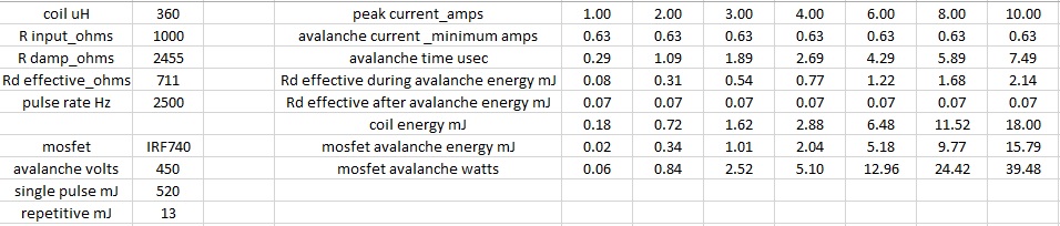

        green produced a table in #237. He takes into account the effect of input resistor - this is the big thing I failed to consider when I happily plugged figures into Miscel !
        With the 1k input resistor in parallel with the damping resistor (bringing the value to 711 ohm), the figure at switch off does not look so alarming.

        • Think I made an error when calculating avalanche energy. Trying again. Maybe someone else could try to compare results.
          • Second try

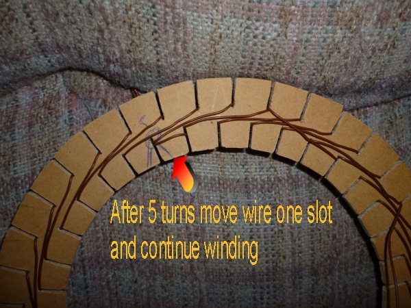

                            • Very interesting KR
                              when you say 7 basketweave turns
                              do you mean 7 turns then move forward one slot rather than wind the normal 5 turns then move forward one slot ?
                                Very interesting KRwhen you say 7 basketweave turnsdo you mean 7 turns then move forward one slot rather than wind the normal 5 turns then move forward one slot ?
                                Thx 6666, & no I mean the normal 5 turns then move forward one slot - like in the pic you supplied so that 7 "basketweave" turns means 7 groups of 5 windings, for a total of 35 laps around the form. By the way, in a thread in the Coils forum it was decided to call this coil construction a spiderweave & refer to it as a 3D Self Shielding (I write 3DSS for short), so going forward that's how I'll refer to it - just a fyi
