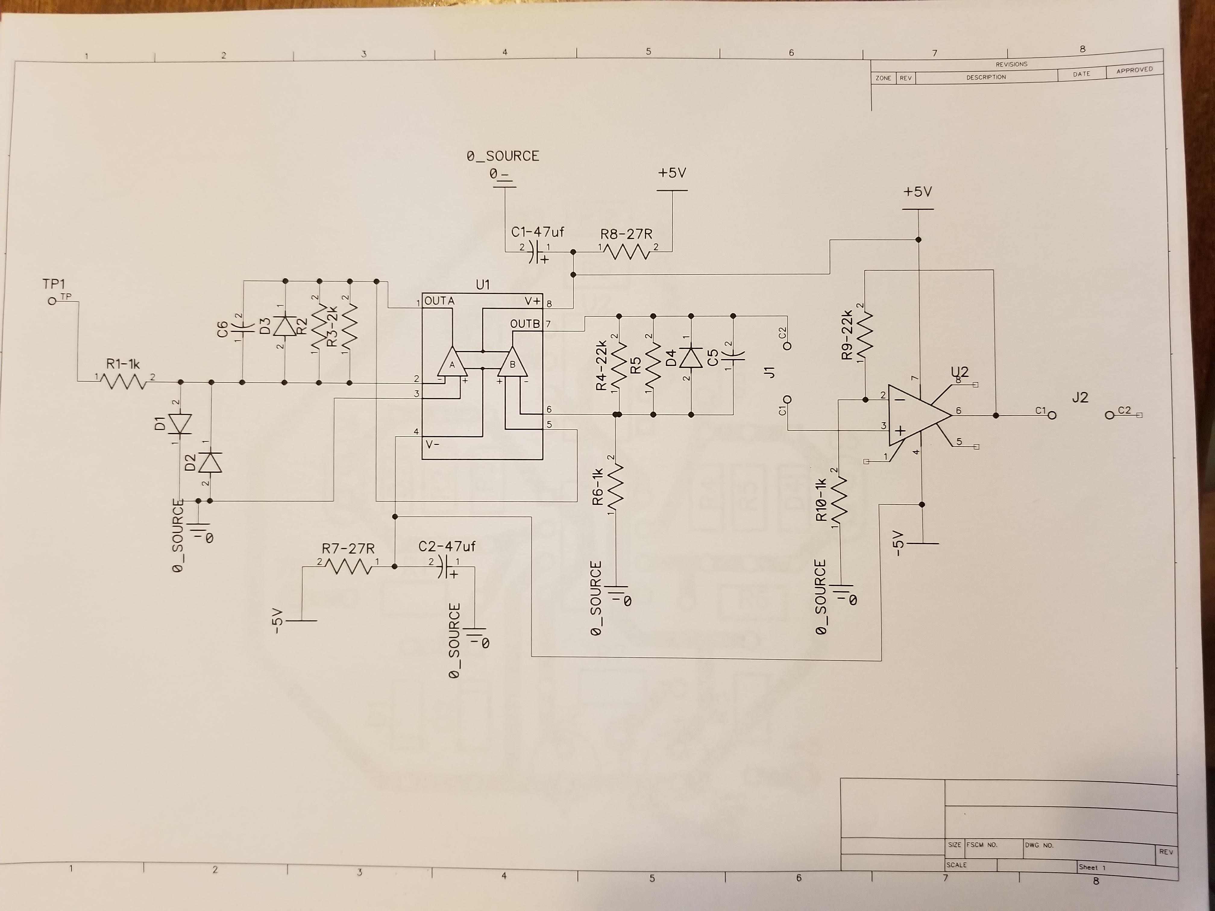

    Can you please post a schematic of what you built. I went back through this thread and was unsure of exactly what schematic is correct.

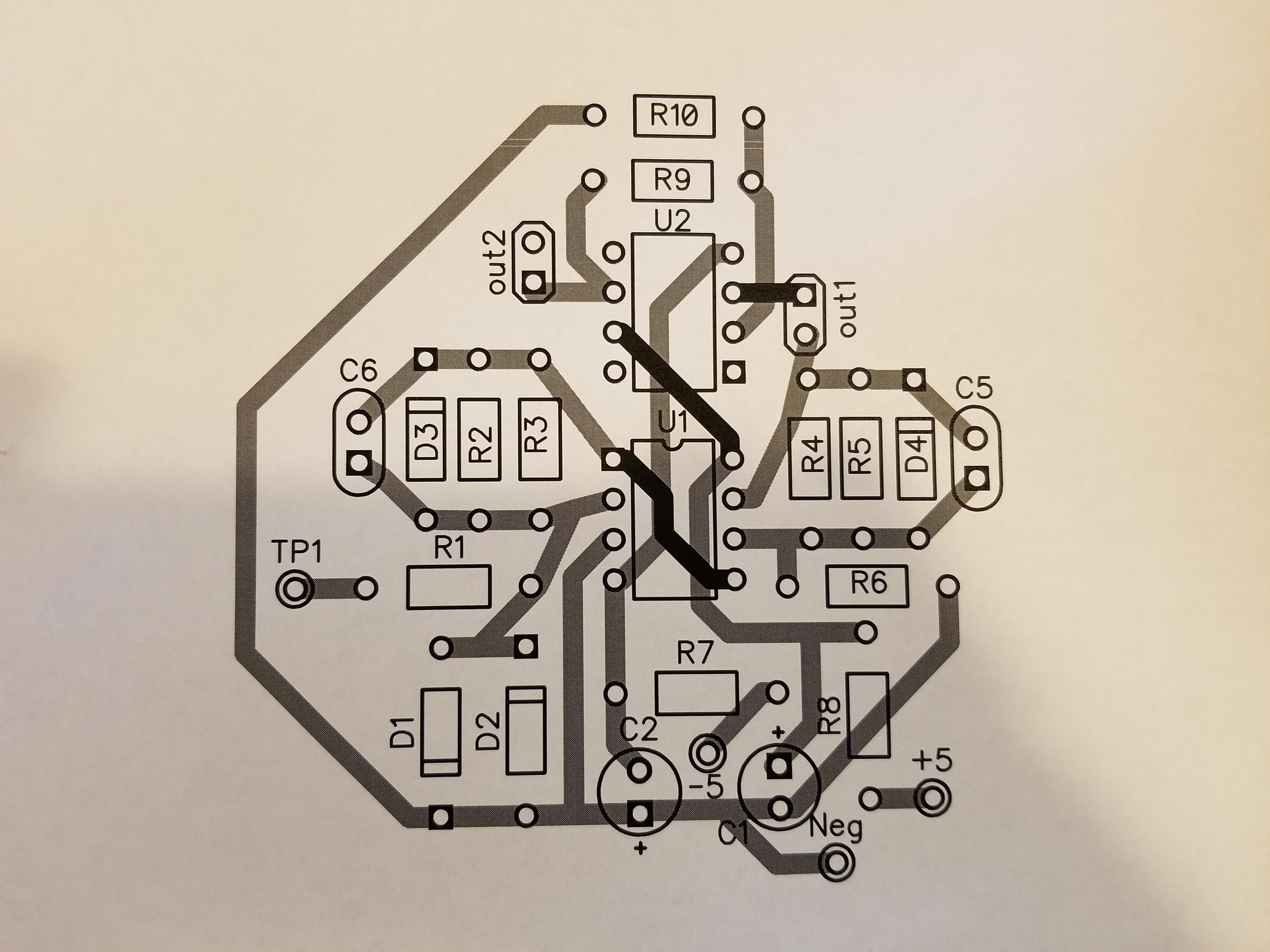

        Here is the schematic I built to, There are three extra spots at the feedback resistors I was going to use for further testing.
        I also made up a quick pcb layout for it.
        It has no ground plane or outline pretty rough I made it for easy perf board layout.

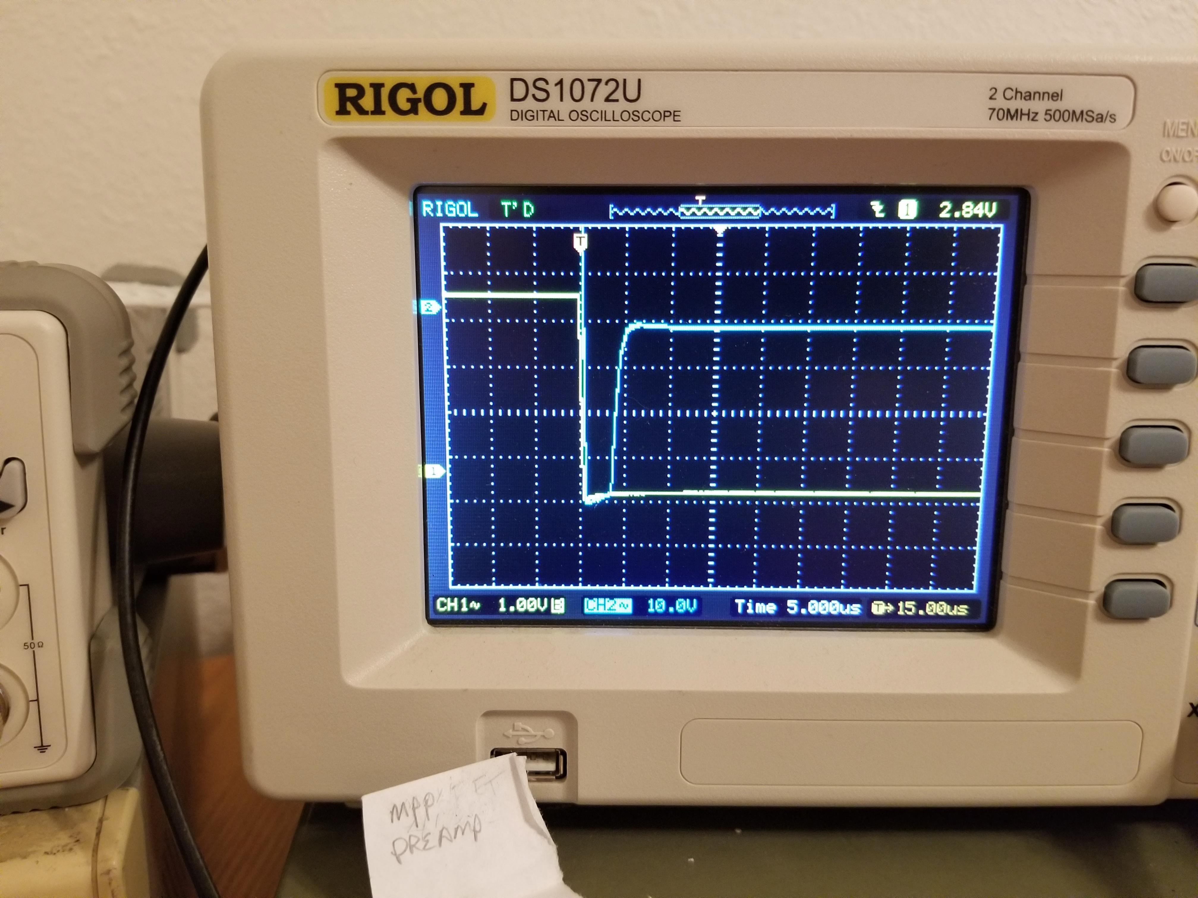

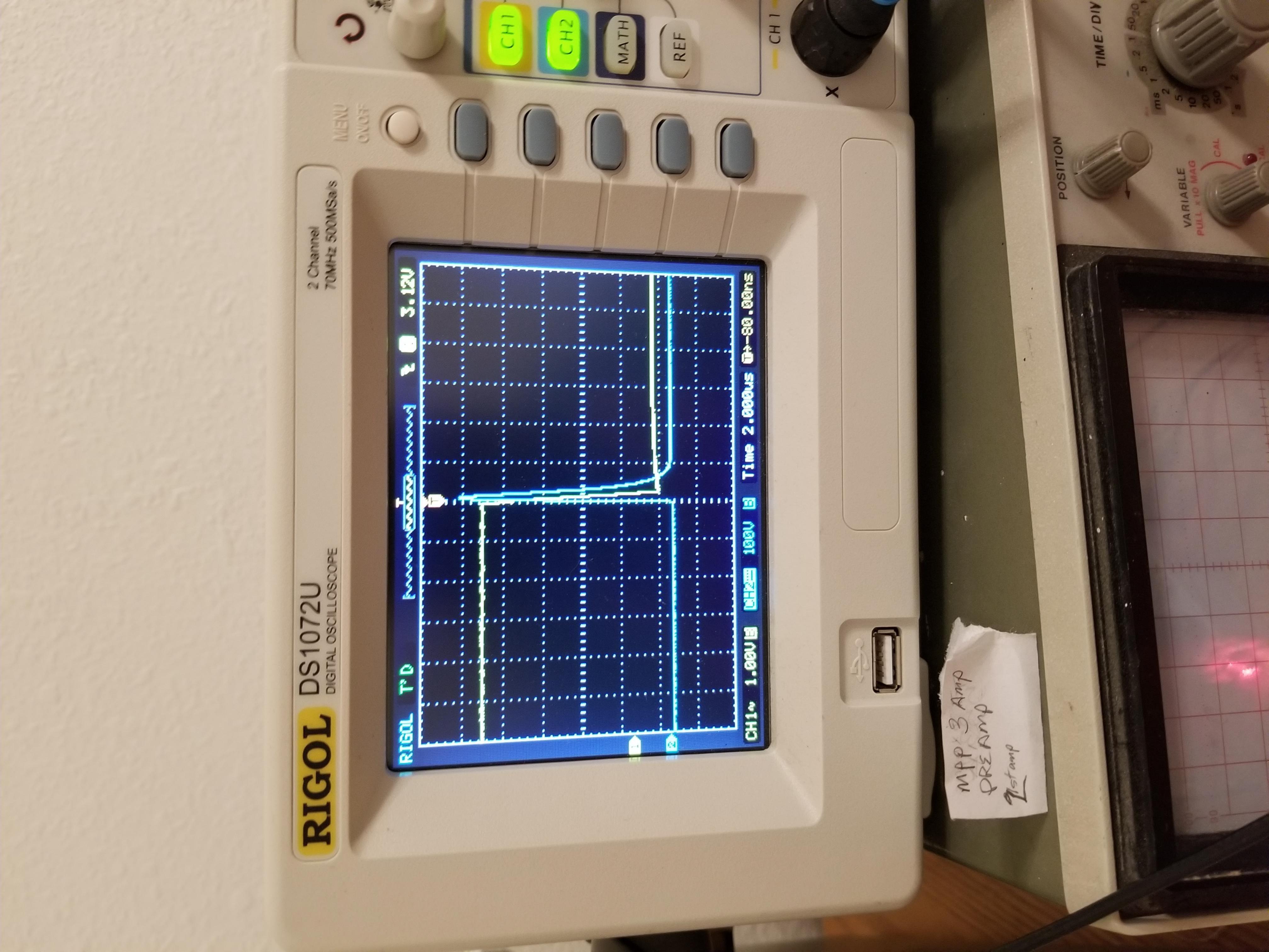

                    • I hooked up the three amp set up to the Mpp.
                      I was a bit surprised to see that its a bit slower than the Mpp dual amp with just the 4562.
                      It looked really good on the signal generator.
                      This is what I'm seeing on the stock MPP preamp with a 4562.
Name:	stock Mpp with 4562.jpg

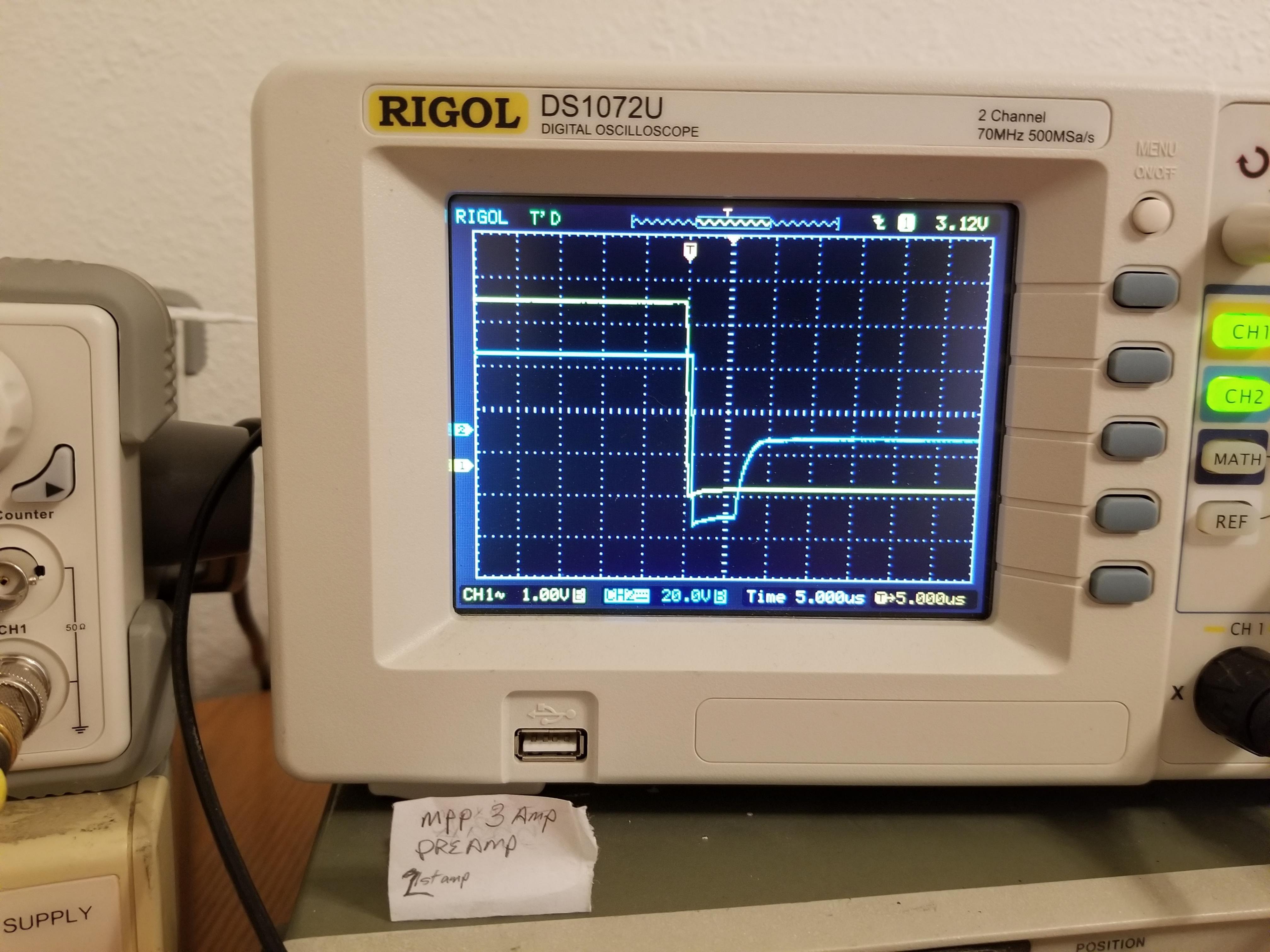

                      This is the 3 stage amp.
Name:	3 amp 3rd amp.jpg

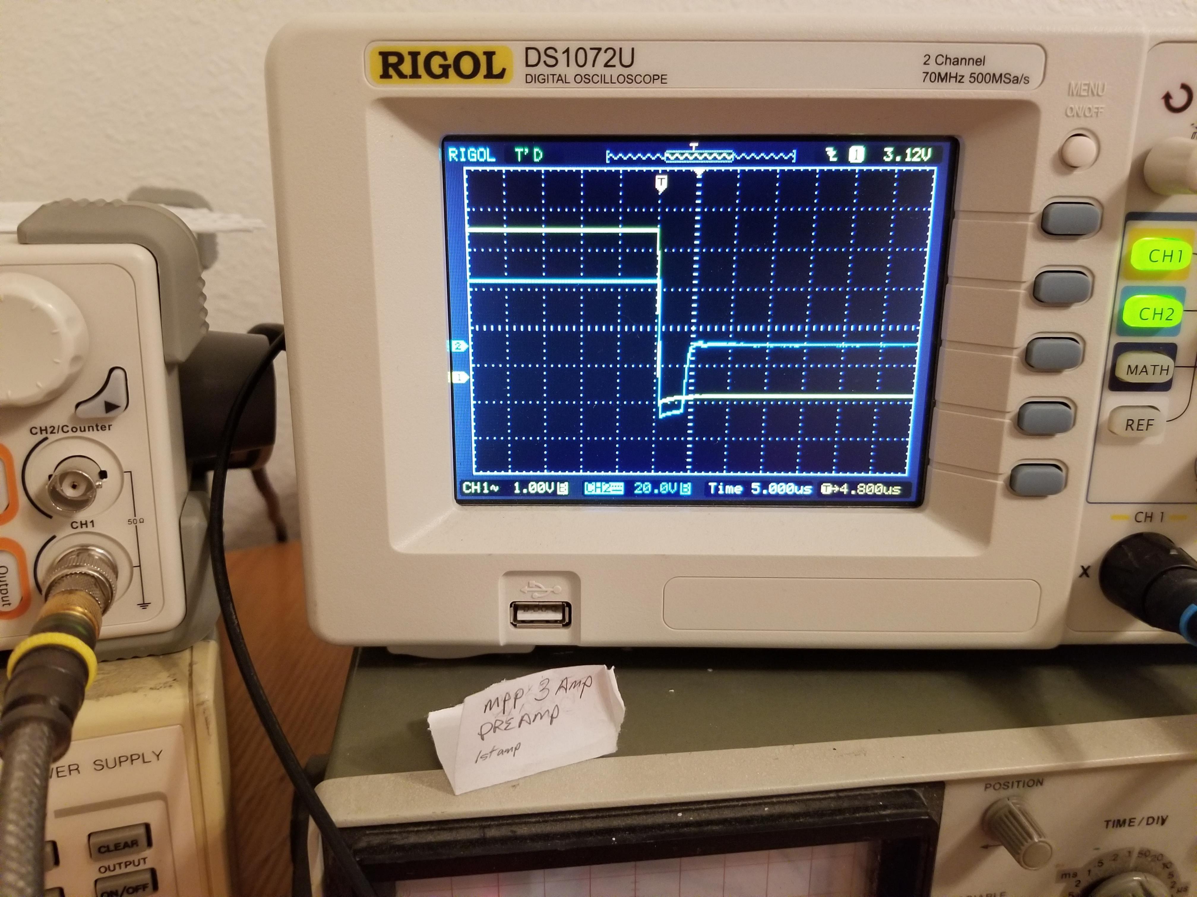

                      Here is the 4562 before the Tlc081, the 081 slows thing down quite a bit as you can see in the above picture.
Name:	4562 before 081.jpg
                      Here is the Tx fly back.
Name:	coil flyback pulse.jpg
                      As far as performance the first big difference is the damping resistor value.
                      Using the same coil for both amps, the stock Mpp damped at 520 ohms and with the 3 stage its damping at 1.637k
                      Seems to have picked up a couple inches but the threshold is a bit unruly, that may be partially my test set up.

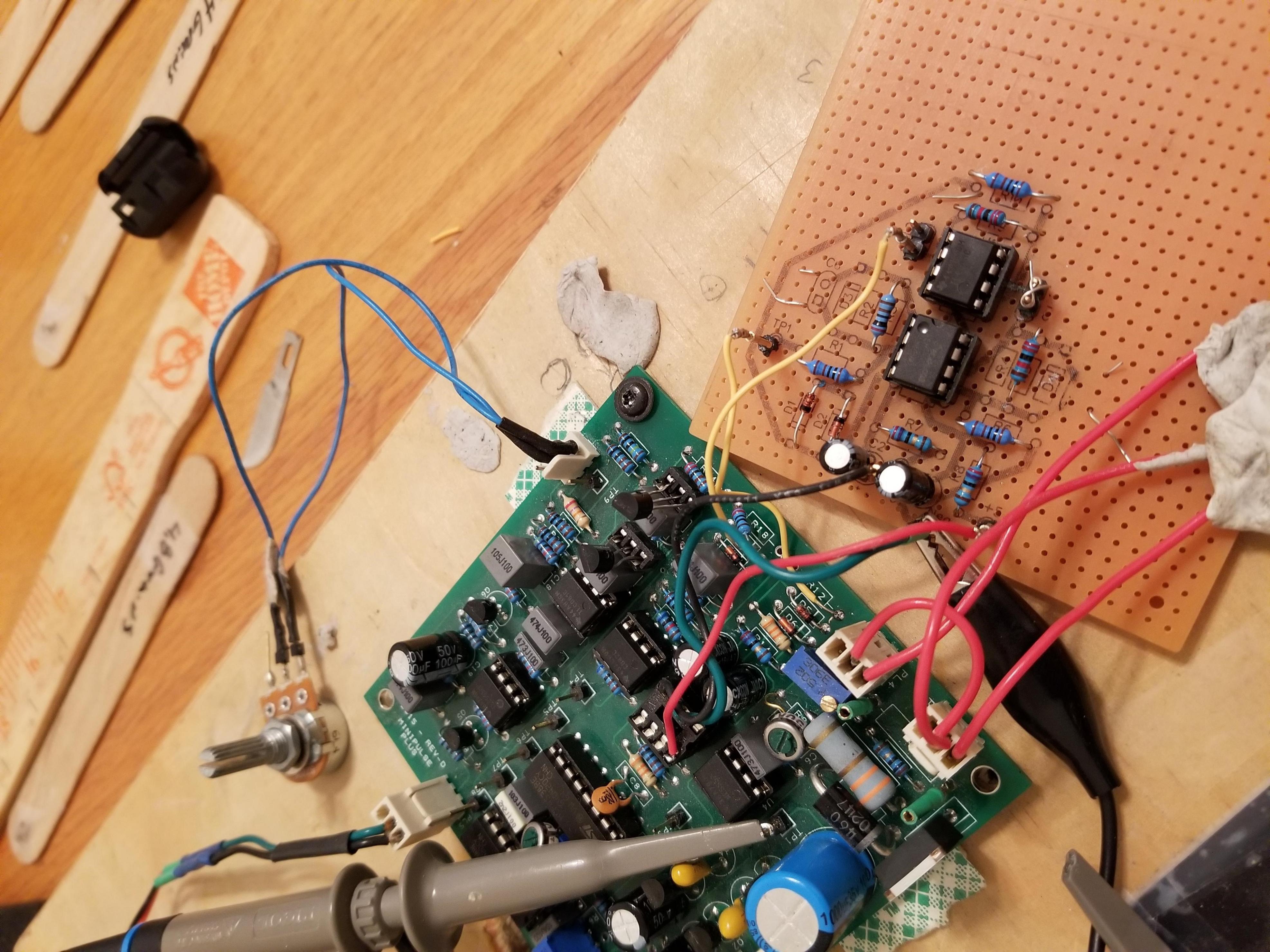

                      In the pic Below you can see its off board and wires sticking up. I think I'm picking up more environmental noise . plus no ground plane on the pcb.
Name:	3stage hook up.jpg
                      I tried a Tlc082 and 081 combination with pretty much the same results.
                      I think on board dead bug style may be next then another half of a 4562 for the third amp, otherwise the stock amp is already faster then the sample generator. Mine shuts down at right under 5us for first sample spacing.
                      I would like to get another 1us or so, that way I have a little leeway on a 5 us sample.
                      • the stock Mpp damped at 520 ohms and with the 3 stage its damping at 1.637k
                        You are getting some varying results, but you can see a difference, the damping changing is a little curious.
                        • Thanks for posting O'scope pictures.
                          I take it that your signal generator did not Saturate the first op-amp like the TX coil's Flyback does.
                          It is this flyback saturating the op-amp that is the issue.
                          1- many op-amps take some time to 'recover'.
                          2- Due to Gain the op-amp output is only a Very small fraction of the fly-back amplitude. so hard to compare on a scope.
                          Hint: Does your scope have an External Trigger input?
                          If so then feed the TX pulse logic signal into the external input and select this to trigger scope.
                          Now you have two scope probe inputs so can look at TX fly-back AND Pre-amp output. Or at two points in the pre-amp stages.
                          There is no need to 'see' the logic pulse signal since you know what this looks like.
                          Good stuff.
                            That is indeed curious. That's a big difference in the damping value for the same coil.
                            I would have thought that the coil only sees the first stage, and the capacitative difference would have been small between the stock circuit and the 3 stage circuit.
                              Read post #1. Circuit Rd=damping resistor if amplifier doesn't keep one end of Rin at ground. Circuit Rd=(damping resistor*input resistor)/(damping resistor + input resistor)if amplifier keeps one end of Rin at ground. Rd changes depending on what amplifier does.
