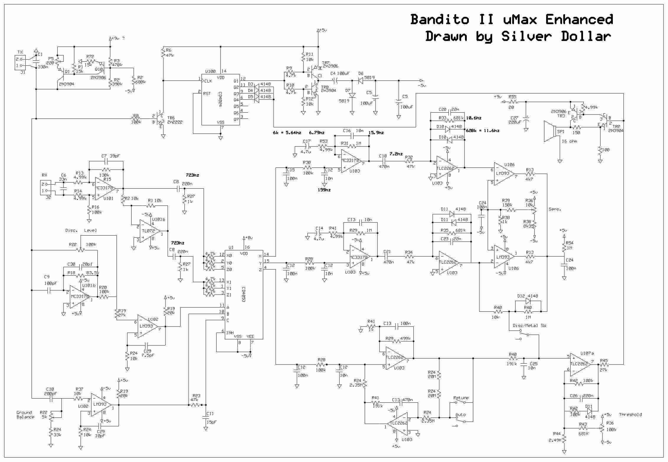

    Well I was reading that Tesoro used a 3 turn because it was cheaper. The 10 turn is easier to tune GB with.
    The GB is very sensitive. I'm not sure if you want to use shielded or plastic ones...

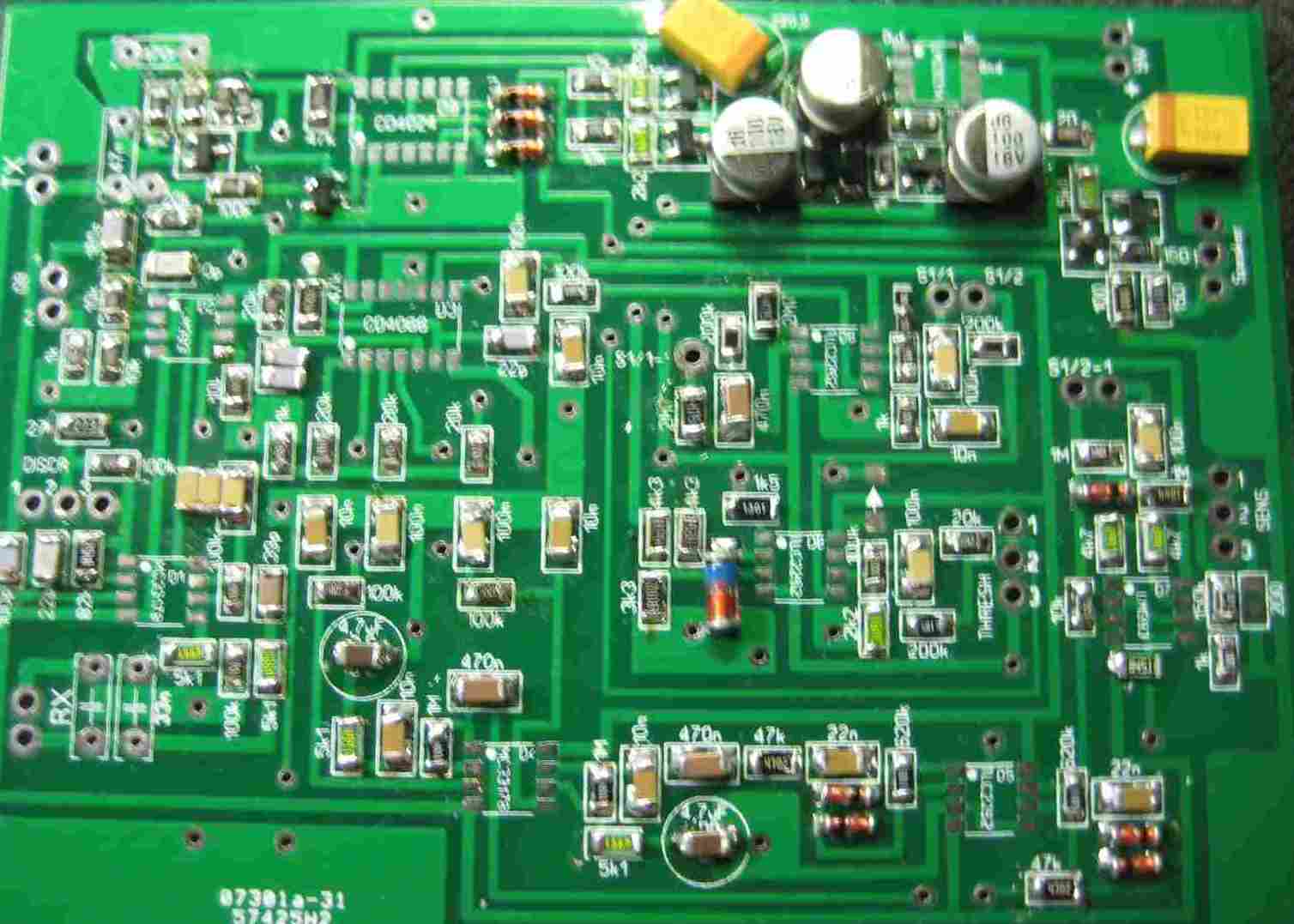

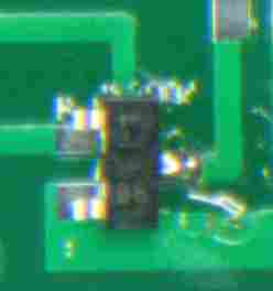

            Here's a pic of the transistor that doesn't fit showing how much pad you have to work with;
            Here's what I got done so far. I found some small SMT 100uf caps.

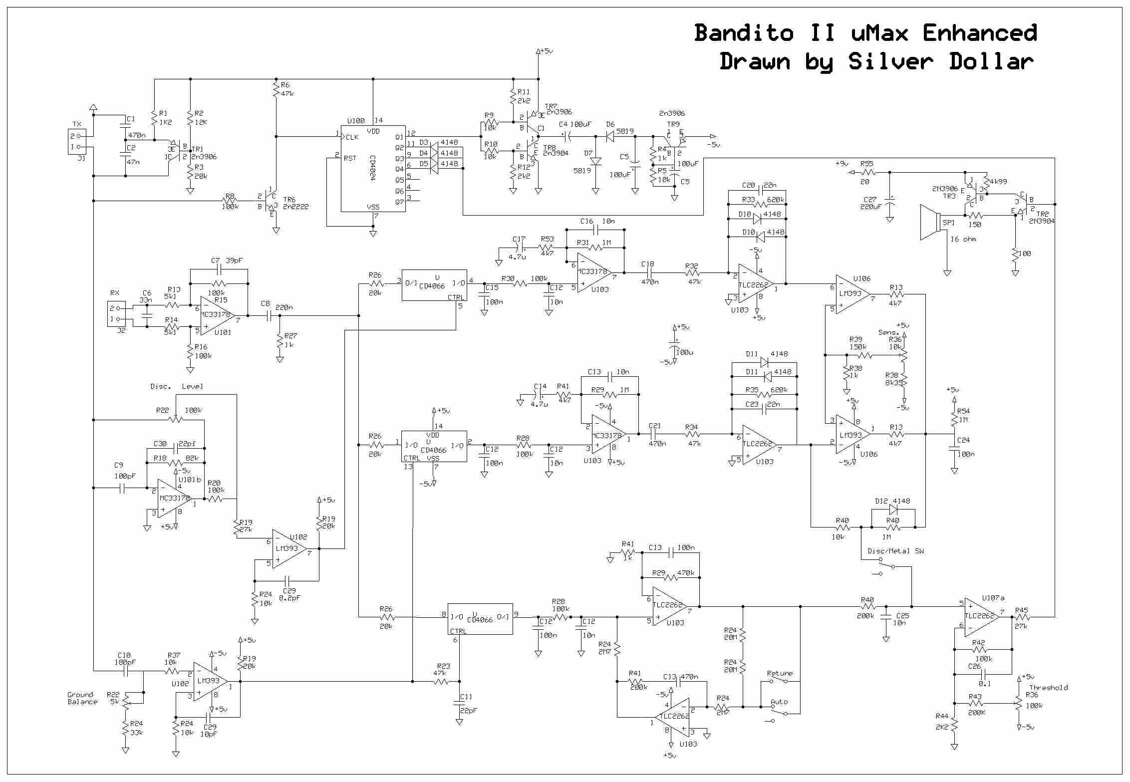

              So I drew the schematic in Express so I can make mods to it;

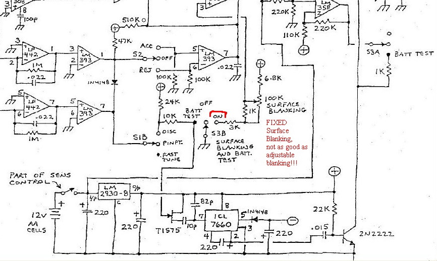

                    Found this thread on the mods forum. The Eldorado and Bandido are very similar. Noticed that a performance increase in all metal mode if the board is in a metal grounded case or at least a lined with foil. Link.
                    Doing some research at the moment to find the best coil specs for a 27DD. Thinks it's better to go for a center tap same as original to keep the phase shift the same.
                    Tesoro detectors seem to be popular on the www.teknolojiekibi.com forum site some good results with home made Eldorado. Google does not work well on my machine and bings is slow going.
                    Waiting for parts from China to arrive while this is happening I will finish the Mouser list off and get them ordered.
                    • #85

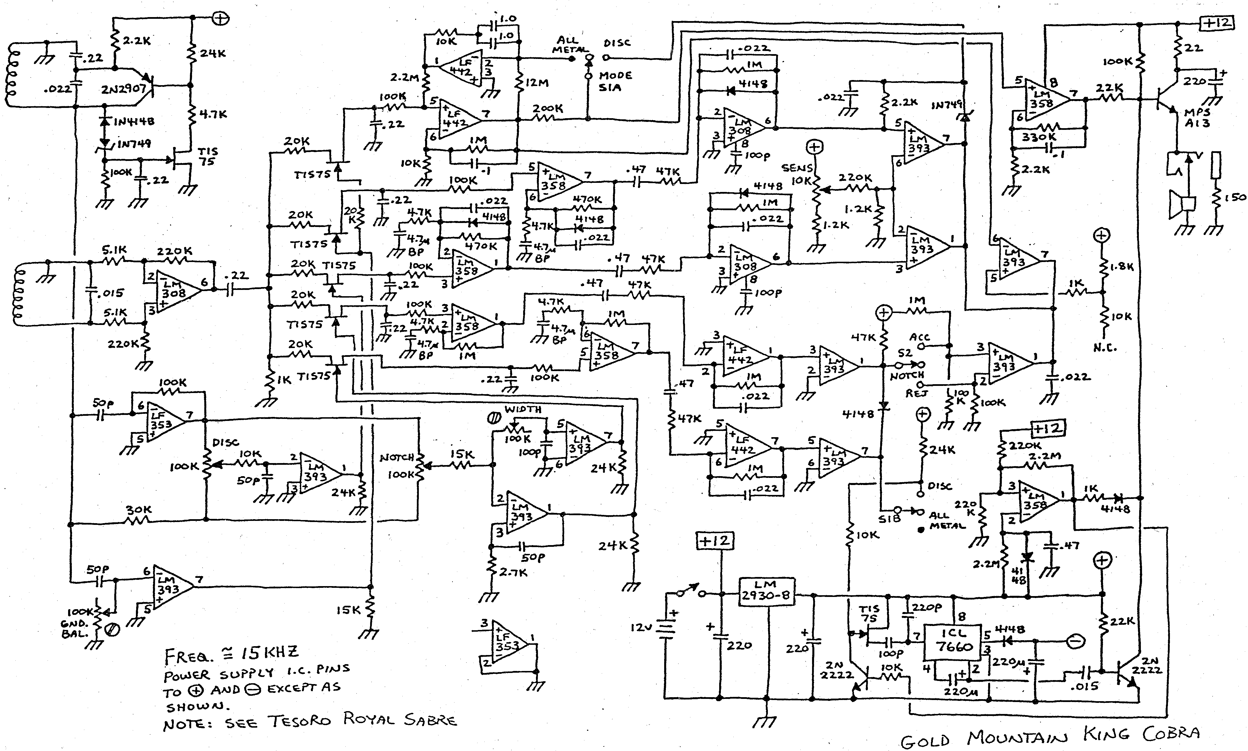

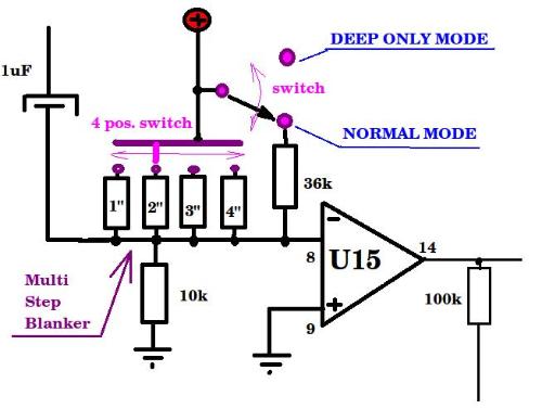

                      Gold Mountain Tech King Cobra has two tone sound, Accept Reject Notch filter, also you can add Surface Blanking adv like in Royal Sabre tesoro if you want.
                      good luck
Name:	Royal Sabre Blanking circuit.jpg
ID:	340487Click image for larger version
ID:	340488Click image for larger version
ID:	340489Click image for larger version

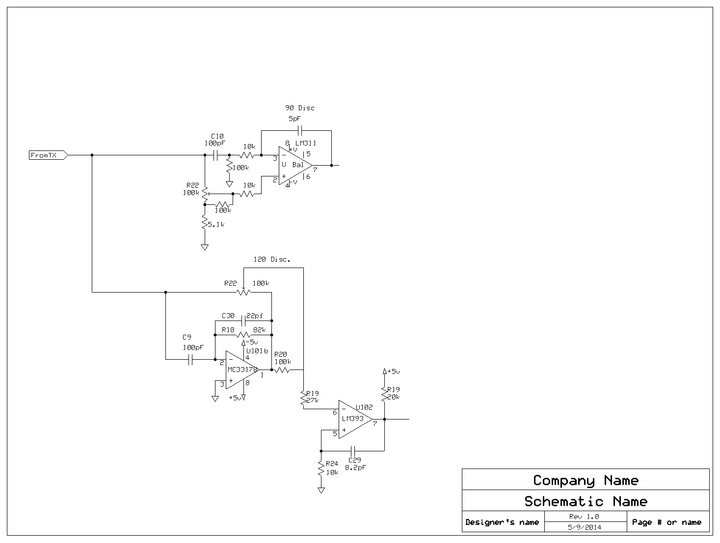

                                Well my Bandito came in today it's cool! I set it up and air tested a screwdriver to 12" or so.
                                I was reading that the Bandito found more trash (than the older models) so some were adding 90 degree Disc to it.
                                So I started working on a possible mod to allow 120 or 90 degree Disc;
                                I had a thought too about the center tapped coils. If you use the beginning wires for the coil and ground the ending
                                wires then the outside of coil will be ground so it will have some self shielding...
