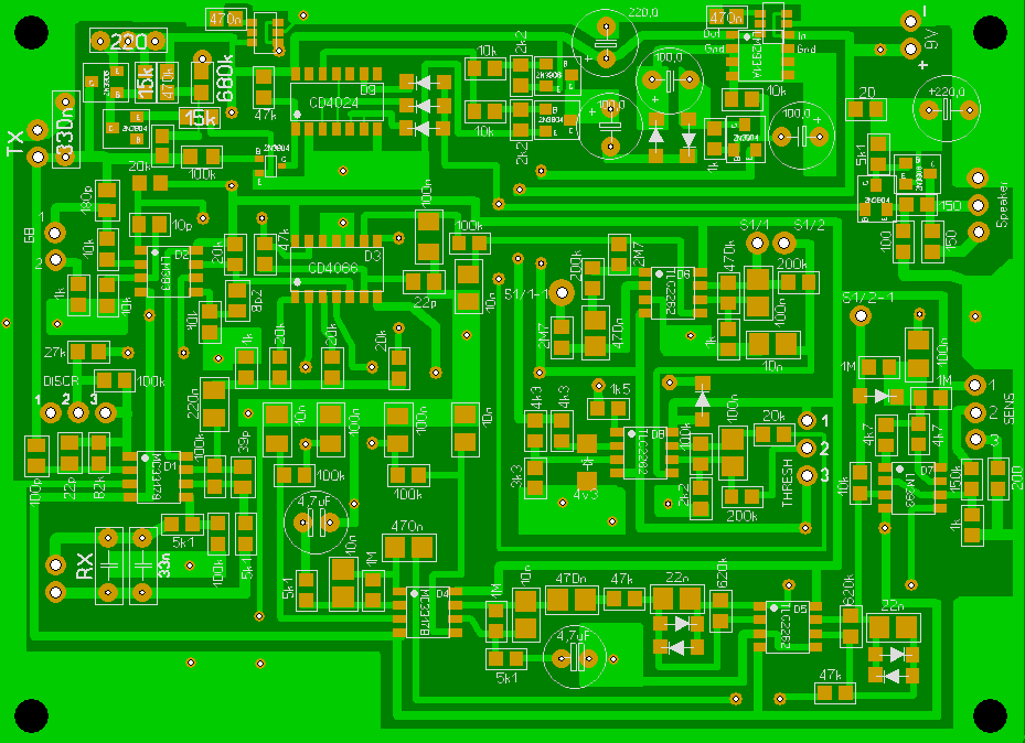

        Yow some of those are expensive! I just completed a new layout. I fixed a problem with an ungrounded cap
        and changed the TX to the Minelab one. I also added a MIC5207 LDO setup for the main 5V and another for
        the TX itself (I have these handy).
        Here's a picture;
        Note with the Minelab you don't need the 1.2K , 12K and 20K!

            I did a few more tweaks to the new layout today. I added a couple of pads so you can select the
            diodes you want for sound. I also added a couple of mods from the attached schematic. One is two
            20 meg resistors (oops more values to buy!, those are for the PP mode and helps ground balance
            I think. And an option to jump the sensitivity pot to -5v through a resistor. Some used that one the
            Golden Saber to get closer to the noise floor. You can still stuff the original resistor and use it per
            the original design.

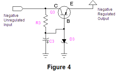

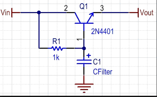

              I'm still unclear on the mistake for the pass transistor on the output of the negative supply.
              Chemlec showed a PNP with the emitter to the output then corrected it to a NPN with the
              emitter going to the input. I found a picture on the WEB of a capacitance multiplier with
              a NPN with Emitter to the output but I'm not sure if this being a negative supply changes
              things....

              I found the answer! If you have a negative supply it goes this way;
                Yep I would go with that the three successful builds on here Firebox Hugo and ashefr10 used a 2N3906 PNP wounder how bernte_one got on

                            I tweaked the layout a bit yesterday and changed all the through-hole caps to SMT. It was tough
                            as not much room was left. I was hoping to add the second channels to the back of the board
                            to make the Dual Bandito but it's a bit complicated. I may have to start all over to be able to do that.
                            I'm not sure I will even have more boards made as no one seems interested in building some. I
                            probably have enough boards around to do what I need...

                                I took a copy of that board and am comparing it to our board looking for mistakes + improvements.
