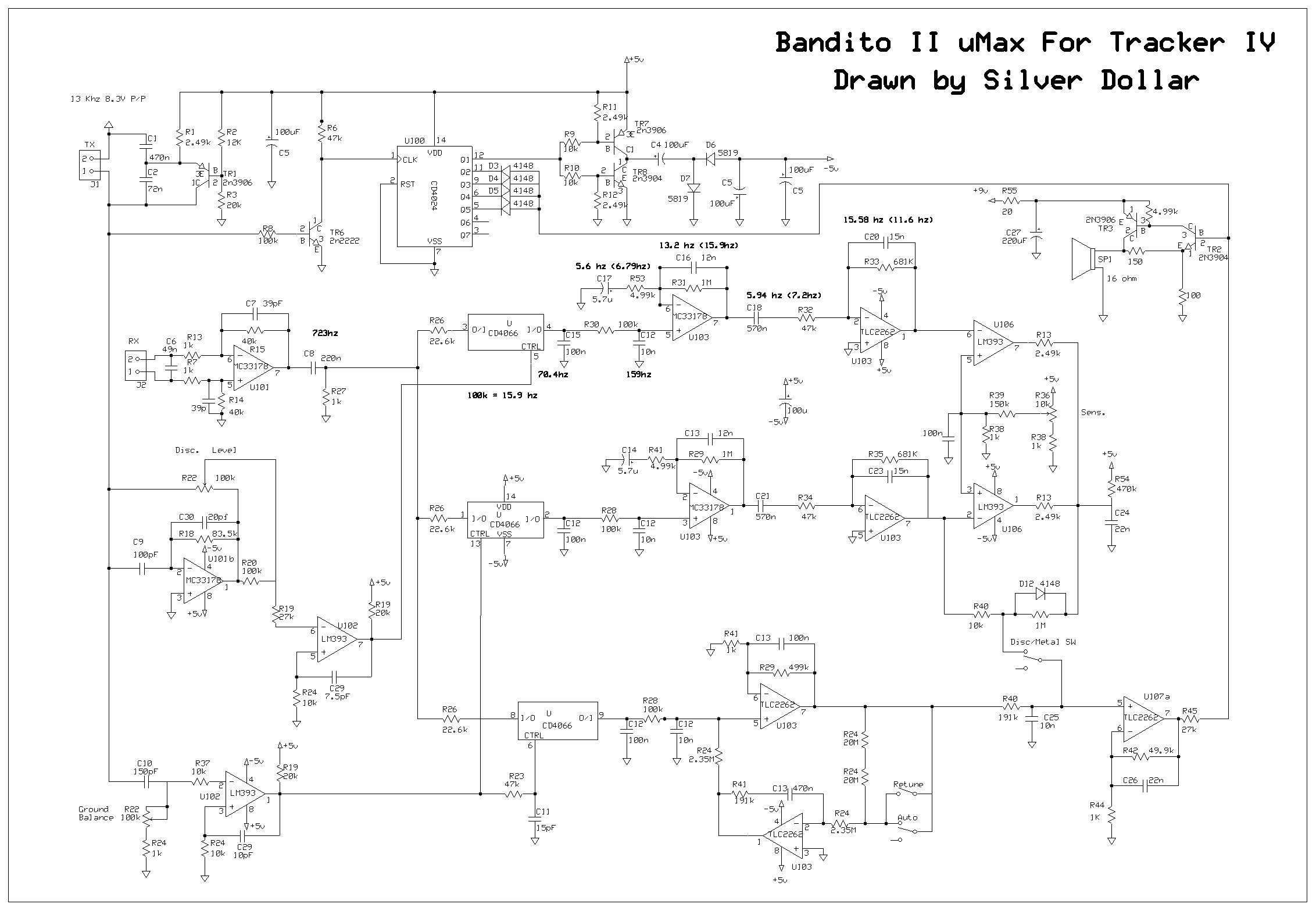

                        • Well after lots of work I've arrived at the most optimal values for most every part on the board.
                          I'm using the Tracker Coil (TX 2.7 mh RX 2.4 mh) and have the max depth and stablest config
                          I could tune. The last mod allows for volume change with depth. You might think your missing
                          some targets due to low volume but they are not there. There's a wall you hit and no signals
                          get through it. Motorboating lives at extreme sensitivities and I couldn't find a way to get rid
                          of it to hear those faint signals. The volume mod stops the tendency to run on after a target
                          goes by. So I'll clean the board one more time and start working on the front panel and putting
                          it in a box!
                          Here's the final schematic. There's some funny values arrived at by lots of experimenting;
Name:	Bandito My Mods.jpg

                              • I had a bit of a breakthrough today. I had just about changed every component on the board
                                trying for more depth. Well I was looking at the IDX as a possible board for my daughters little
                                MD. I got a BH coil that has a cap in it so wants to oscillate at 6.5 Khz. I built the IDX oscillator
                                tonight and found it works quite well on the Bounty Hunter coil.
                                So anyway I was studying the schematic to see the differences from Bandito/TGSL to IDX and
                                noticed the cap after the input op amp is 22n on IDX and 220N on the other MD's. I changed it
                                on the Bandito and Bang 1 - 2" more on all targets. Silver is solid to 13" and cracks to 15". Gold
                                goes to 12" and the the coins go 1 - 1.5" deeper too!
                                I'm not sure the function of that cap. It could be a low pass or high pass but changing it sure
                                makes a difference! The sound is a bit crunchy towards the max depth and haven't tried it in the
                                ground yet but it appears promising.
