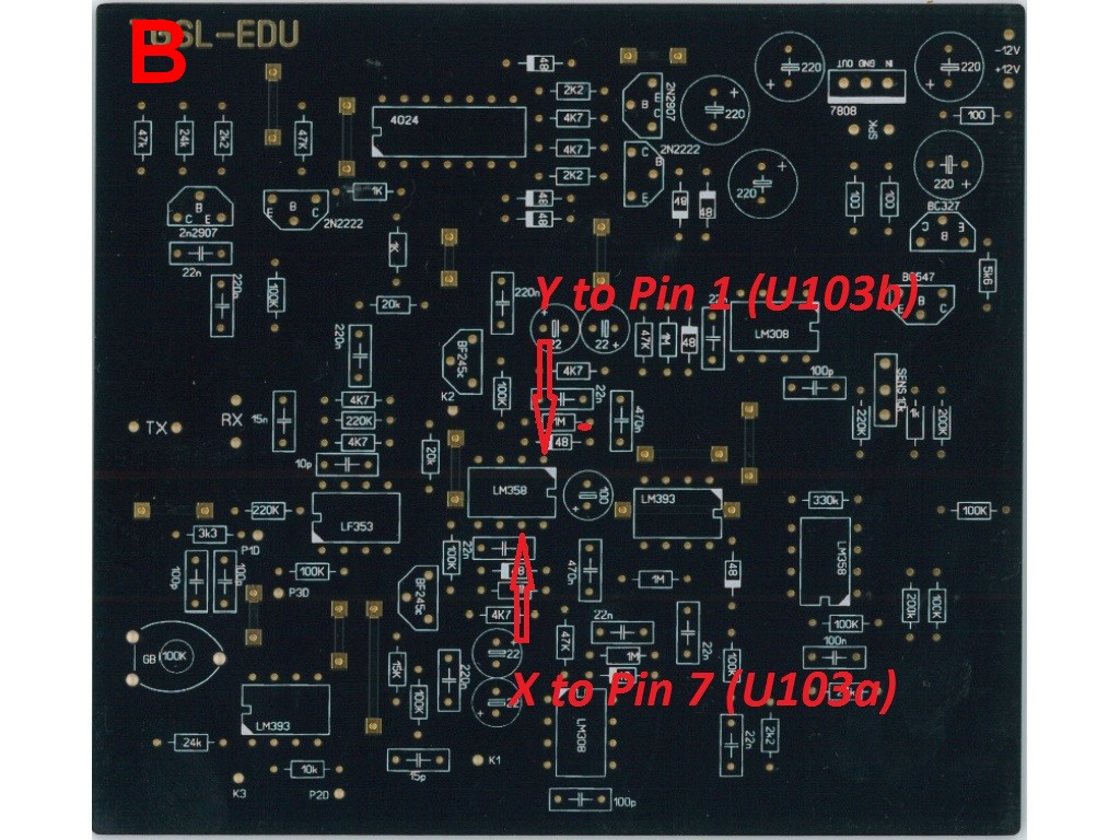

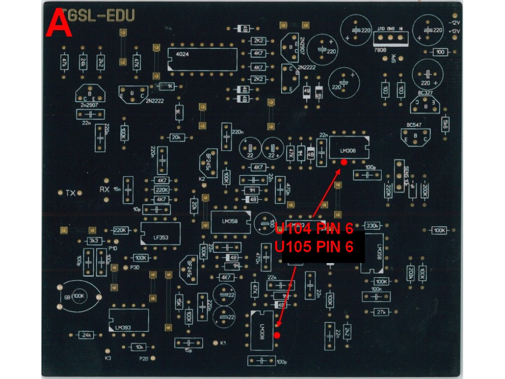

            I connected pins from LM308.
            Which is correct?
            A or B?

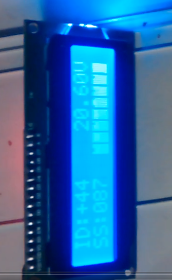

            Video
            https://dl.dropboxusercontent.com/u/..._221106729.mp4
            sorry for translation
              the connection "A" is good.
                works well at home, now I have to prove it on the field. I'm very happy. I'll post my installation files if someone serves. Thanks for everything and greetings from Spain.

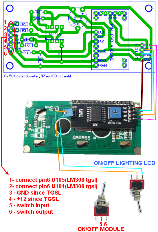

                  I leave my files for all who wish to use.
                  I do not use decoder. My LCD illumination is controlled by a switch. On/off only.
                  GEOTECH thanks especially to members
                  Prospekteur Darem.
                  TGSL EDU_Arduino_Vdi part 1.rar
                  TGSL EDU_Arduino_Vdi part 2.rar
                  Missing two libraries necessary for Arduino. They have to search for the network.
                  LiquidCrystal_I2C
                  MenuSystem

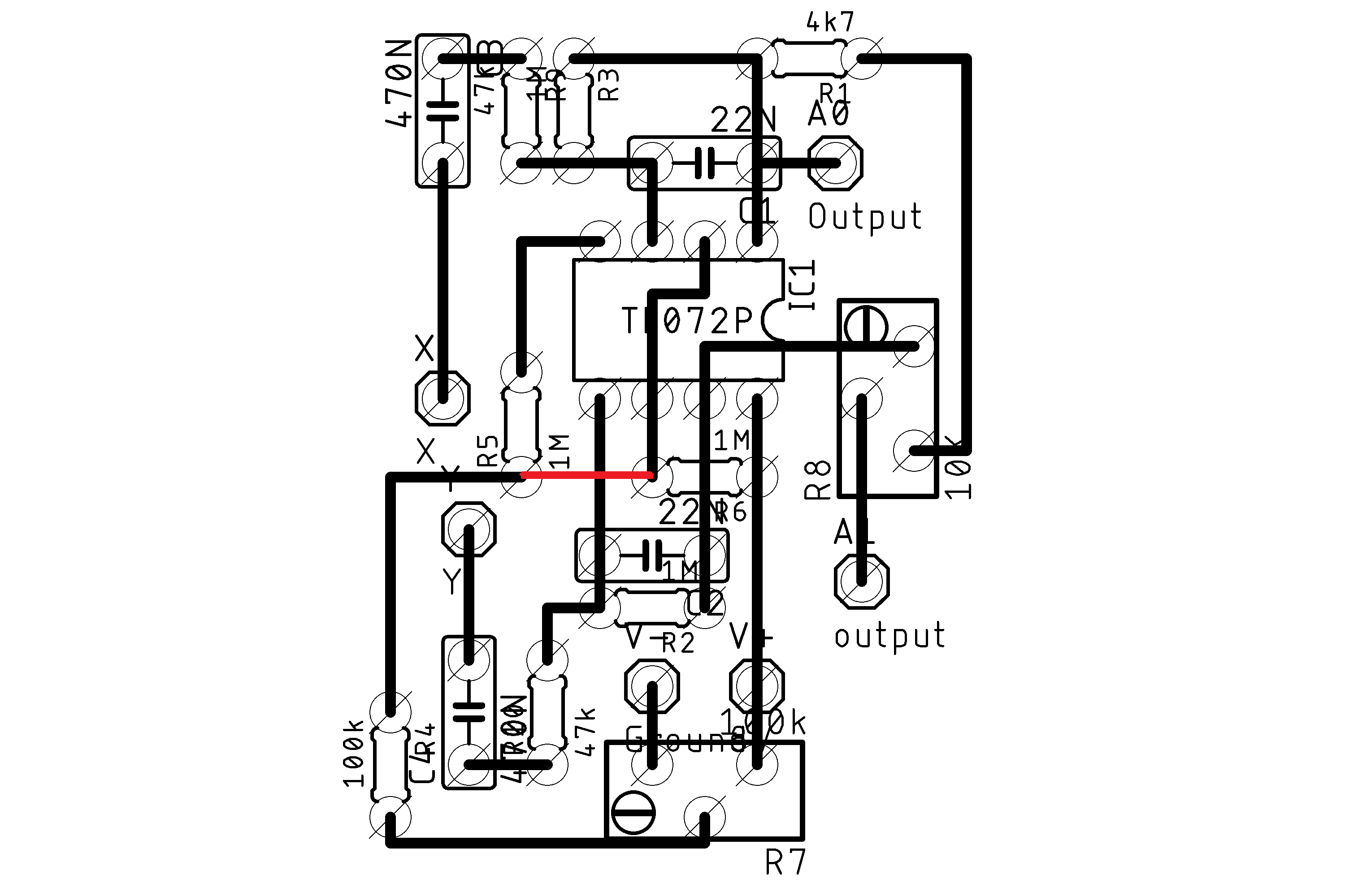

                        • #42
                          Could someone verify the schematic and board layout to make sure it could work and if everything is in place right please. was done in Eagle, It is for XY signal to Arduino VDI.
                          Thank you
                          The Zip has all the schematic and Gerber's.
