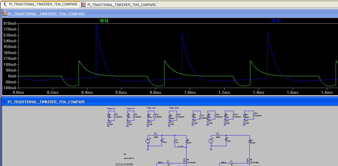

    attached is a simulation, comparing Tinkerer_TEM with traditional PI
      I am trying to understand the TEM method.
      The second TX transmission pulse starts right at the end of the high voltage pulse, so it does not oscillate.
      Unlike the traditional system, (and by way of comparison), the TX pulse is usually 10% of the duty cycle. In the TEM method, the transmission pulse is 90% of the duty cycle.
      It is right?
        Right.
        I put the 2 simulations together to make it easier to compare.
        Look at the target response and compare the power consumption. for the target response click on the inductors of the targets. This shows the eddy currents in the target, related to what the RX coil will see.
        I made the Flyback and the peak TX current roughly the same level. Try changing each of the parameters at the time.

            It is clearly seen in the simulations that the response to the objectives is greater in the TEM method.
            I wonder how samples are taken at the receiver, with a TX pulse that takes up the longest time in the transmission cycle.
            I assume samples are taken during the TX pulse, perhaps similarly to the Tinkerer V1.

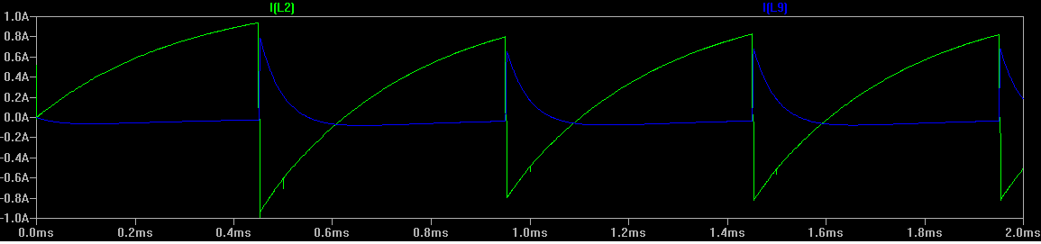

                The first image shows the response of both methods to target 50 us.
                In the second image, the target response 50 us and current in the coil in the TEM method.
                It was also observed that at the moment the target signal is reaching zero, the current in the coil is increasing.Click image for larger version

                  Excellent.
                  You can see that the traditional PI decay curve goes to about 0 and stays there until the next TX pulse.
                  On the TINKERER-TEM, the decay goes to about 0, but does not stay, it crosses over. So your 0 is the crossover point.
                  For the TINKERER-TEM you need a separate RX coil. You can use an IB or Induction Balance setup like a DD coil, or a concentric RX coil. There are several variations.
                    Excellent.
                    The crossover point can be manipulated. If the TX cycle is too long the coil starts ringing soon after reaching 0.
                    But if you increase the frequency the ringing time overlaps with the next TX cycle.

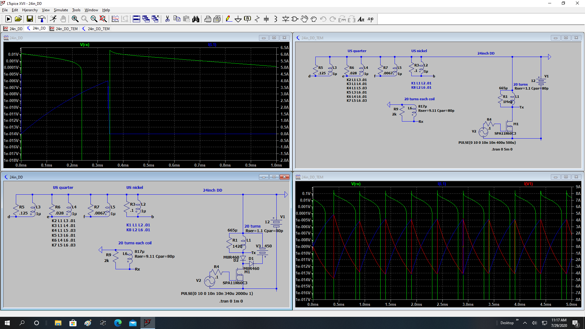

                            Added Rx coil to simulation. Looks like it would be worth trying with real circuit.
                              Changed 24in_DD normal PI to what I think is TEM? Looks good.
                                Interesting experiment.
                                This is not TEM. TEM recycles the Flyback power. This makes it more power efficient than traditional PI.
                                The side effect is that it becomes more VLF like. I have run it with up to 15 Amps peak current, (real circuit, real 6ft diameter coil, #10AWG wire) at high repetition rate, while consuming a fraction of what a traditional PI would consume.
