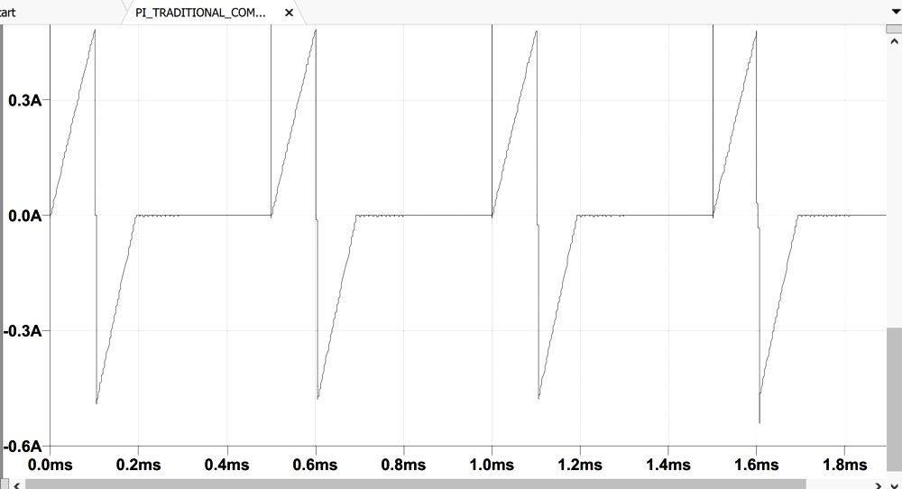

    Zero to 500mA, -500mA to zero. Both halves, increasing slope.
    I can agree with that.
    • #47
      Now I look at it from a different angle:
      During half of the cycle the current flows into the coil.
      The other half of the cycle the current flows out of the coil.
      • #48

                    • #55
                      Symmetrical TEM
                      Here is the current waveform tweaked a little bit to make it more symmetrical.
                      I separated the cycle with a long "dead period" to make the view easier to understand.
