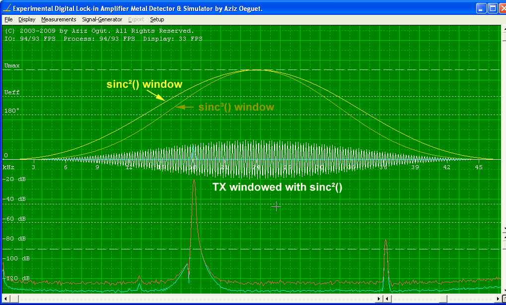

      Let's define the window w[n] for n = 0 .. N-1, where N = number of coefficients/samples in the window, usually a power of two due to efficient discrete FFT requirement.
      w[n] representing the factor coefficients of the window function.
      It is important, that the window function is symmetric and starting/ending (almost) with 0.
      w[0] = w[N-1] = (almost) 0
      The following window functions can be used:
      Hann window; B = 1.50
      http://upload.wikimedia.org/wikipedi...%28hann%29.png
      Tukey window, α=0.5; B=1.22
      http://upload.wikimedia.org/wikipedi...%3D_0.5%29.png
      Cosine window; B=1.23
      http://upload.wikimedia.org/wikipedi...%28sine%29.png
      Lanczos window (sinc window)
      http://upload.wikimedia.org/wikipedi...Lanczos%29.png
      and so on ... (Triangular, Gaussian, etc.. you see the analogy?)
      Further: sin²(), cos²(), sin³(), cos³(), sinc²(), sinc³() and others can also be used with right parameters of course.
      Any window function is convenient, which minimizes the spectral leakage.

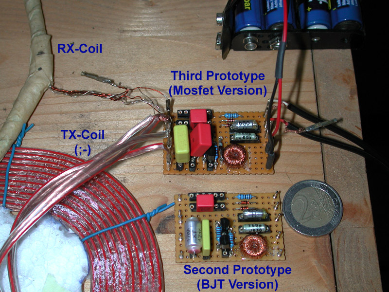

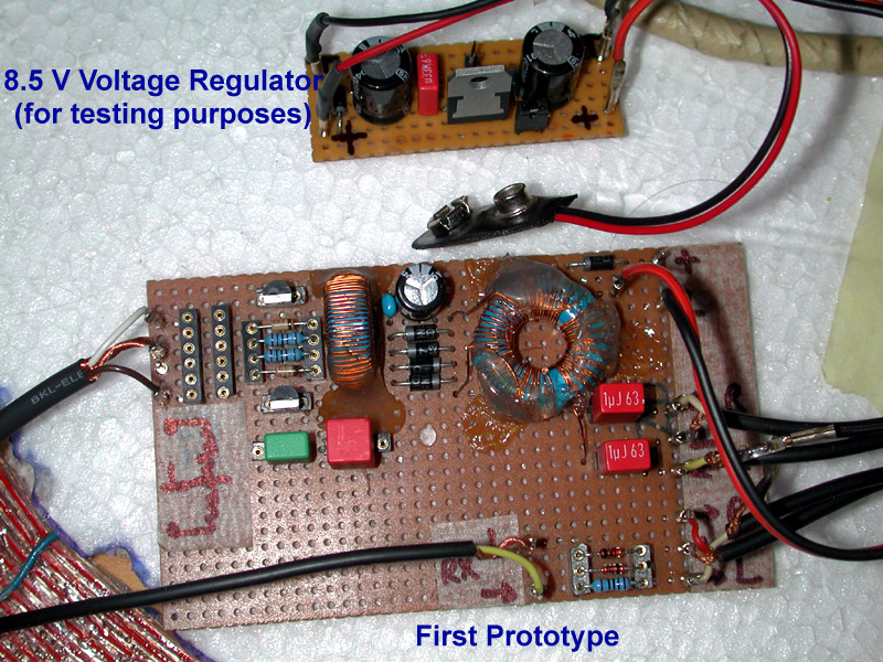

                • Pics of Prototypes
                  I haven't shielded my TX coil yet. And I haven't built the RX coil yet too. I've just put a RX coil I have found in a DD configuration.
                  Hey, that's it. That's all the electronics I'm using at the moment.
                  My previous prototype:
                  Cheers,
                  Aziz

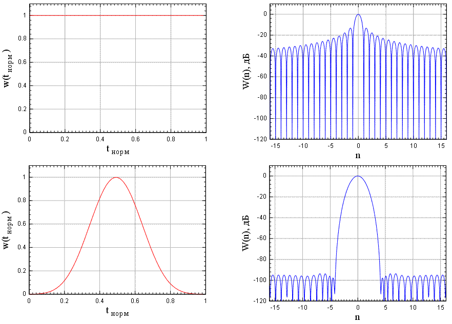

                          • (oscillator + FFT) - very bad signal detector
                            Optimal detector -> S(targets) = ∫ (Stx(t)*Srx(t)), technical realization – correlator
                            For the harmonic signal Stx(t) = A*sin(wt+ф) need to know instantaneous (t) value w, ф, A . Oscillator it does not provide. Assuming that A,w – known constant, we can use DFT as correlator, but you must take into account its features.
                            If, time integrating multiple of the period Tx, it is possible to choose the maximum number of samples to process. Otherwise - to apply smoothing function that limits the signal spectrum
                            In the figure: a rectangular function and Blackman–Nuttall window
                            • Originally posted by Sergey_P View Post
                              Hi Sergey,
                              thank you for writing some sentences now. I understand you this time.
                              Yep, windowing limits the signal spectrum but it makes different solution approaches possible. Even the pure FFT solution.
                              I didn't try all approaches. There might be more (maybe much more) potential for the detectors performance.
                              Cheers,
                              Aziz
                              • Hi all,
                                I haven't implemented all the window functions yet. But the sinc²() and sinc³() are working quite good (see below).
                                Cheers,
