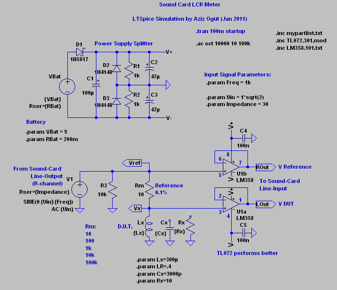

    I am thinking of to make one of those cheap sound-card RLC meters (impedance meter) rather than spending at least 100 EUR for an inductivity meter. I have found many interesting sources for this little project.

      We only have to do a nice complex math on a complex voltage divider. Should be really a trivial job.

        Hi all,
        I have built the small circuit of the sound card LCR meter (see below). It's really easy and cheap stuff. I have tested some available software for it. The only one, which works quite well is the Visual Analyzer software (see http://www.sillanumsoft.org/prod01.htm ) . You can forget all the other software stuff. Most of them did not run even. Others did not allow setting me the appropriate sound card device. None of them allowed a 24-bit/96 kHz sampling.

        • Ok,
          here is the theory behind the LCR meter:
          http://icom.hsr.ch/uploads/media/RLC_Meter_EN_01.pdf (english)
          http://icom.hsr.ch/uploads/media/RLC-Meter_DE.pdf (german)
          http://www.sillanumsoft.org/ZRLC.htm
