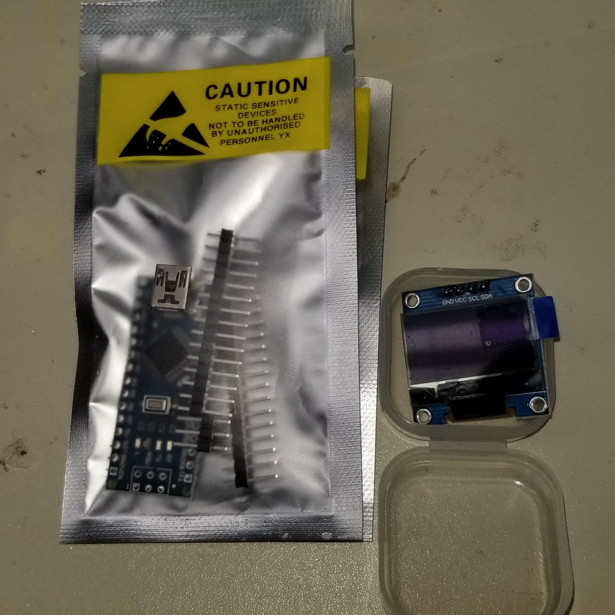

      I did read through the PDF a few days ago but needed time to search through my parts bin. I came up with an Arduino and a 0.96" OLED display.
      Is the adapter PCB available somewhere or do I need to upload the gerber to a service like PCBWay and buy 5 of them?

        DIY Detectors don't have the Nano adapter on offer -> https://diydetector.co.uk/store/index.php
        so you will need to upload the Gerbers.
        JLCPCB will turn them round very quickly.
