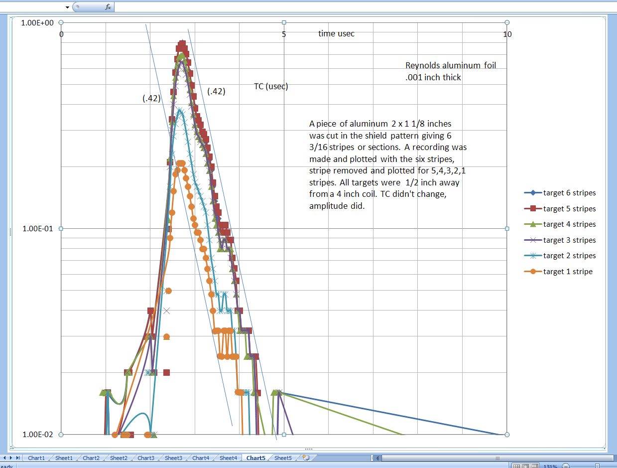

              Not suggesting aluminum foil is the way to go. A plot showing why I think it didn't change the 9 inch coil sensitivity. First image is a 2x2 inch piece of aluminum foil not cut and cut in a pattern shown in second image The cut foil has a TC of .4usec vs 3usec for the not cut.
              Fascinating result from just cutting! It is always important to specify the thickness of the foil as this has the largest effect on T/C. Do you know how thick it is?
              It would be interesting to see how a piece of foil at a specified thickness, cut as you describe, and long enough to do your 9" coil comes out on the T/C test. We know that long rectangular strips do have an effect of increasing T/C in addition to the thickness per our discussion in the Target Time Constants thread. It would be interesting to compare one with the cuts versus one without the cuts.
              Good Stuff!
              Dan
              • #52
                It was regular Reynolds aluminum foil. All I have is a vernier calipers. I folded a piece a few times and measured it to be about .001. Not sure how to measure a piece that long but a will try some different length pieces. Maybe some with more cuts/inch. Was looking at my copy of ITMD and saw a section on cutting targets. Might be where I got the idea to cut the foil.

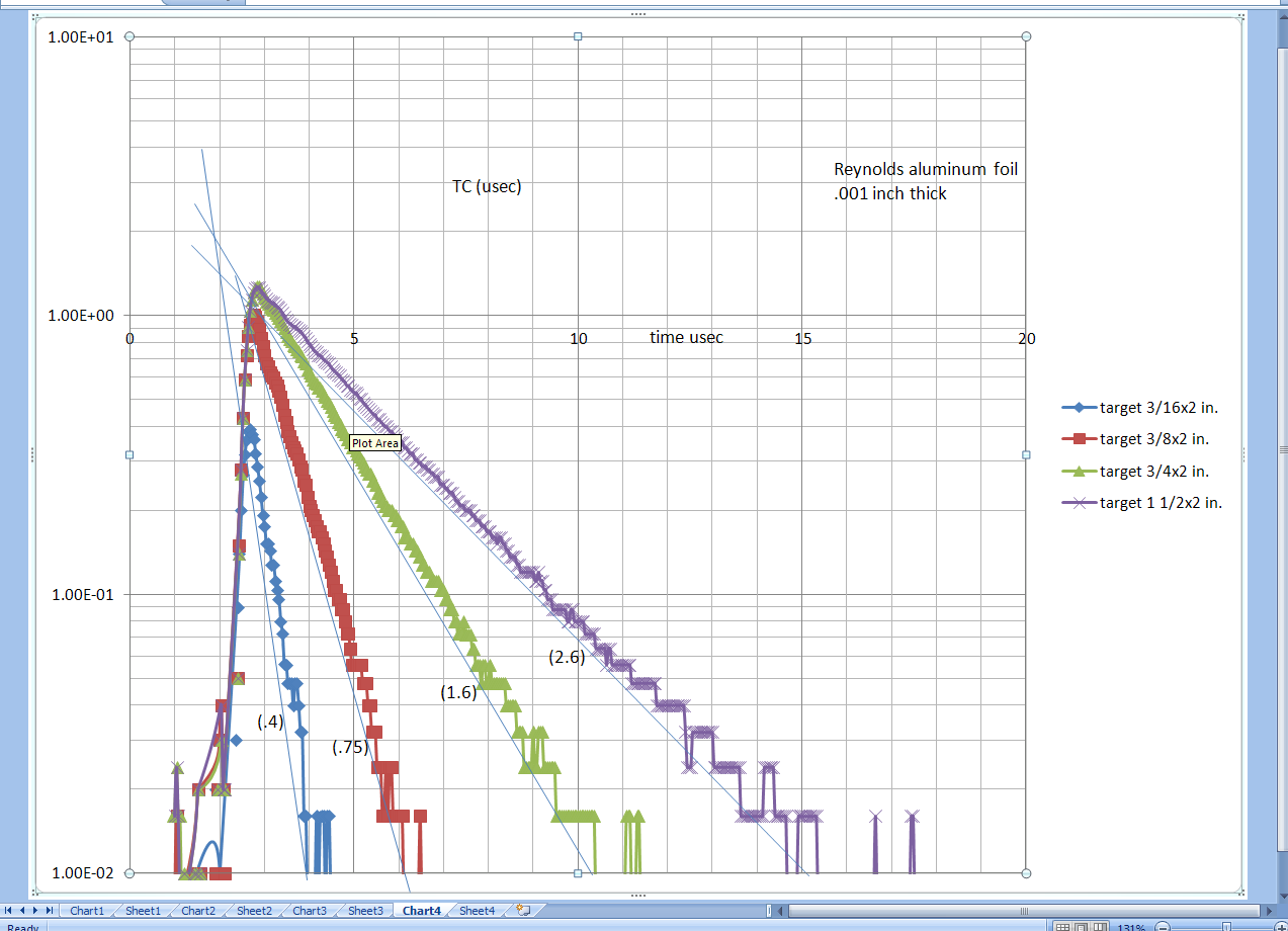

                      Another plot. Cut four pieces, 3/16 x 2, 3/8 x 2, 3/4 x 2, 3/2 x 2 inches. The 3/16 x 2 measured the same TC as the 2 x 2 inch piece cut in a 3/16 pattern. I'll try a longer cut piece the next time I cut one
                      • #56
                        Another plot that I think shows pattern length might not make a difference.
