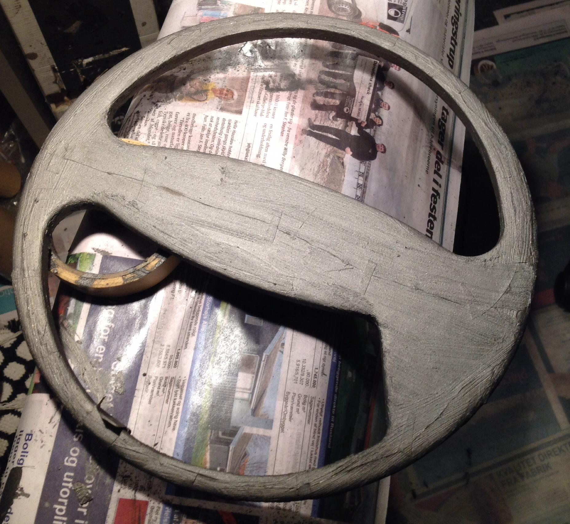

                  Just working on a experiment... Velox one coil. Want to try a shielding at this wet grass problem coil outside. Found the connection to the inside shielding. It went to the cold side at the RX. Made some outside drainwires and to hold them, used som small piece of tape.
                  Then I made the mix with only powder and this alcohol I got... One hour paint with the brush, it was difficult to keep the mixture wet to keep a thin lay. Now I got to much and the resistance is down to 150-200 lowest. Tomorrow I will sand it or find a way to get a thinner lay.. Goal is 3-500 ohm, like I did at my sussecfull 7" Deus coil. Before the protecting lack, I will go out a do some test...
                  If this wouldn't help anything, It can Be taken off easy.
                  Picture shows the mixture is drying up.
                  Henrik.
