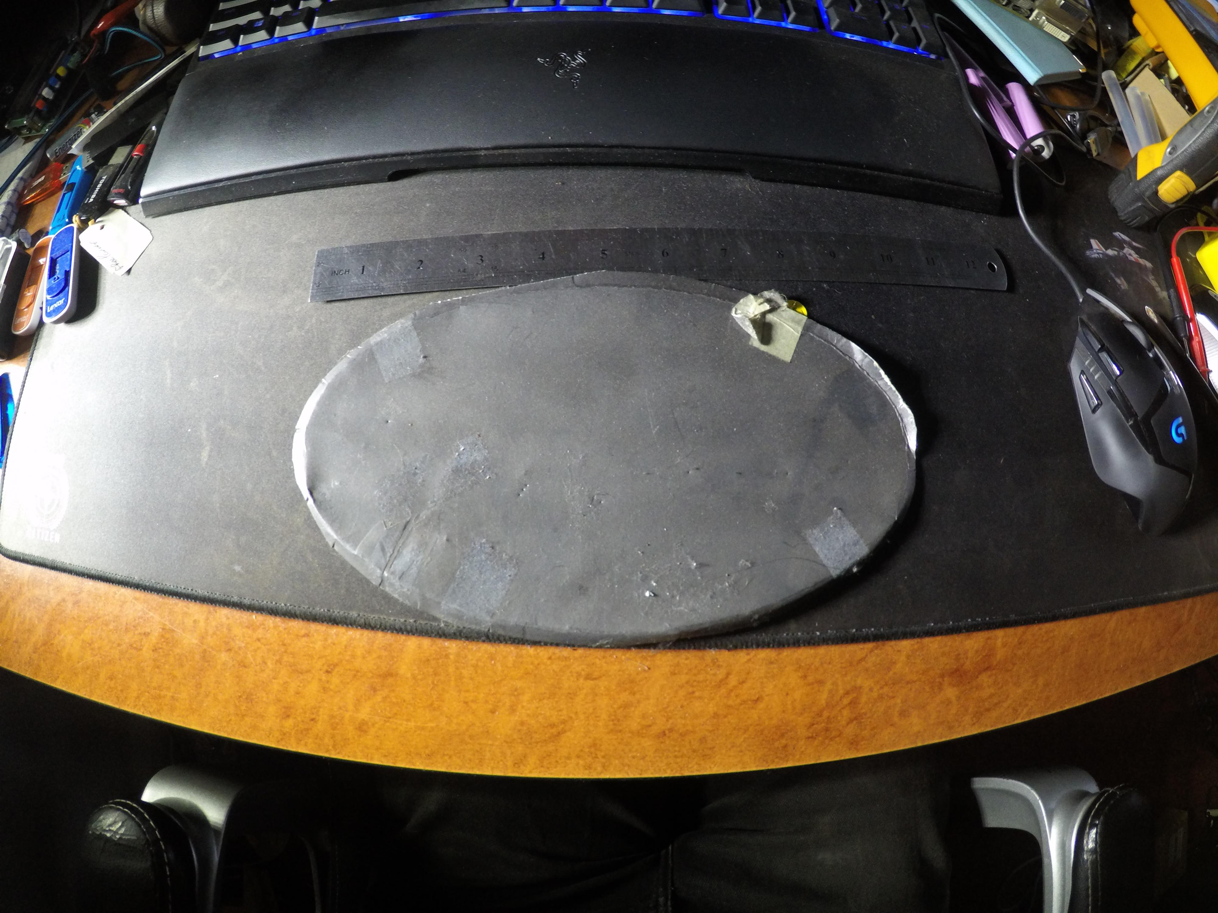

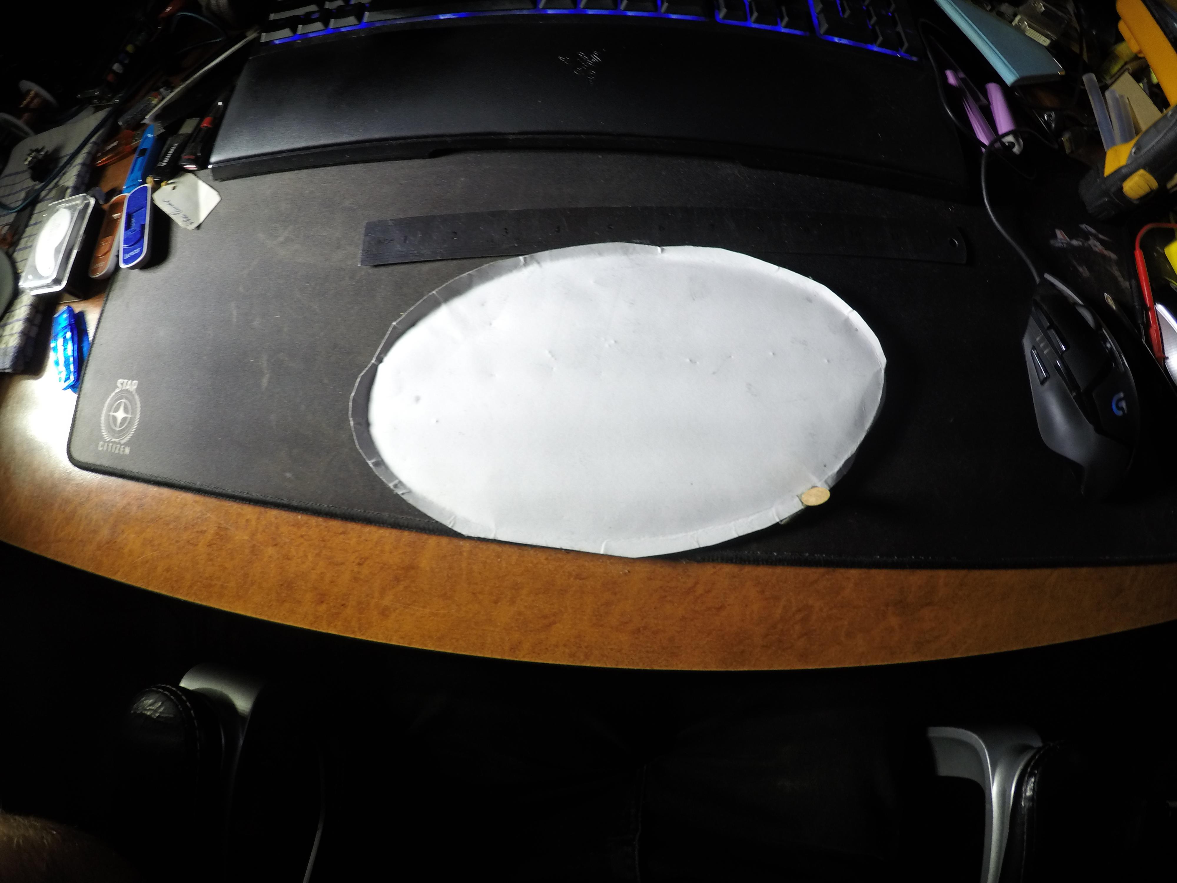

        1.5Kohm per centimeter is what you want. https://www.youtube.com/watch?v=XnrStRklcUQ
        look from 3.00 minutes where he says 1.5kohm per centimeter.
          What mixture of graphite will give 1.5Kohm per square centimeter is for experimentation, if you are mixing your own.
            measure a shielded piece from a xt17000 minelab and it read600ohms at 1 inch at the full length of cardboard it read650 ohms
ID:	350206Click image for larger version
            Hope that helps
            for got to say that this is a vlf detector wether that makes a differents or not with the shielding between vlf or pi detectors
