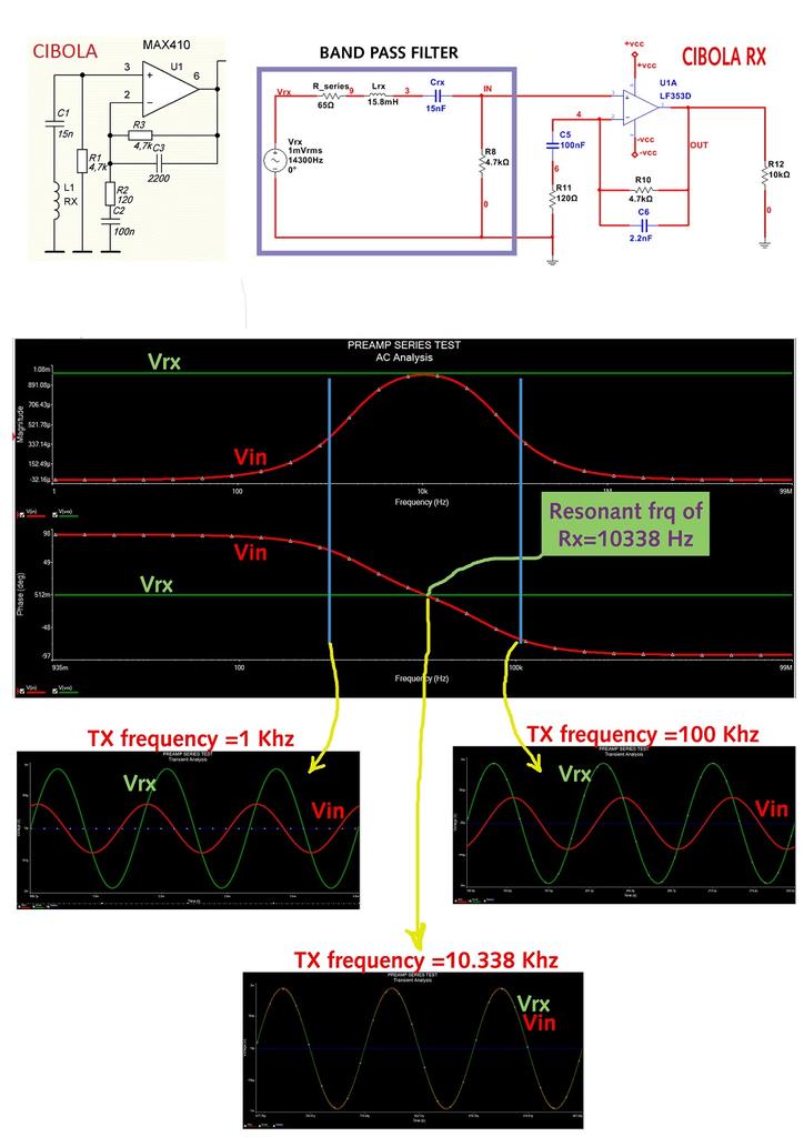

    The 7 degrees phase shift in your plot is due to the LCR8 effect on Vrx.
      Maybe when Rx resonant frequency is different from the tx freq., The Rx coil and cap act as a band filter(or high pass or low pass), resulting in a phase shift of Vin. The amount of phase shift dependent on the difference between the TX freq. and the cut off freq. of the filter.

        Two coils tuned "off" resonance with respect to one another, behave in effect like a filter , this incurres a phase shift of the received signal. If the Rx resonant frequency is higher than TX, then this would be low pass filter, causing a negative phase shift and vice versa.
        I'm just postulating here, not sure.
        In series resonant Rx, what you have is high pass filter, so the tx frequency would be above Rx resonance. The advantages of this are obvious. Better discrimination, less interference from emi, better ground balance capabilities.

          Your explanation for the cause of the phase difference between Vin and Vrx is entirely correct, but the point is, why is the reason for choosing these values of Lrx and Crx at this resonant frequency of the receiver?
          And why is the higher resonance frequency of the transmitter Tx not selected and what is its effect?

              But I think it's not like that, and in fact it's a Band pass filter circuit, which I've plotted on.
              As can be seen, at TX frequencies below the resonance frequency, RX 10338HZ is more like the LOW PASS circuit and reduces the amplitude of the output voltage Vin
              And also caused the signal to retard the Vin signal relative to the Vrx signal
              And at higher frequencies than the resonance Rx, this phase difference is reversed.
              Regarding the diagram and shape of the received signal amplitude, there is no difference in the choice of the sender Tx frequency higher or lower than the resonant frequency of the receiver.
              But this choice of frequency is higher or lower than the resonance frequency Rx in the phase difference between Vrx and Vin, which is positive or negative.
              In fact, in the Cibola circuit, selecting the sender frequency above the RX receiver has caused the Vin signal to retard to Vrx.

                  The point I tried to make is that when both Rx and TX are at same resonance, in other words two identical coils of same inductance and tune capacitor, and when they are at balance( nulled), their is no phase shift of the received signal( or negligible phase shift). Both Rx and TX are in phase with each other.
                  However when Rx and TX are at different resonant frequency, there is phase shifting. I am not math guru, but I am sure that the amount of phase shift can be precisely calculated. The variables would be inductance, resistance and capacitance of Rx and TX, along with the wavelength of the tx signal.

                        I did my own test with a TGSL device, which is parallel resonance type and I saw it by changing the Rx capacitor(Increase or decrease) This will cause the resonance frequency of the receiver Get away from transmitter frequency And this lowers the sensitivity and depth of the device But the stability of the device was increased by the distance between transmitter and receiver frequencies.
                        I have not worked on the IDX project to have accurate information about it, but with regard to the receiver, the parallel resonance is almost close to the TGSL response, and both structures are parallel, such as Raptor project.
                        In the IDX device, the transmitter frequency is 6600 Hz and the resonance frequency of the receiver is 4650 Hz, which I have shown in the simulation and diagram below.
                        Now pay attention to the frequency response and the phase of this circuit.
                        As seen, the frequency of the Tx is far from the frequency of the Rx, and in fact the Tx frequency is where the variation of the amplitude and phase is very low.
                        If the transmitter frequency approaches the resonant frequency of the receiver, it will increase the amplitude and phase changes of the received signal in the receiver, and in fact, we will see a higher sensitivity, but I think the probability of the oscillation of the device will increase.
                        All of the above is merely a review of the behavior of the receiver's part of the circuit and does not mention the effect of the loop type and how it is nulled.
                        In fact, all of the above explanations are based on the assumption that the loop is properly nullified
