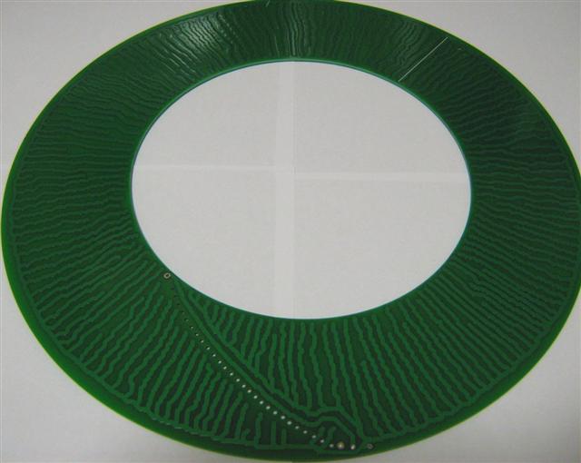

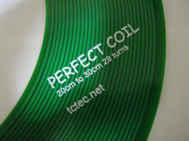

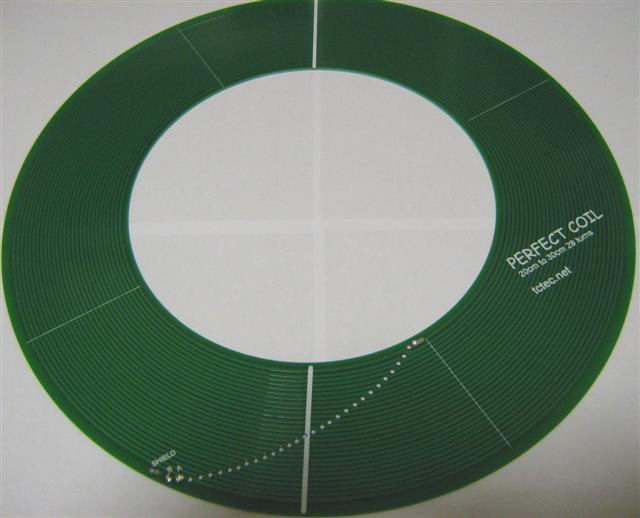

                      Ok here it is, a pcb coil
                      Ok here is the PCB coil.
                      It seems pretty good.
                      It turned out very close to calculations for a spiral coil.
                      Inductance = 310 uH (using oscillations when in parallel with 1uF capacitor)
                      Resistance = 4.7 ohms
                      Capacitance to shield 2.5nF
                      The physical dimensions:
                      20cm inner, 30cm outer (5mm fatter on one side than the other, due to minor variation)
                      Copper thickness = 2oz , required to get the low resistance.
                      28 turns, 1.4mm wide track.
                      Made using circle shapes then breaking them with a drill hole and connecting them.
                      Note the shielding:
                      It is fingers of copper, giving capacitance, but confounding to eddy currents similar to slotted al foil.
                      * It is broken at one end (does not make a full current loop of course)
                      Testing:
                      on my pi, without changing the damping resistor (335 ohm) a nice shaped discharge curve starting at about 20uSec (after amplifier curve, i.e the curve looks good, as fast as the bundle coils I made)
                      At the beach:
                      shielding worked (minimal effect when move up and down on wet sand).
                      *Very touchy when edge is dug in to sand, or sand gets on top.
                      This is due to I believe the close contact between sand and coil and will be solved by SPACING, a buffer around the coil to put space between it and the capacitive/conductive sand resting on top and edges...
                      Depth is as good (or better) than my hand wound coil !
                      It is very light, and consistent (symmetrical and 'clean' on targets)
                      (I found four targets: bobby pin, AU 20c piece, Au $1 coin, bottle cap)
                      Pretty good for first version (version a) !

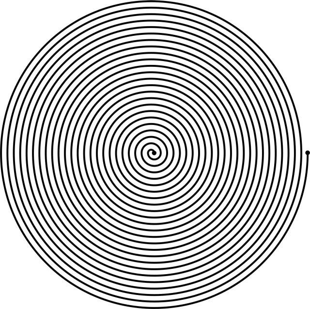

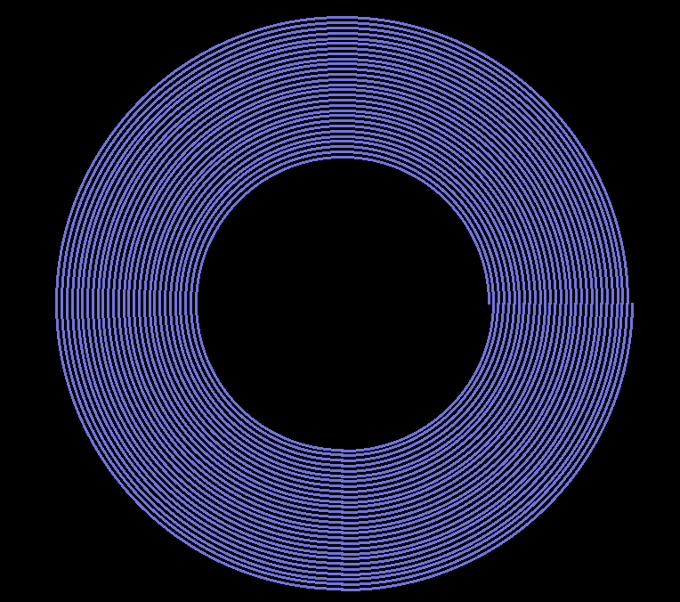

                        Instead of making the coil with circle shapes, you could use a spiral.
                        Here's an example I've created using Easy-PC (Gerber file attached).
                        28 turns, 60 thou tracks with 80 thou spacing.
                        The image looks somewhat coarse, as it was taken from a screenshot. However, the Gerber file is completely smooth.
                          Thanks,
                          Spiral is nicer, if Easy PC does a spiral, then I might have to use that.
                          If I change to spiral, it shouldn't change the specs, maybe make it a bit better (symmetrical)
