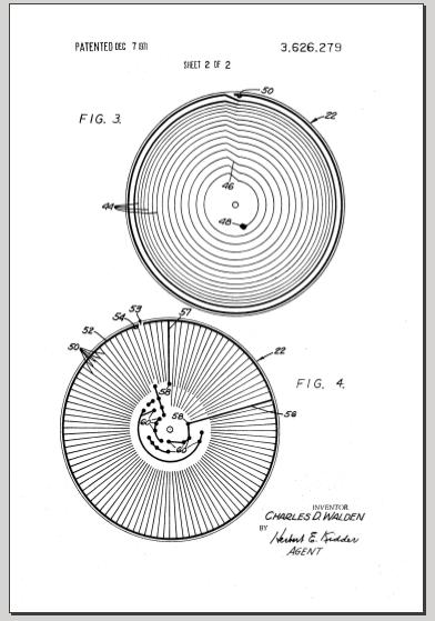

      Only as interesting info: coil proposed in this topic here was invented more than 40 years ago:
        WM6,
        Thats interesting, I could not enlarge the image? Maybe upload again? Tesla was using spiral coils a 100 years ago.

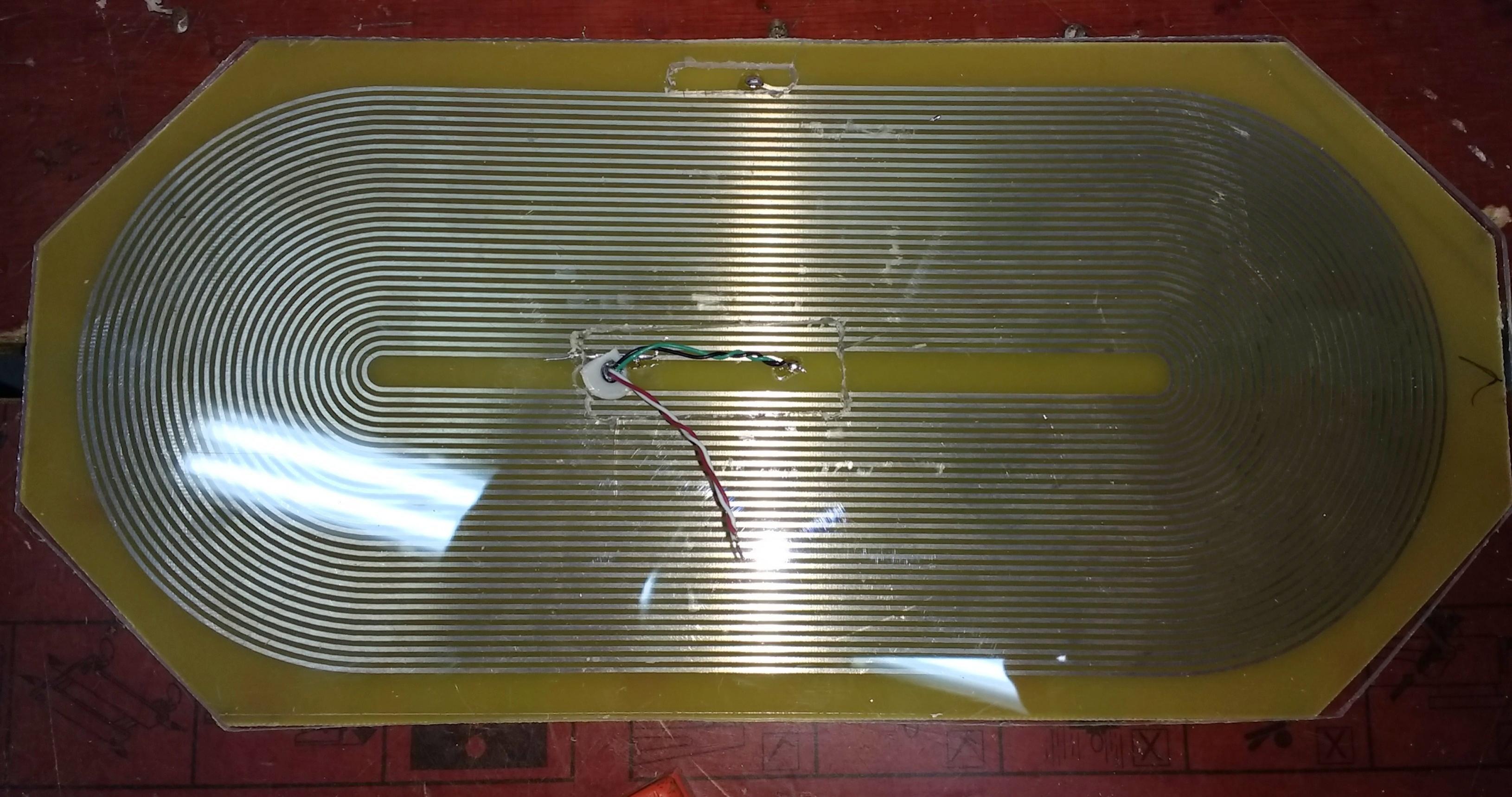

          Sorry for bad resolution. This was due to JPEG format - need to be renamed in JPG.
          This was PCB spiral and PCB shielding.

              That patent is awesome I think the inventor knew his stuff.
              He has the spirals becoming more dense towards the outer edge, interesting.
                Good noticed.
                  BTW, this is to keep the shielding to coil capacitance density constant. No rocket science.

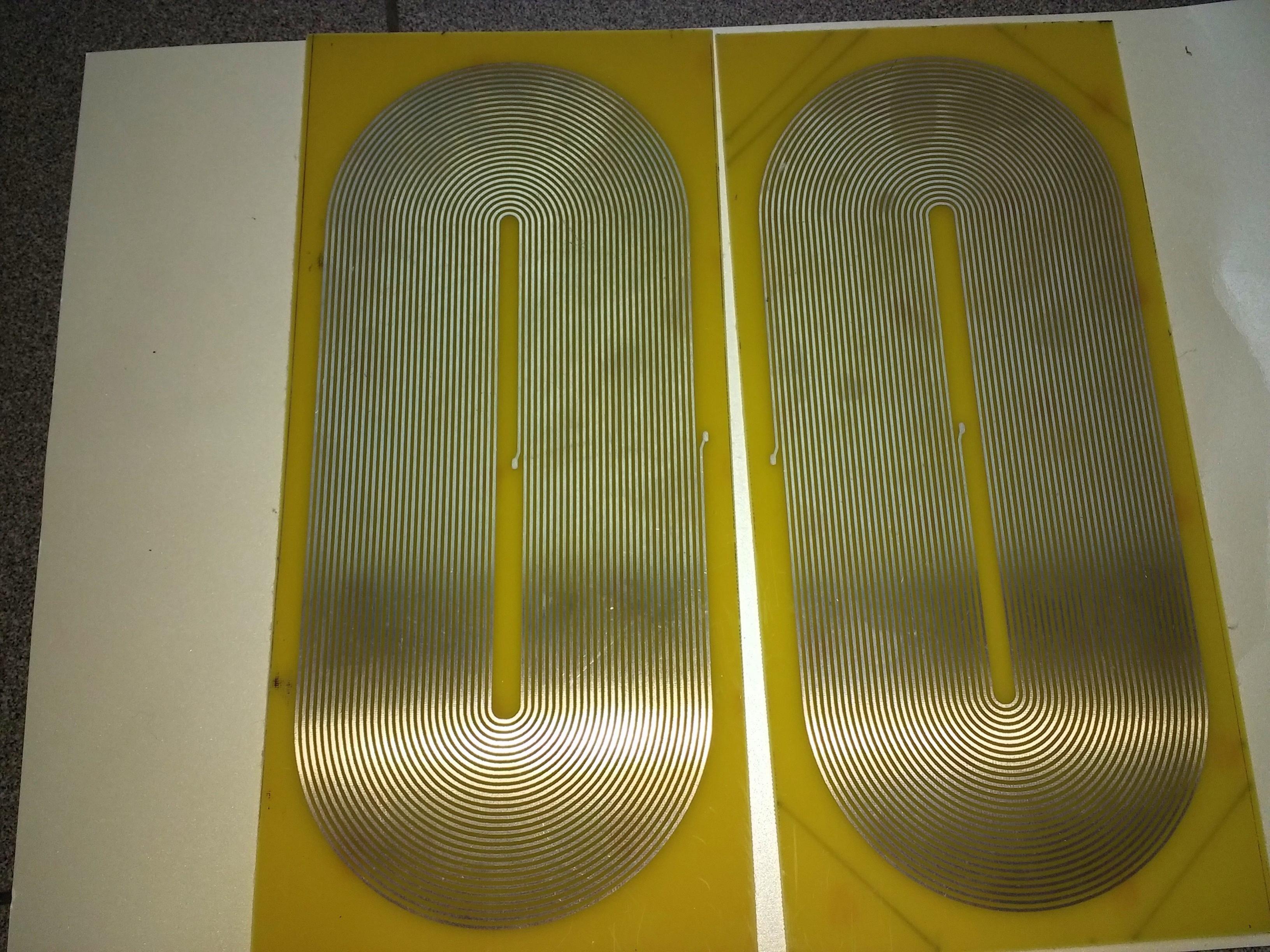

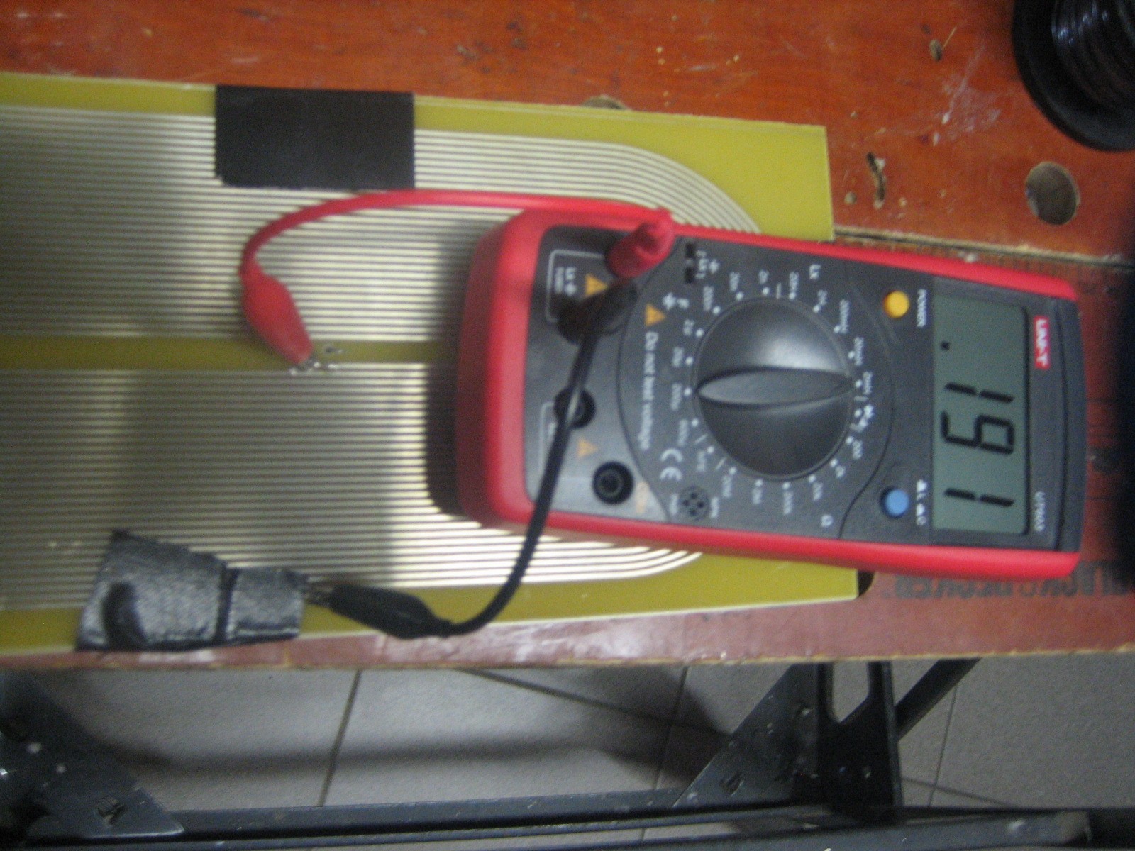

                      I had 4 of these PCB coils on the shelf for a couple of years now.
                      Finally had some time during the holidays to turn them into a search coil prototype.
                      The layout was published here by George : http://www.geotech1.com/forums/attac...5&d=1337436177
                      A single PCB coil measured 191 microHenry

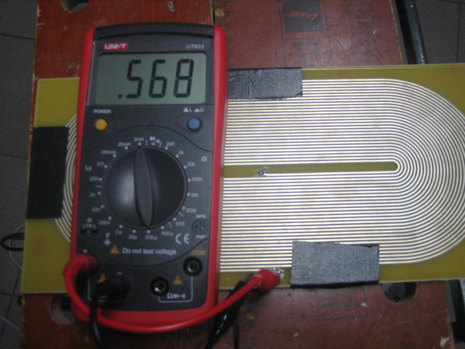

                      2 of these in series and stacked on top of each other measured 568 microHenry = 3 times the single inductance due to mutual inductance.

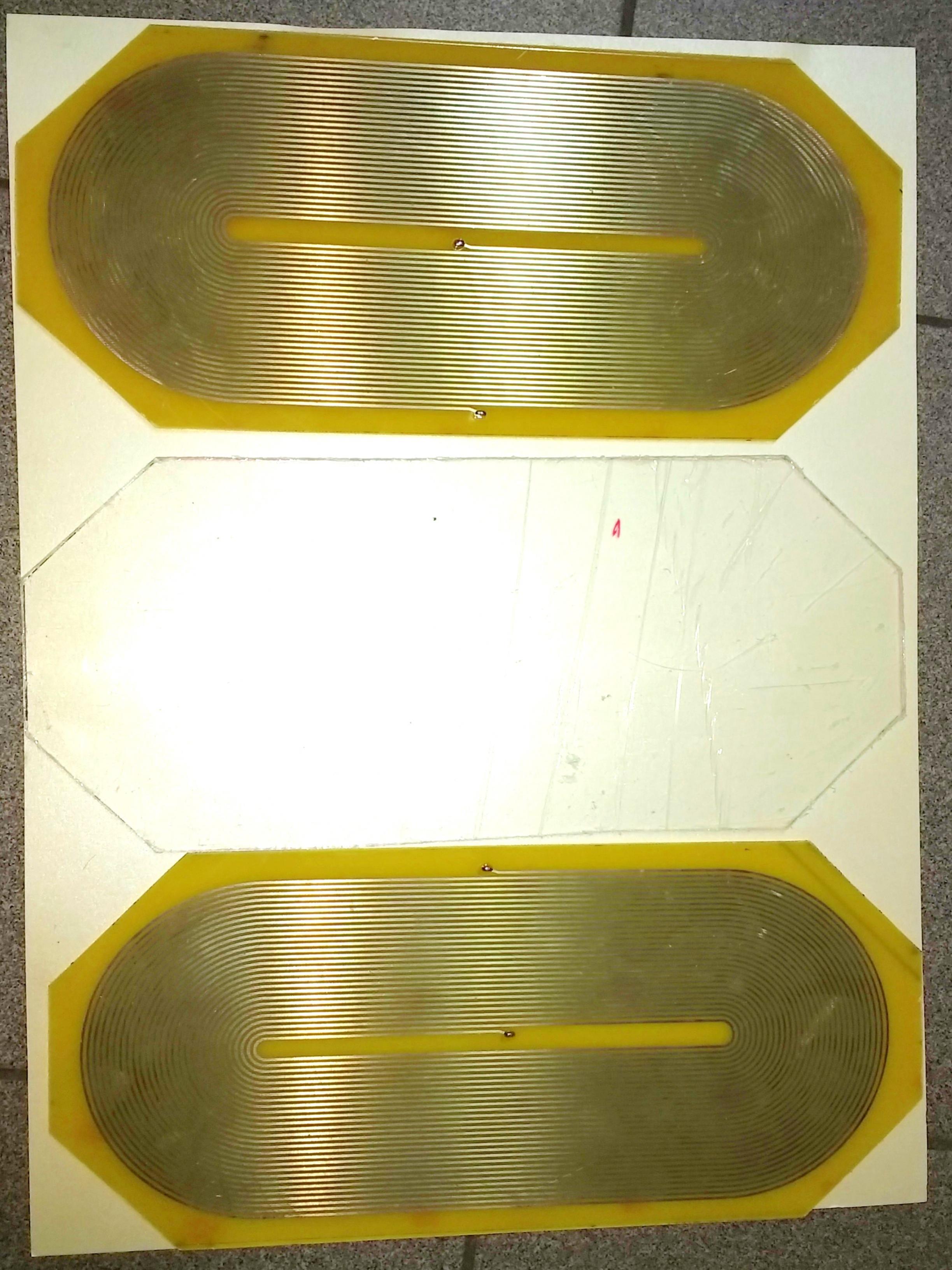

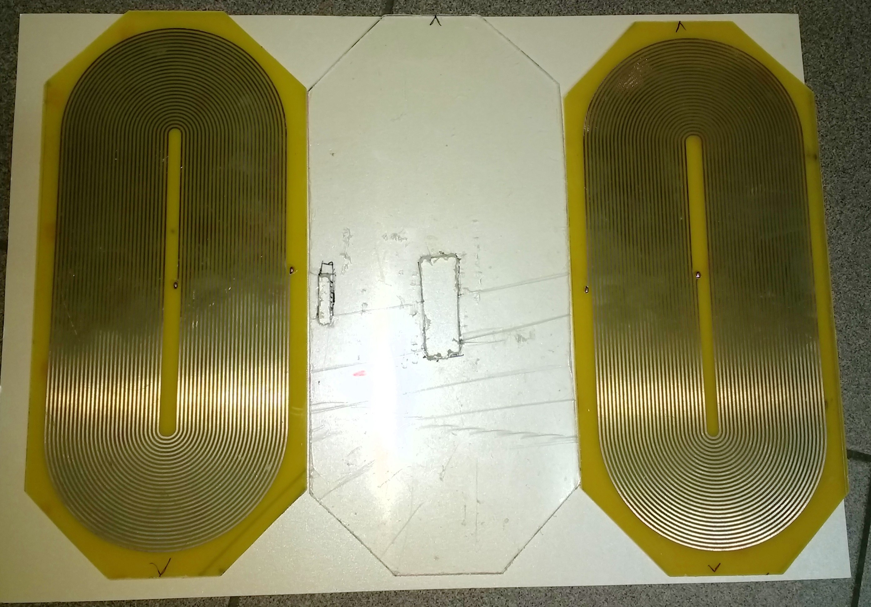

                      To turn this into a practical search coil, I turned both PCBs facing each other - with the traces at the inside and the epoxy PCB bottom at the outside, with a piece of plexi glass in between as separator/insulator.
                      I cut some holes in the plexi plate for the inter PCB connection - at the outer side of the coil - and the cable connections = the 2 inner connection points of the PCB.
                      The 3 layers are glued together.

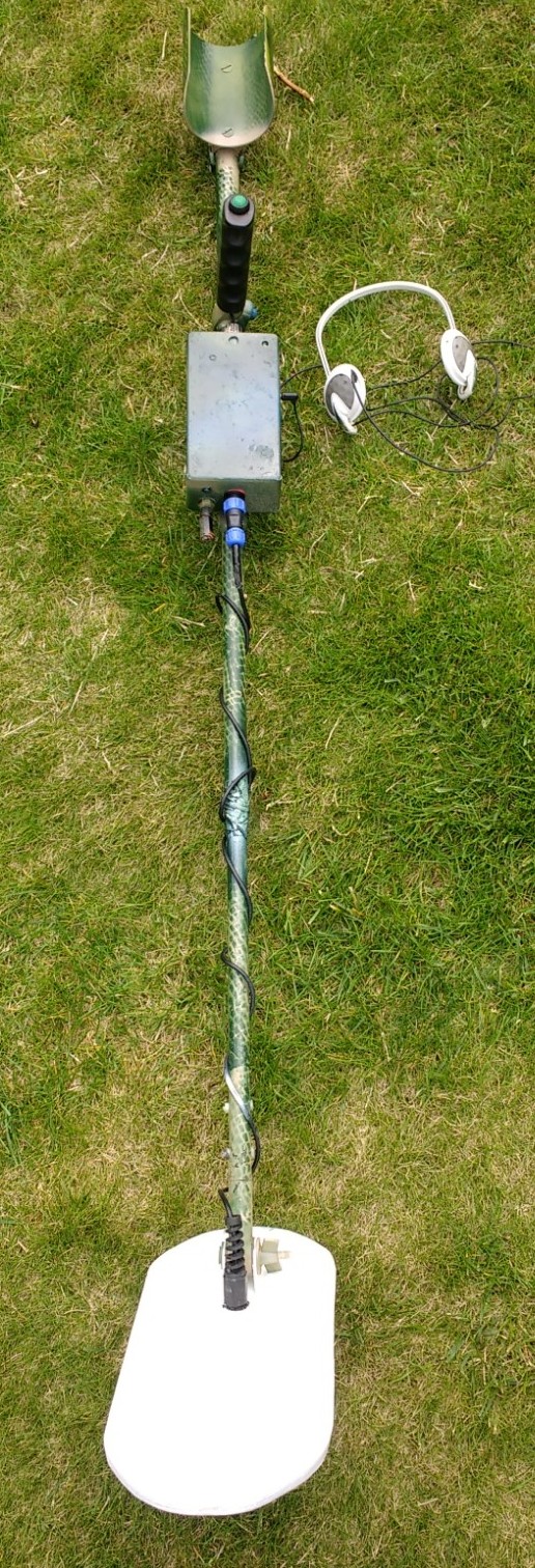

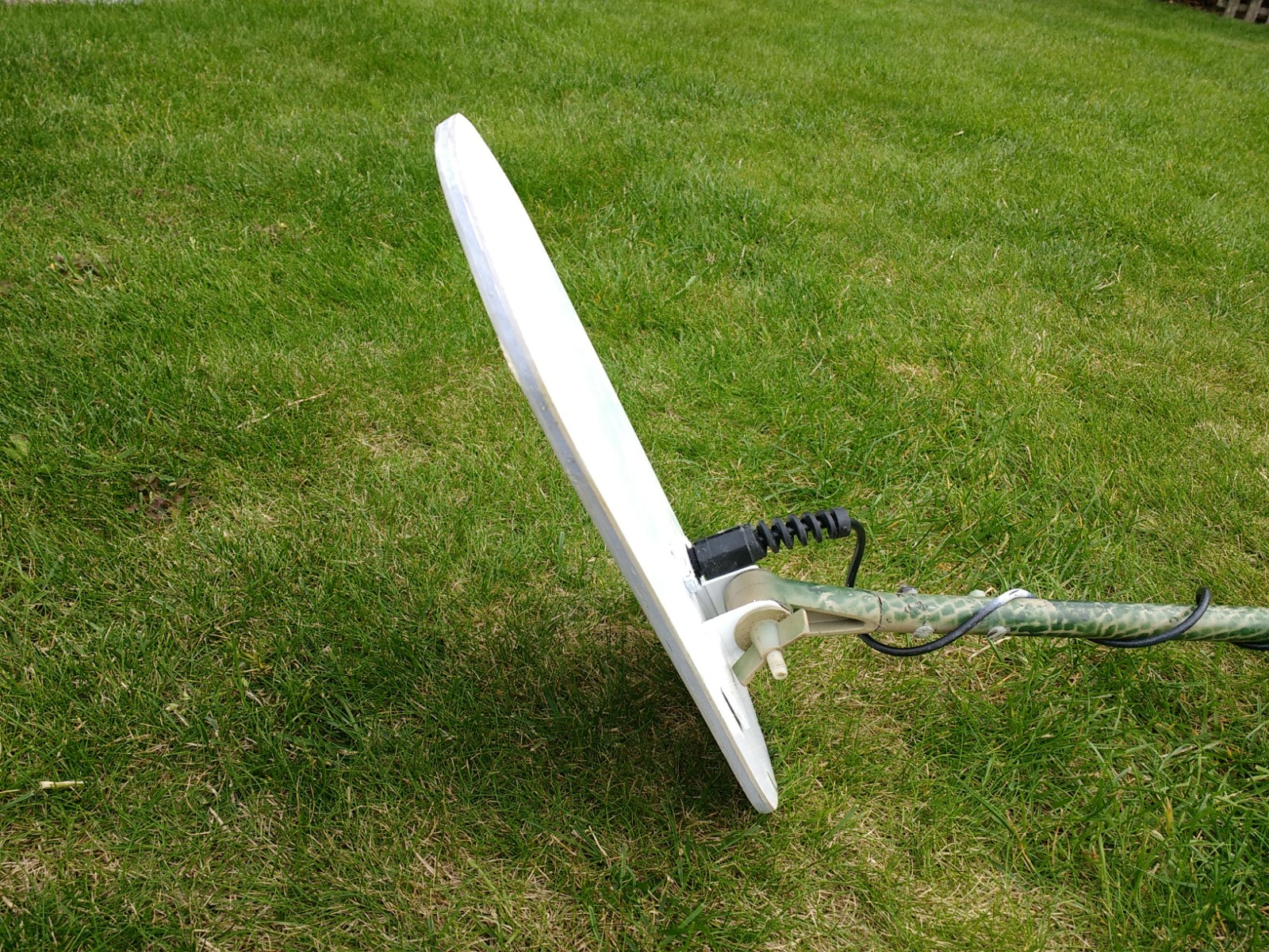

                      Shaved the edges smooth, glued a couple of ears on, painted it with primer and mounted on my Pickini V4.
                      PickiniV4 current: 45 mA as opposed to 135 mA with the normal round bundle coil.
                      Feels very light compared to the normal round coil I use.
                      Very aerodynamic - if this is even a coil property.
                      Sensitivity is somewhat less than my normal round coil - which is also a bigger diameter.
                      Less chatter inside the house.
                      Still finds a 1 Euro coin at 20-25 cm, which is OK to me for beach hunting. I don't want to dig any deeper anyway.
