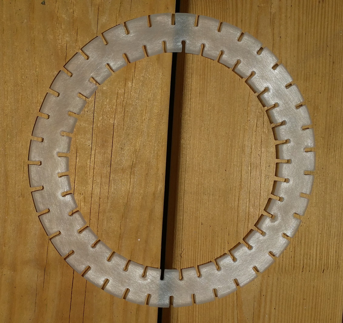

    5/16".
    5/16" is .312" and 24awg 600 volt PTFE insulated wire has a diameter of .042". With 30 turns of wire around your form there will be 6 wires crossing each other in each of the slots. I was concerned that the slots could hold the depth of 6 wires. So 6 X .042 = .252" and that easily fits in your .312" slots. In fact the slots could handle 7 wires each or 35 turns around the form.
    No worries!
    Dan
    • I decided to remake my coil frame to Dan's dimensions after all. I trust Dan's experience and I'd rather recut it now before I go any further. Click image for larger version
Name:	coil template 2.jpg

          On my coils with the 8" round or for that matter any 1" wide coil form configuration I've decided that 1/4" of space should be the minimum from the deepest point between the inner slots and the outer slots. This way there is little proximity or parallelism between the first 5 windings and successive windings.
          Best of luck!
          Dan

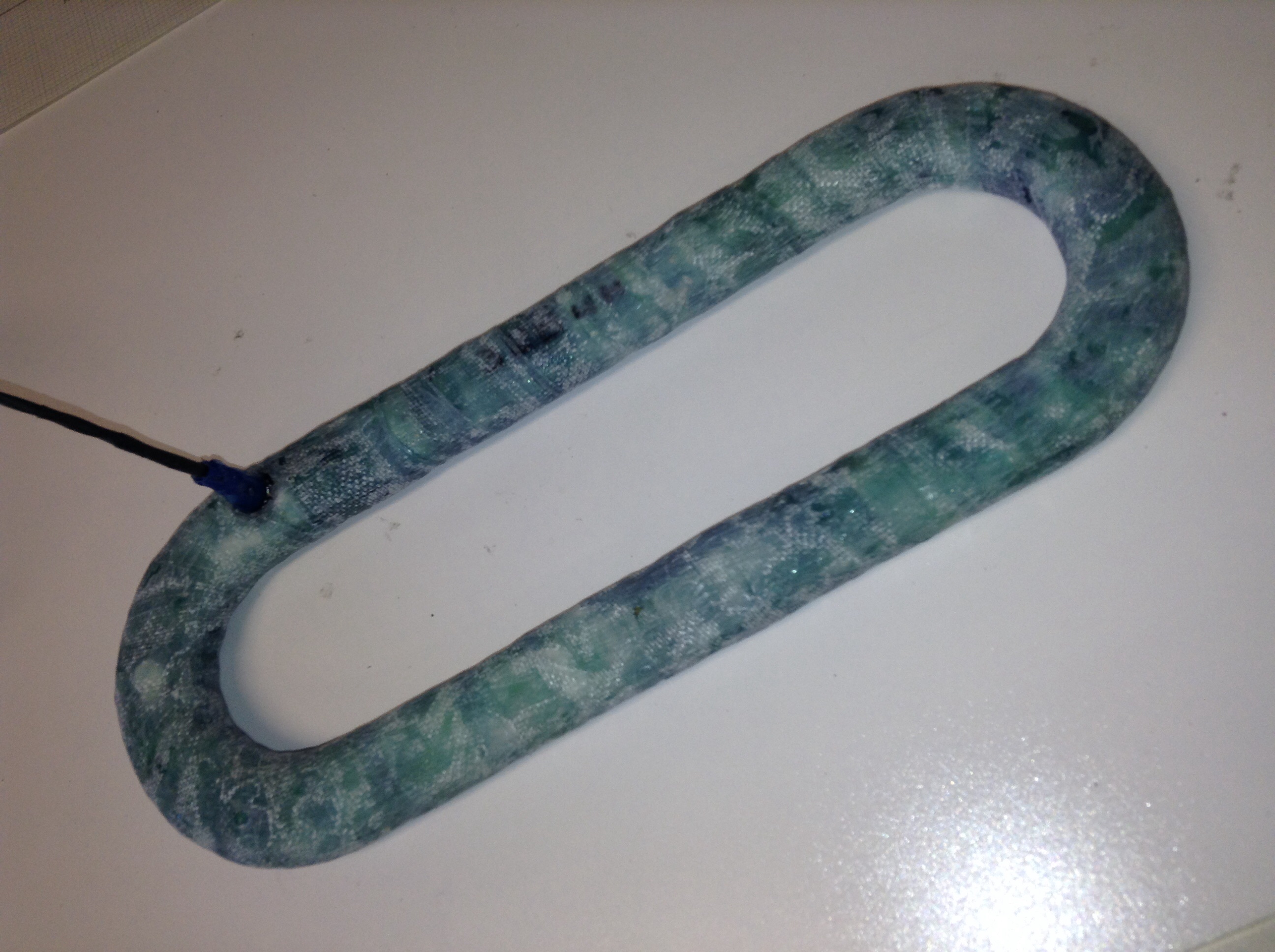

                            • Attached below is a photo of the first fiberglass layer being applied to the 'racetrack' style of coil. This coil is wound in what is properly known as a '3D Coil' according to some old crystal radio antenna references. For our purposes it also has the advantage of a pretty good degree of self - shielding. For this reason I will refer to this type of coil wind as a '3DSS' weather a circular, elliptical, oval, square or any other shape so long as it is wound in the unique geometry of the coils in this thread. This should eliminate the confusion of calling it a spider coil or a basketweave coil, neither of which exhibit any self shielding.
                              The attached photo shows the 1 1/2" wide fiberglass mesh strip applied with about a 33% overlap.
                              Dan

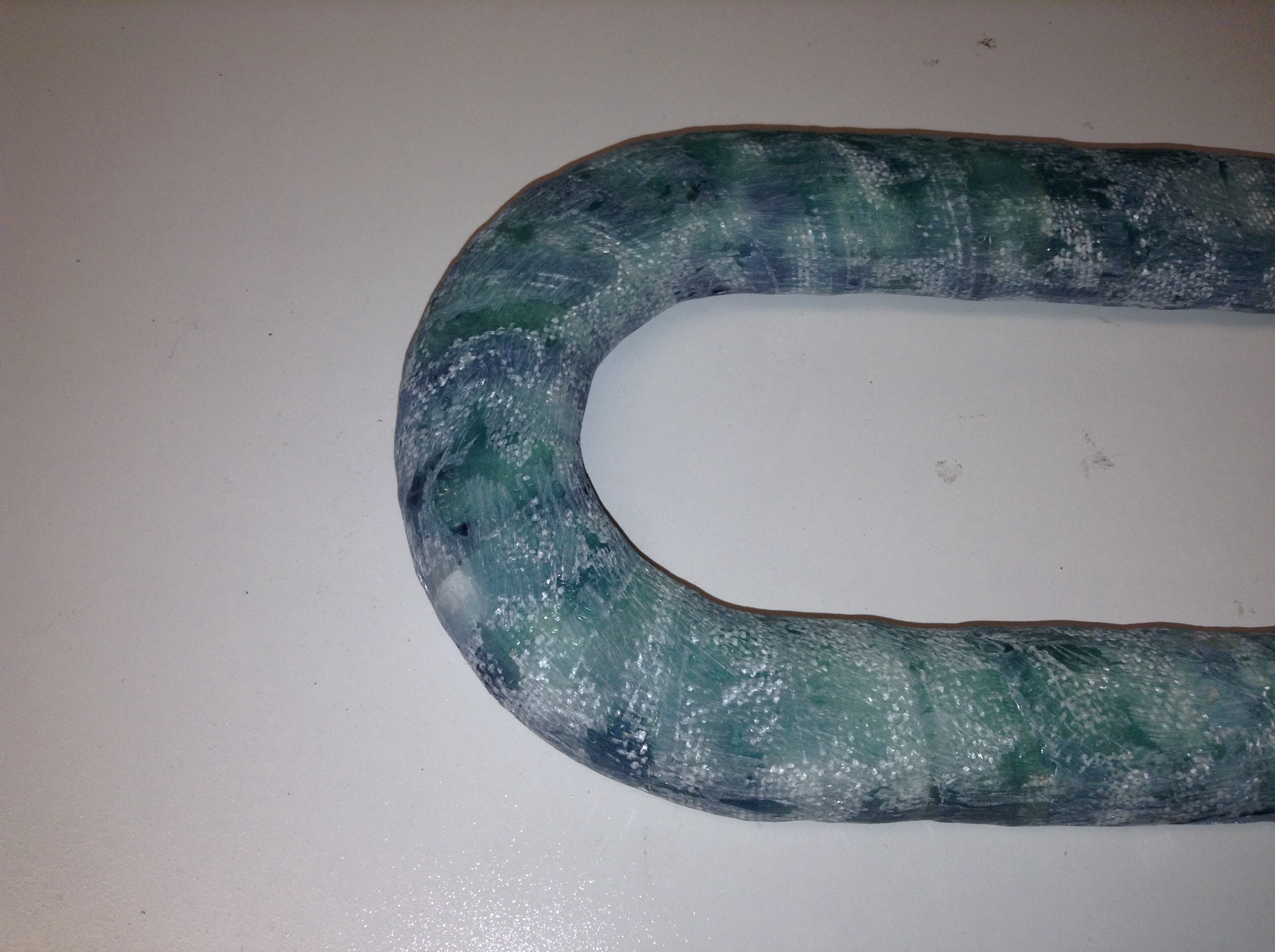

                              • After the first layer of fiberglass has cured the whiskers are removed using a Dremel tool and a sanding drum at the lowest speed possible.
