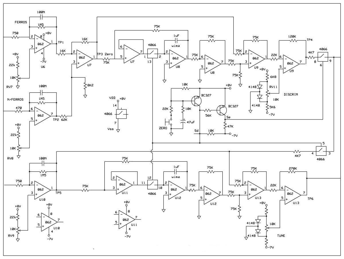

  • Regarding #158, 4066 is a bilateral switch, so pins 8&9 are interchangeable. Same with pins 3&4.
    Offset potentiometers of 10k (RV7,8,9) are originally connected with a single resistor of 22k, which is the same as if each of them is connected with it's own resistor of 68k. The schematic you refer to has 22k resistors in series with 10k potentiometers. It means that in comparison with Georgi's schematic it will be 3 times more coarse, and you'll find good positions on the lower end of potentiometers, not in a middle. However, functionality will be the same. If you find it difficult to adjust, just replace 22k resistors with 68k.

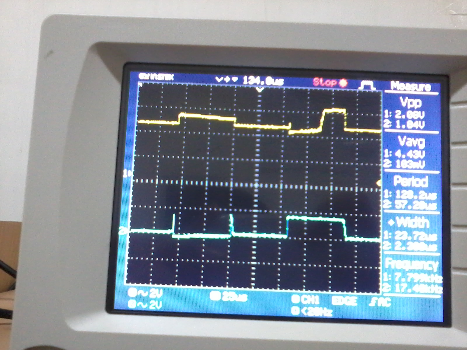

        ok i measure by 2 channel forins 11, 14,pins 10, 15,pins 9, 4

        Well, could you find U4 pin-16, because that is what I wanted. IS it that hard to understand?
        Reread my post.
        What I was trying to get you to do is put ch1 scope probe on u4 "A" input (U4-11, that's U4 pin-11) and ch2 probe on "X" output (U4-14).
        Do the same for B and Y
        Do the same for C and Z.
        Those DUAL TRACE pictures could be meaningful, and very much more so, if you will adjust the scope to show us TWO (2) cycles of the signals.
        And then, check with multimeter (or scope is better) and make sure you have +8V on U4 pin-16, and make sure you have -7V on U4-8 ( that's U4 pin-8 ).
        I should not have expected you to know it before, but now you know my code. I like to save my fingers from unnecessary typing whenever I can.

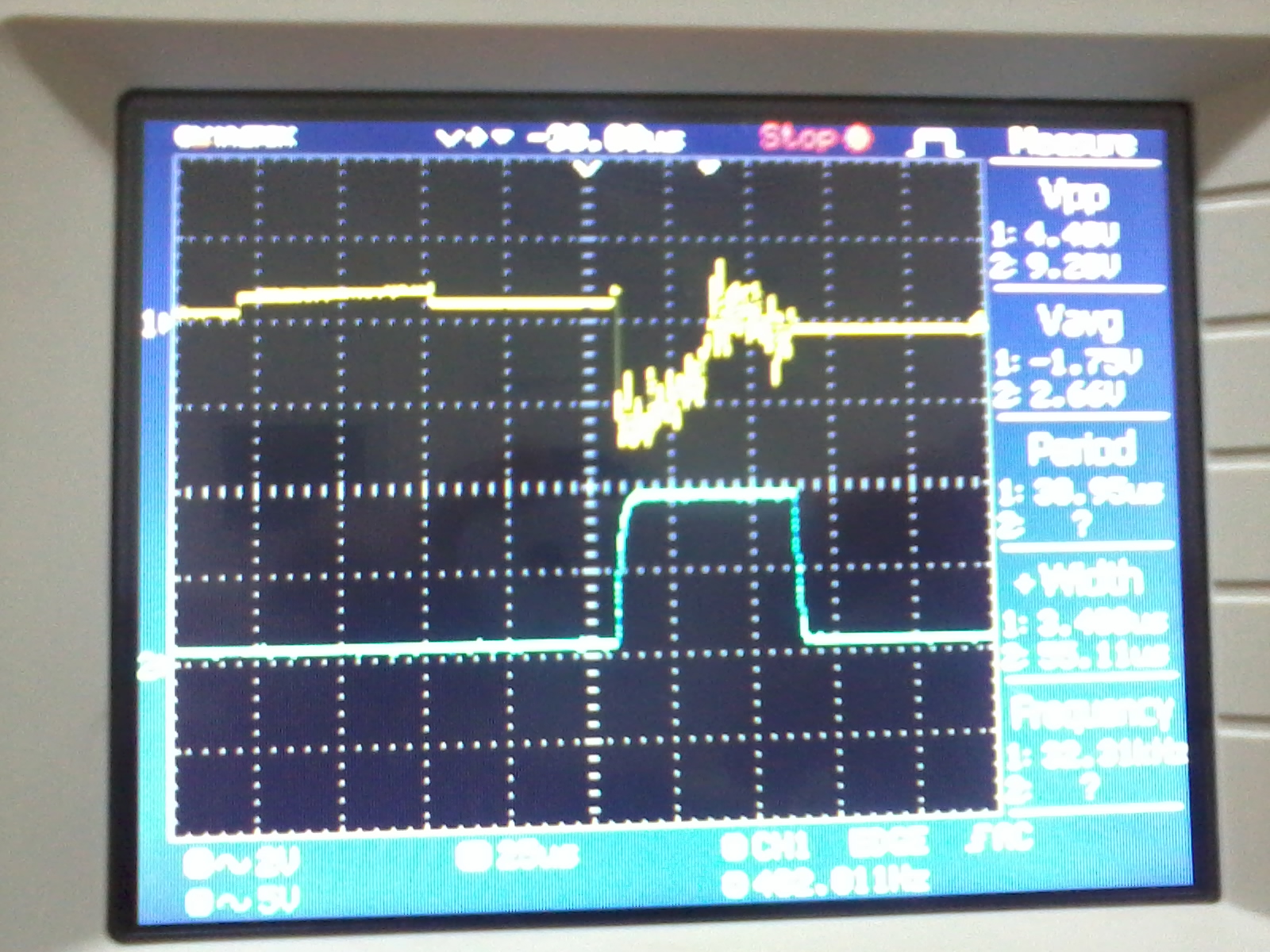

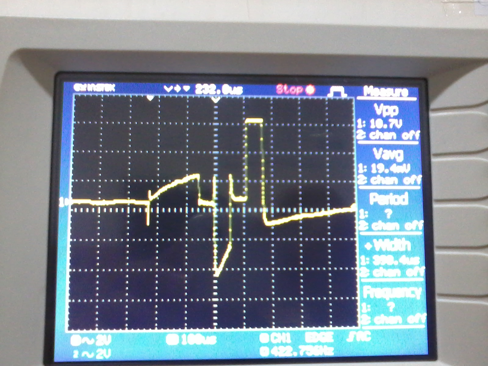

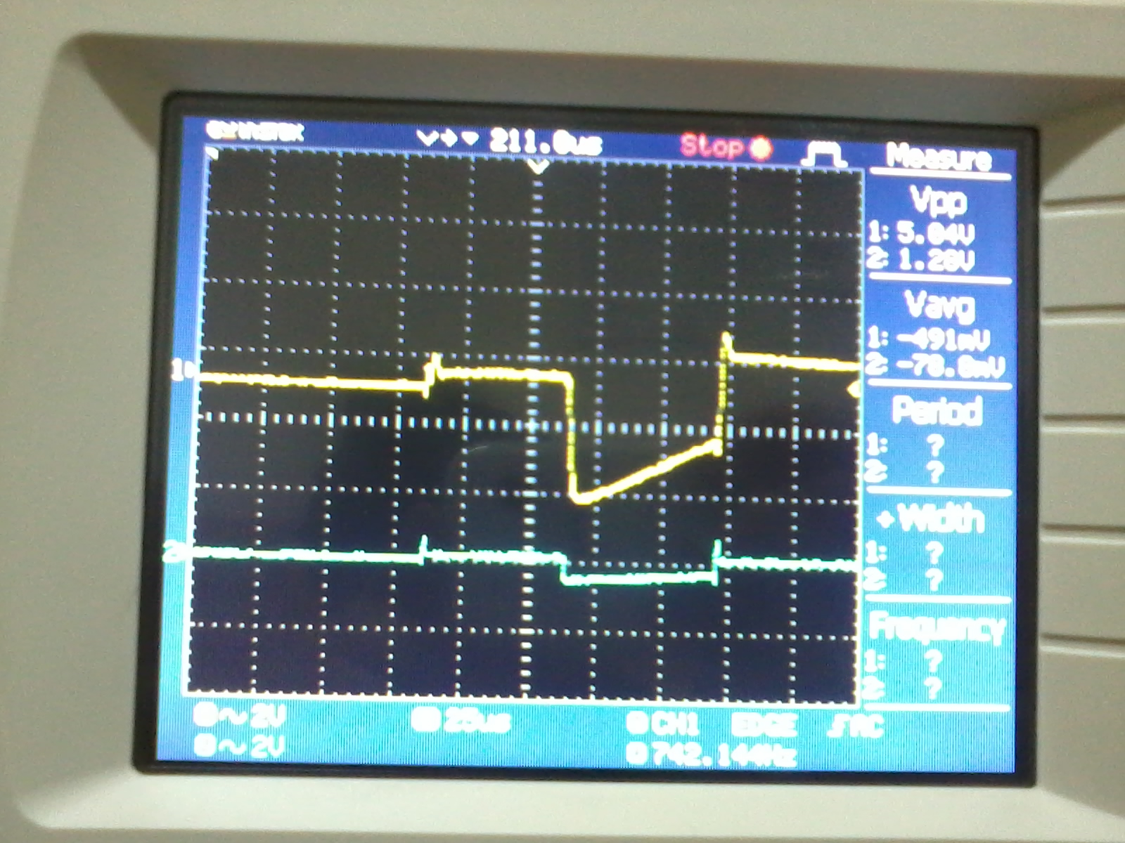

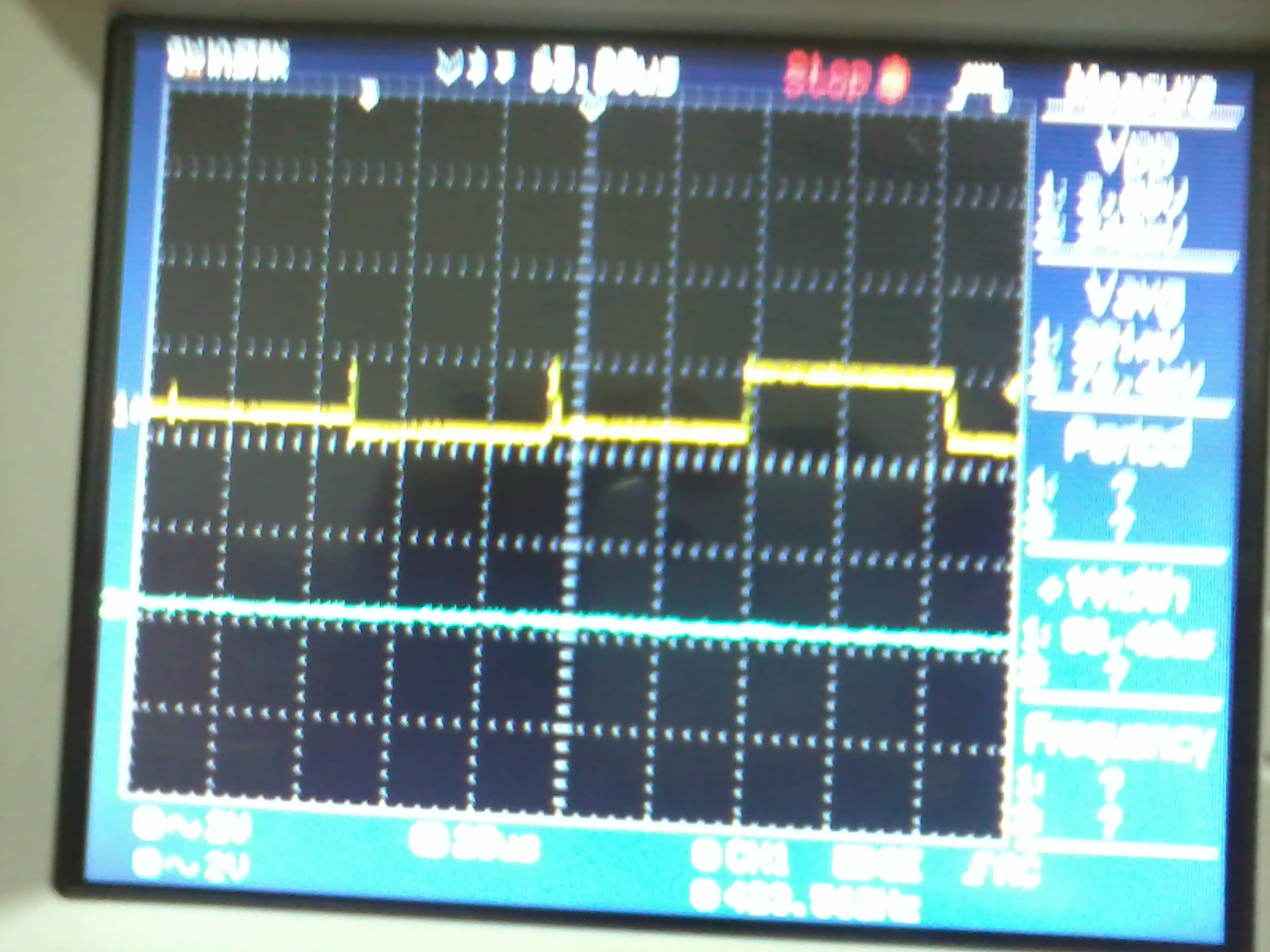

            i take photo that you say,now i put it ,please check
            sorry me man for my bad english
            • first pin4,9(yellow for pin4,belu for 9)
              second pin15,10(yellow 15,blue10)
              third pin14,11(yellow14,blue11)
              and finall picture for pin3,6(yellow3,blue6)

                Naw, that was just me being hard on you and I apologize. I can't expect you to understand that 'shorthand'. I'm used to it, but you're not. I'm hungry and often grumpy early in the day.
                And you're right, I should have said to check voltages on U5.
                I'm still trying to analyze your pictures. Something doesn't look right but I can't say what.
                georgi, what is going on with his last two pictures, can you tell?

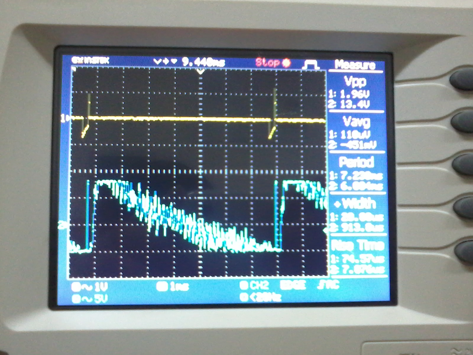

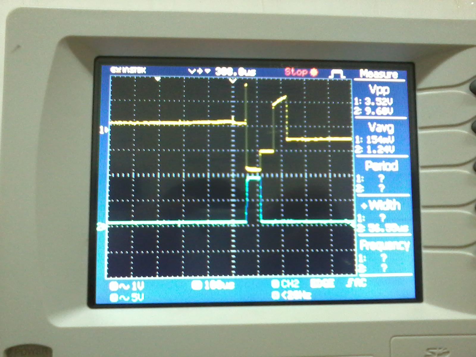

                  • hi
                    this picture for TP points,you careful not adjustment their point
                    first for TP5,
                    second TP1,2(yellow1,blue2)
                    third Tp4,3(yllow TP4,blue TP3)

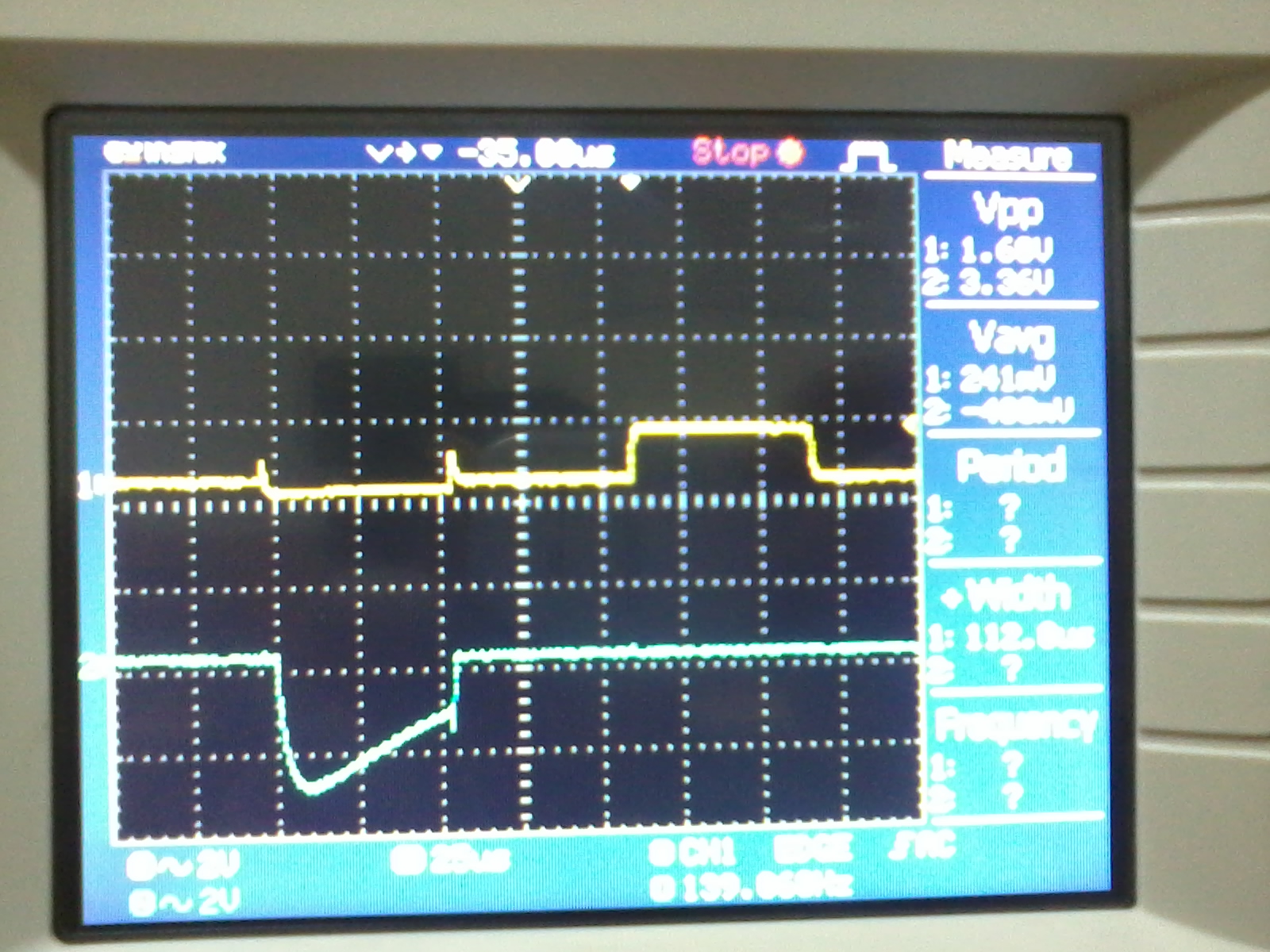

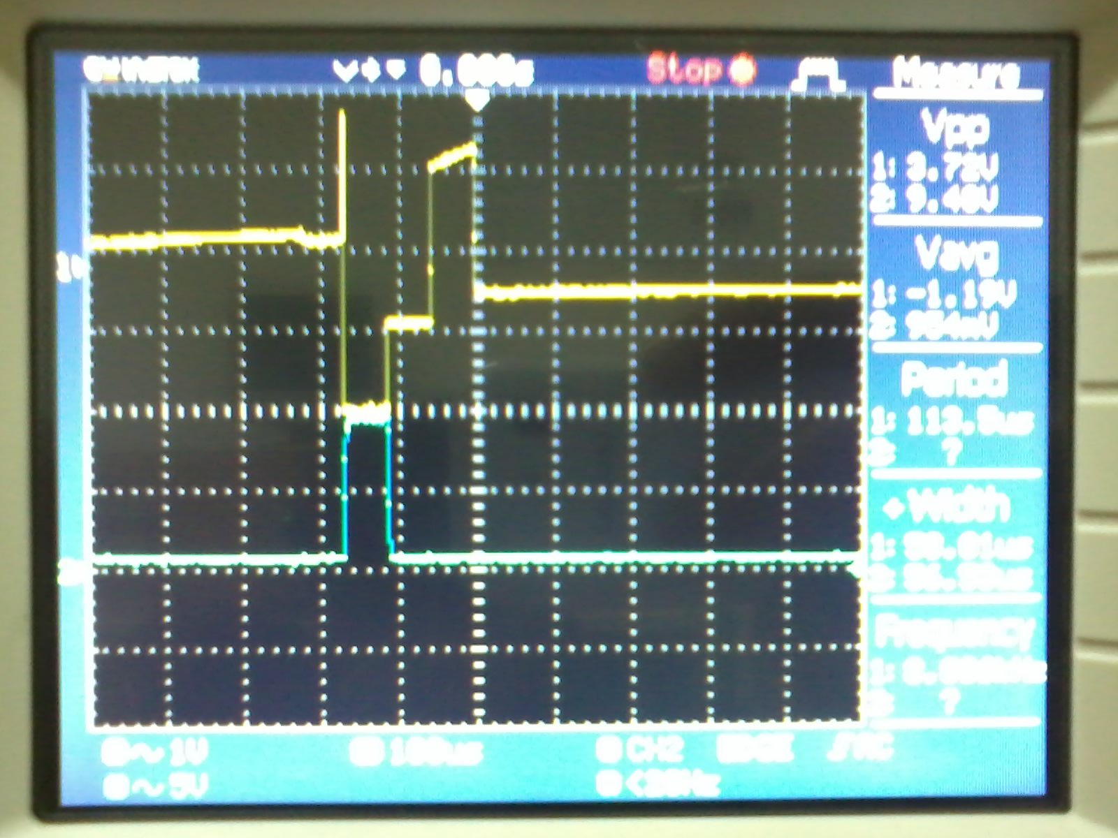

                    • first picture for TP6 when i put the pot on max
                      second for TP6 and pin9 4066

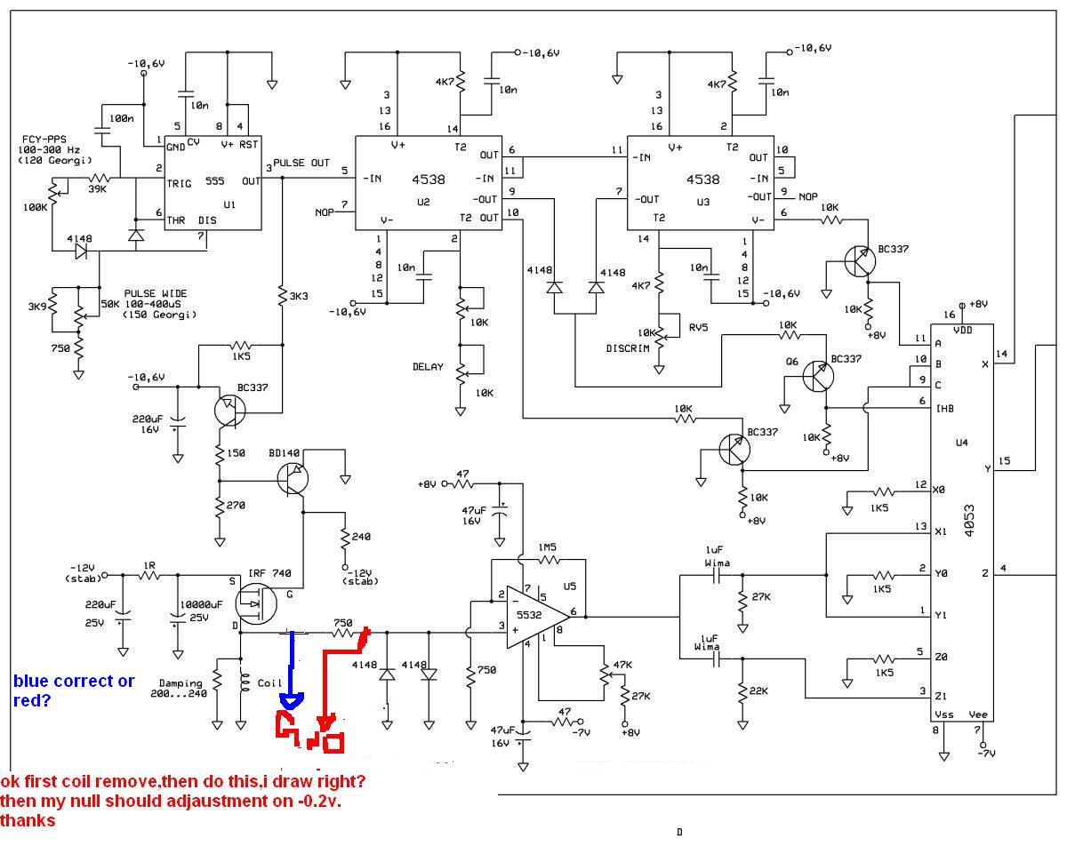

                      • this is for my guru porkluvr

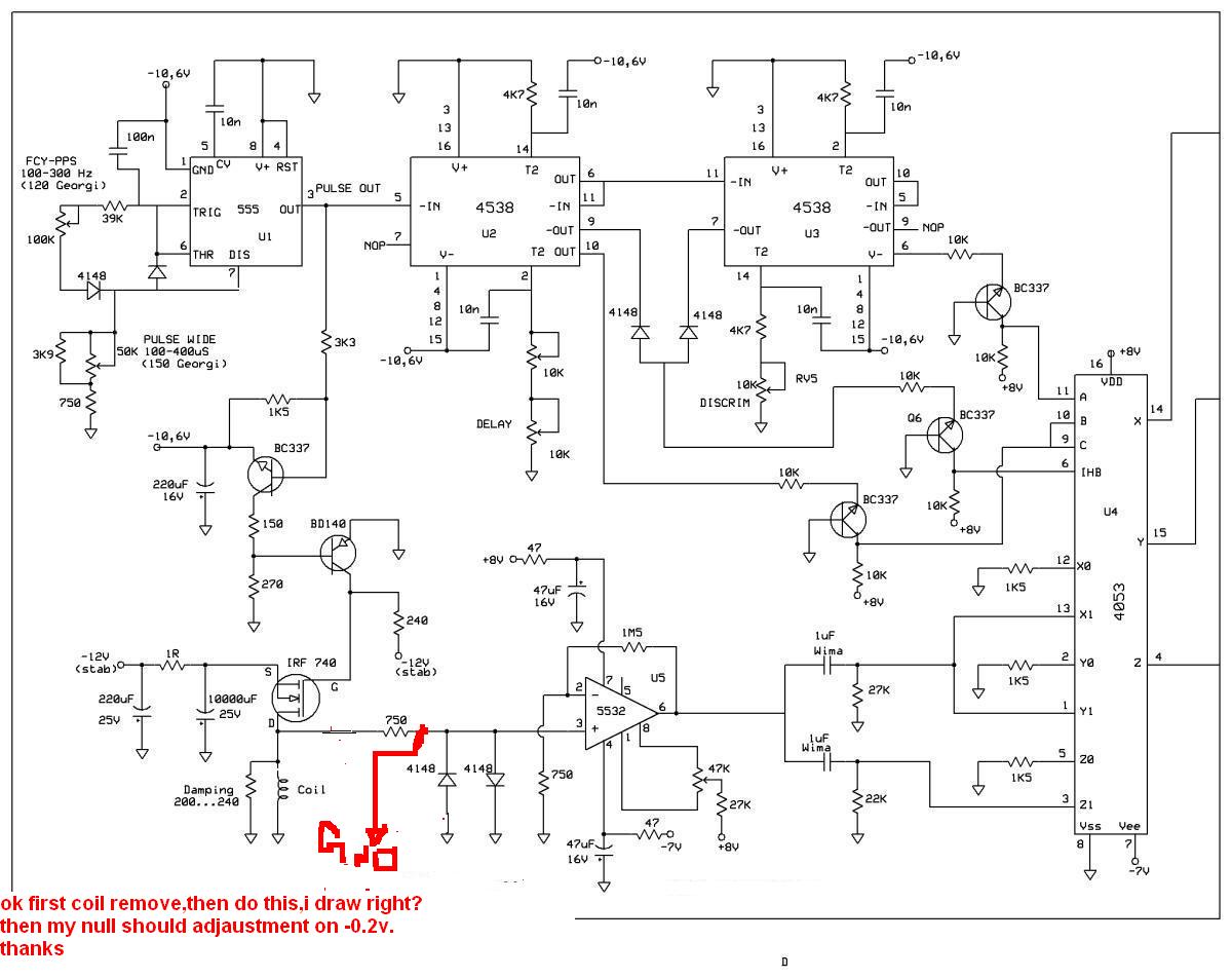

                        • You posted two slightly different pictures. I suppose the first one was a mistake. (You can edit your posts for at least 1/2 hour after you make the post, if you make mistakes)
                          That is where the positive lead goes, but where you put the ground lead in the first picture is wrong.

                            • ok but can not edit
                              my means first picture ,blue wire ok or red?
                              you say :The ground wire does not need to be connected directly to pin-3, it could go to the top of D3, D4, or best, to the bottom of R18, since they are all connected together. AND I THINK RED WIRE is ok!
                                I do not know where the test points are, so would you save me some time by showing me?!
                                look the figure,
