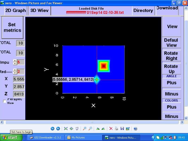

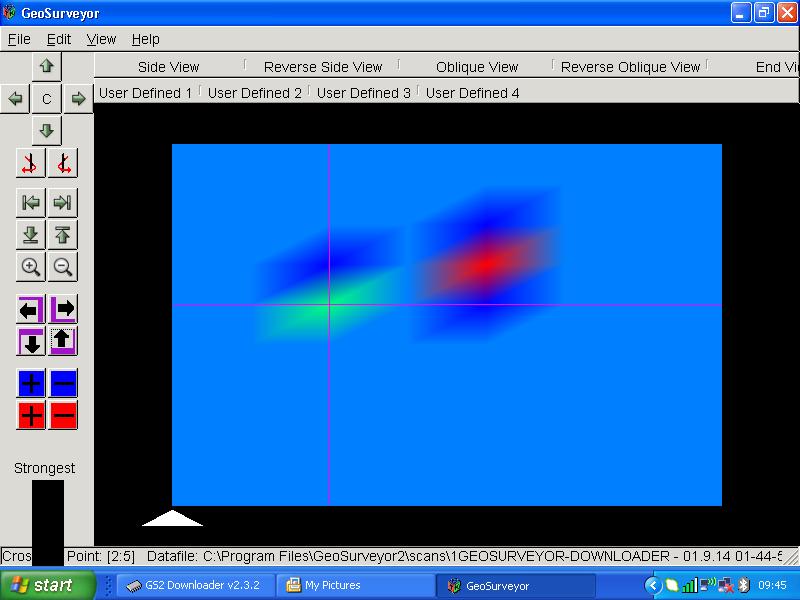

      • two software !
        same sensor 200yt!
        exactly the same targets 2 row and 5 impulse !Click image for larger version
        • I have better resolution
