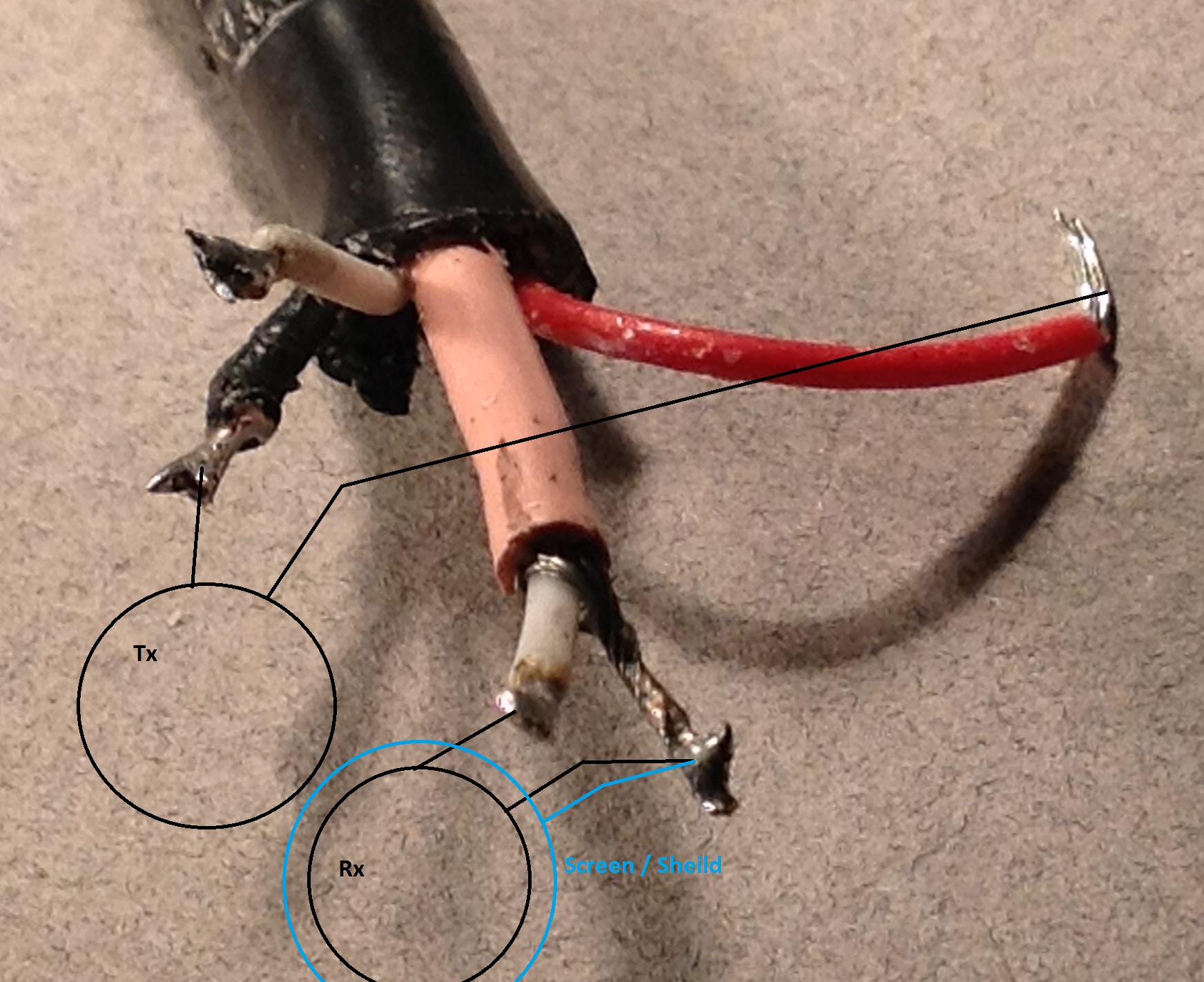

          Did you connect it like this ? What happens to the white wire?

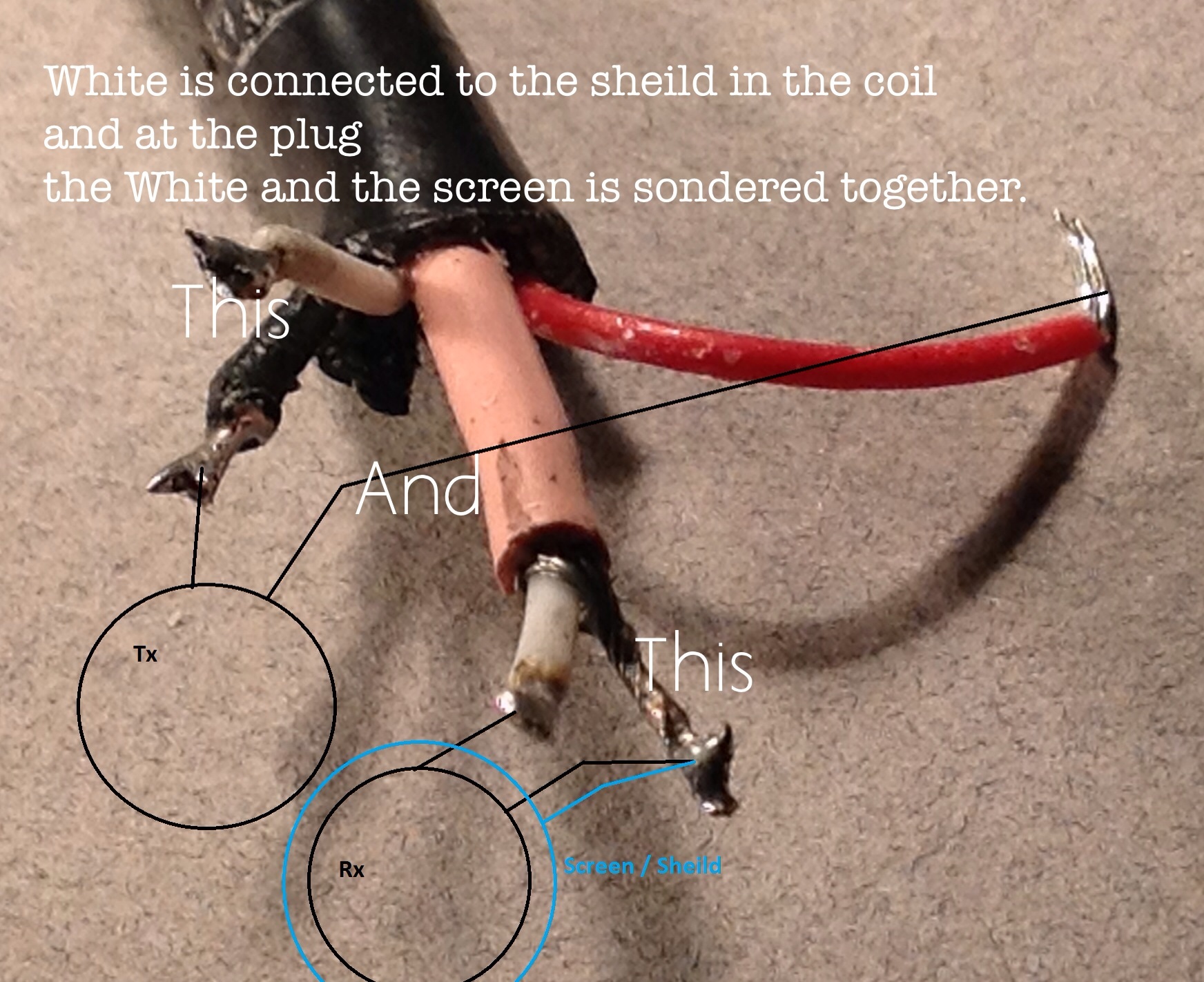

            Picture show how the cable was connected... Just like you say Gulfnut, just one change.. The screen/sheild and the White is connected at the plug.
            No 1 coil didn't work because of wet grass / chattering. My shielding was to bad.
            It could Be because the RX and TX Sheildings was connected in the coil, and not at the PBC or at the Plug.

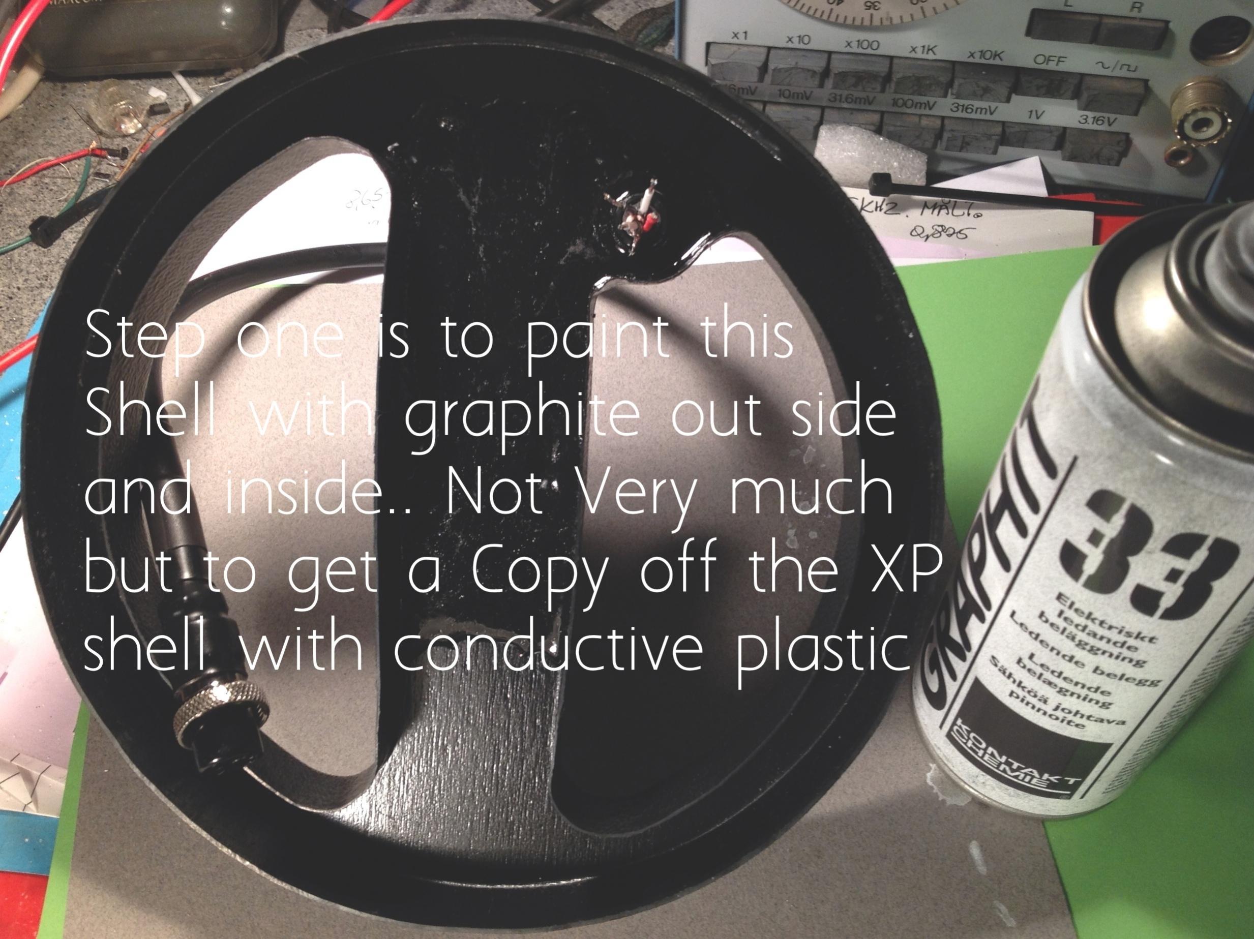

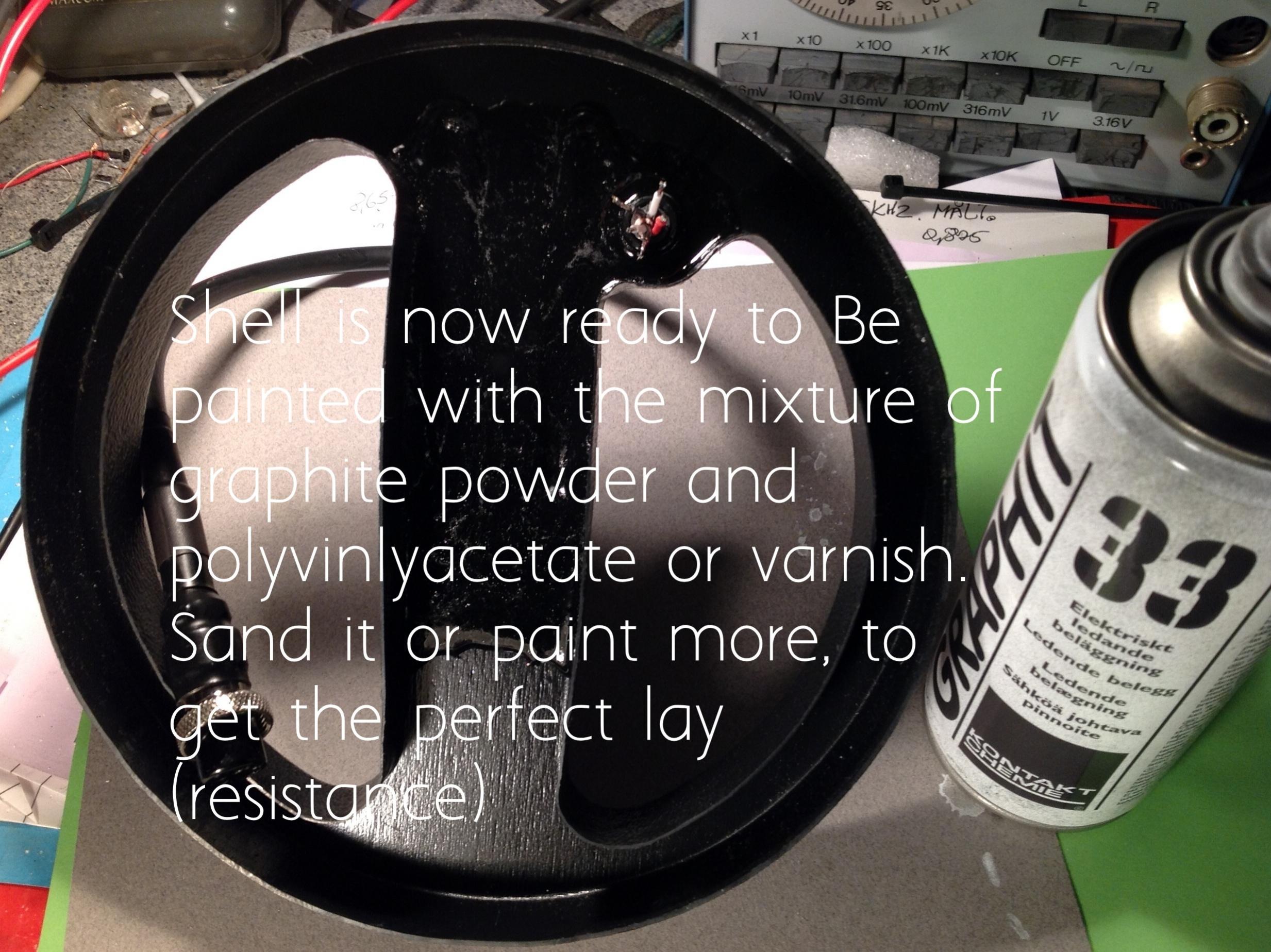

            Itsa good idea to get or make the shell grounded (XP and Minelab are using conductive plastic) - Home made version could Be a thin lay of graphite allso outside at the shell. THIS I WOULD MAKE.
            You can make the Sheilding in this two version... 1 the shell is like a sheilded case. 2 the two RX and TX coils are sheilded eash. The last one is easyer to work with, because you can use hot glue to fasted and go out to try perfomance before you close it up. The first one is more difficult to test, because the ending lay of graphite isn't possible before it closed. I WILL GO AFTER VERSION 1.
            The best perfomance is If you/I can make the shielding lay perfect, to get the same resistance all over...
            This could Be done by sand some place and paint some more a other places. THIS IS MY GOAL.
            1-2 kilo ohm is sayed many times in the threads and to get that, lower resistance can Be measured at 1 cm. (100-500 ohm)
            The connecting wire or wires is done in many ways, but I like how XP had done with a wire from heel to toe.
            With graphite powder its possible to make a paint.. (That need some experiments ) I WILL TRY THAT.

            • OK heres some experiments to try,
              with your coil
              Wire up as you did, try it and get a benchmark/ reference performance..
              then
              1) DO not solder the white to anything ( red / black Tx ) (Coax hot and cold/braid Rx ) ( Coil Screen to Rx coax cold/braid)
              Any better?
              2) As 1 BUT Solder the White to the Rx cold/braid at the box/plug end
              Any better?

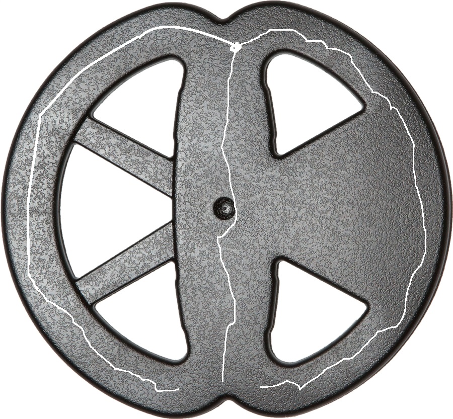

                Im impressed with the xp solution, both the shell and the potting are good low resistance and the drain wire faces the ground rather than being above the coils.
                With a metallic shield like aliminium foil - you need a gap so you dont short circuit the mag feild - the coil flux would race around the screen as current.
                With a partially conducting screen ( like xp 1.5kohm - side to side) the sheild can be complete annulus, no breaks required - as you dont have a short circuit condition, as ohmic, no large circulationg currents.

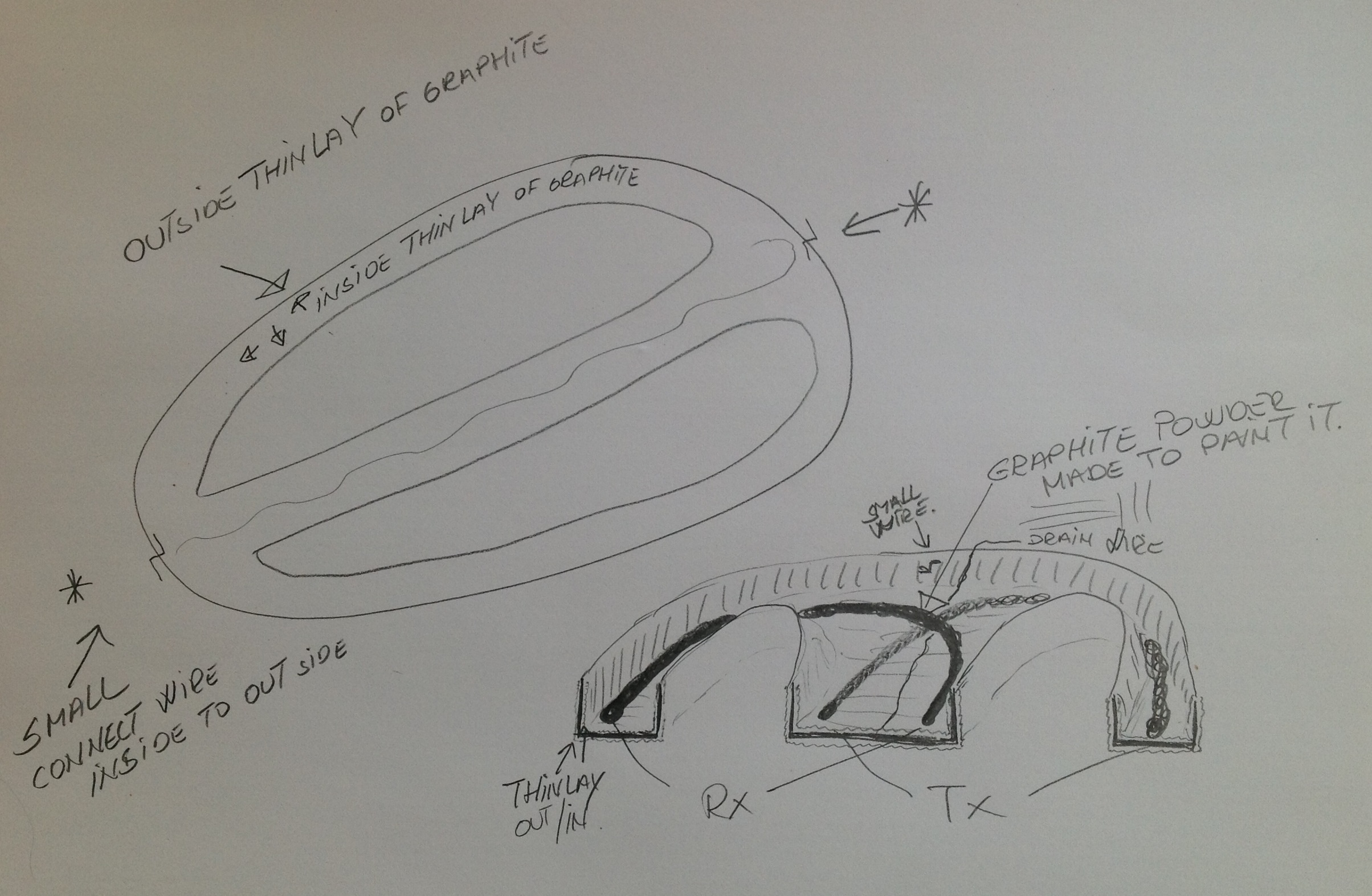

                      • Thanks - try to understand everything you say, but ist a little hard.

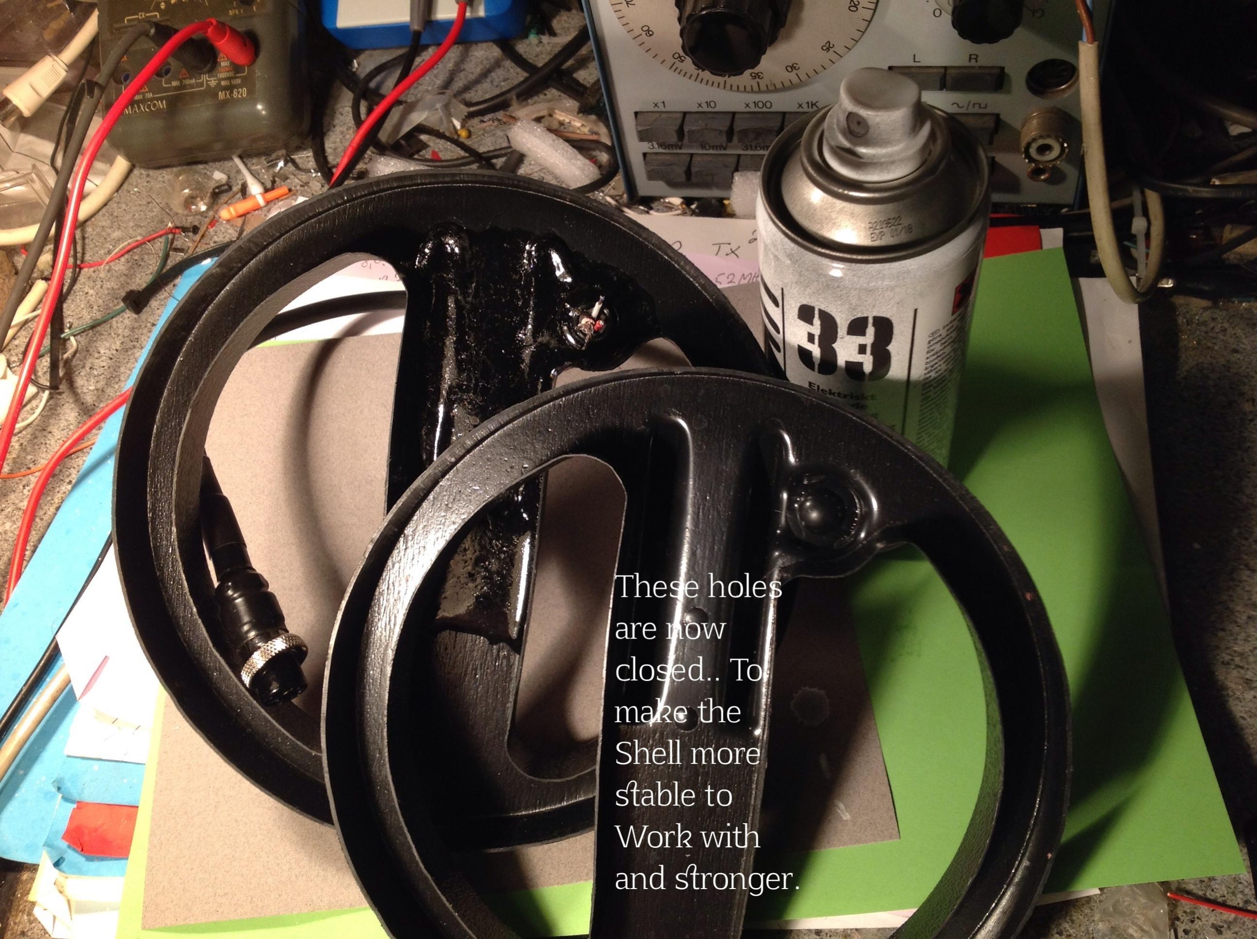

                        Its allso to difficult to explain what I'm going to do, so I go after some fotos.. And a hand drawn drawing.
                        With these I will try to show you my plans...and at the same time, tell you "did I understand what you said" so you can stop me, before its to late.
                        I should had been more in English lessons at school.. Got 100-200 words to work with, so its Very difficult to tell every correct.
                        Henrik.

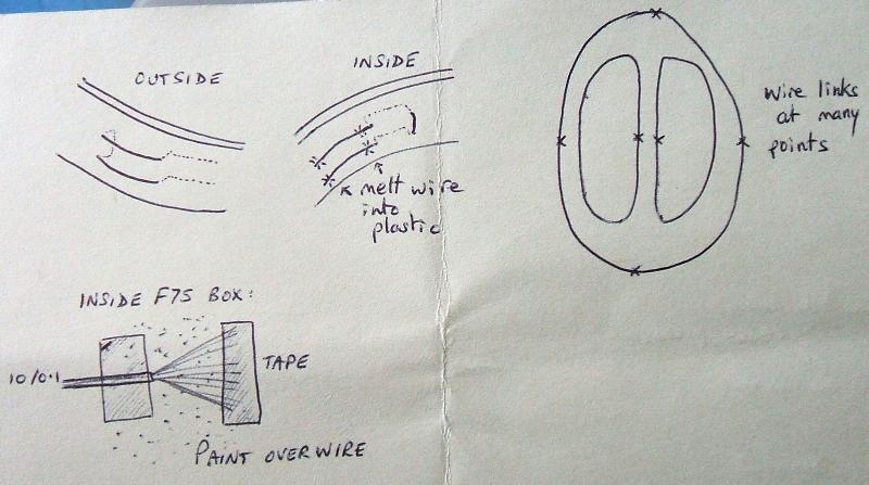

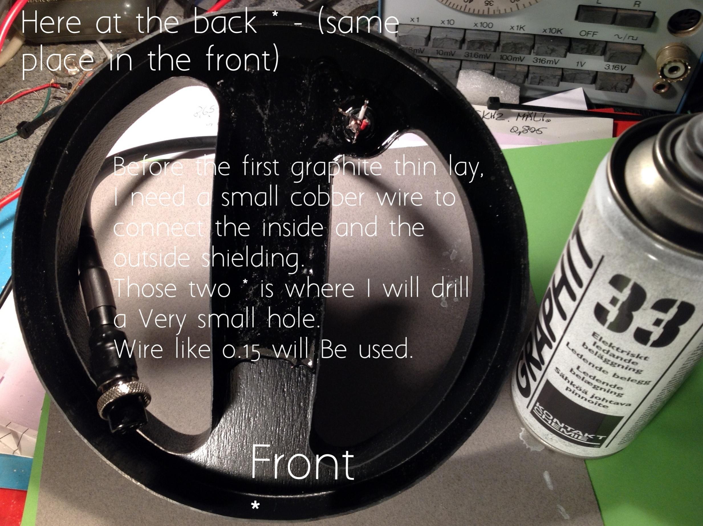

                        • I'm not sure how essential it is to have graphite on the outside of the coil case. After all, many commercial coils do not have conductive plastic - any white plastic case will definitely not be conductive, because black carbon dust is added to make the plastic conductive. Plus, the graphite will wear off easily with use.
                          However....If you want to try it, I suggest using more connections between the outside and inside, maybe add two near the centre of the coil case?
                          Making a good electrical connection between graphite and bare wire is not easy, and so the more contact points the better. I think using multi-stranded wire may be worth considering, such as 10 /0.1mm ( 10 strands of 0.1mm diameter). Inside the control box of my F75, there is a painted graphite shield on the case. A 10 /0.1mm PVC insulated wire has 20mm insulation removed, the wires are spread out in a ' Chinese fan', and the end 5mm of the wire is taped down. The paint is then applied over the case and the bare section of the wire.
                          I will attach a drawing with some suggestions on how to fit these in/out wires, later. [done]
                          I think your attempt to even out the surface resistance measurement is too ambitious, and probably will make no difference. Only do it if you think you have a particular 'bad' area, where you perhaps had difficulty applying the paint.

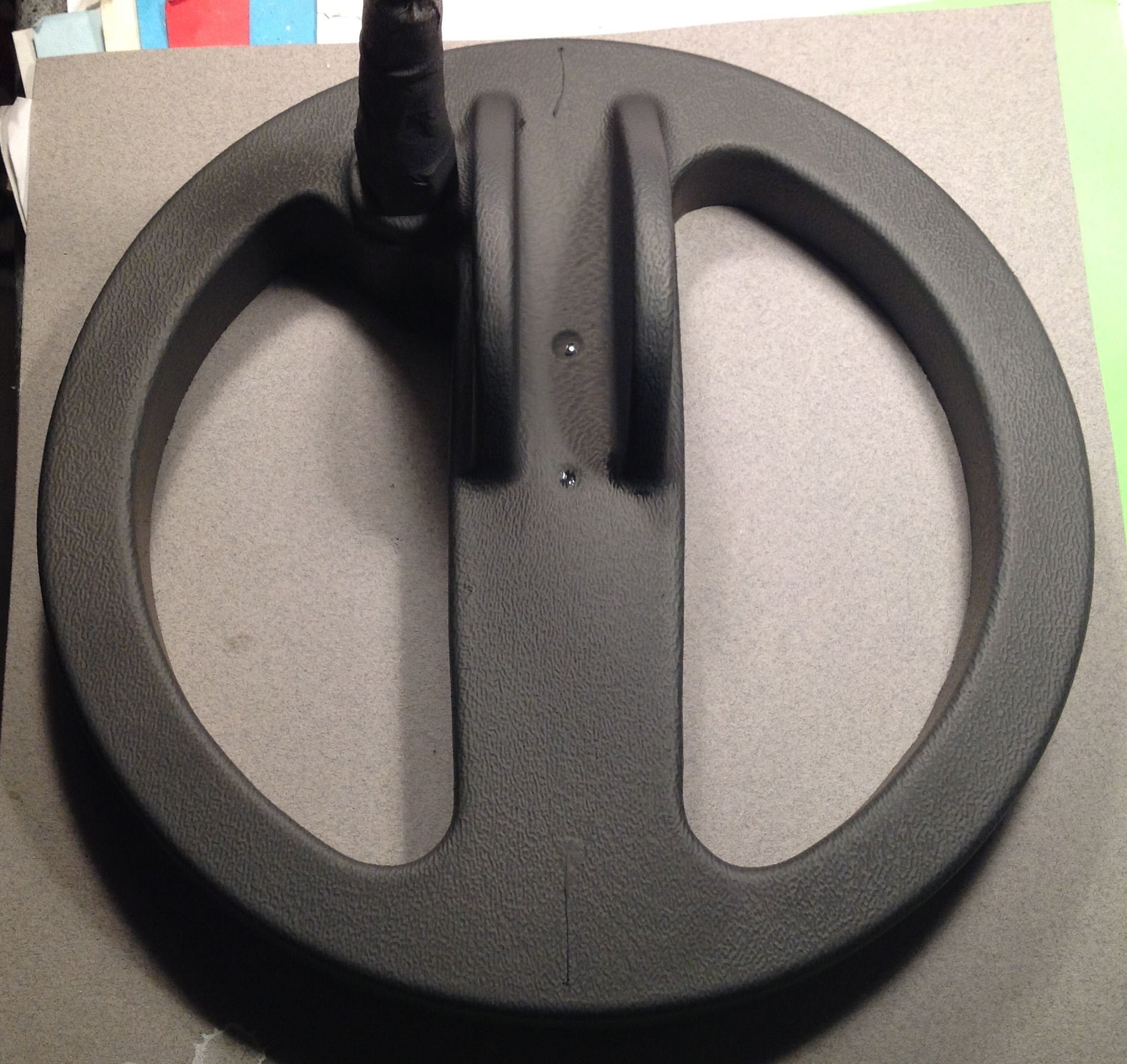

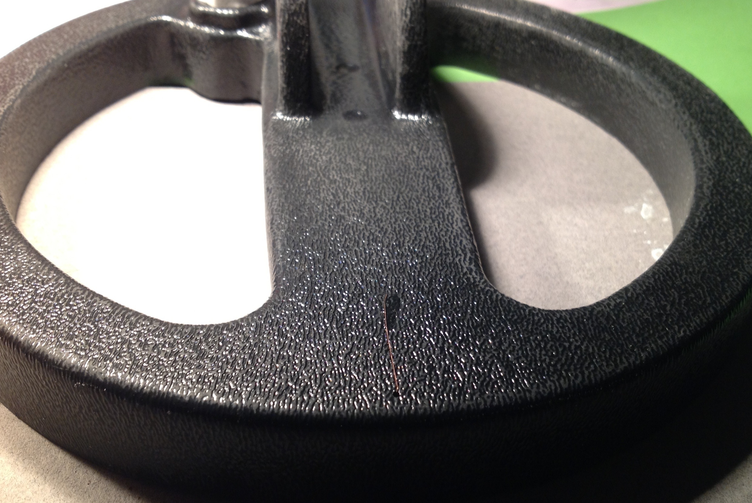

                          • I understand Skippy..
                            The two first wires 0.10 is now at place. I will try to measure a little, it will give some ideas where I am.
                            then I can add some more wires and take it from there.
                            pictures showing before and after first paint. (Only two wires front and back 0.10 mm)
                            • nice shells from don there.
                              I guess the side to side resistance of the xp shell is good also due to the cross web supports that go from centre inner to outer so you get additional low R path.
                              On the drain wire, I normally fit to the shell, then coils, then pot.
                              The e field charge will exist and vary between the coil and the ground. To me it makes good engineering sense to have your drain in there between the ground and the coils, rather than above the coil ( where I normally put the drain ).
                              Henrik what is the resistance of your shell - side to side ? Is it even dry yet! The R goes lower as it dries.
