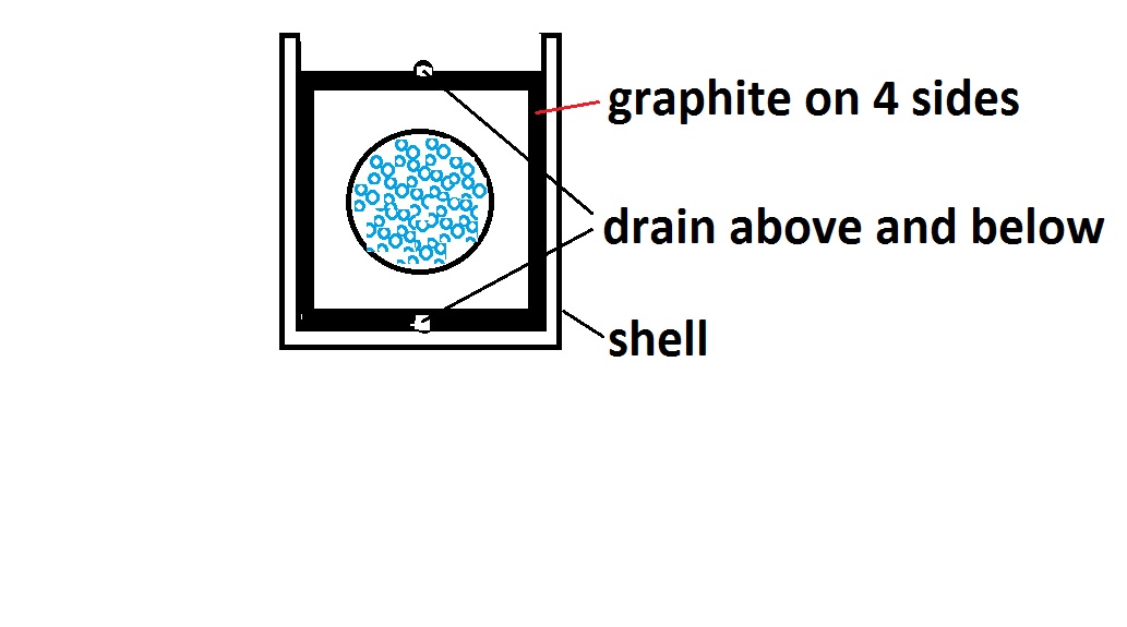

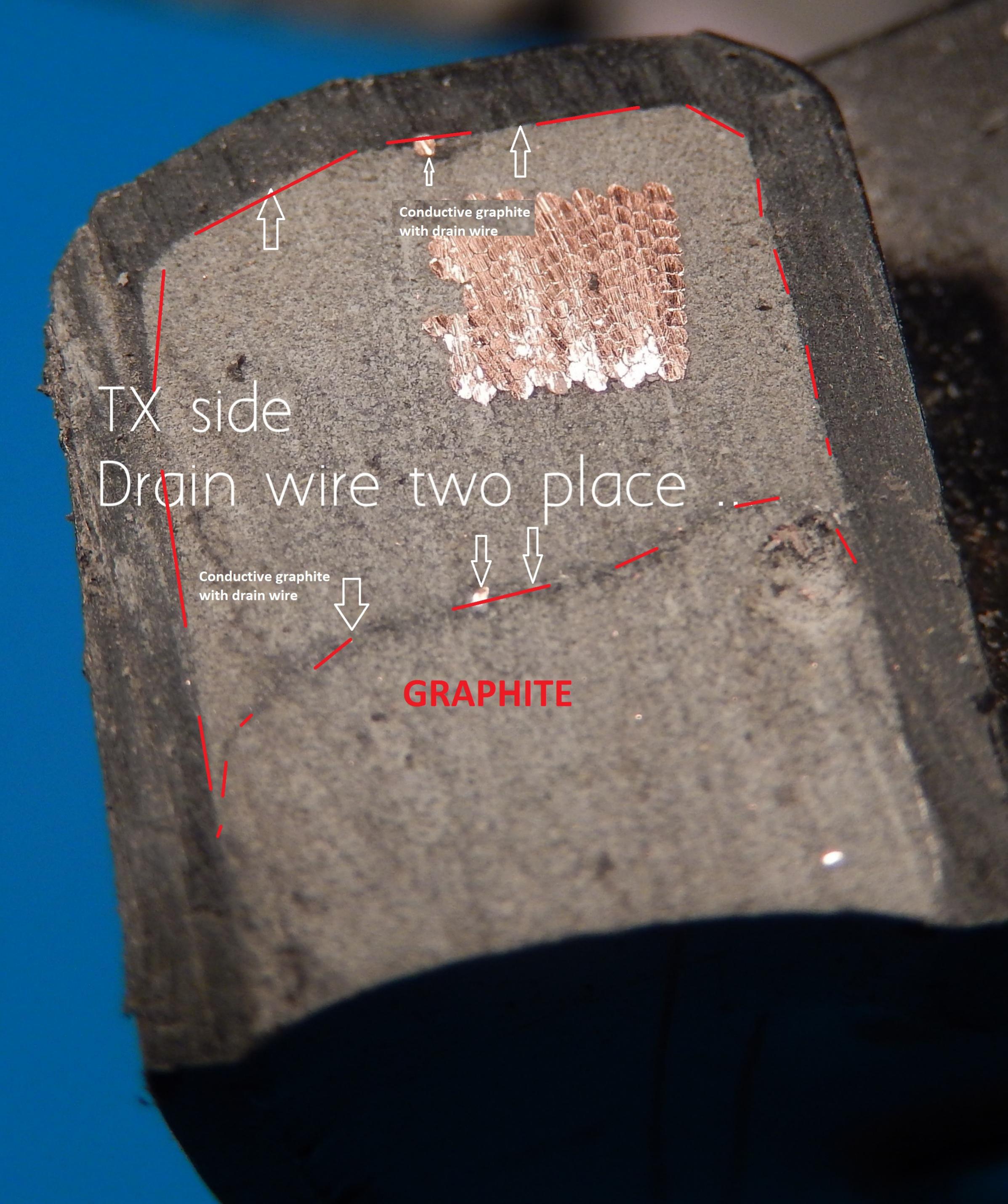

                • In some of your photos I could see a thin Black line in the potting.
                  This is additional graphite layer - The layer had a drain wire. So the original coil bundle had graphite on 4 sides like screen box.
                  It also had a drain wire above and a drain wire below coil bundle.Click image for larger version
                    It also had a drain wire above and a drain wire below coil bundle.[ATTACH]29031[/ATTACH]
                    BUT Gulfnut - I made all that, just like the Deus coil....

                        • Yeah Gulfnut . I got that, and made allso a lay outside the Shell. Just to copy the conductive plastic.
                          Only thing I can see helps.. With those Strange interference making the signals Breaking up like iron close by, is more graphite and lower resistance. But I'll let it Dry up some more.. and take a day off the project, until saturday.
