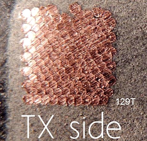

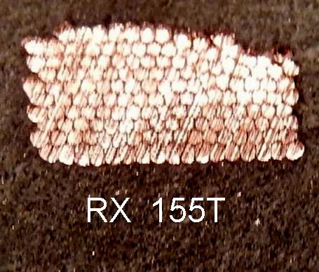

    • Here's some mathematics for you.
      You measured inductances as: RX = 14.9 mH; TX = 10.4 mH. Ratio = 1.433, so the Turns ratio = Square-root(1.433) = 1.197
      Your coil cross-sections show: RX = 155 Turns; TX = 129 Turns. Ratio = 155/129 = 1.201.
      Pretty darn close. This also shows that if there are any 'extra' windings, for mysterious purposes, like broadband nulling, they can't be more than maybe 1 or 2 turns.

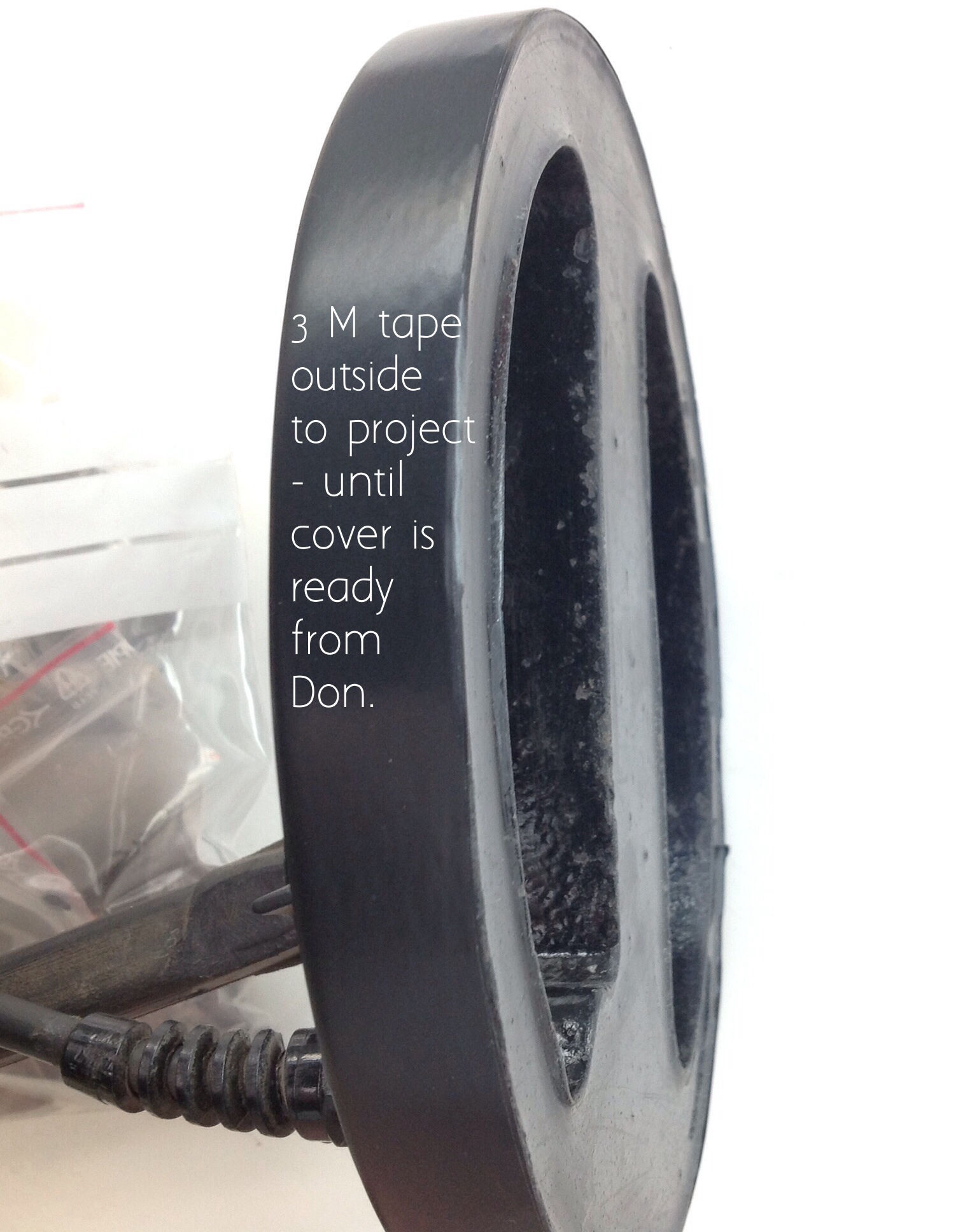

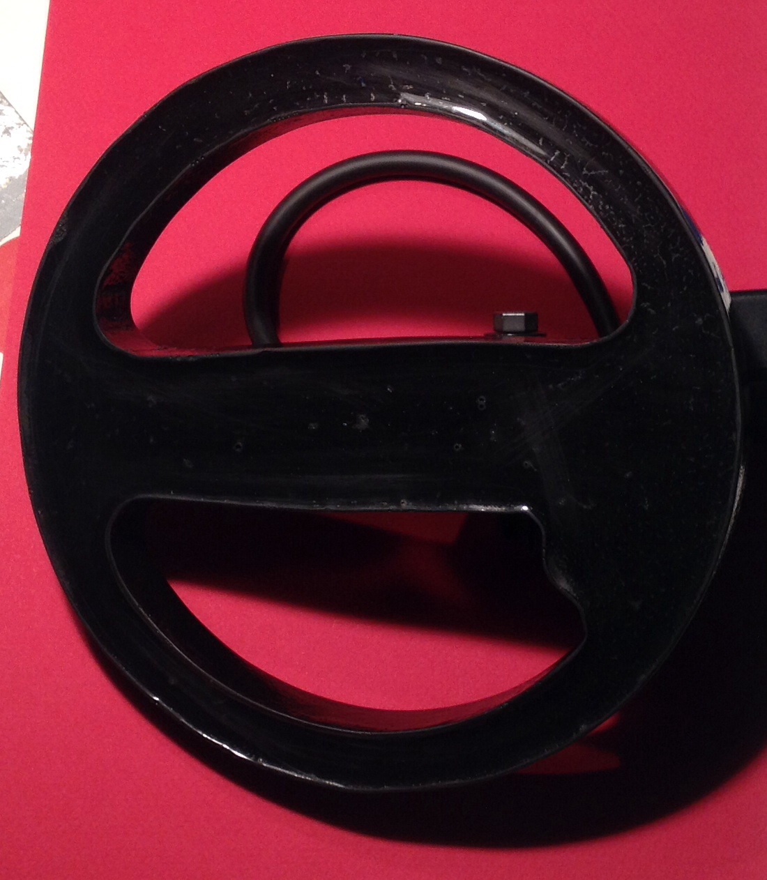

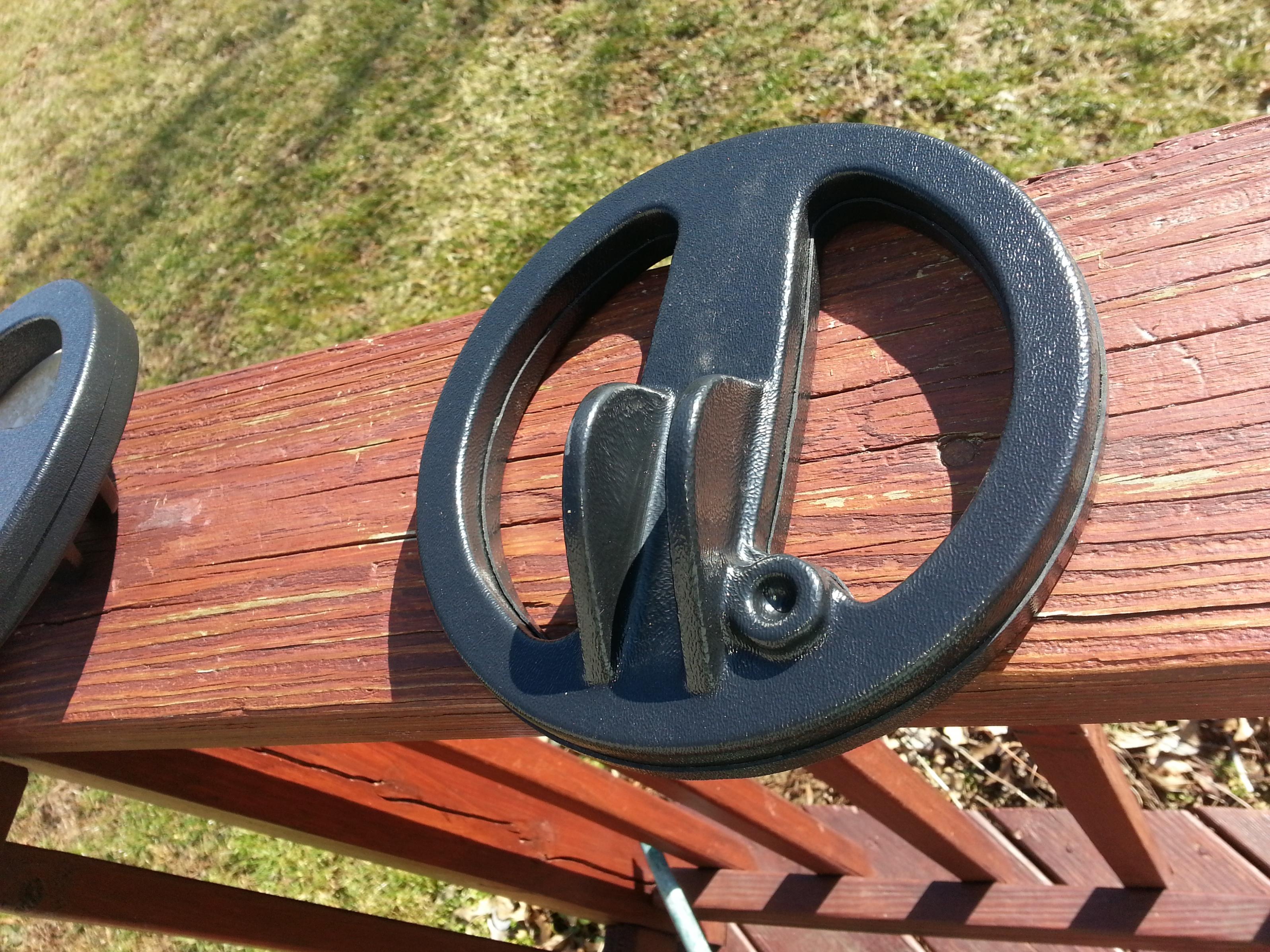

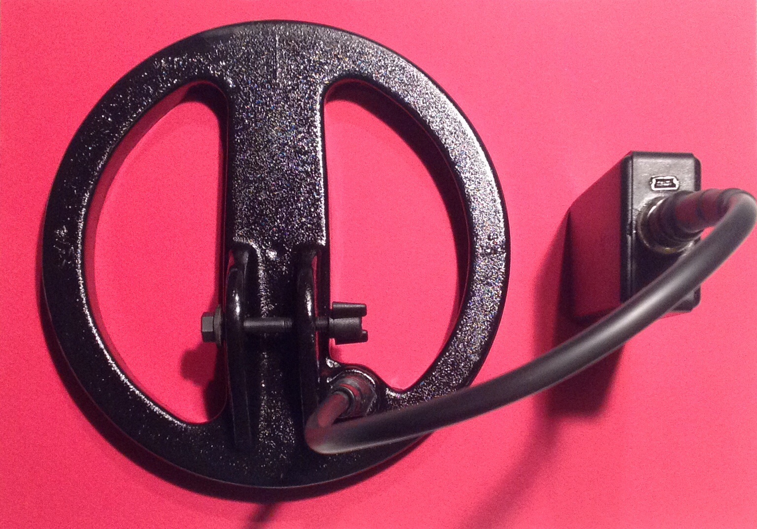

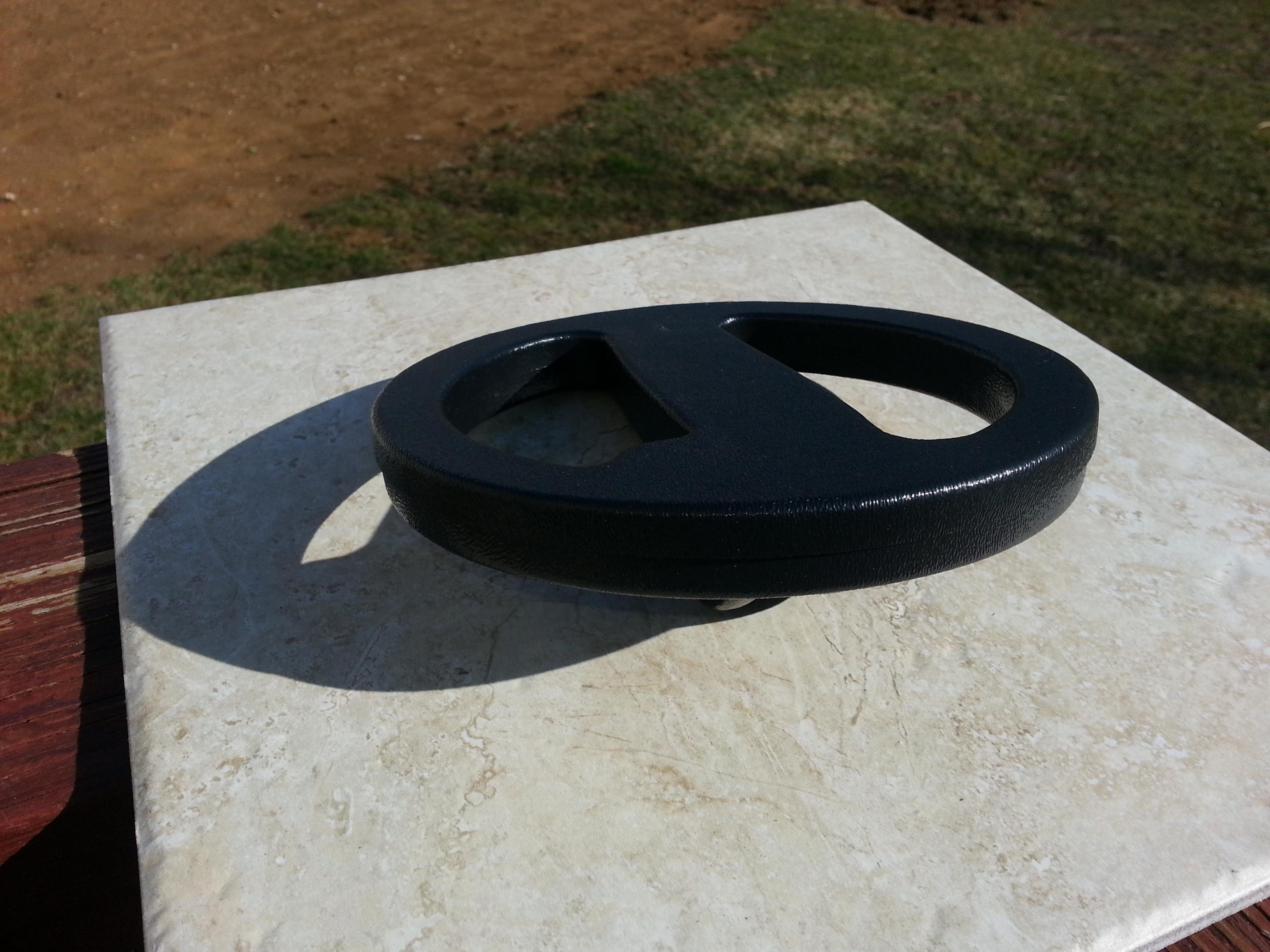

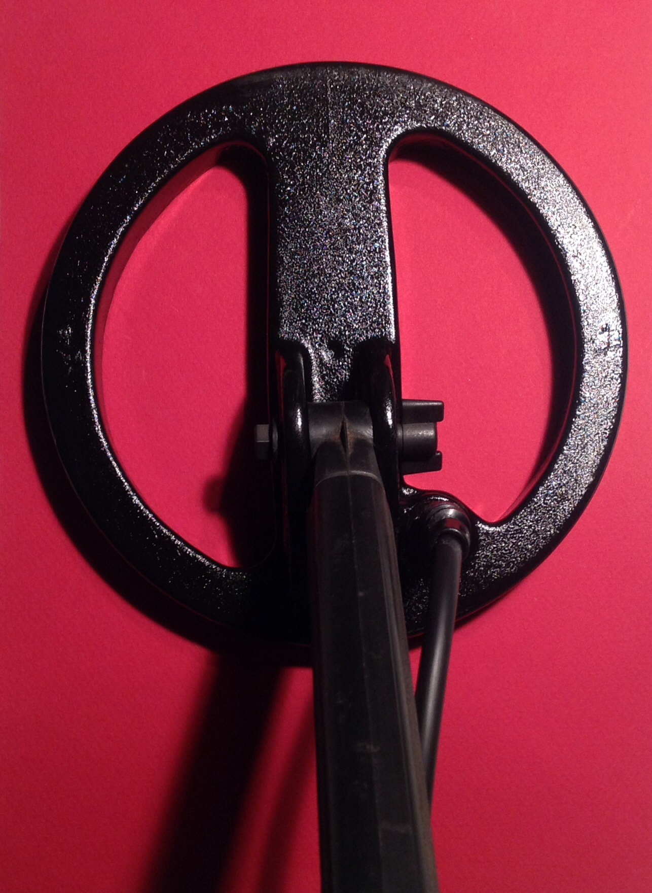

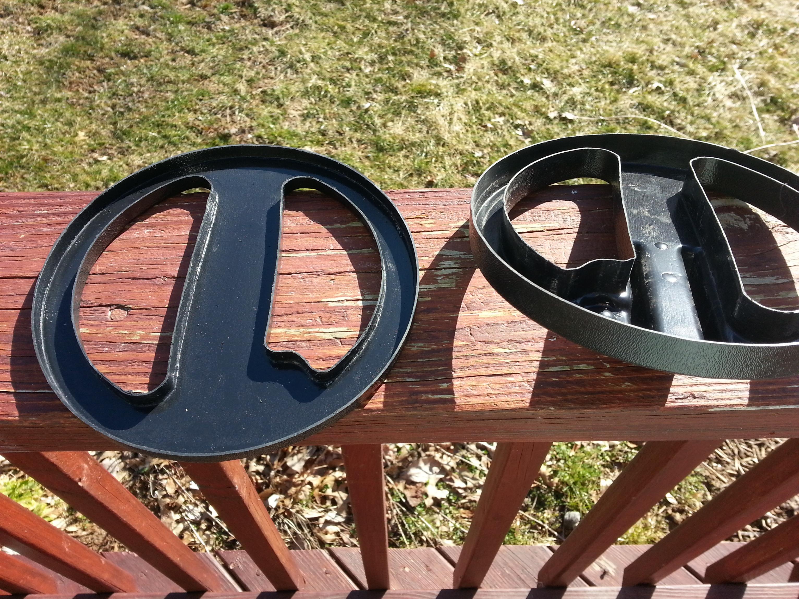

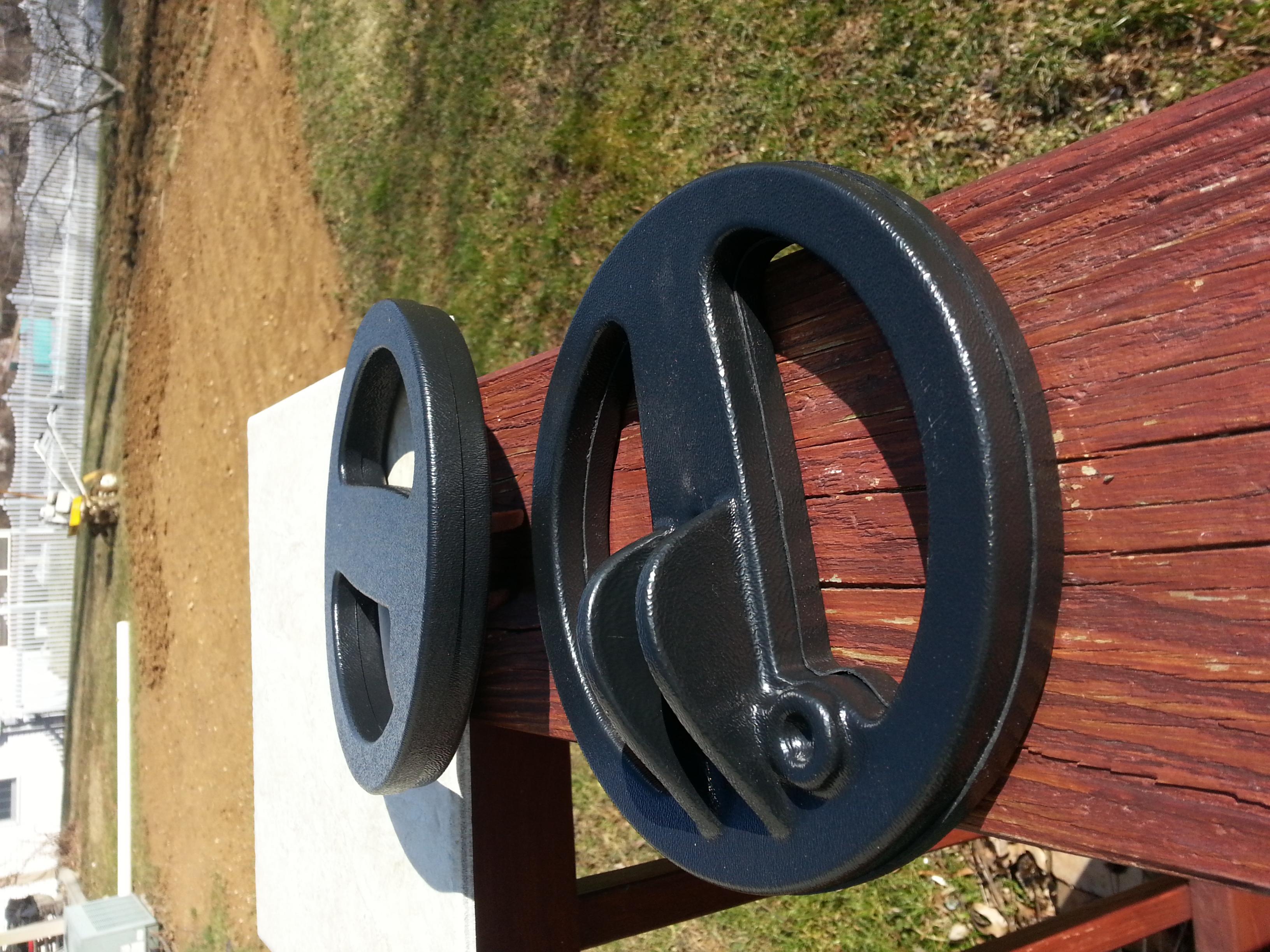

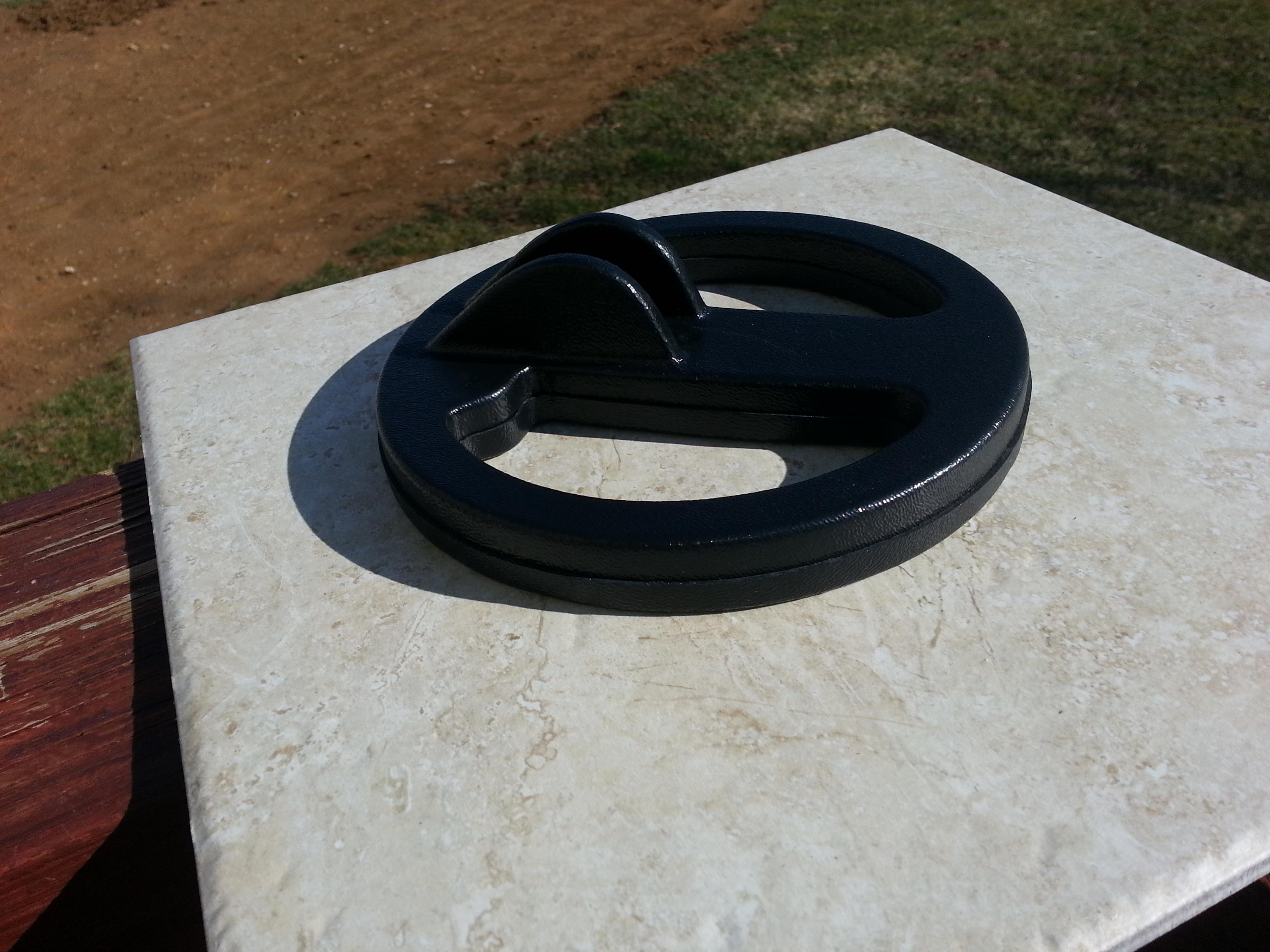

        Finish paint and bottom seal. (Pictures)
        • dons shells are exellent, nice job it seems from skippys pics xp are not worried about interwire capacitance

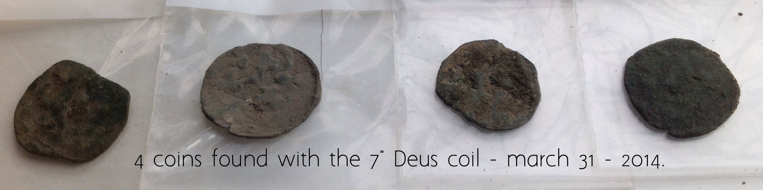

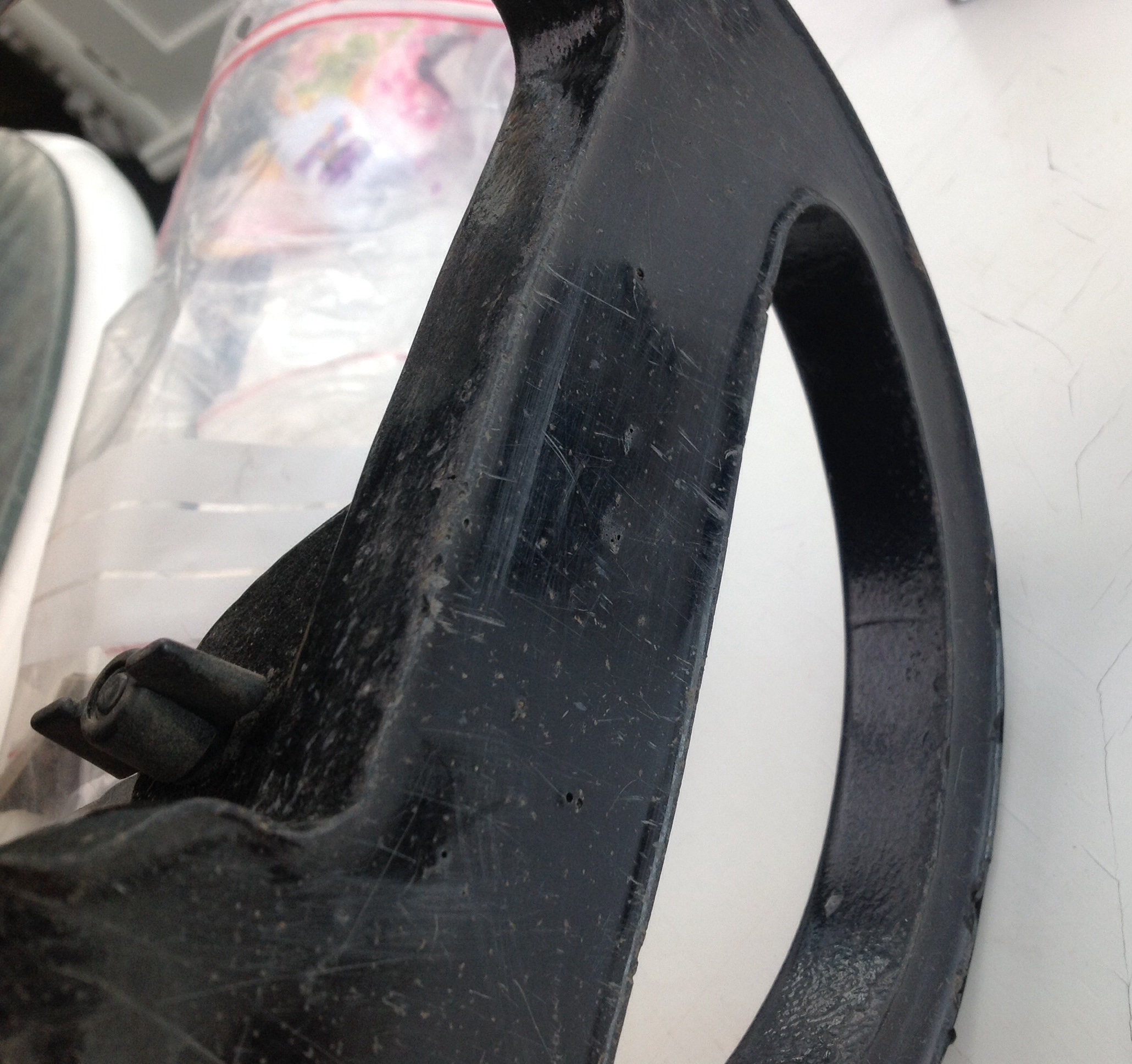

          • The first scratches came to day, at my newly painted 7" coil.. Need to make cover or protection. But 2 hours search and 4 old hammered coins.. Its working pretty good amongst a lot of iron.
            Thanks for all you help to make this coil.
            Henrik
            • Show us a pic of your hammereds !! Steve
              • if you found them in the same field, they would be considered as a hoard in the uk.
                • Yes, we want to see those hammered coins.

                  • Originally posted by Henrikras View Post
                    Henrik
                    7" coil covers coming your way..
                    Don

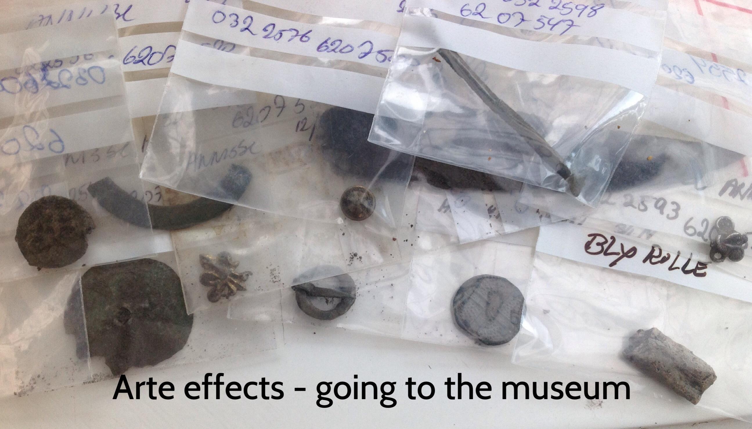

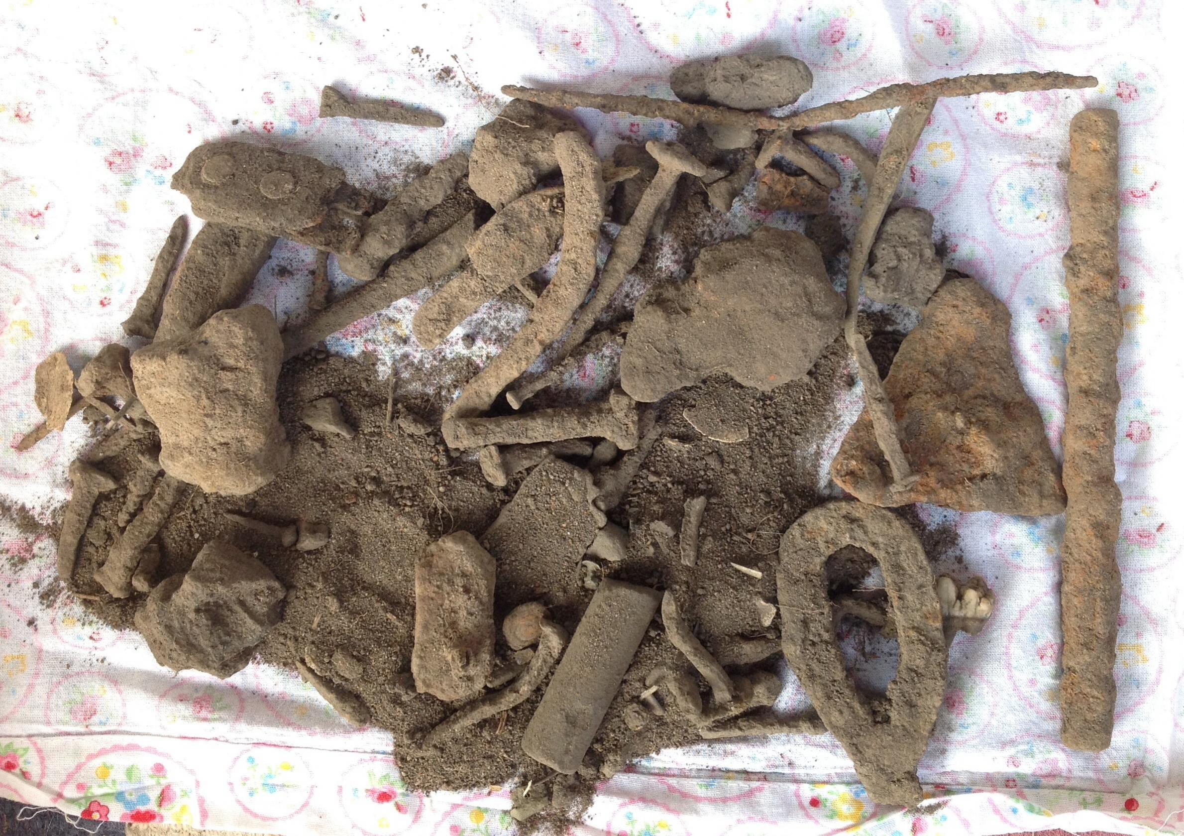

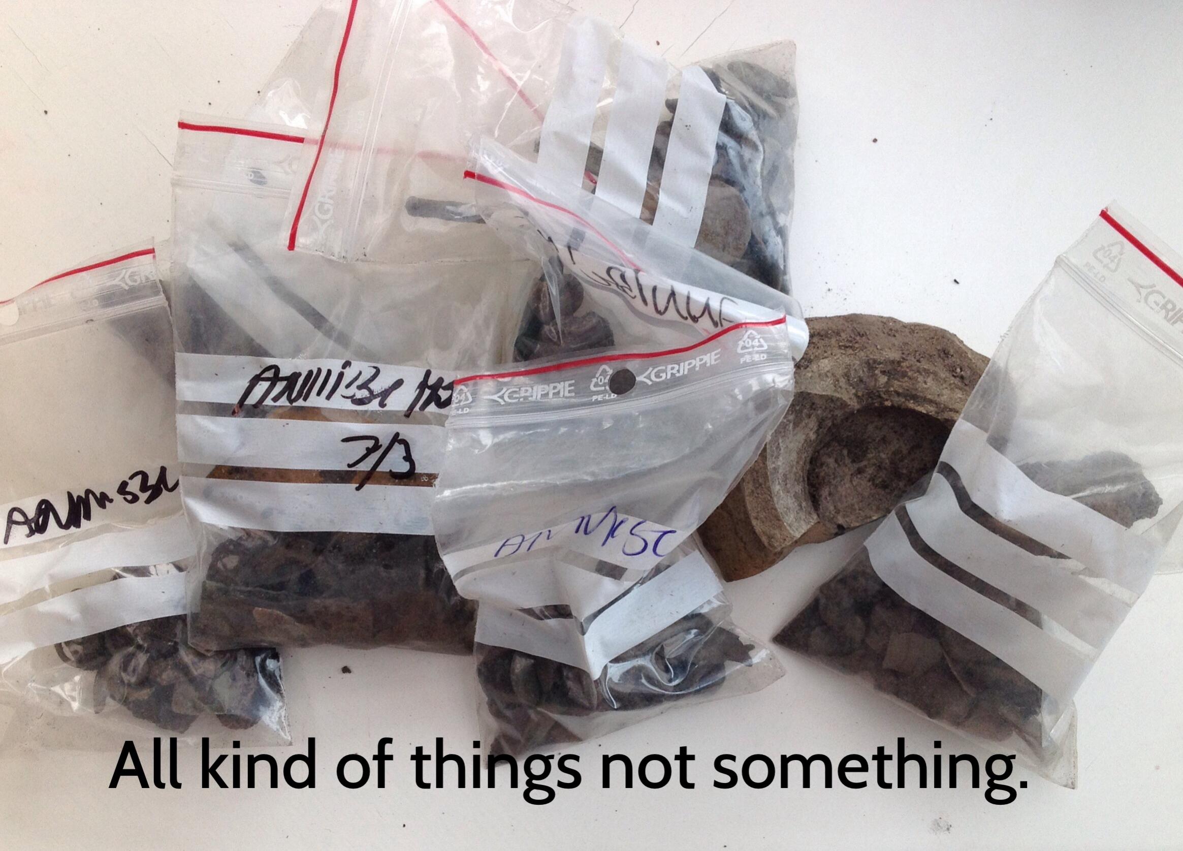

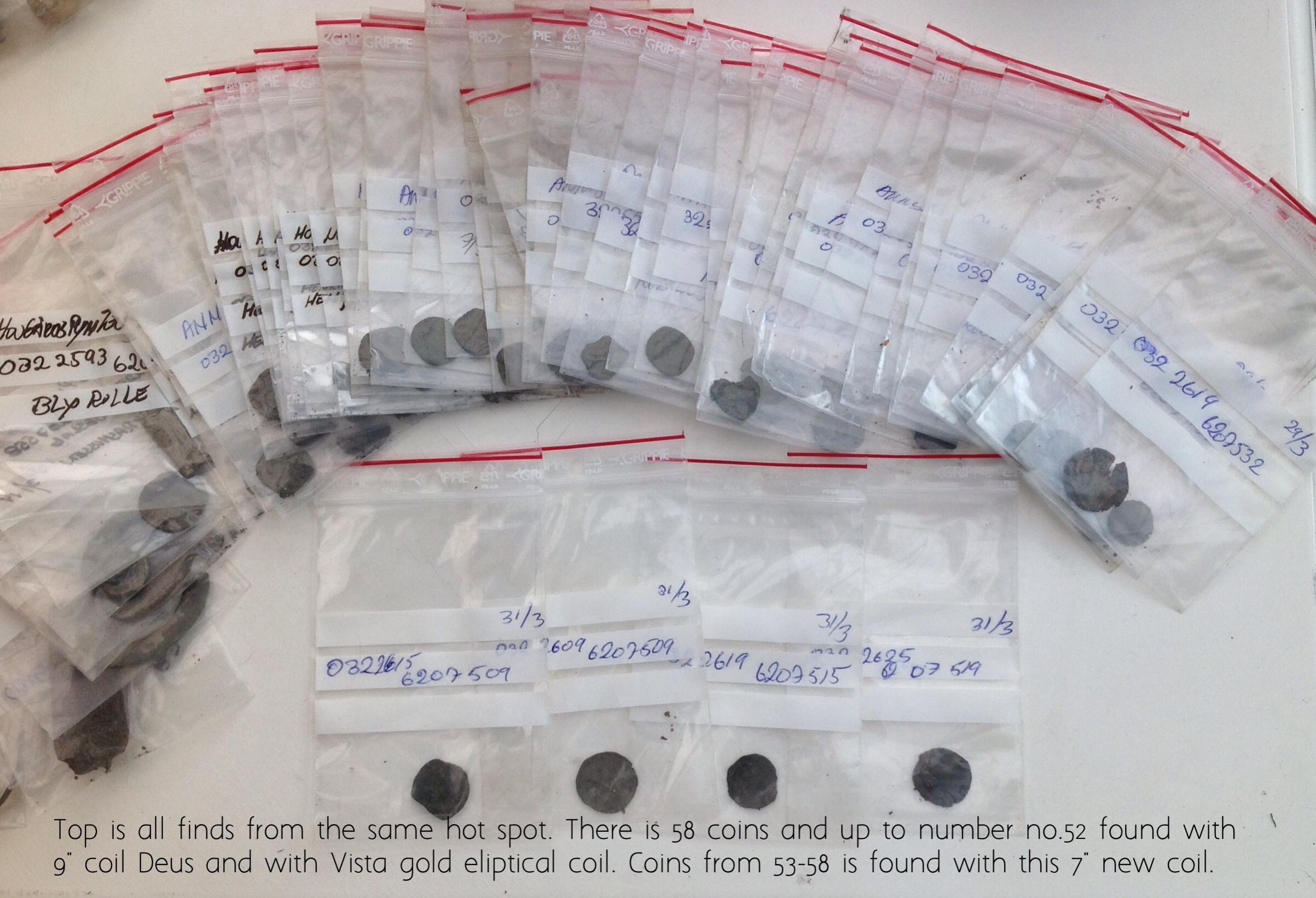

                    • Hi all.
                      Here is some pictures.. Pics 1+ 2 is the coil after 2 hours search. I will record a video next time I go out to the hot spot,
                      so you can see all the stones and briks there is at the surface.
                      Pics. 3-4-5 is the finds until know... That spot here was the reason to make a 7" (smaller) in a hurry.. Ive started out there 1-2 months ago, and it allmust impossible to do the search, there is so many nails and iron things. Ive found out that a faster Detector and smaller coils did a better job... More finds days with slow slow swing and in fast programs. But even with the 9" Deus coil and in the fast prg. I could see that the nails was masking.
                      It will properly Be a kind of a hoard - but the reason so many coins are found in the same place (and there is found many more since 1996 the spot was found), is that all the farmers had to pay the King at this place. Is was a kind of a casstle in the year 12-1500, then is was more like a Big farm.
                      Must of the coins is form a period 12-1440 where there where a lot of wars / fights here in DK.. We call them civil war coins.. They are with Very low % silver because the King needed money to participate in the wars.
                      But there is silver coins out there, not many and mustly broken.
                      Picture 7 is some of the iron stuf I dig up... Ist a good idea to dig those Big iron signal, there is easy to find..
                                Thanks - but please think about this in some another way.
                                Competition isn't allways a good idea, but I'm Glad that some usefull came out in the open. This like many other threads is something we share and doing together in the spirit of this hobby, and the spirit is so great in this Forum. Lets keep it there and go back to the subject please.
                                Henrik.
                                Hello Henrick.
                                With that said, I will be happy to "donate". I will be dropping these in the mail today. These are still in the experimental stage so don't get hopes too high.
                                They fit like a glove on some shells that I just made but once a shell is epoxy filled you may need to make a tiny "shoe horn"to get them on.
                                Anyway, see what you can do and I may need to make another go around if they need to be larger.
                                Don
