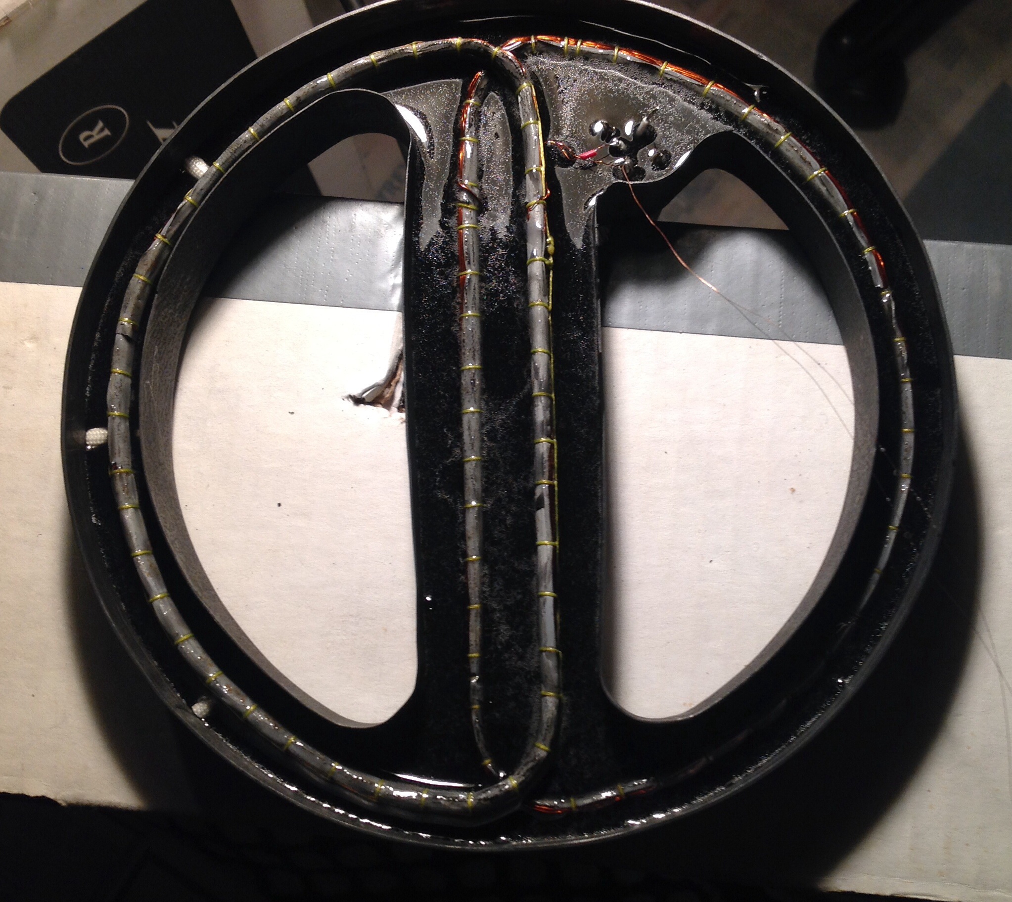

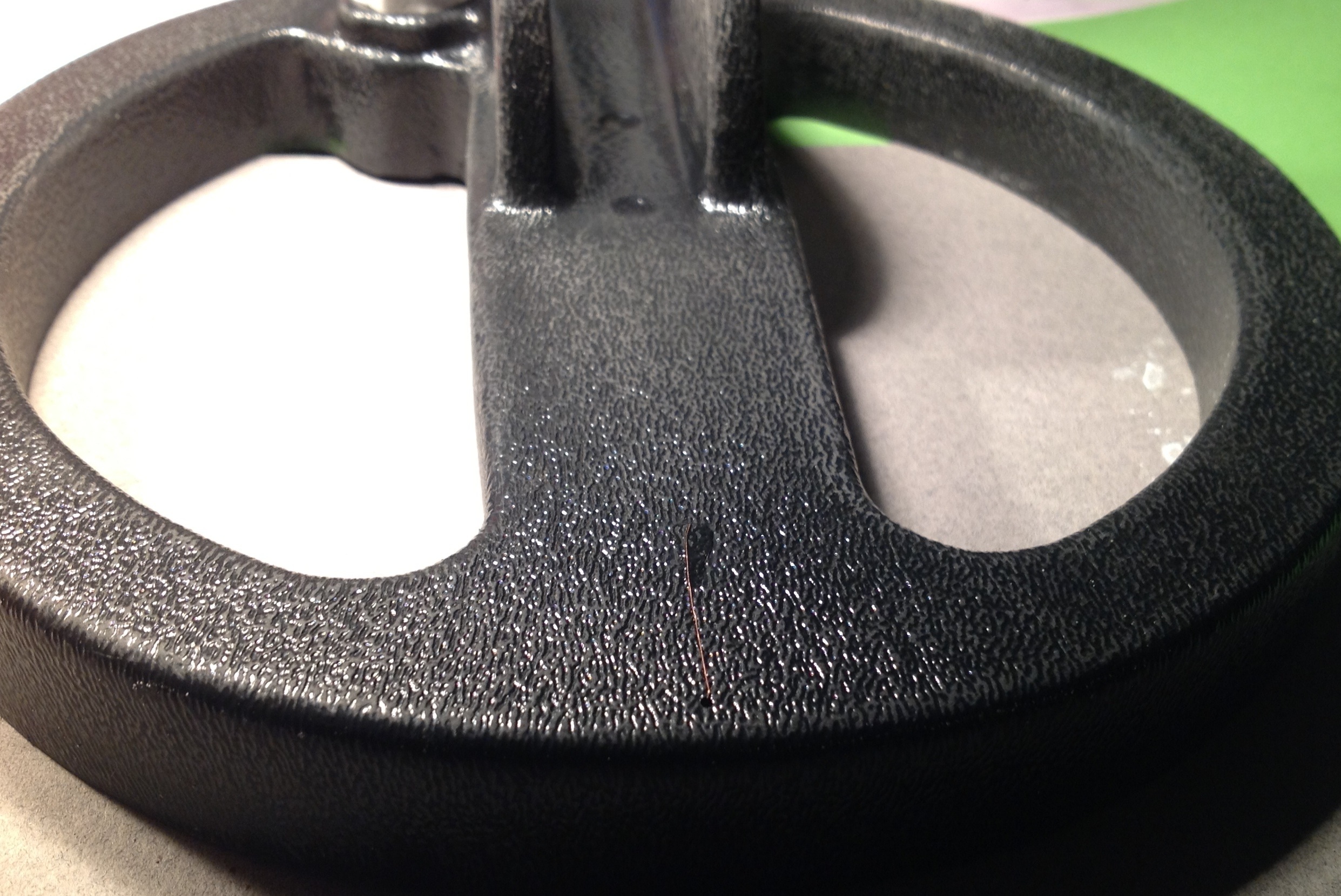

        Step 1. A working Deus coil must Be taken apart. At the electronic side you must lift of the lid at the top, its sealed with silicone and gentle losen the PBC board. Take some pictures before you disconnect the wires and make your own schematic. The thinny ones is the RX. If you want to scope something, ist a good time now. Picture 1.
        Be carefull with the wires coming out from the coil, you need to measure the RX and the TX in your Deus Stock coil.
        I was using a Bigfoot coil and that was measured : RX 15.9 mH - 70 ohm and the TX 10.4 mH - 20.4 ohm.

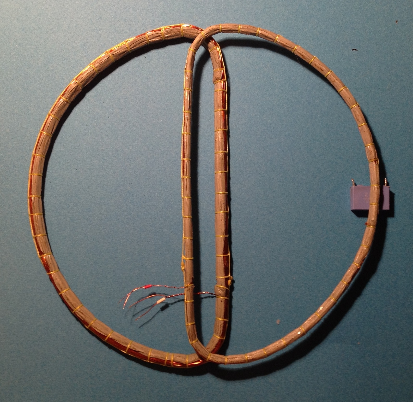

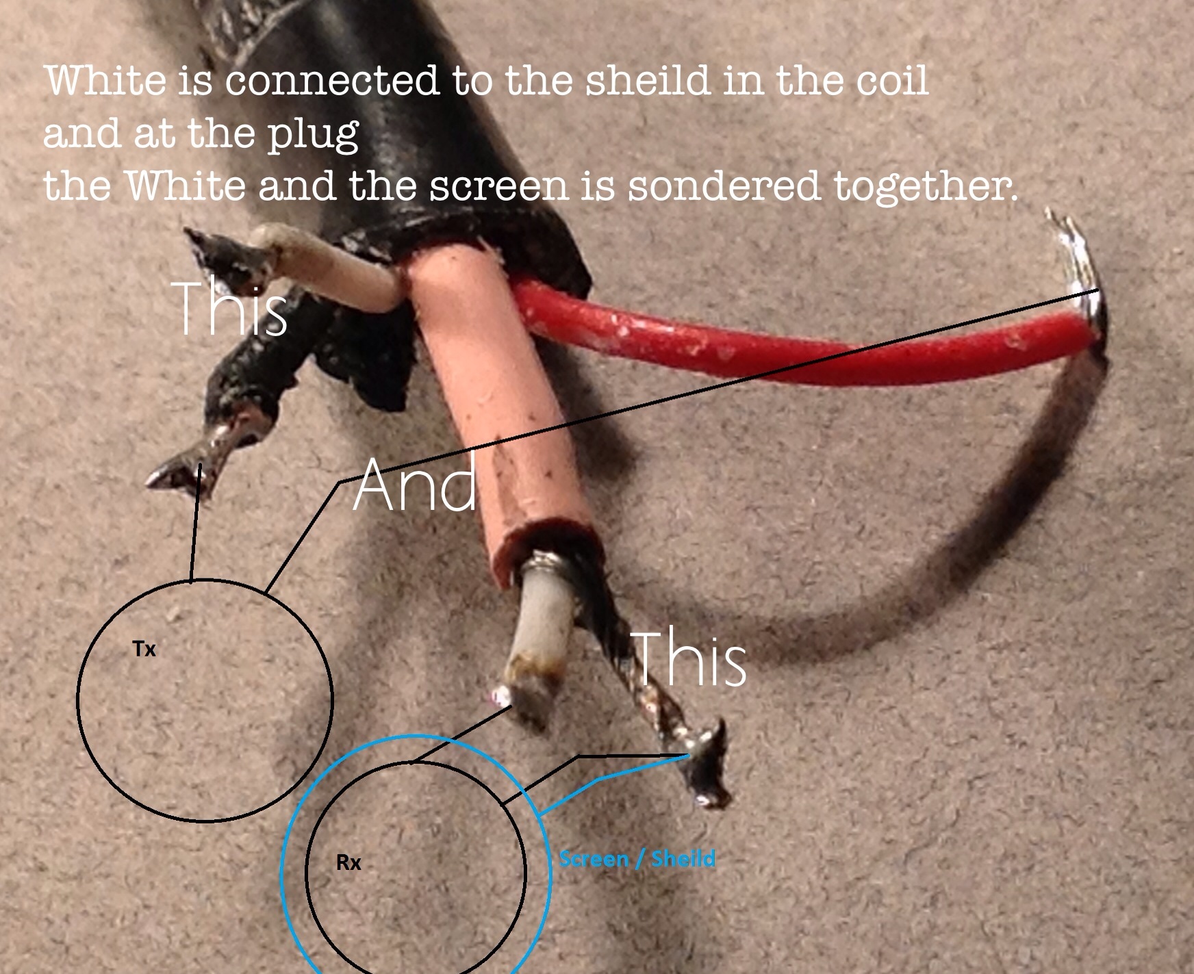

        Step 2. Find a little plastic box you can install the PBC board and a Battery and two plugs. You need only a 4 pin plug and mine choice was the standard microfone plug like them used at many detectors. Plug no. 2 is the charging plug.
        I found a mini USB chassic type, that gave the benefit that the Stock charger can Be used to charge the Battery.
        Battery either the Stock Battery or like I did or a stronger cell. Picture 2.

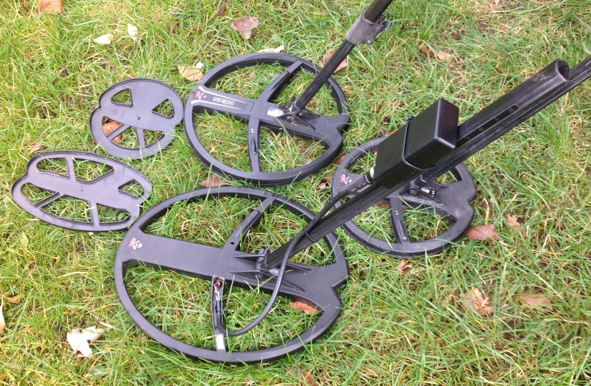

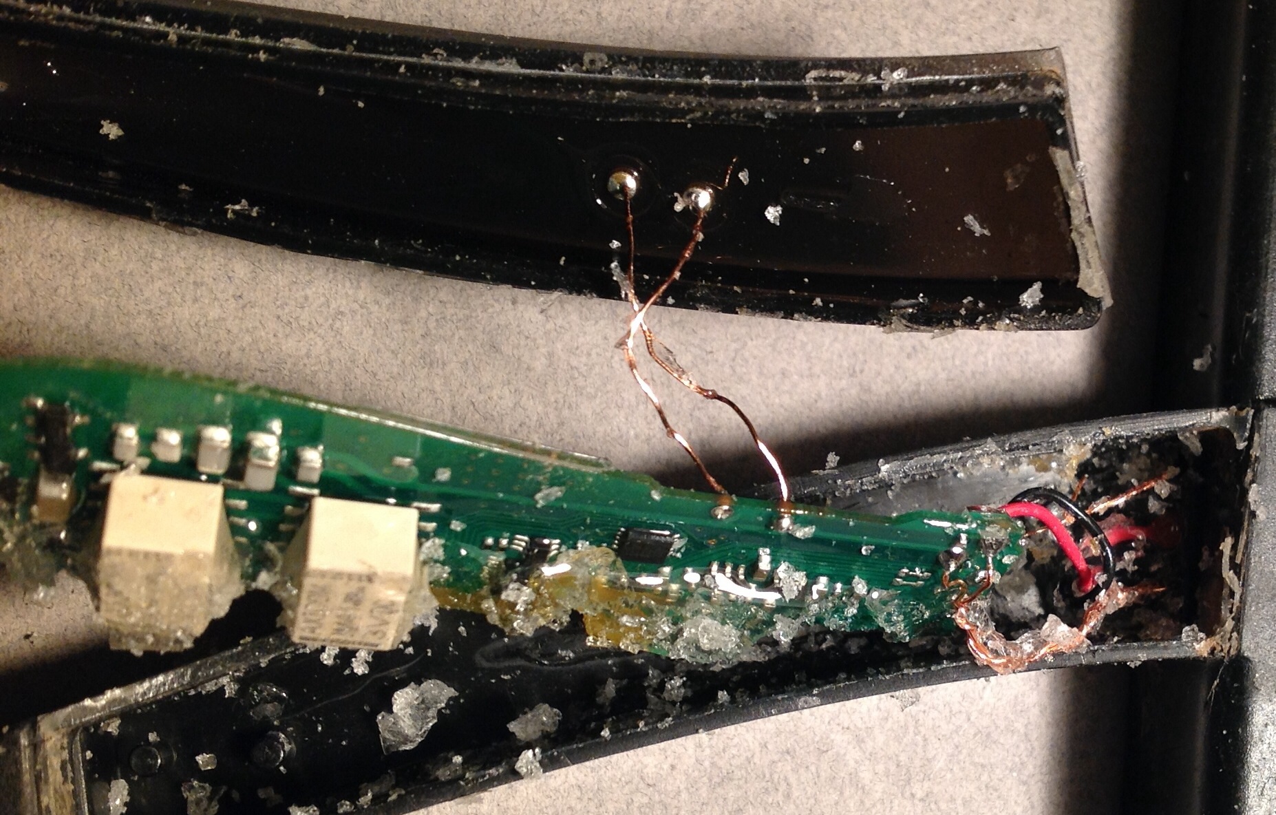

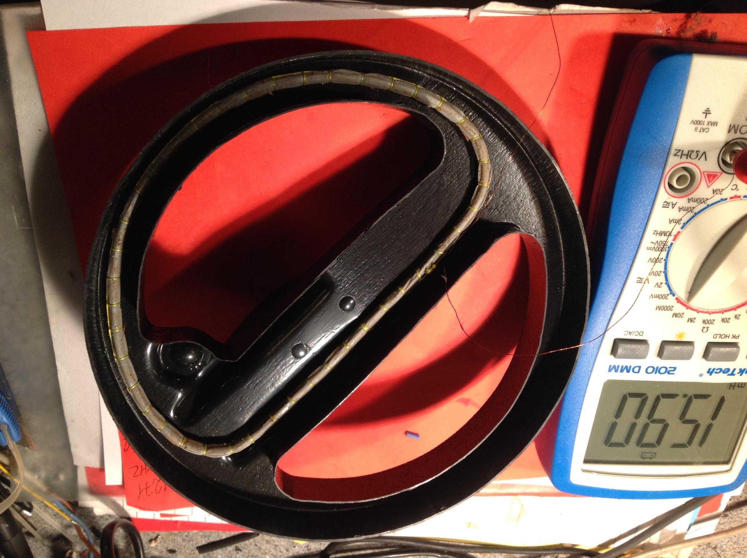

        Step 3. Cable at the Stock coil ! I had to take the Stock coil and put a cable with a plug at it, to see my project would work. Doing that you still got a working Stock coil, now just with a cable to the electronic. My cable is 40 cm long, just enough so the box can come up to the top at the lower stem... I found out that there must Be some distance between the control unit and the new little plastic box with the PBC board. (Overloading the signal I think). Picture 3 and 4.

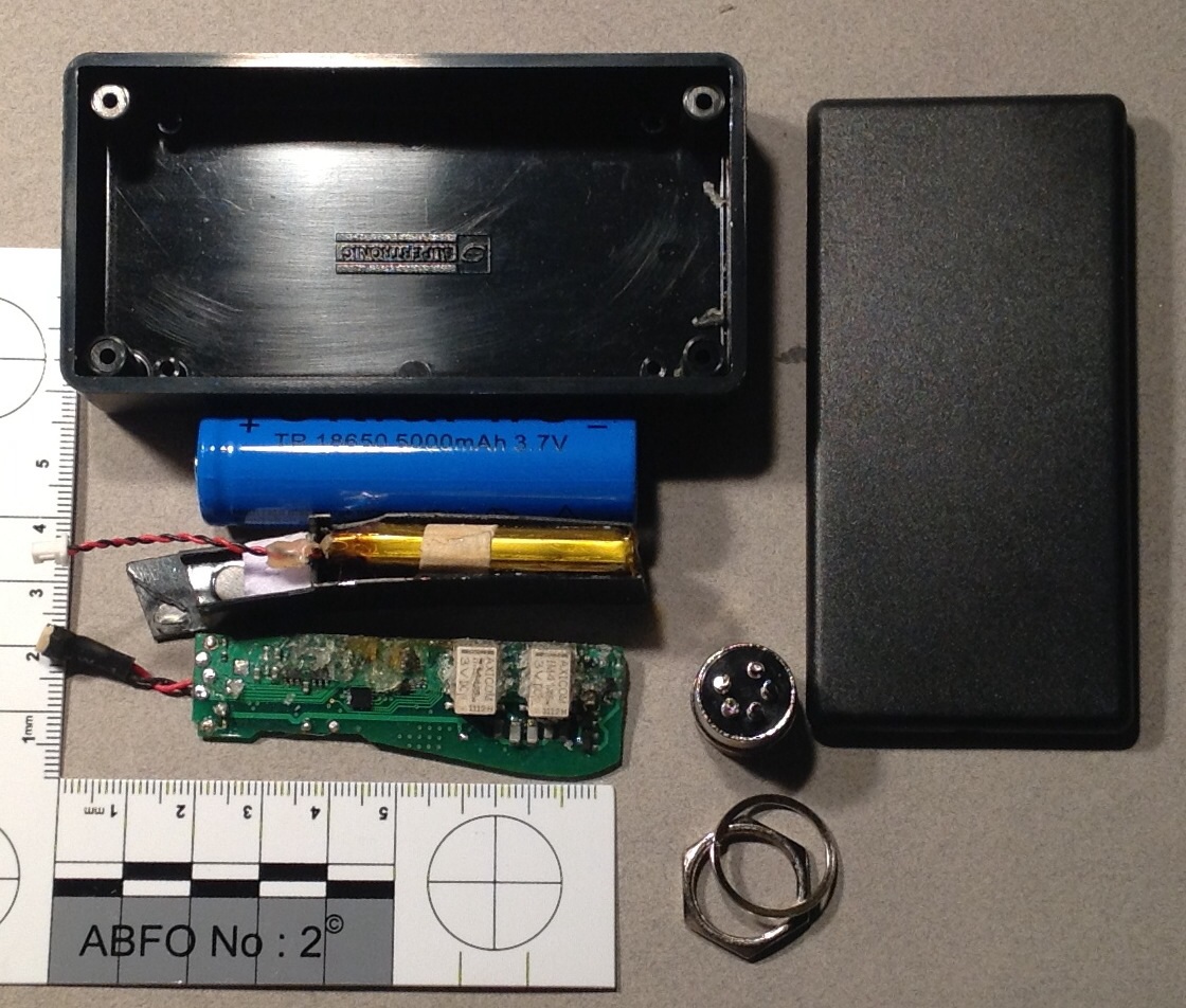

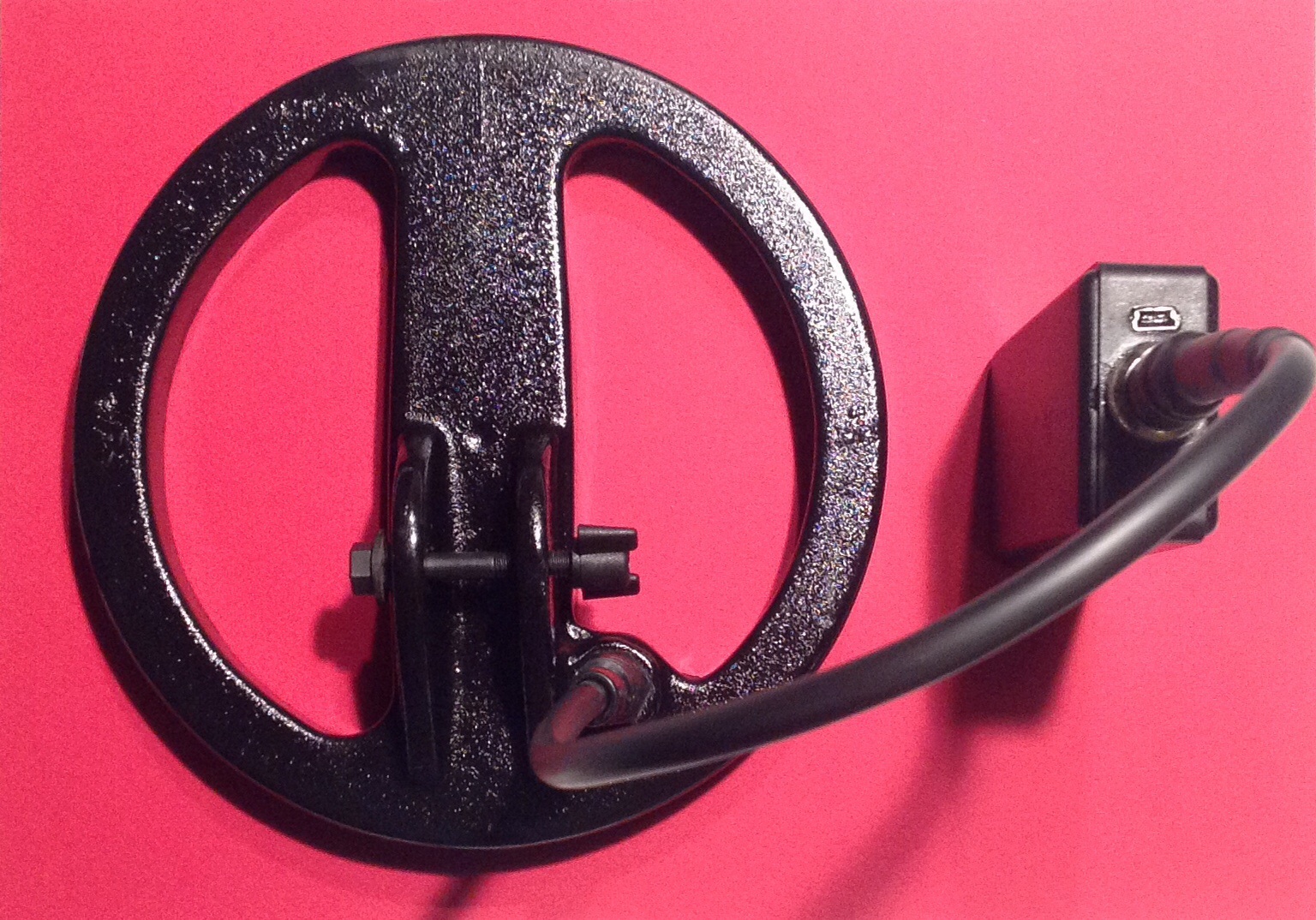

        Step 4. Now you are ready to make what ever coil you would like... I was first going after a 6" coil, but couldn't easy find a good Shell to work with. A helping hand gave me the information about DB Shells (Donald Bowers) and he was nice to help me with his 7" Shells. This was a Very good choice. Picture 5.

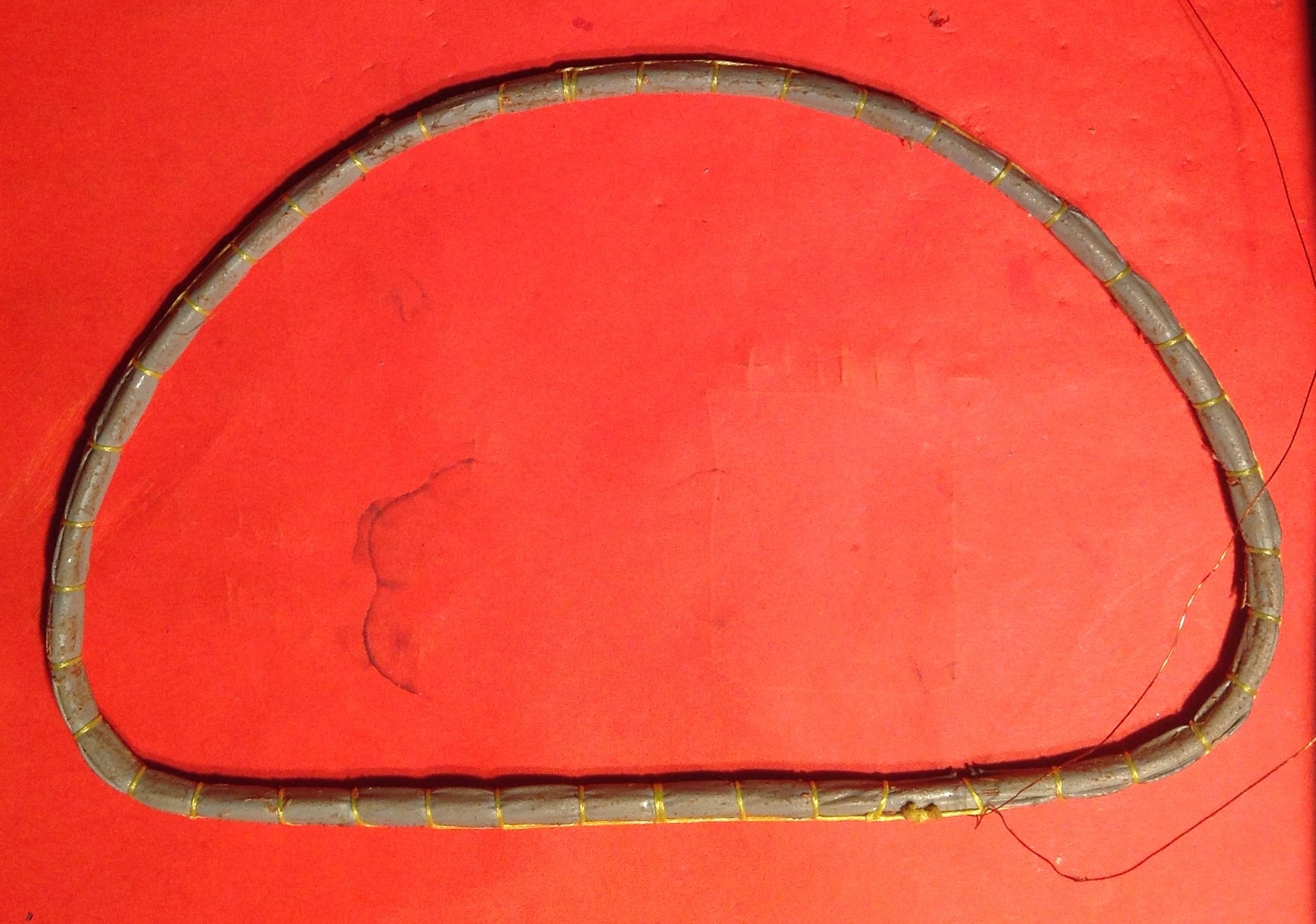

        Ps. The cable I used - picture 6. But I think that you can use S-VHS cable. (Look in the Thread information is to be found).

          Step 5. Now you must wind your RX and TX. By great help from the Coil Calculator, you can find the perfect wires to use. http://www.geotech1.com/forums/showt...oil-Calculator It is important that your close to the Stock coil resistance allso..(20 and 70 ohm).
          At mine 7" coil had the RX/TX a innerdiameter at 40.5 cm, but you need to add some turns % to hit your Inductance and that took some time to find out. I ended with 234 turns with AWG 0.18 wire at the RX and 198-200 turns with 0.315 wire at the TX.
          It is important that your Winding is done tight.. I was doing it by hand and was using the lack spray kontact 70 every 20 turns, and quickly after the Winding was finish, before the lack dryed up, I was tighting with some thin thread.
          Its a good idea to tight your coil every 1 cm with the thread, to make Your work Very stable.
          Skippy told me how I could take out the last 4 windings by par, to help in the end to find the Inductance . Like 196+2+2 turns. I didn't found out how, but you can find this idea in the Thread. Its no so difficult to take off one or two turns If you end to high, I had to do that, because I found out that the TX was sensitive to get this project to work. 10.45 was to high, the low ID didn't work, but after I came down to 10.35 mH I hit the nail. At the same time I was working with the resonans, and found that even more sensitive. By that I learned, that the Inductance is more a guiden, but the resonans is what we need to hit, and the TX is changing much in performance, the RX not so much.
          After I had made the RX and the TX coils, I had to shape the corners a little.. That lowered the Inductance a little and Helped me, because I was a little to high.

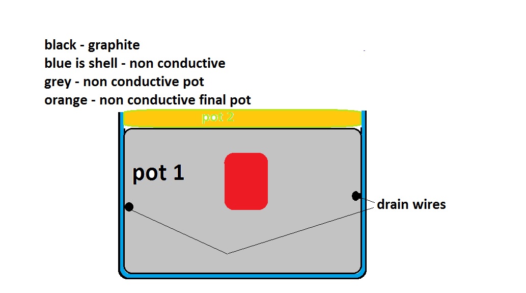

          The shielding was a nightmare to me... Inside shielding at the Shell, small wires from the inner to the outside, drainwires and shielding outside allso. All this made with Very much graphite 33 spray down to 300-500 ohm.
          I did like XP did, connect the drainwire to the RX cold side, and to me that was the RX wire from the start of the winding, the inner wirer. That worked.
          Step A was to paint the graphite inside the Shell, Remember small wires to the outer and the drain wires.
          I made the drain wires like a S, Remember allso the drain wire you shall use to close up your shielding, to the lay after you had fill up the first amount of the Compound mass.

                • Approx graphic of construction..

                        • I was just thinking about the external graphite coating, and the method you used to make a connection to the internal shield / ground. Then I realised that XP don't have to intentionally make a connection - they use the two battery charging pins to directly connect the outer graphite to the circuit. And because of the series-connected diode used in the charging circuitry, there is no need to isolate one of the terminals, as no current can leak. I guess on charge a small current must flow through the graphite, but it's a trivial amount.
                          • You are a genius - Skippy.. Perfect.
                            • Except for the fact that there needs to be a big unshielded region near the electronics circuit-board, so that the 2.4GHz antenna can work correctly...so maybe the charger contacts area is not coated. They could just paint the graphite around the edge of the hole where the electronics sits, so it links inner and outer surfaces.
                              • There is no shielding at this parts of the Shell the electronic is placed, and I just measured 1-2kohm from the outside to the inside lay,
                                and the charging pins is removed... Sorry !so that theory couldn't be right.
                                Skippy could you send me a PM with your adress.. Then I could send you the XP coil I open up. Maybee you find out the secret.
