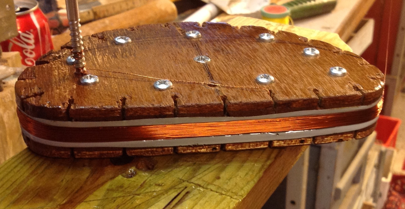

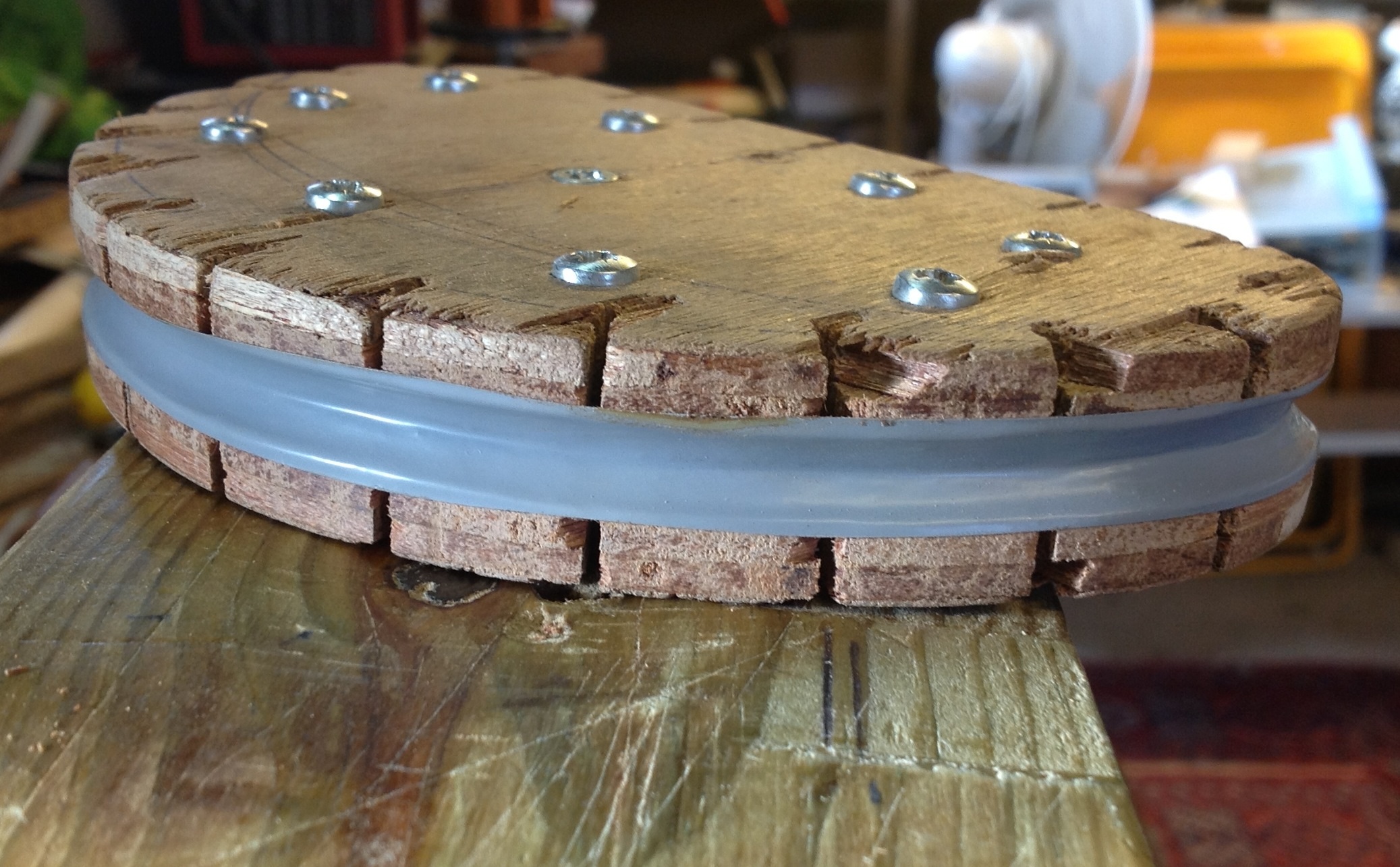

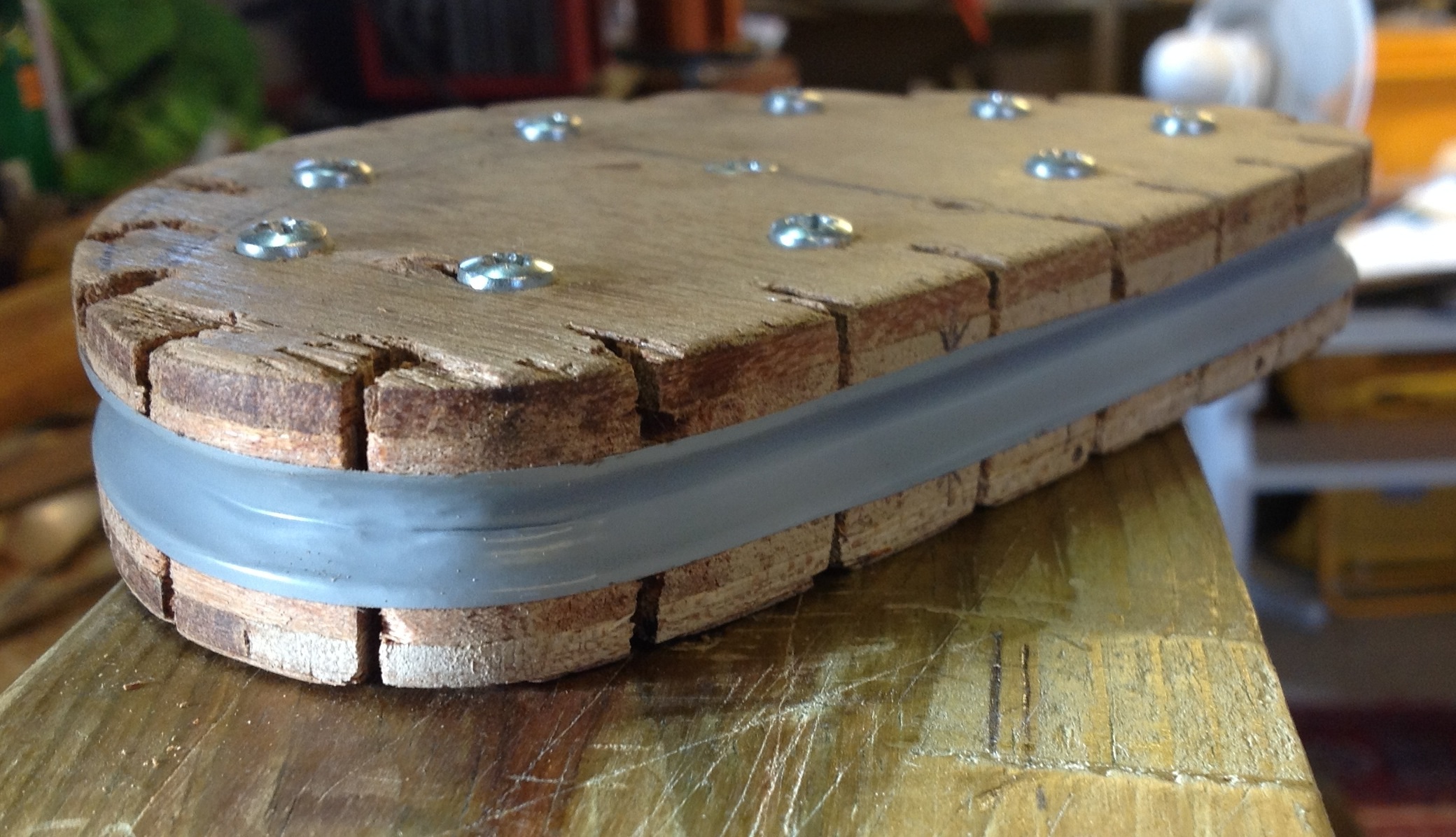

      Grey gave me and idea... I just changed it a little. The tubes are gone (so fare), and now its two pieces af hard Wood with a tunnel to the wires. Like Greys idea with the longitudedially cut, its just two pieces of Wood screwed together. And with Skippys idea to bundle with cotton thread, I made some small cuts in the Wood every 2 cm.
      One turn is 40 cm. / problem is I got no Shell to this, its made out of the blue air, just hopeing that the DB shell 7" will fits fine ! If not, its not so difficult to make a new one.
      Ps. I open up the 5 x 8" TX and it droped down to 9.05 mH.. So you where right Skippy, to lose wires... It wasn't the small eliptical design so much.

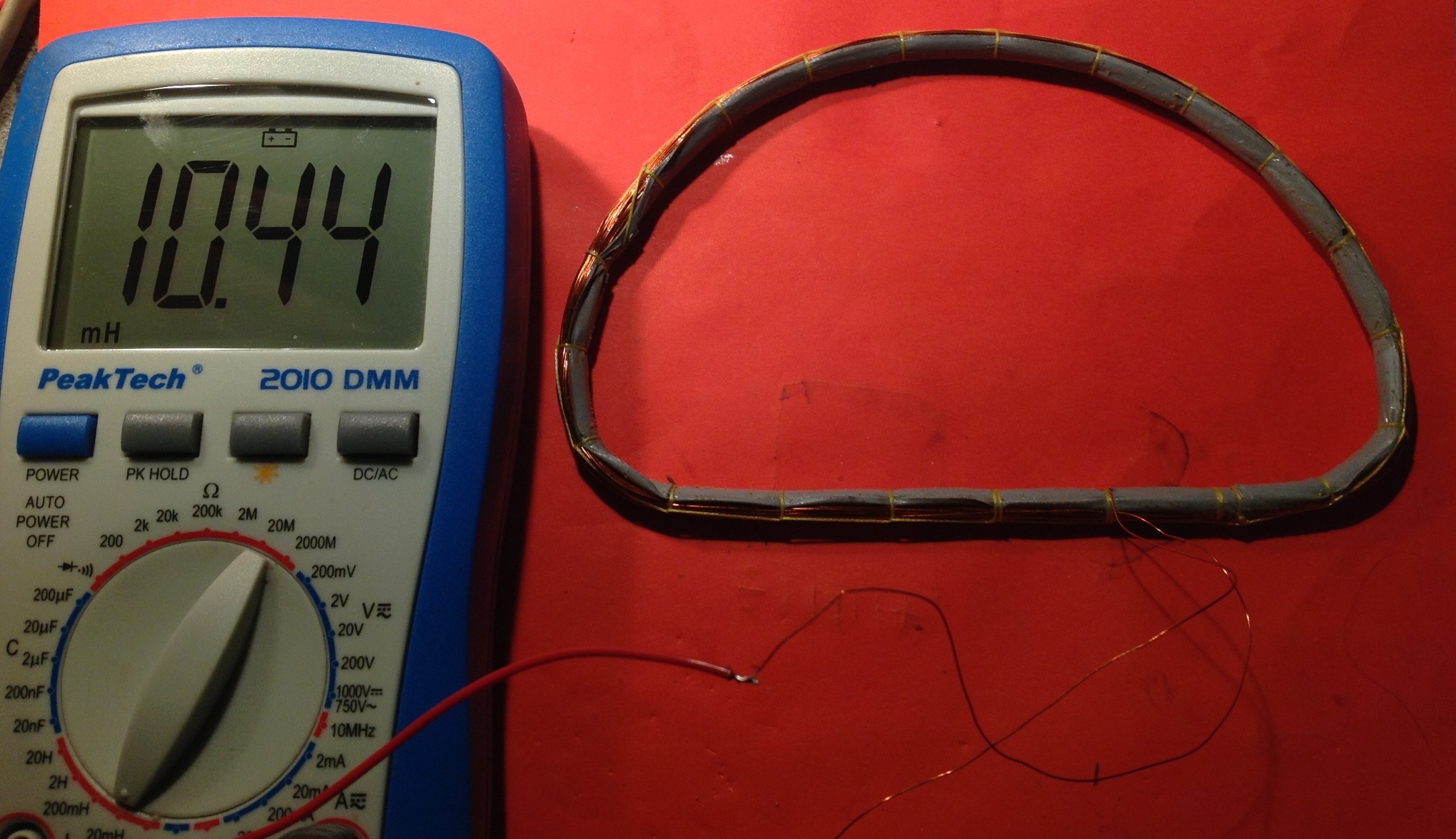

        Just made one TX and got the 10.4 mH, but a little high resistance 29 ohm. It was with 0.255 wire. (0.31 will Be needed)
        Henrik.

            • Party time.... TX ready 10.4 mH and 19 ohm. (Stock coil 10.4 and 20 ohm).
              199 turns with 0.315 wire.

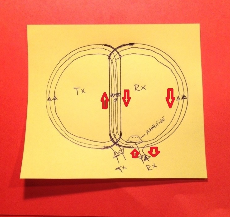

                • Need some good advice or help !
                  1 - 1 1/2 year ago I ask how to start the Winding at the RX and the TX... Picture showing the help I got.
                  Now I'm on to same issue again and wondering this ! If I wind the TX and RX exsactly the same way, and the same place to take out the wires to connect, it would end up with the hot side starting from the inner at one (TX) and the hot side starting from the outer side (RX)..... What would you do ? Any exsperience what the best result / performance is - Cold side starting from the Inner Winding or the outer side ? If I couldn't get any help, I would had let the hot side Be the outer side ( the ending af the coil ) at both the RX and the TX, because of Maybee small capacity to the Sheilding, because the outer windings got much more surface..
                  I Maybee long over target here.. But If I'm not asking - I never learning.
                  Ps. The RX and the TX got same cold side (ground at the board).
                  Thanks.
                  Henrik.
                  • I personally don't think it matters with a DD coil, especially if you are going to shield them from each other. Others may have different ideas.
                    Good luck with the second winding.

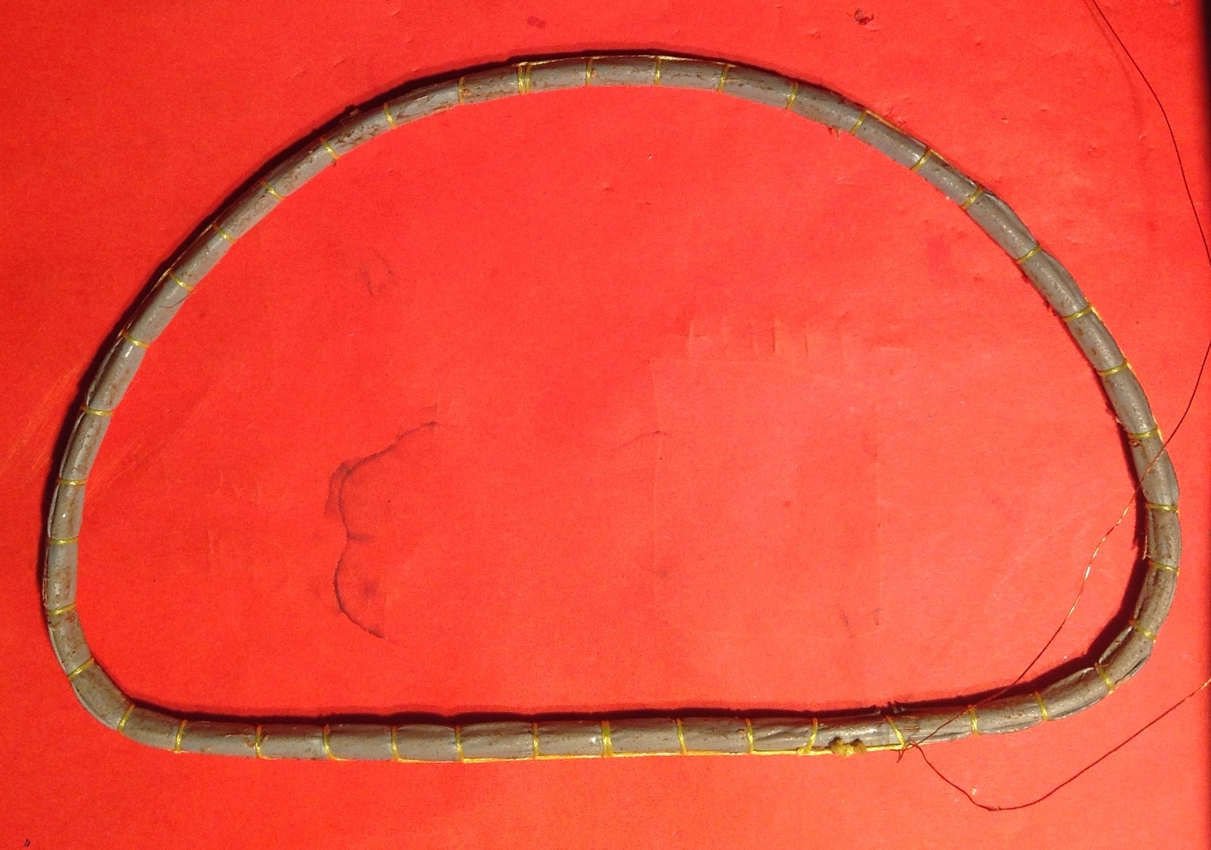

                          • Hi all.
                            Thanks for all the information about the Cell... I did a test some days ago, with a 50 ma and 100 ma draw both cells and the Stock cell went down to appoxly 15% after 6 hours. The blue one had 84% at 6 hours. Then I didn't do so much more. I know that 18650 isn't 5000ma but something like 2800-3300 ma, and Thats okay to me.

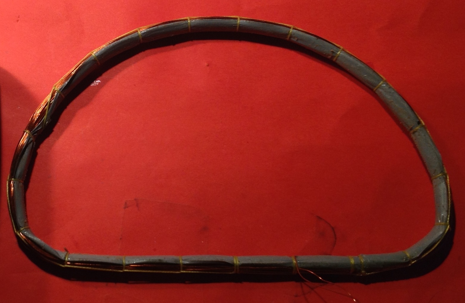

                            News... My TX coil was 10.4 mH - but after now after a day drying up, it went down to 10.1 mH.. Once more learning by doing, it wasn't tight enough, (you sayed it Skippy, I didn't listen). But got an idea to fix again.

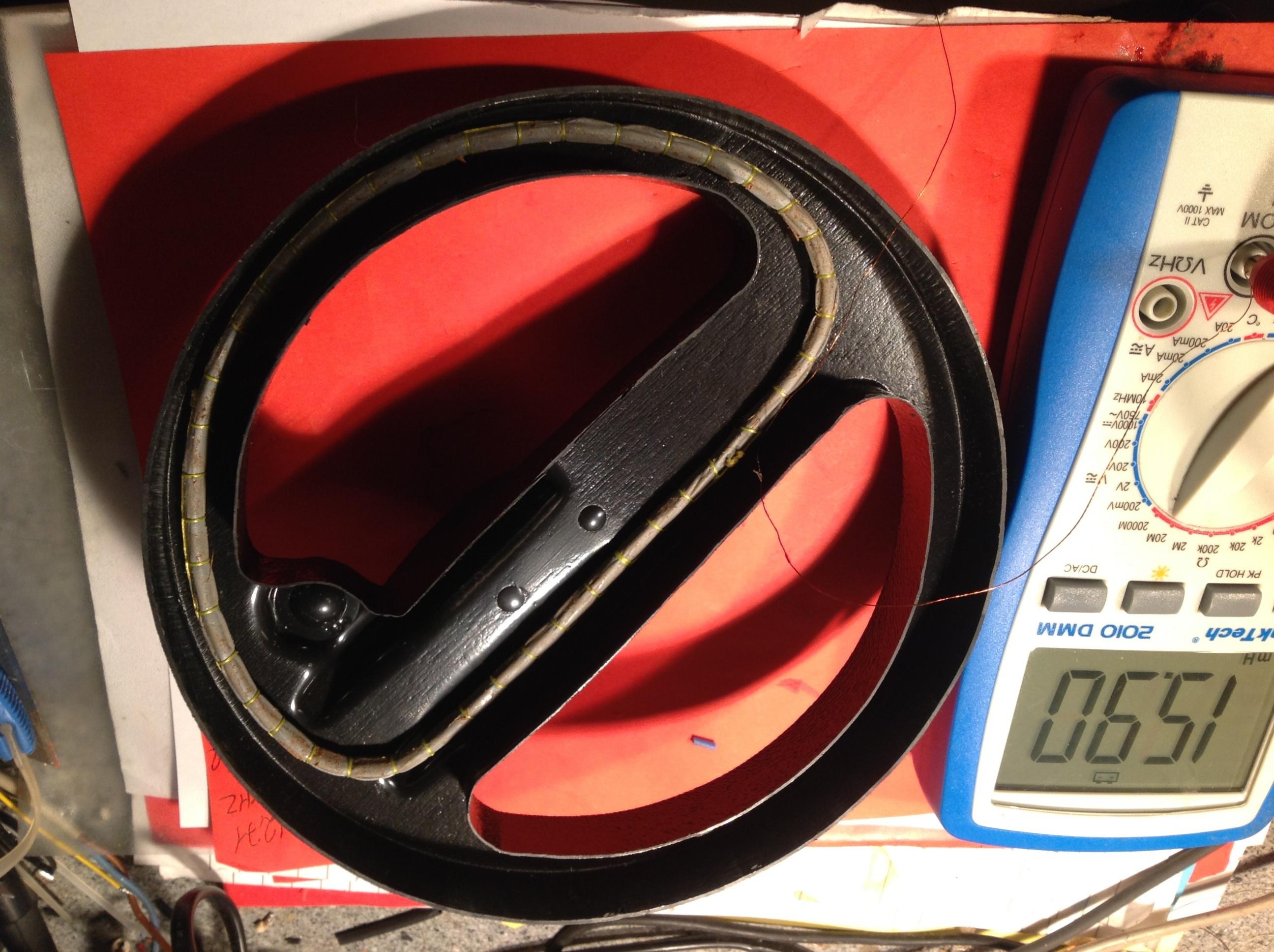

                            Just got the DB Shells.. Very nice made. Thanks Don. (See picture 1).
                            and how lucky can it Be ! The Shell and my coils it made like they where born together..

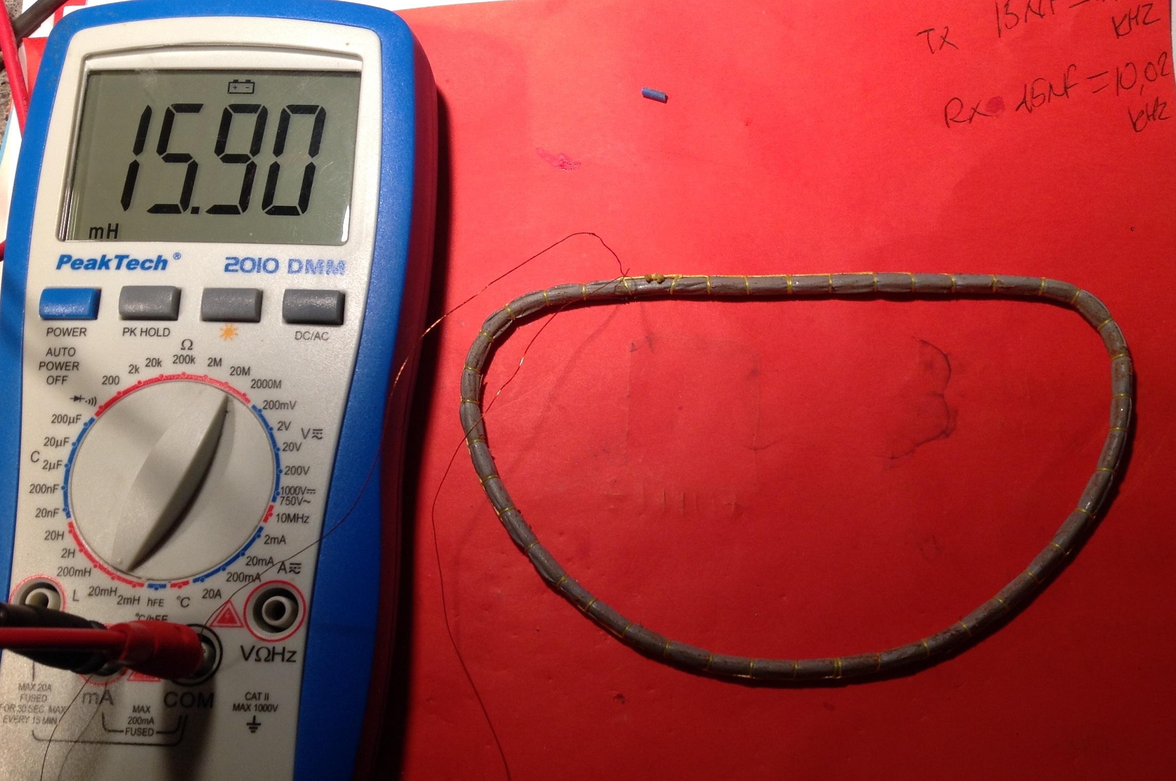

                            Pictures allso showing the I just finish second try with the RX... And now with cotton thread every 1 cm. Hope it will stay close to the 15.9 mH the goal was. This RX coil ended at 67 ohm, (70 ohm Stock coil). 230 turns with 0.18 wire. Appoxly 5-6% higher that the Calculator said.
                            This wooden sandwich construction to wind the coils is AWESOME to work with... Easy, fast, and Very exactly. First try with the RX - 234 turns and cotton every 2 cm gave 16.4 mH.. / then it was easy to figure out, 4 turns less.. And Bingo it hit the nail.
                            To morrow I have to heat up the TX (now 10.1 mH) gentle so the spray lack is getting soft, and then more cotton threads to tight it harder.. Then I'm sure it will go back to my goal 10.4 mH.
                            Then its time to connect and turn it on. Fingers crossed, that I dosn't need more turns to find a Null..
                            Ps. I made a LC test like I did with the Stock coil long time ago... And the resonans was close to the same, so I at the right track.
                            Ps. Its easy to finetune the enductance.... Just by changing the sharpe at the coil a little. But you who had work with this will know.
                            Ps. Skippy - the Shielding - please some help with that.
                            See you tomorrow.
                            Henrik.
                            • Hi Henrikras,
                              how much costs your digital-meter?
                              btw. meanwhile there also exists some with LCD-screen-scope on it for very good price.
                              about the coil:
                              the less mH the less depth and stability if e-smog or high mineralization occures.
                              You will not find good metal with just one wire-loop.

                              • Hi.
                                The multimeter I got is a peaktech 2010. That model is out of Stock, but this is a alternative (30 € only) link. http://www.reichelt.de/Multimeter-di...=PEAKTECH+2005
                                A Big coil to the Deus could Be an idea, but first this small coil project and Maybee a even smaller one later. Your fields properly different that mine, but I got Serius problems with iron masking the goodies. Thats why this idea came up.
