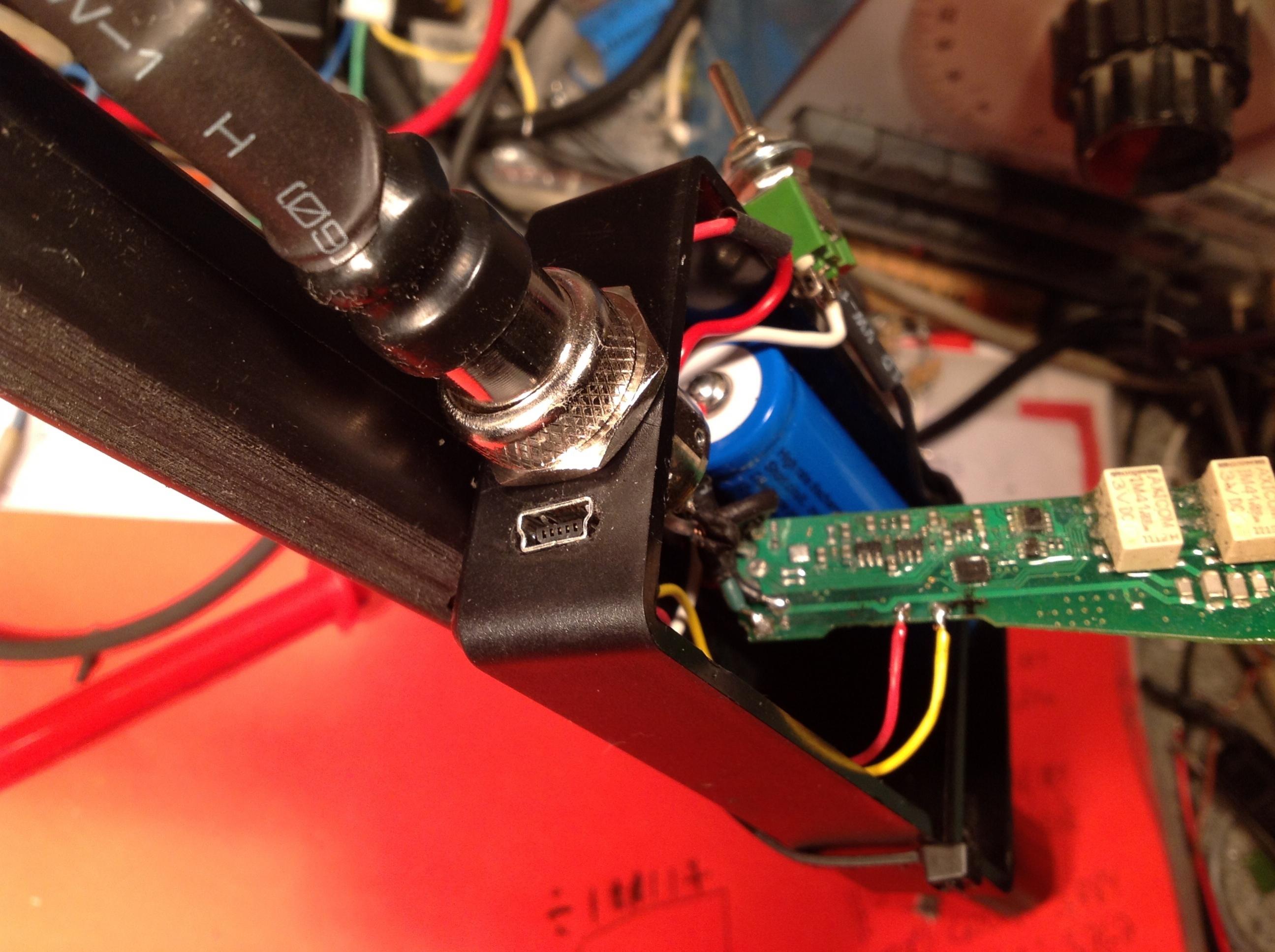

                                Just finish with the charge plug.. ! Mini USB just like the Deus control unit and Headphones. (See picture)
                                From now - coil production. Got all the AWG. Shell from DB is allso at its way, to make a test with a 7".
                                Thank you so fare..
