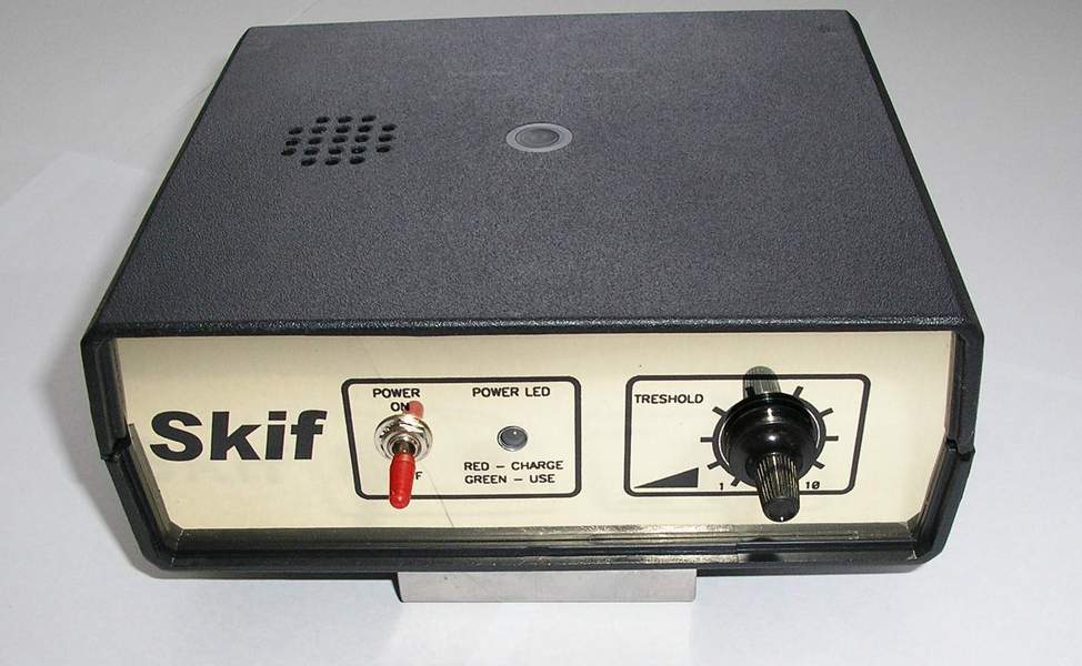

          • #80
            this is not DP, this is SKIF, THE bright example how to write the manual for dummies. no pots - no tuning - touch nothing, turn on and Go.
            no questions, no long reports, nothing of libel by innuendo )))
            gold rule - DELETE ALL POTS.

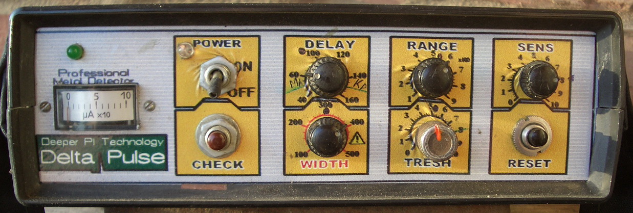

            • #81
              what is this pot you turn in the video?
              at pic.

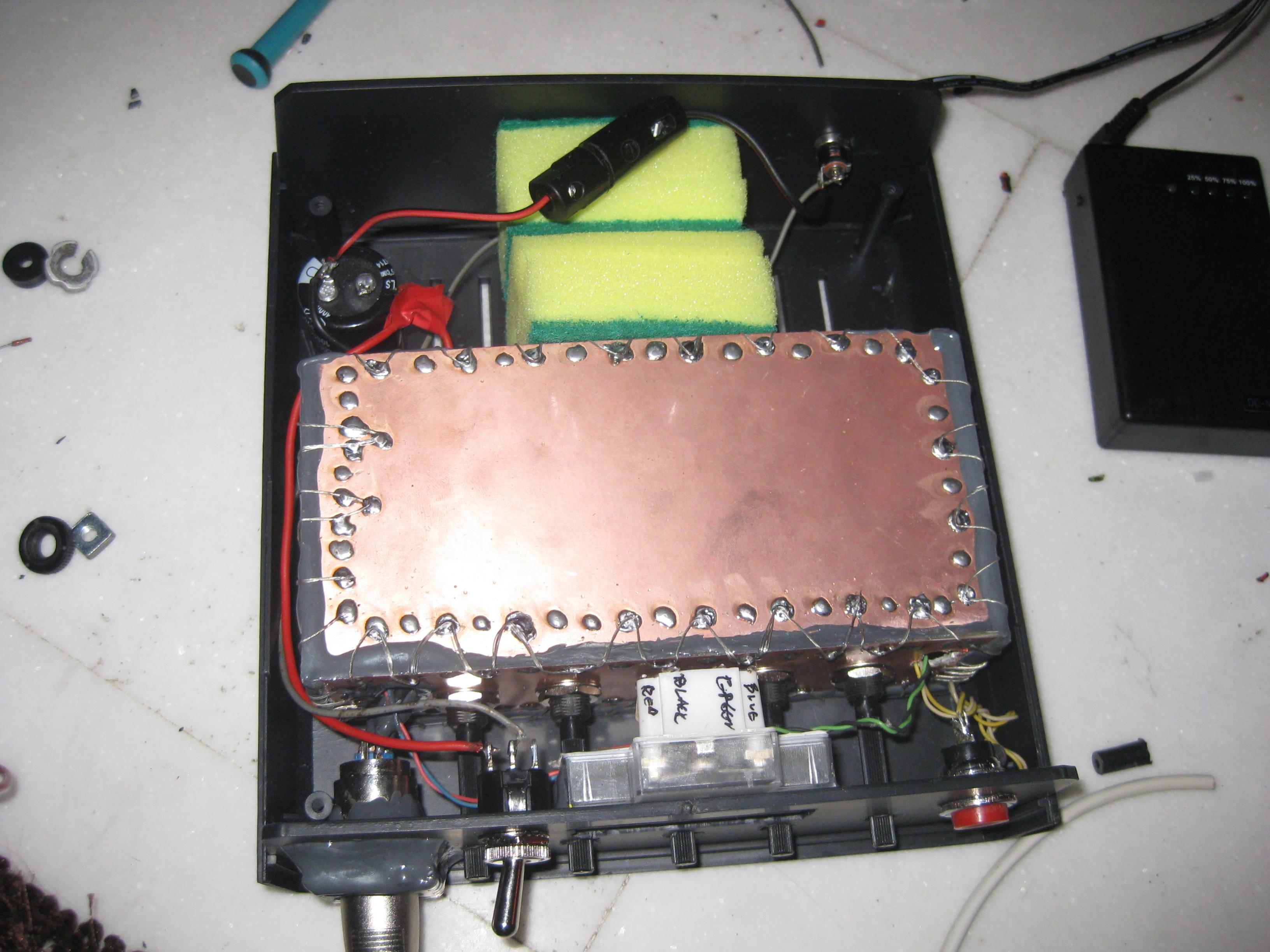

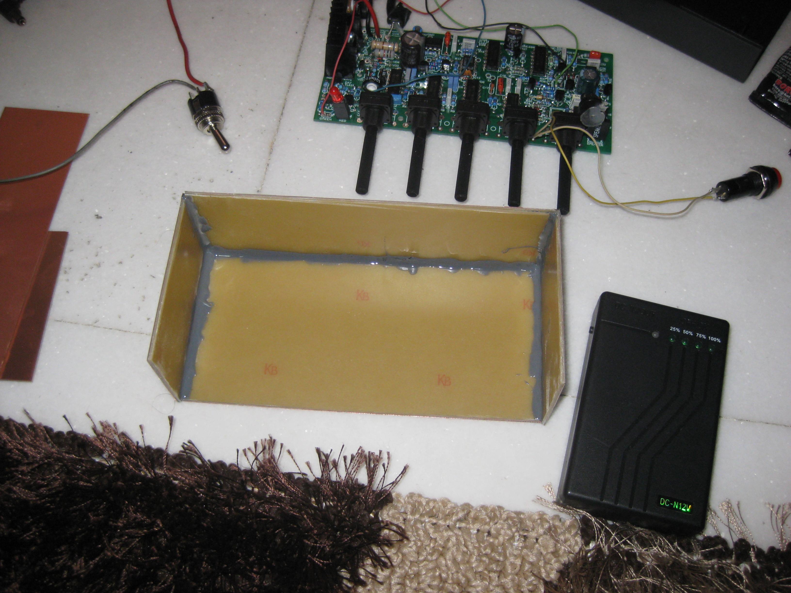

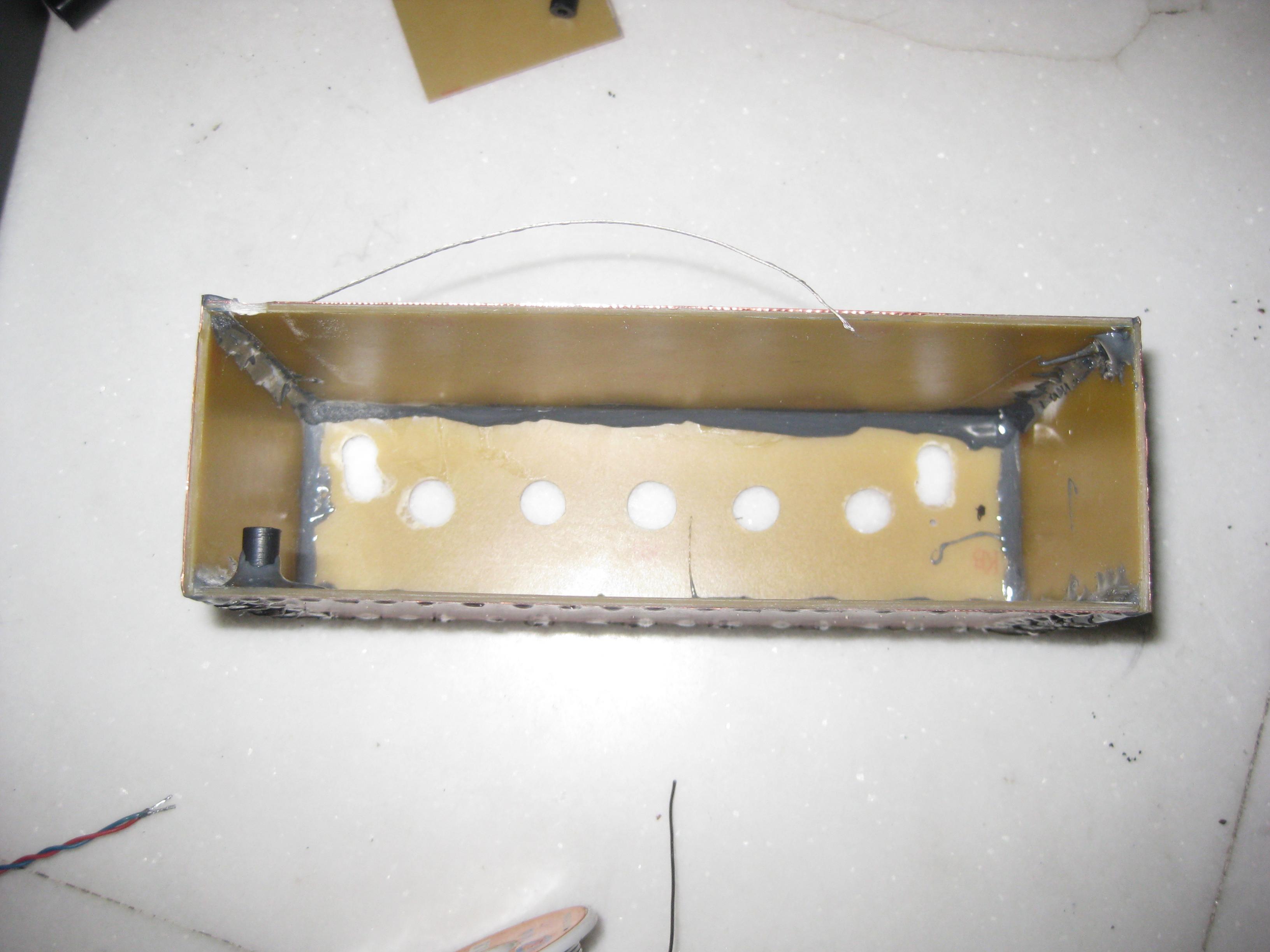

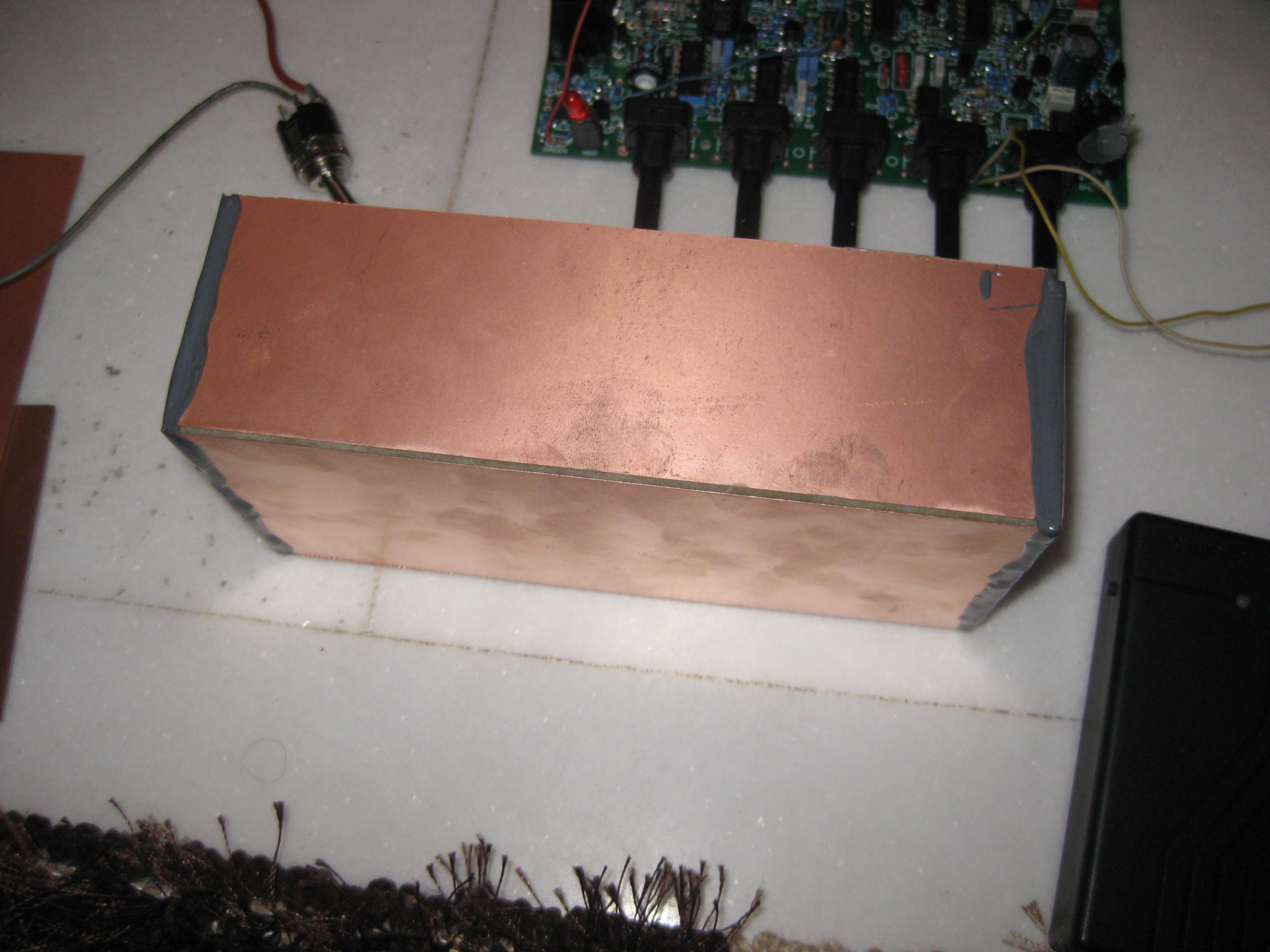

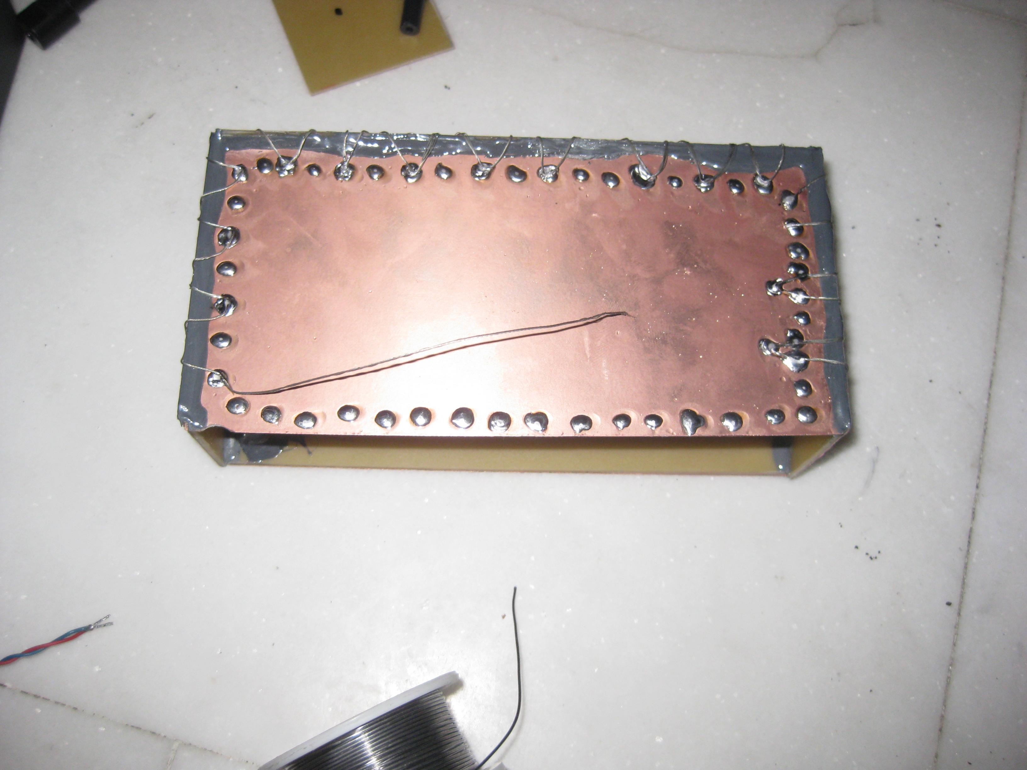

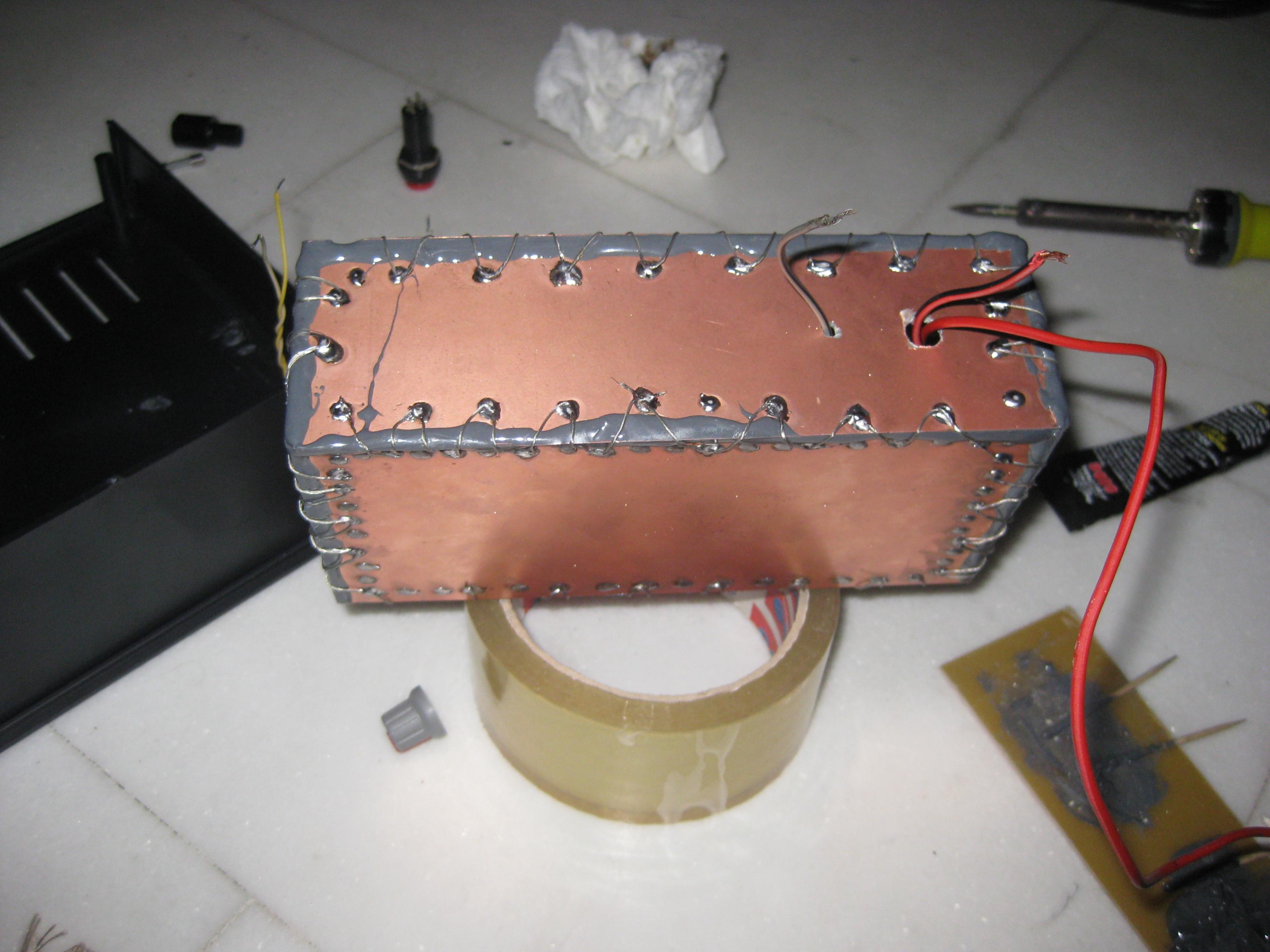

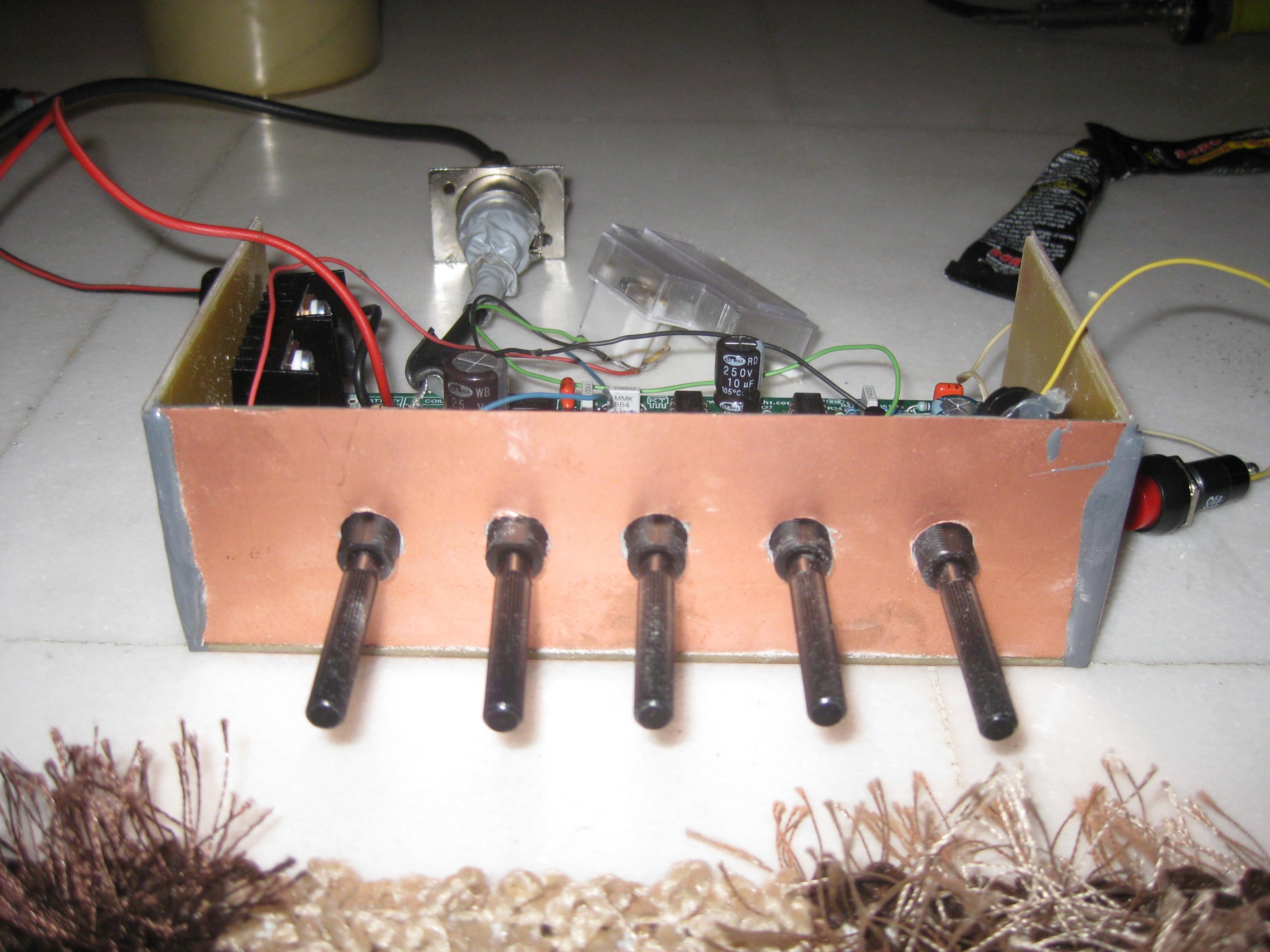

                  some pictures:
                  Almost everything, ready to assembly:

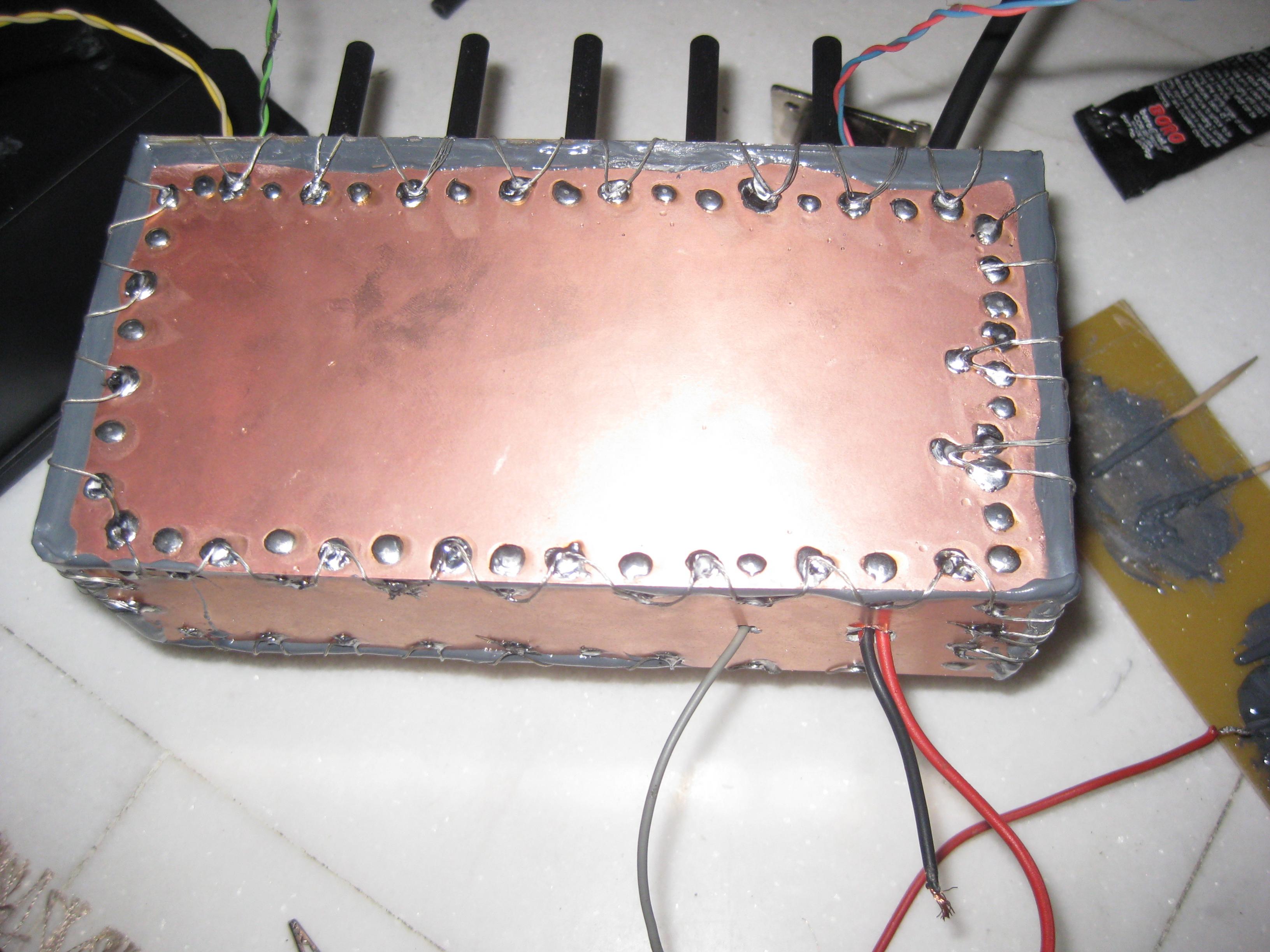

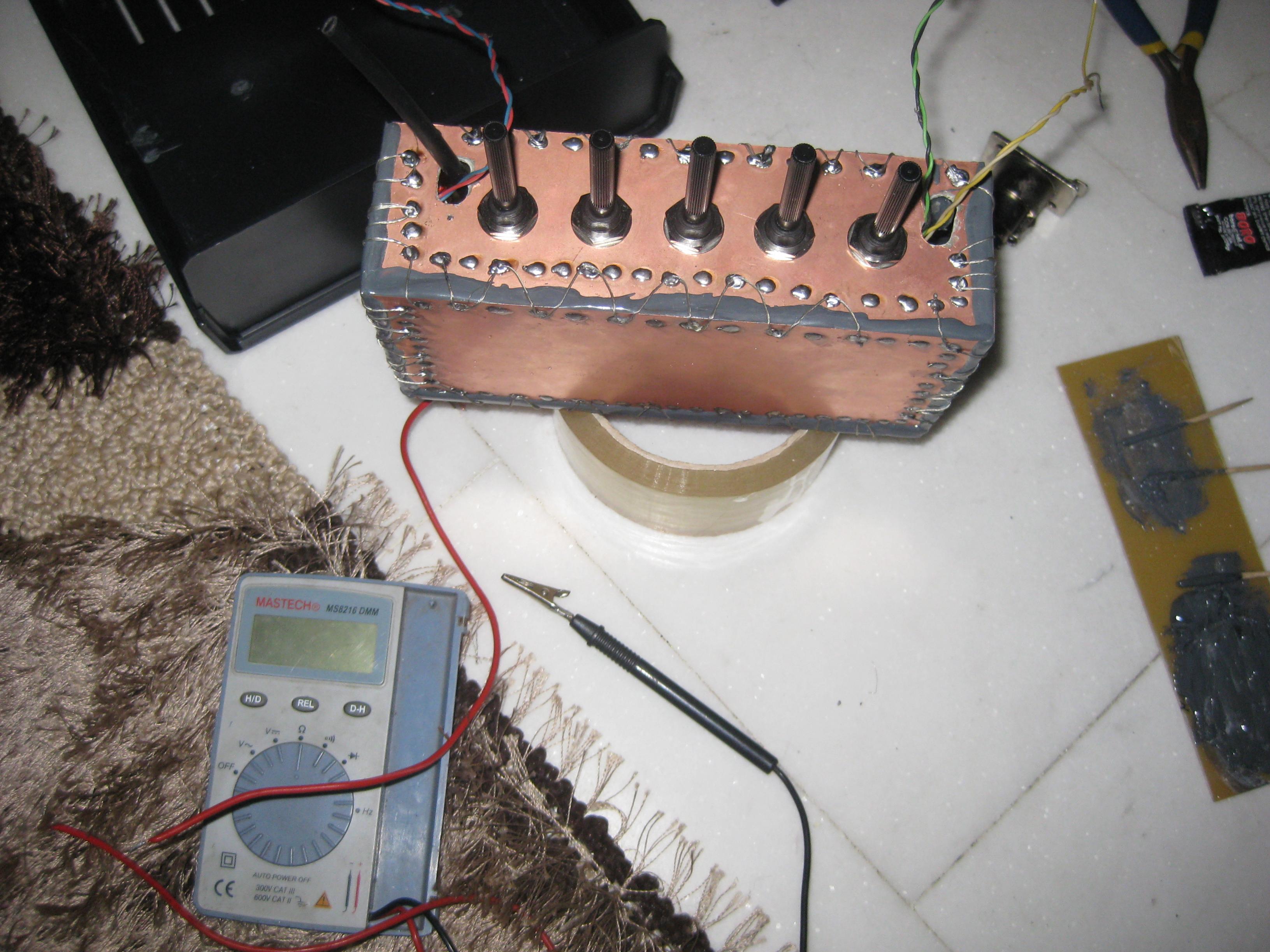

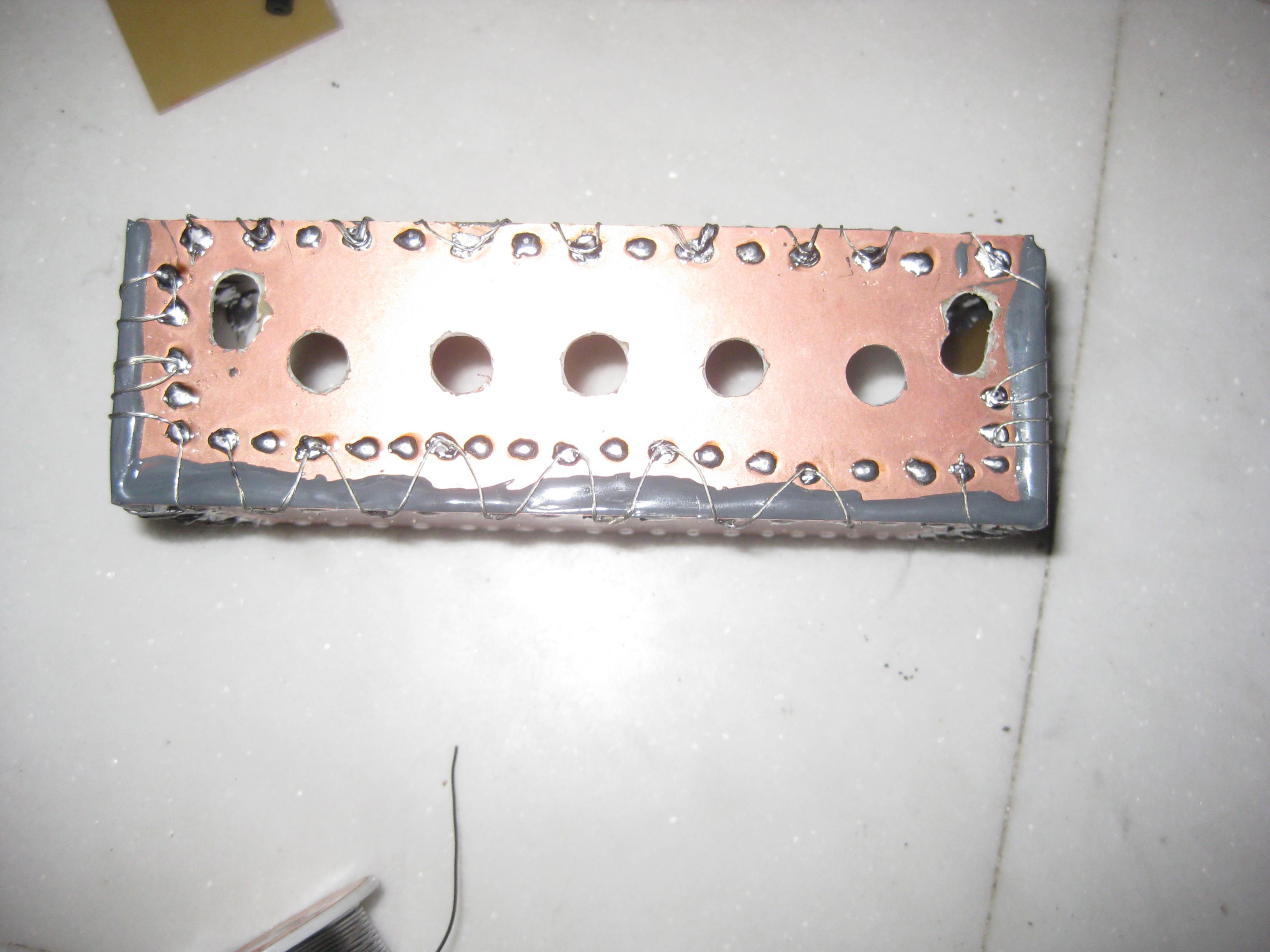

                  metal box shield:
                  made from pcb, cut then glued with superglue, then with 2 elemnts very strong glue
                  after the box is complete every side will be connected to each other with many wires

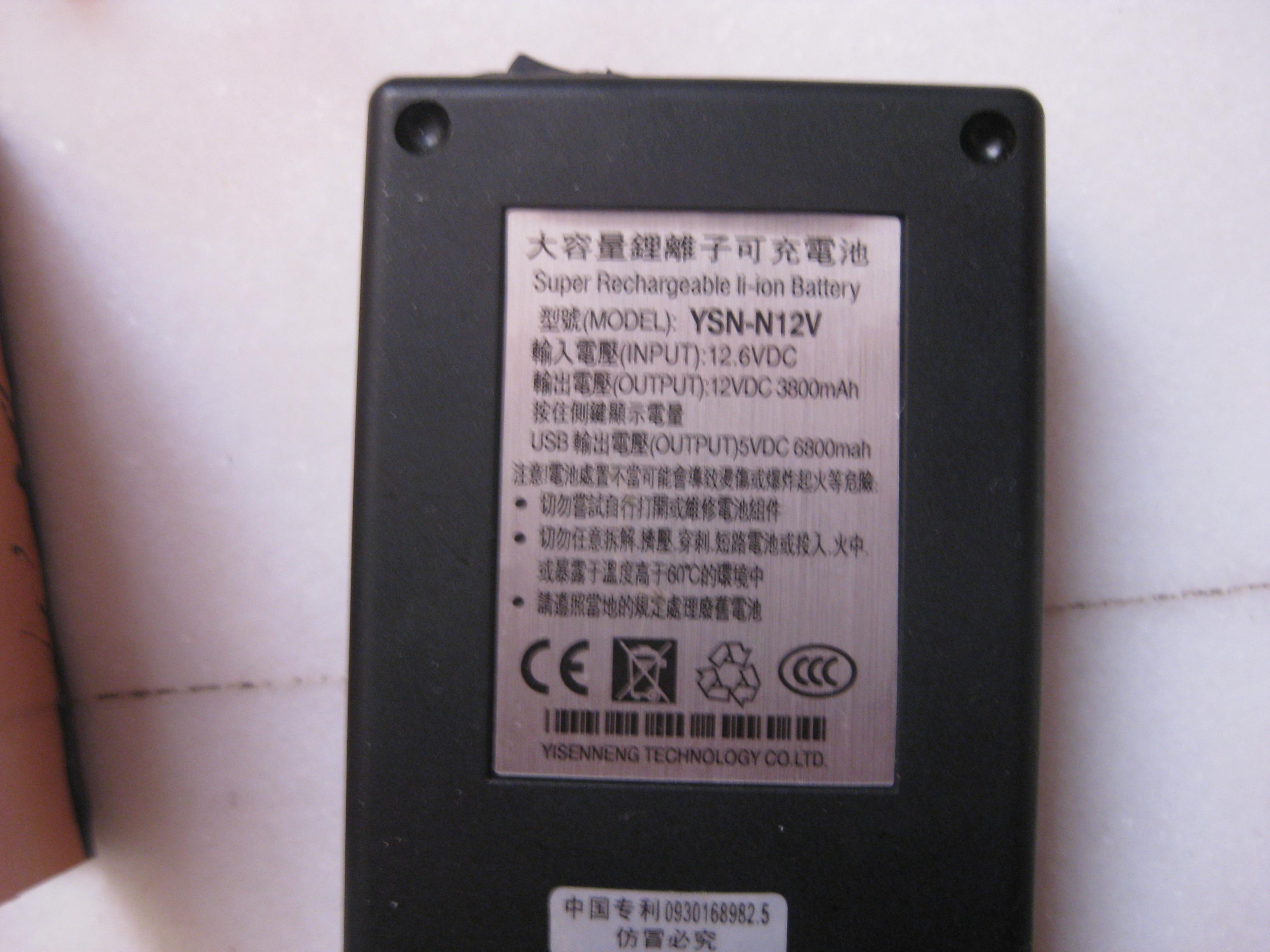

                  nice lithium battery from ebay, light, easy to charge, cheap, lasts for 6hours continus usage
                  over/under voltage protection
                  short circuit protection

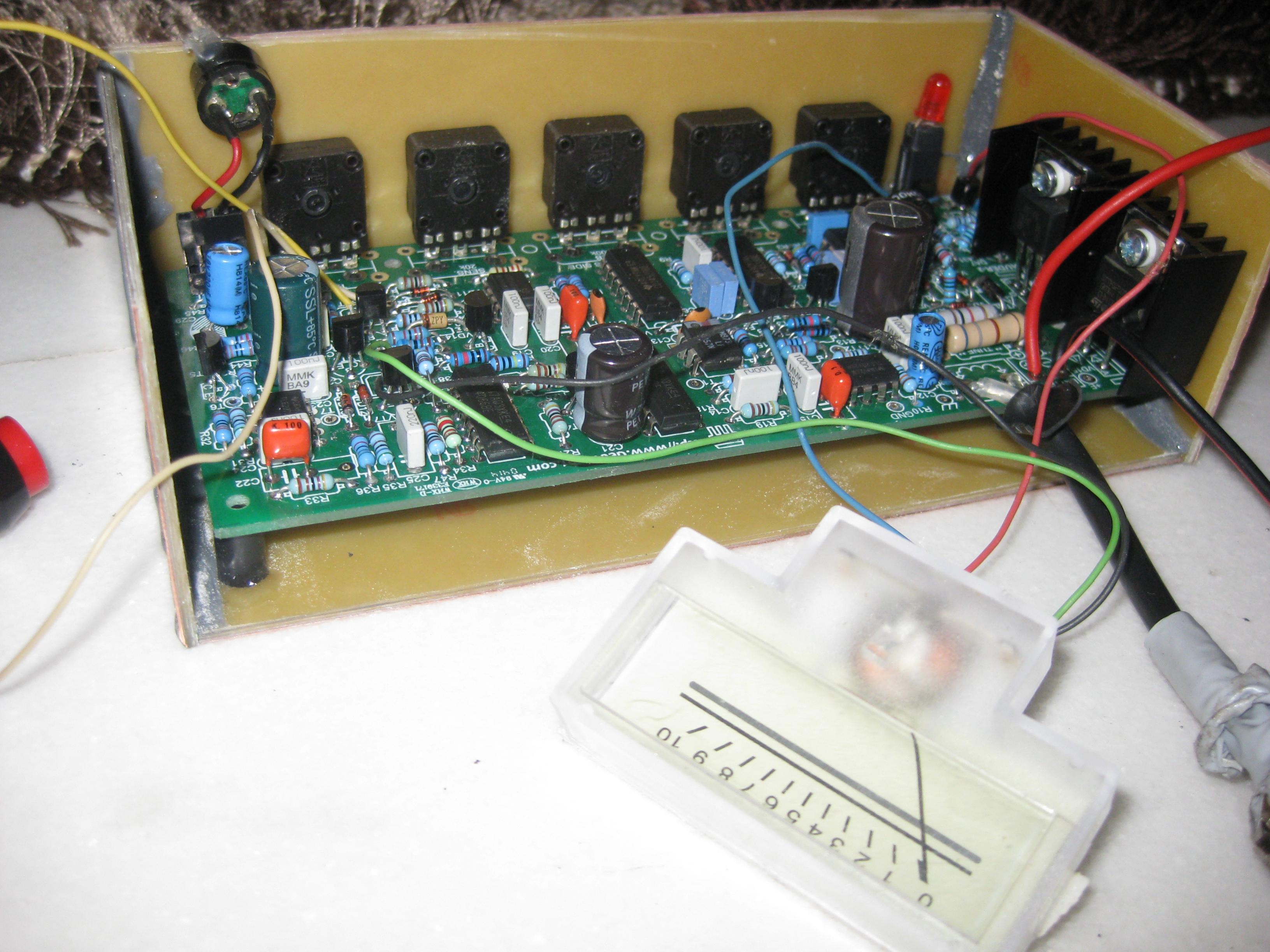

                  • #84
                    VERY VERY NICE JOB! but be attentionally with these chinese power supplies - although there written 12,6 voltage output
                    it can give you 14 and more voltage, that can be danger for DP -!
                    connect a resistor to PS output, 5-12 watt, 120 ohm will give you approx 0.1 A 100 mA, then measure voltage on the R.
                    you have to see no more than 12-13V that will be OK faraway in your job.
                    • #85
                      thanks for the tip! this power supply is tested for two years and is very nice! it gives 12,5 volts stady until its empty.
                      pure luck for chinese stuff!!

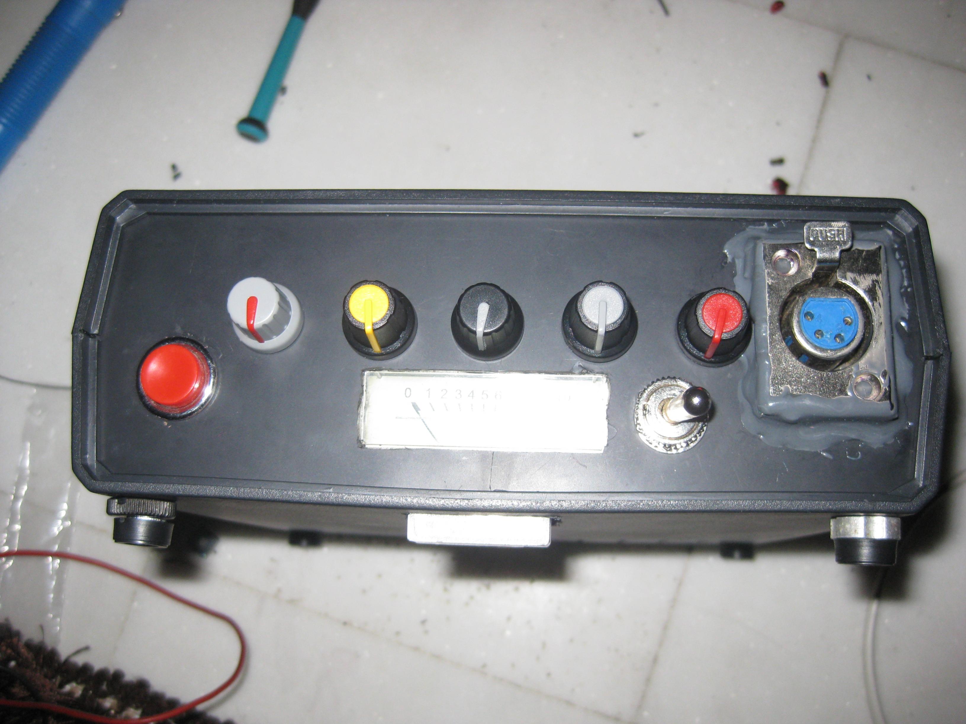

                      i post some pictures of the finished product
                      any questions welcome

                      • #86
                        [ATTACH]32504[/ATTACH]
                        [ATTACH]32512[/ATTACH]
                        [ATTACH]32511[/ATTACH]
                        [ATTACH]32510[/ATTACH]
                        [ATTACH]32509[/ATTACH]
                        [ATTACH]32508[/ATTACH]
                        [ATTACH]32507[/ATTACH]
                        [ATTACH]32506[/ATTACH]
                        [ATTACH]32505[/ATTACH]
                        [ATTACH]32513[/ATTACH]
                        hi
                        good work
                        why use copper box for shield ? and dont use graphite ( same method like KT)
                        i wait for you to test and put result here.
                        • #87
                          hello, i used copper box because this was what i had and did not want to search anymore for parts in the shops, its an overkill but no one can say "the word interferrence" now!
                          one mod i will do next time i will open up the box is 20k pot at threshold. no matter how much KT is screaming, i WILL try it
                          i will post test results as soon as i make proper coils, for now, 2cm coin at 22cm distance with 25cm diameter coil 700uh (bat coil)
