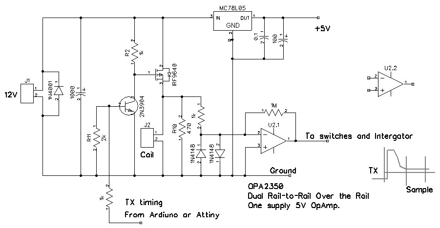

    • TX from SurfPI looks even more simple. 555 drives MOSFET IRF9640 without any transistors. Also 8 pins dual Rail-to-Rail OpAmp like OPA2350 is perfect for the job. But proper conversion of schematic is required.
      • WS what other projects have you used a OPA2350 in ?
          Really poor spec's makes it hopeless for a frontend amp. At 10khz has about 7nV/√Hz and below 10hz looks to be well over 100nV/√Hz
            I am experimenting with OPA2350 to build Ardiuno PI or front end for any Attiny / Atmega MC.
            That OpAmp is good enough to use as preamplifier and integrator too because it is dual OpAmp
            with low noise, high slew rate and an input common-mode voltage range that extends 300mV below ground
            and 300mV above the one 5V positive supply.
            Most interesting that it is one power supply 5V Rail-to-Rail OpAmp with ability to work with input that goes over the rail voltage.
            It fits our situation when flyback voltage goed down to negative values over the ground rail but can be amplified by OPA2350 without additional -5V power supply.
            http://www.ti.com/lit/ds/sbos099c/sbos099c.pdf
            WIDE BANDWIDTH: 38MHz
            HIGH SLEW RATE: 22V/μs
            LOW NOISE: 5nV/√Hz
            So you can hook it up to your coil without using -5V converter to make negative power supply voltage
            and use second amplifier in case as integrator.

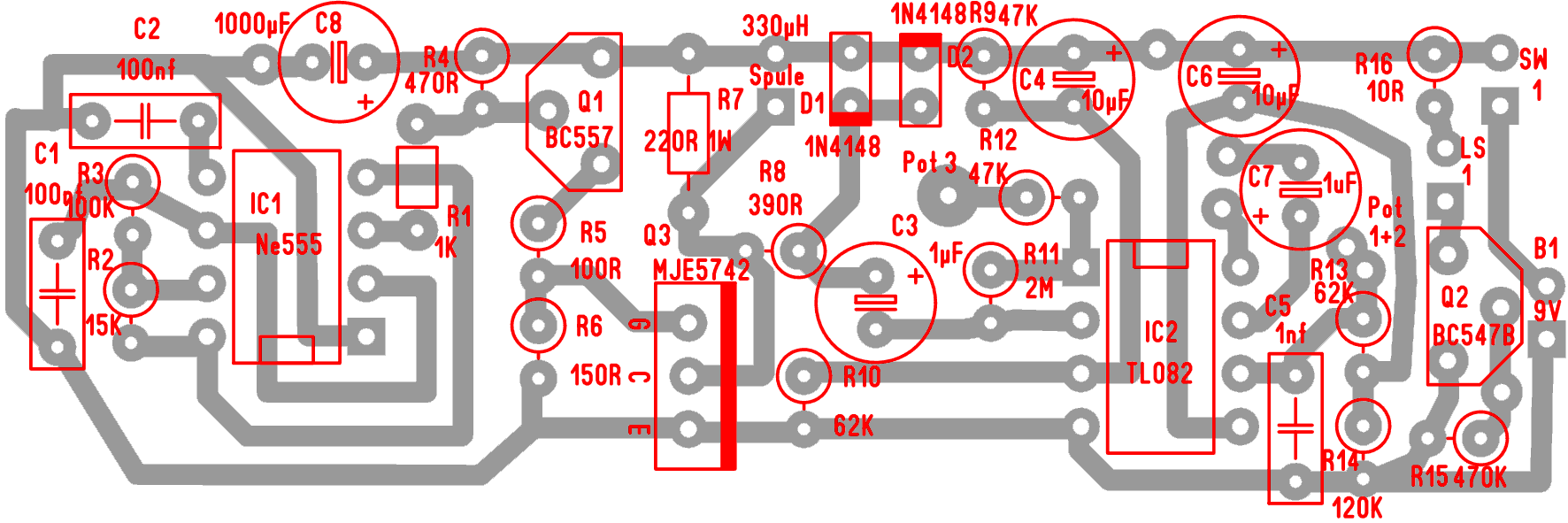

            • i have modified pirate pi pcb tl082 version to dimension of 25mm*75mm
              will test and hope it works
              • here it is
                @ all please check for errors copared to shematic
                didnt test it
                the place for the C8 1000uf is a bit to small for a standing cap
                idea was to lay it down
                please look an comment if something is wrong i am new in pcb desgin

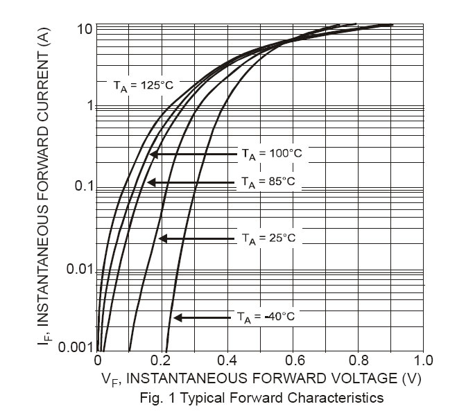

                • Flyback voltage trimmed by diodes goes straight to amplifier. No gating, no switches.
                  I think that scehematic will be more stable if you will use Shottky diode to trim flyback instead of 1n4148 or kd521 to lower input spike from 600-1000 milivolts to approximately 100.
                  Because if you will trim all the voltage let say more 100 milivolts than detector will ignore most of the spike and amplify more useful target decay signal.
                  Only problem with low forward voltage Shottky diodes is high capacitance. I found one DFLS130L with only 75pF. ($0.49 on Digikey)
                  It will cut everything that was over 100 milivolts working virtually as a switch that is absent in the schematic.
                  http://www.diodes.com/datasheets/ds30492.pdf

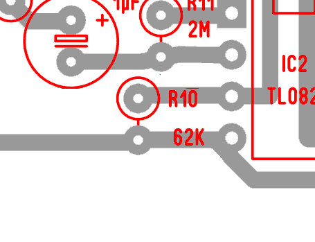

                  • Well done, I found one thing I would have done different Click image for larger version
ID:	338937 but it isn't a big deal. I didn't see any problems, I noticed you switched a Darlington in .
                    • hello thomas you are right
                      i build pcb from left to right, stretched it und shorten it here and there
                      so it is an improvement the resistor will be placed clother to tl082
                      thanks

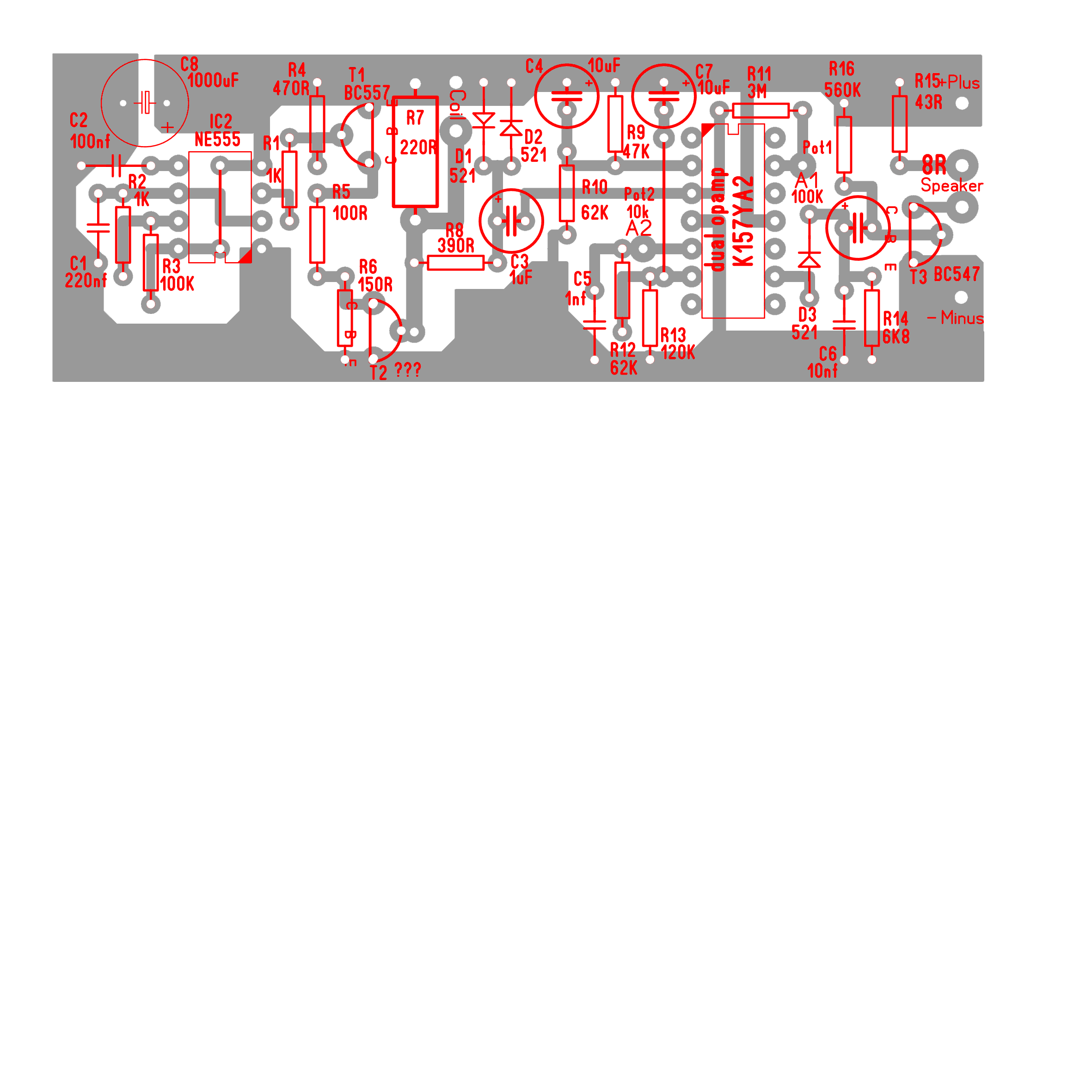

                      • Hi all
                        Hi bernte good modification for tl082 (k157ya2 is impossible to find for me)
                        Bernte how about your test?
                        Does it have a good distance detection?
                        • K157UD2 has nothing of something fantastic data. it is ordinary universal opamps. change it on LM358.
                          • Also you can try TLE2072. It is finally improved version of 30 years old TL072 - less noise, high slew rate, e.t.c. http://www.ti.com/lit/ds/symlink/tle2072.pdf
                            TL082 and TL072 are practically the same. It is hard to find difference between them in data sheets.
                            • Thanks all
                              I m going to try with lm358 and tl082 because i ve got them.
