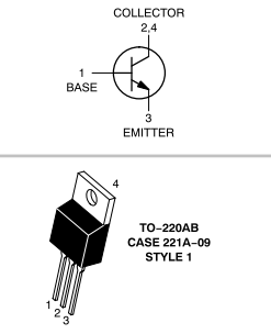

                if i mount a irf630 instead of mje13007 how should i rotate the irf630 the conection is total different right
                • Hi WS and Mickstv, Looking back at some of Moodz's early projects he uses ca3130n as a single supply preamp, but I dont know anything about them.
                    no rotation, same pinout, but the driver should be changedClick image for larger version
ID:	339022Click image for larger version

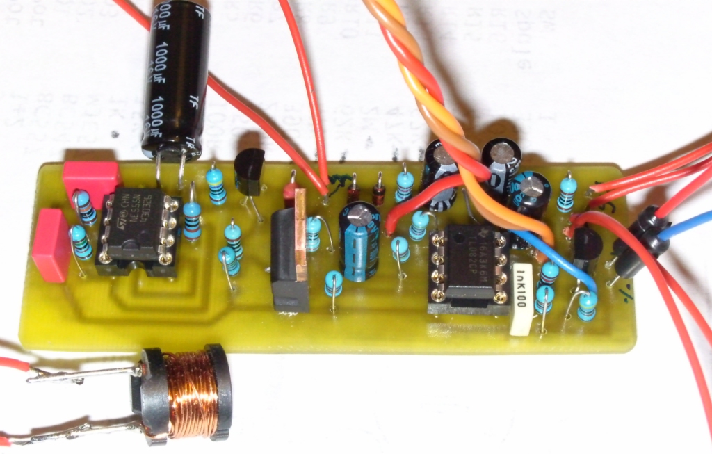

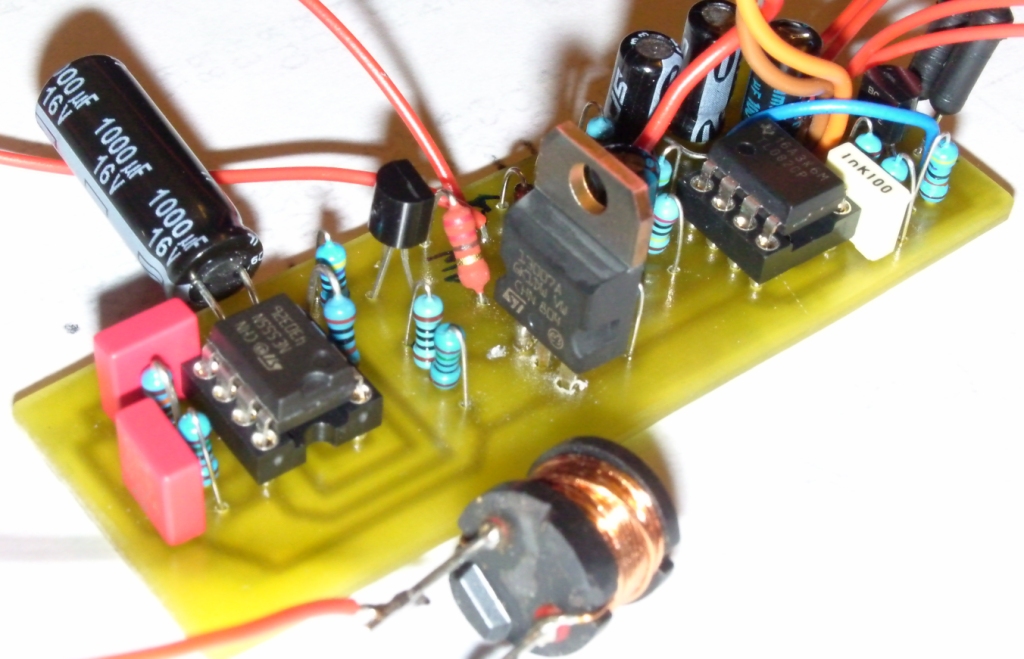

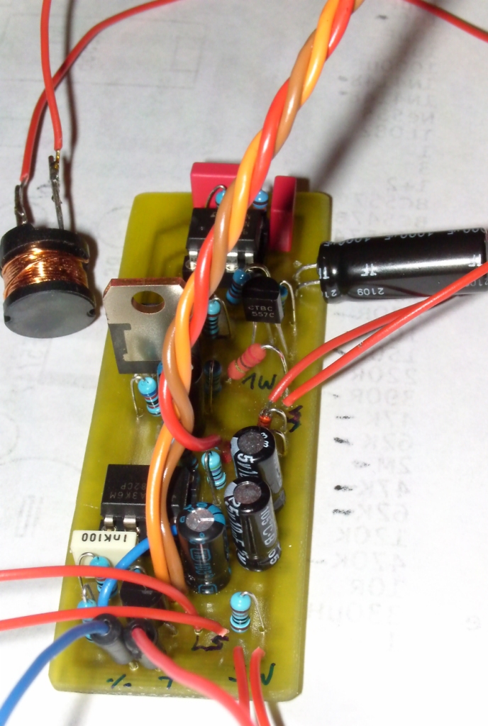

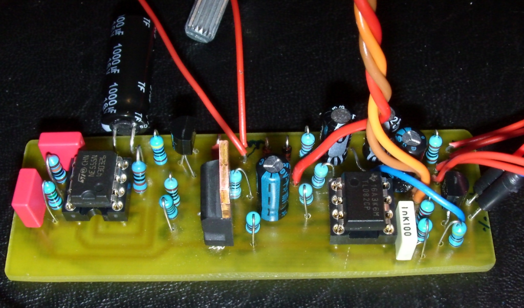

                    • ok assembled all together and gues what - nothing
                      only one light klick when i switch it on
                      over 10V supply MJE13007 gets hot fast
                      any hints i dont know

                        • has anybodody testpoints for me that i can measure?
                          • MOSFET need more voltage on gate for working. I test IRF740. It work if power > 12V.
                            • thanks Eddy
                              i have irf740 and irf630 here i replace R5 with a bridge and try it
                              what dou you think from the rest of my pcb
                              http://www.geotech1.com/forums/attac...4&d=1389733230
                              do you have any improvements ?
