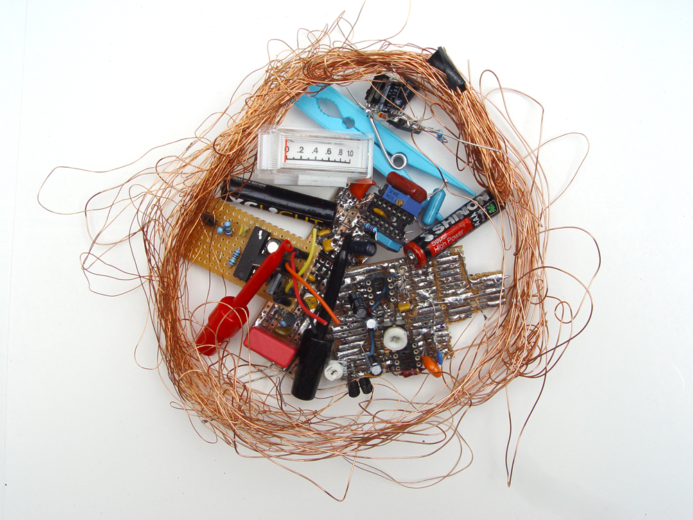

      I made your idea but it dont working yet . look the picture.
      I still know why.
      The only thing that happened at turn on that my hairs went stand upright.

        Can you tell us:
        Capacitor voltage and resistor wattage
        • Originally posted by Nezocas View Post
          Can you tell us:
          Hi, Nezocas
          C1-C2 = 630V C3 = 400V C5 -C6 = 16V
          Resistors 1/4 watt.

              Any Capacitors Rated at 16 Volts or Greater Should work OK.

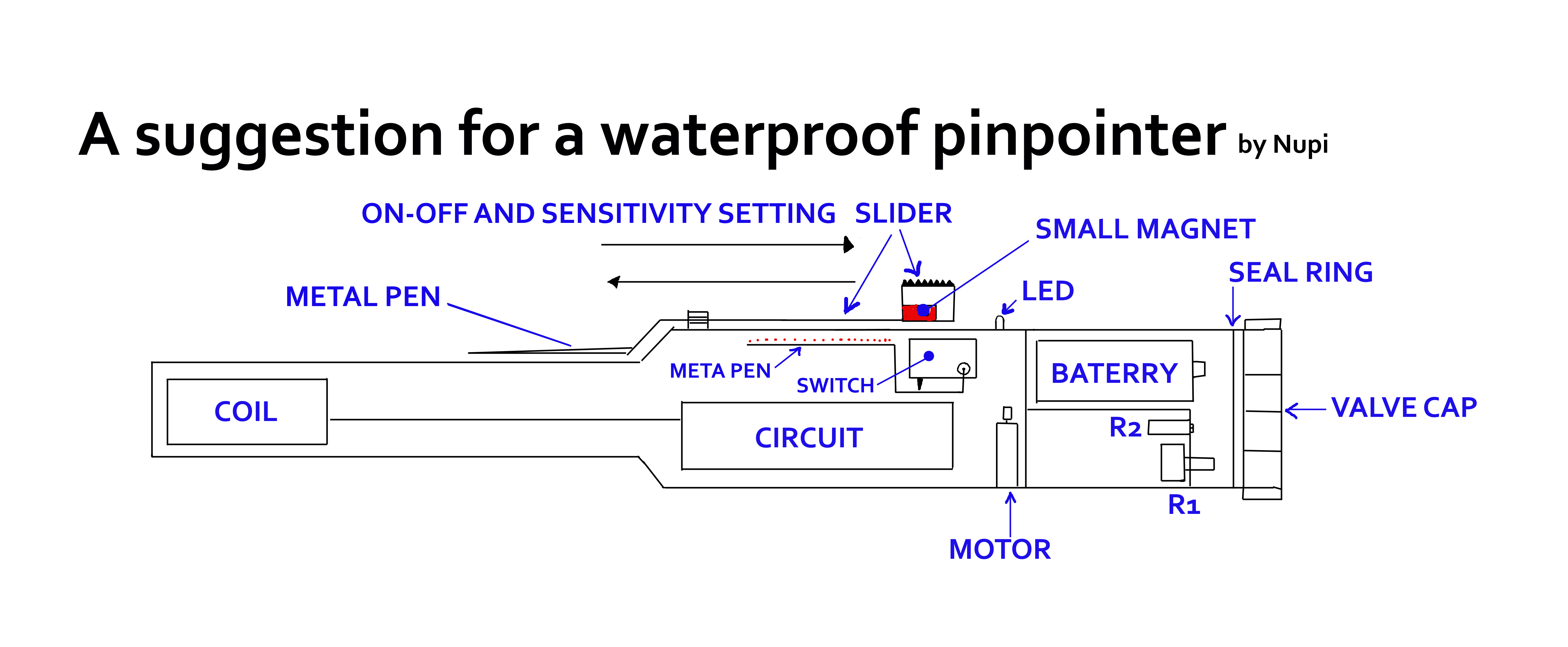

                              That's a clever design, the reed switch and the light.
                              You would also be able to apply to the pinpointer if you want to make it waterproof.
                              You do not necessarily need a pot on the outside.
                              You can make the fine tuning on the outside.
                              You can create a slider with on-off switch with a magnet and mini-switch.
                              The sensitivity set you with the same slide.
                              There are of course several solutions imaginable.
                              In order to operate the pinpointer fully automatic we need more go direction
                              Davor or another genius.
                              I'm not so far yet, and at my age it will not happen, I think.
                              I am a practical man as occasional have a applicable hallucination.
                              A suggestion for a waterproof pinpointer.
