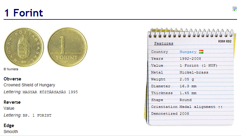

        I also built the pinpointer as hadrianus colleague (min Hungarian) and I had a stability problem.
        The R3 resistance trimmer potentiometer I changed and became stable.
        The HUF 1 45 - 50 mm to detect.
        It has been a good pinpointer.
        Thank you everyone!
        Hi, Eugen.
        You say R3 but you mean R1 or R2?
        What did you change?
        It's very good 40-50mm for 1 Forit.But maybe it's possible to get more than that, maybe 75mm.

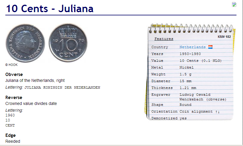

        I have no 1Forit but I have tried with 10 Dutch cents from 1954.
        Detected at 85 mm.
