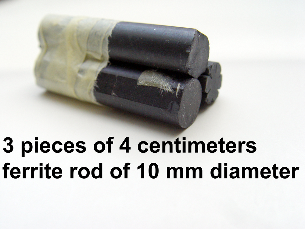

        Hi Bente,
        I can not say when I'll start the project because I want to improve
        the temperature stability and some adjustments but before that my health needs to improve.
        I have spontaneously responded to this tread but I have doubts whether I should have done.
        I have not tried out with a core of 16cm.
        I have a good result with 10mm, and it's cheaper.
        But it's definitely worth it to give it a try
        You need 3 pieces of 3.3cm, so with a core of 10cm you can make the coil.
        Cores of MW radio are fine.
        You can look at this website. www.friese-electronic.de. Maybe you find them useful.
        I have never bought anything from him so far, so I have no experience with him.
        I want to try with 3 core of 8mm diameter from Conrad to see what the results are.
        They are not expensive and well obtainable.

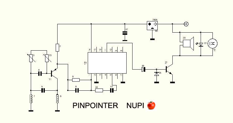

            Hi Bente,
            Thanks for the Ebay tip.
            I had so far not shown any schematic because I wanted to start a DIY project and
            it should be optimized and I can not now.
            You're right it season is started and it will take too long before everything is ready.
            Therefore, I make an appeal to everyone let's optimize together this pinpointer.
            There is in this forum more than enough knowledge to make it a success project.
            I have worked for months on it to make a simple but effective pinpointer.
            I wanted to make a pinpointer that can make cheap.
            So it is for every butjet.
            That's my goal.
            Anyone can make it.
            You do not need to solder necessarily (its work fine on a breadboard)
            you do not need a osciloskoop
            You do not need to program it.
            It is not made with SMD components.
            Best datas should I still seek. Coming tomorrow.

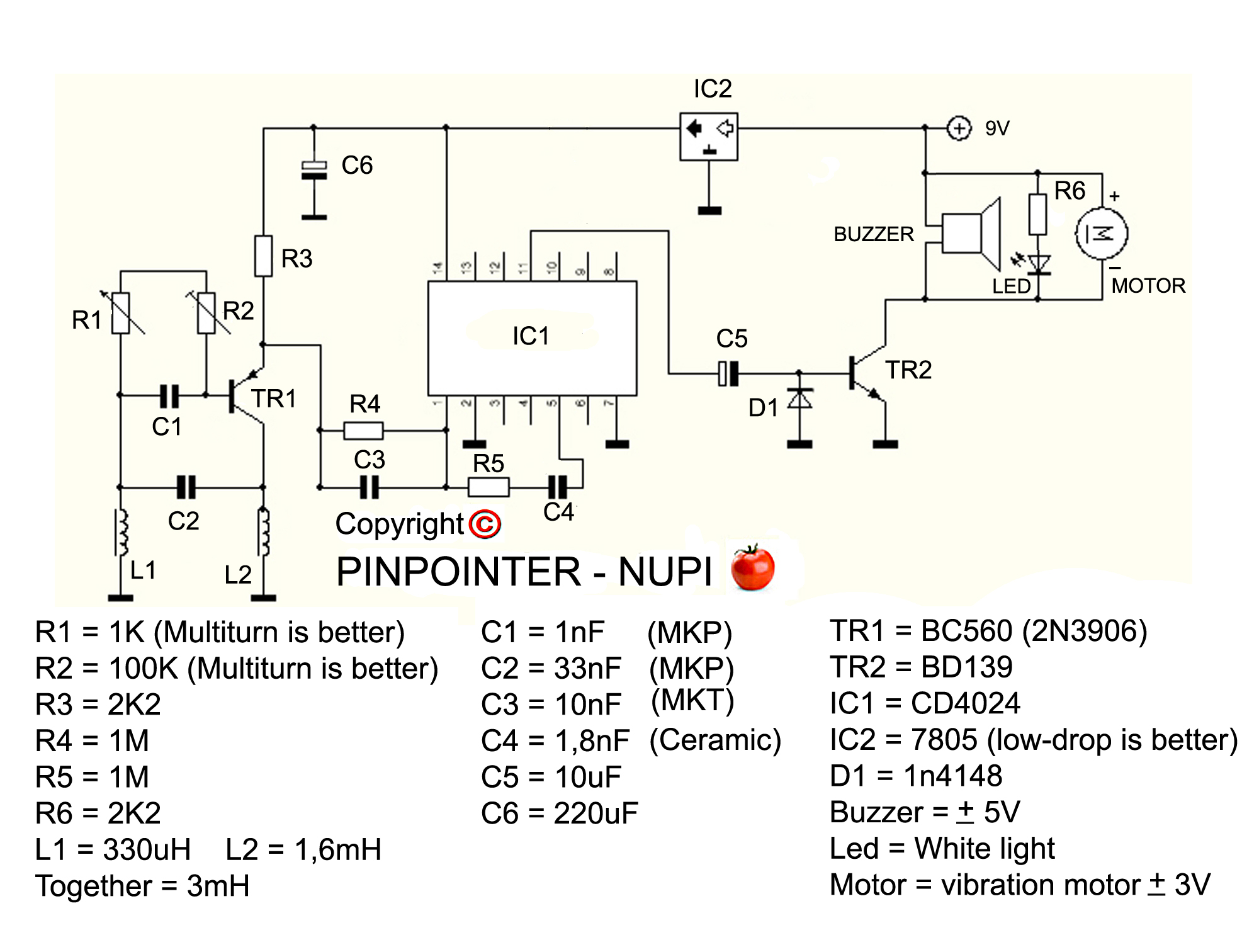

            • #51
              The pinpointer schematic is complete.
Name:	Schematic Pinpointer Nupi.jpg

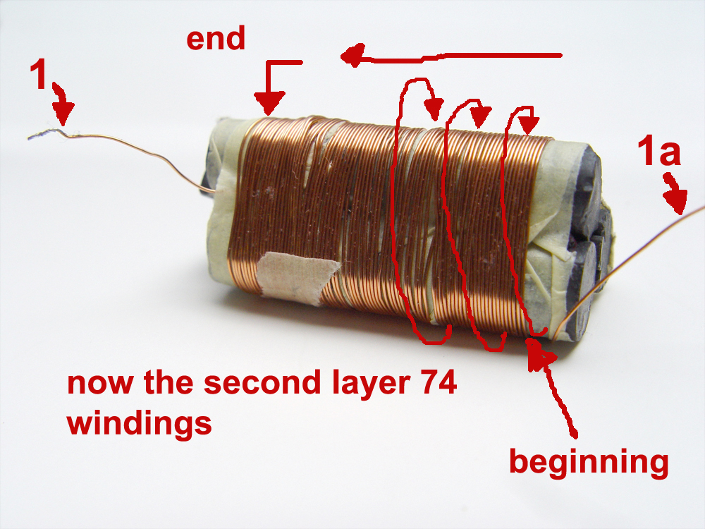

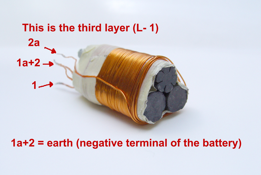

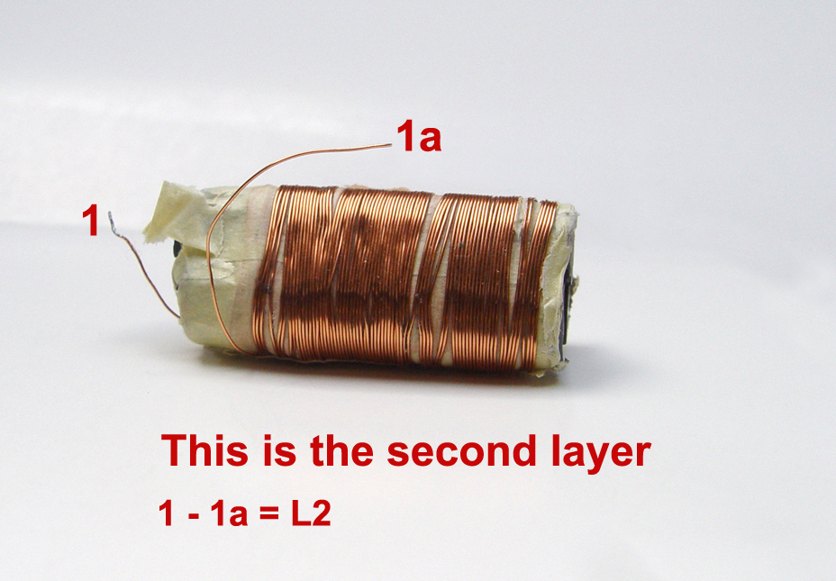

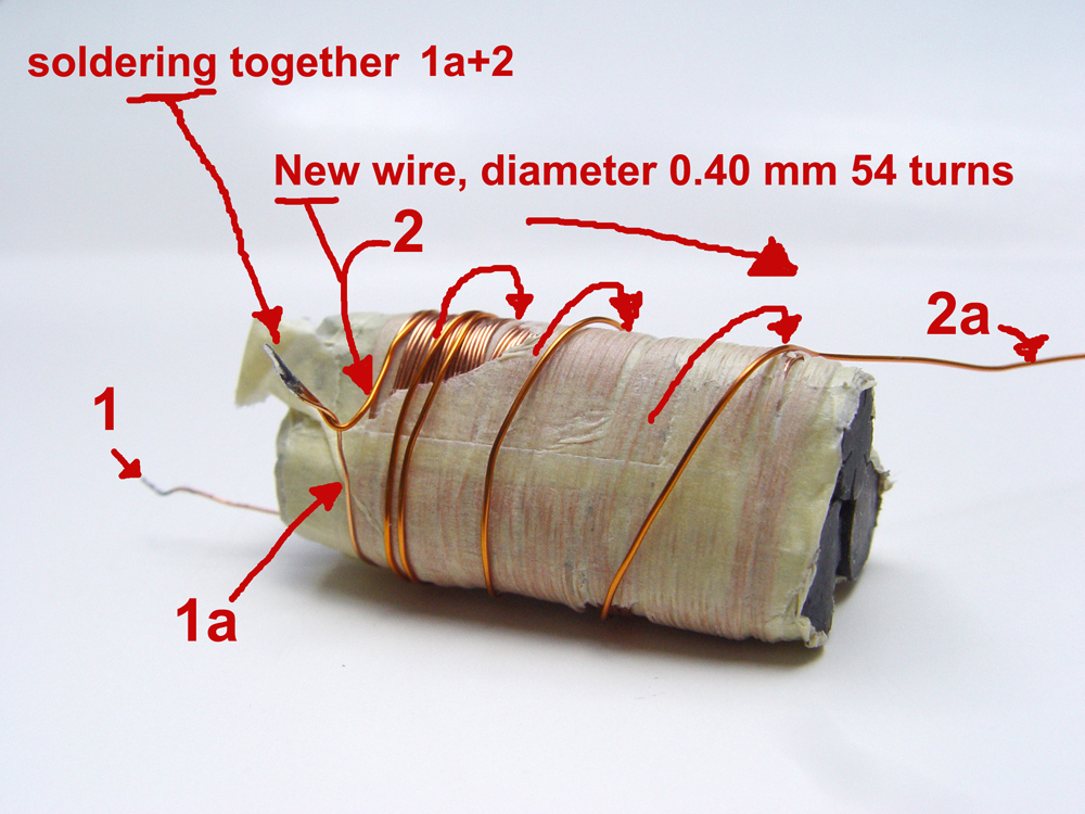

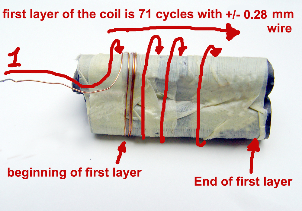

                    Nupi Hello, can you give a precise specification of the coil (the thickness of the wire, how much turns, connection details (A1, A2, B1, B2), the direction of winding, core thickness, ohm, etc...)?
                    I did not quite understand the use CD4024, but if it is a function of the VCO, it is much easier to be done with NE555 timer?
                    • #55
                      Hello Harp.
                      My English is very poor but in simple words the CD4024 is a counter and a divider not a vco.
                      The counter count on pin one on the negative transition of each clock pulse and then he divided it. Click image for larger version
                      You may be able to download a datasheet for the CD4024.
                      Maybe you can find someone that speaks good English and can explain better.
                      In this design, you better use the CD4024 and not the N555
                      I make a drawing of the coil today.

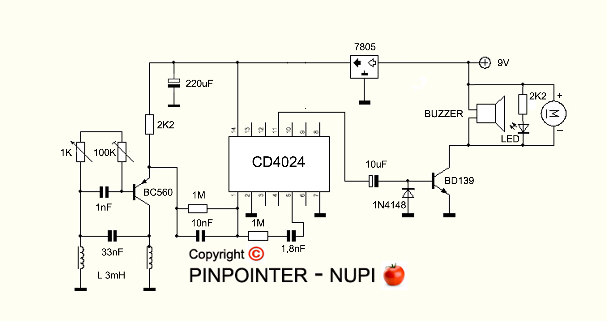

                      • #56
                        The new SchematicClick image for larger version
Name:	Schematic Pinpointer Nupi 3.jpg
                        • #57
                          Nupi Hello, can you give a precise specification of the coil .................................................. .........
                          I hope you understand the images.But you can always ask for further explanation.
                          regards Click image for larger version
ID:	339762 Click image for larger version
ID:	339763 Click image for larger version
ID:	339764 Click image for larger version
ID:	339765 Click image for larger version
ID:	339766 Click image for larger version

                            • #59
                              seems to be hard work to build coil
                              Yes, it is a heavy coil.
                              You can also make the coil of one piece ferrite rod .
                              You can the circuit try first on a breadboard, it works fine.
                              I will post later a picture of the breadboard.
