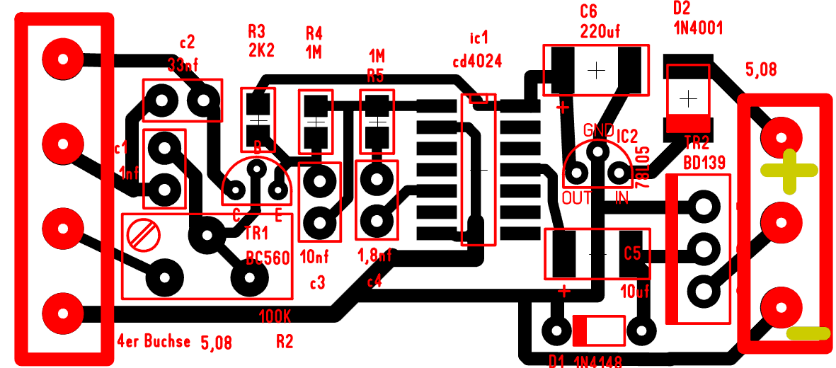

      • #78
        ok here is what i have done last 2 hours
        plan was to make single sided board
        th components could be soldered on top, or on bottom by changing orientation (trimmers, trasistors ...)
        layout is made with top and bottom tracks
        sorry i am noob

          Great Bente,
          I see two small mistakes.
          I think you need BD139 and D1 turn 180 degrees.
          Is it possible that you make one with a normal components, no smd?
          For clarity, I have not made ​​with SMD.
          So, I do not know how the circuit will do with SMD components.

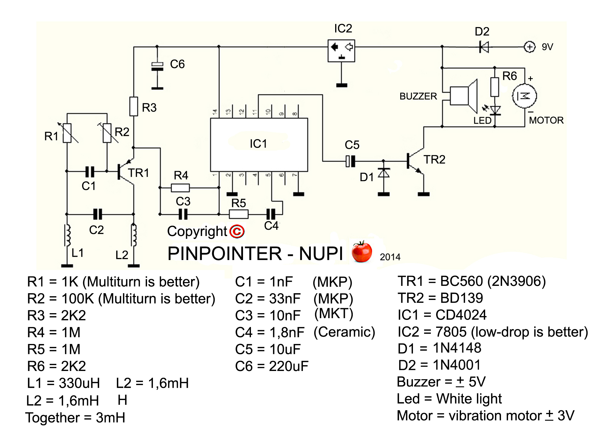

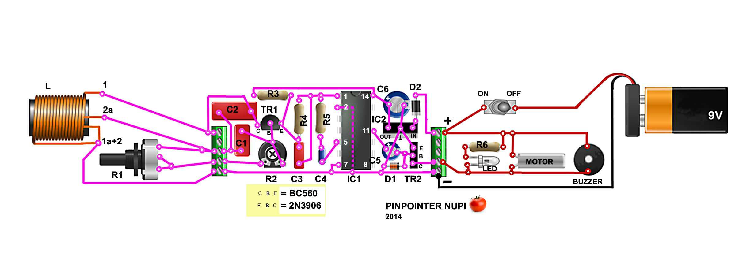

            • #81
              Important - Important
              I made two mistakes in the schematics.
              One in the schematic (schematic NUPI 3) misses D2
              In this Click image for larger version
Name:	Schematic Pinpointer Nupi 4.jpg
ID:	339806schematic is restored.
              In schematic (pinpointer NUPI 2014.jpg) I made a major mistake. There, the wires 1 and 2a
              on the coil is swapped.
              In the schematic pinpointer NUPI 2014 (2) Click image for larger version
Name:	pinpointer nupi 2014 (2).jpg
ID:	339807 is restored.
              Sory for the caused inconvenience .

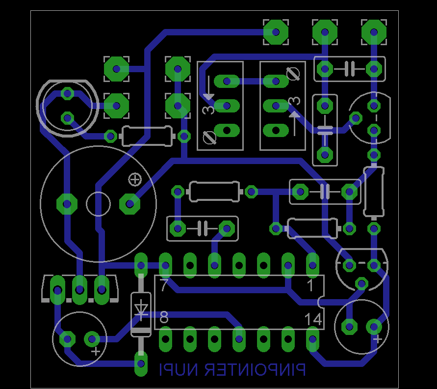

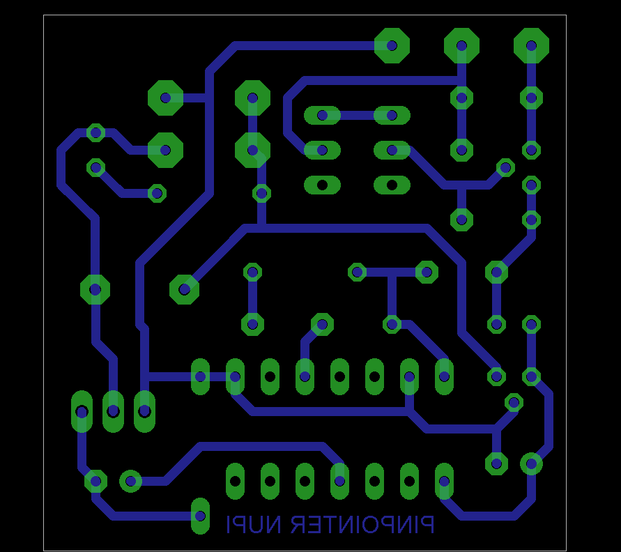

              • #82
                NUPI thank you, excellent documented!

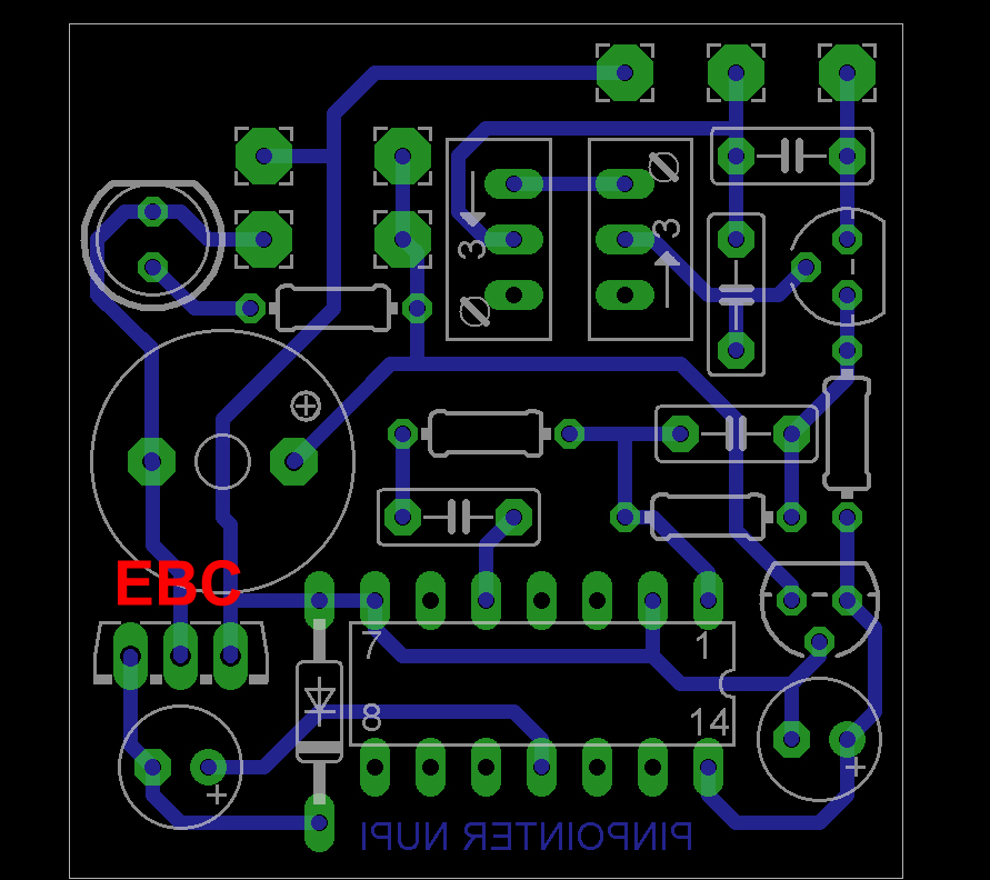

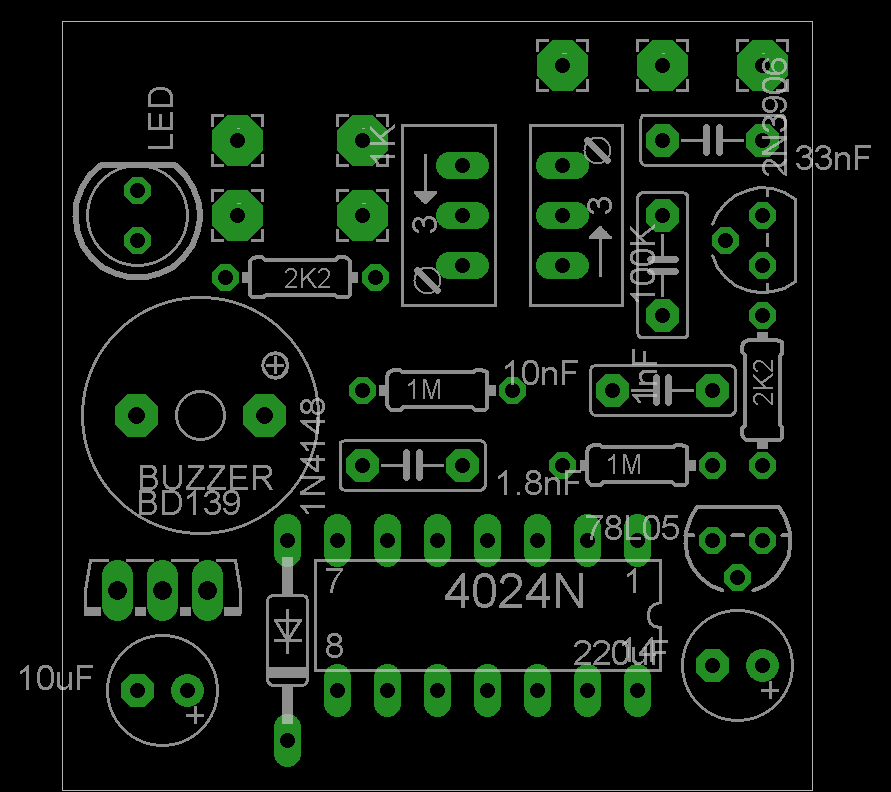

                I drew the PCB of the pinpointer compact design with non-SMD parts.
                Plate size is 40x40mm. If you like the design you can use it in your kit for sale.
                The upper 3 pads is for coil, middle 2 pads is for supply, lower 2 pads is for motor.
                I wonder if you could do some testing with the usual materials, to compare data:
                Aluminum foil of chocolate: 3x3mm, 2x2mm and 1x1mm
                Copper wire 0.4mm diameter: 3mm, 2mm and 1mm
                I do not have a gold chain ...

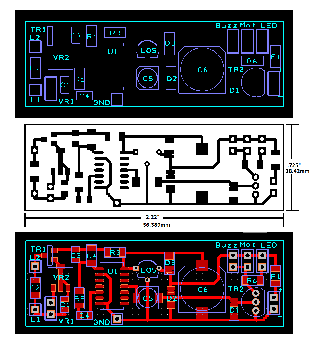

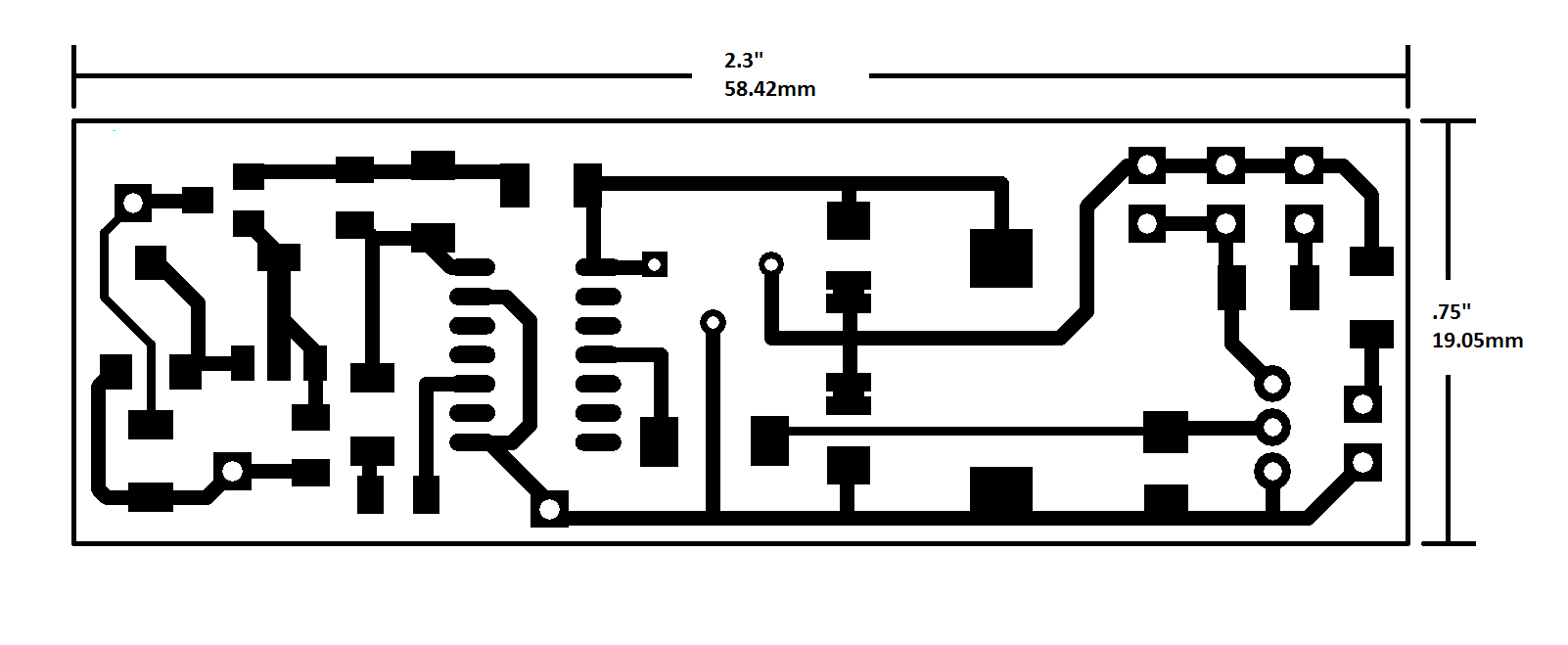

                  • #84

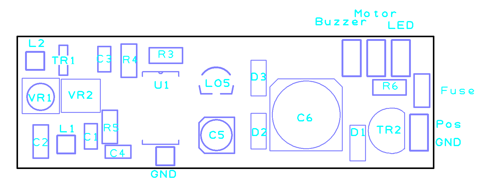

                    I made a few changes SMD with some trough hole. Click image for larger version
ID:	339811Click image for larger version
ID:	339812 any mistakes?
                    • #85

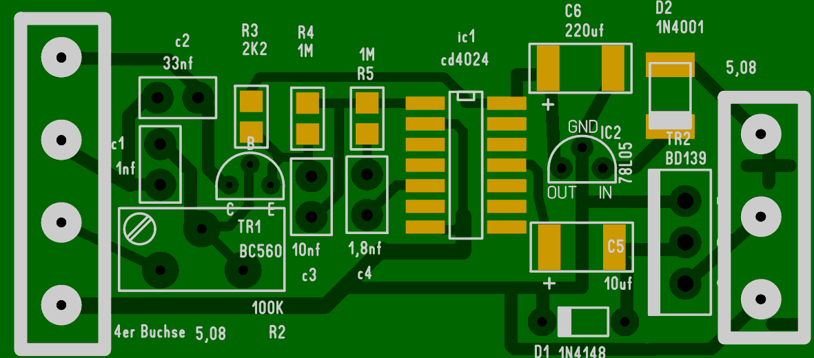

                      Forgot a black and white and some silk screen mistakes.
ID:	339821Click image for larger version
Name:	NUPI Silk Screen.png
ID:	339822 and TR2 is a 2n5551
                      • #86
                        Nice job Harp.
                        Thank you but I'm not go make a kit.
                        I have not yet looked good but Its looks that the transistor BD139 is not good.
                        See the picture. Click image for larger version
                        It is important that R1 NOT placed on the PCB
                        With R1 you adjust the sensitivity and the "ground balance".
                        I have do for you some testing with the Aluminum foil of chocolate: 3x3mm, 2x2mm and 1x1mm

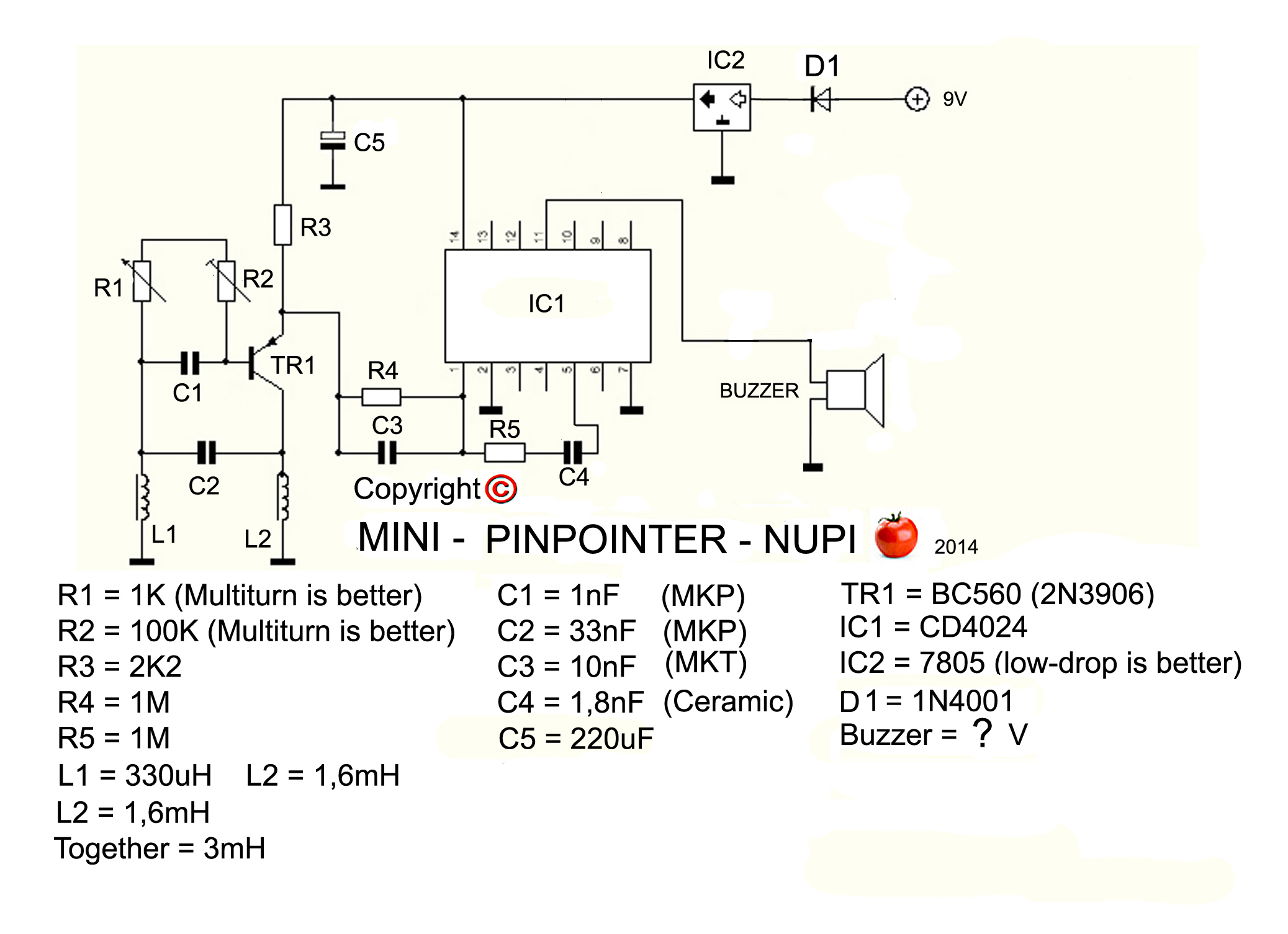

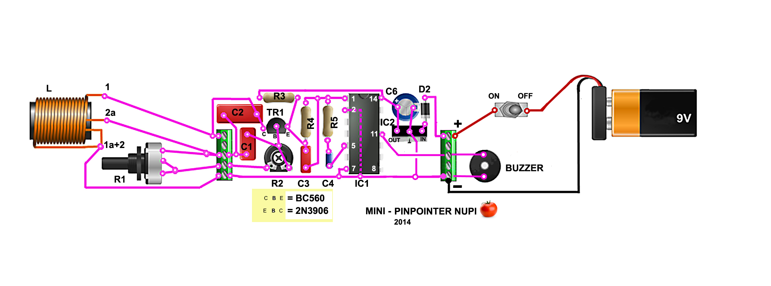

                            MINI
                            Schematics from the mini-pinpointer nupi.
                            Who wants to build the pinpointer smaller you can build the mini - pinpointer nupi.
                            The sensitivity is less than the "Big one" but it is worth to try it yourself.
                            I have the schematics adapted and given him the name mini - pinpointer nupi Click image for larger version
Name:	Schematic Mini- Pinpointer Nupi..jpg
ID:	339824 Click image for larger version
Name:	MINI - Pinpointer nupi 2014 .jpg

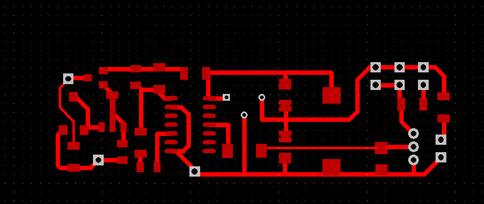

                            • #89

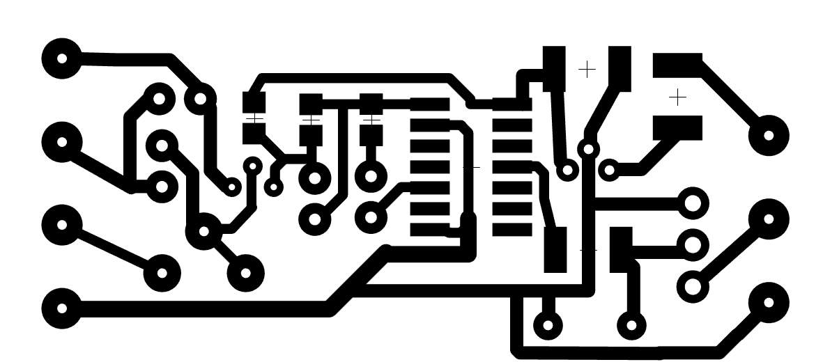

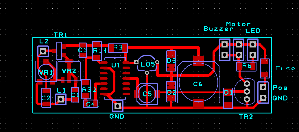

                              I took a few things off board, for a small board, I do everything I can SMD.
Name:	NUPI Maybe Final.png
                              • #90
                                [ATTACH]29029[/ATTACH]
                                Great job!
                                It will fit 20mm plastic pipe. So you can put a coil with ferrite core in the same pipe.
                                May be it is possible to add some voltage converter IC to power schematic from one or two AA batteries to let everything to fits that 20mm pipe.
                                Or may be it will work from 3V at all.
                                Or you can use small 12v batteries for photo cameras:
                                Ultra 12 V Type G23A is know as 23A, 23GA, A23, E23A, GP-23A, GP23A, K23A, L1028, LR23A, LRV08, LRVO8, MN21, MS21, V23, V23GA, VR22
                                http://www.ebay.com/itm//281155577756
                                It is smaller pinpoiinter ever build.
