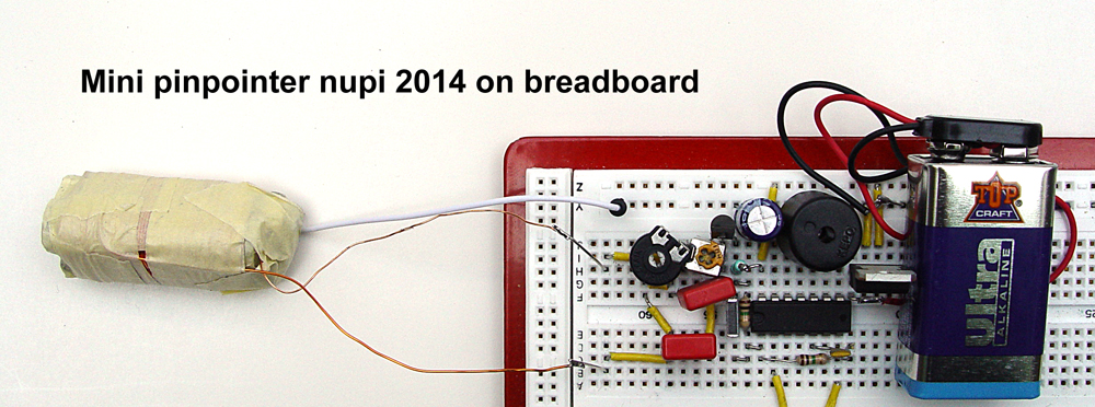

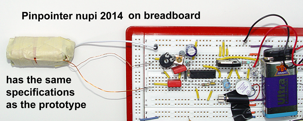

    • Can you give me information, which is the voltage on the Emitter of BC560 while the unit is in standby mode, and which is the voltage on the Emitter while the ferrite touched the metal?
      Thank you!
      • Originally posted by Harp View Post
        Thank you!
        The voltage depends on the setting of R1 and R2, but the point that he has not yet been detected is around 3.23volt.
        At maximum detection is 2.25 volts.

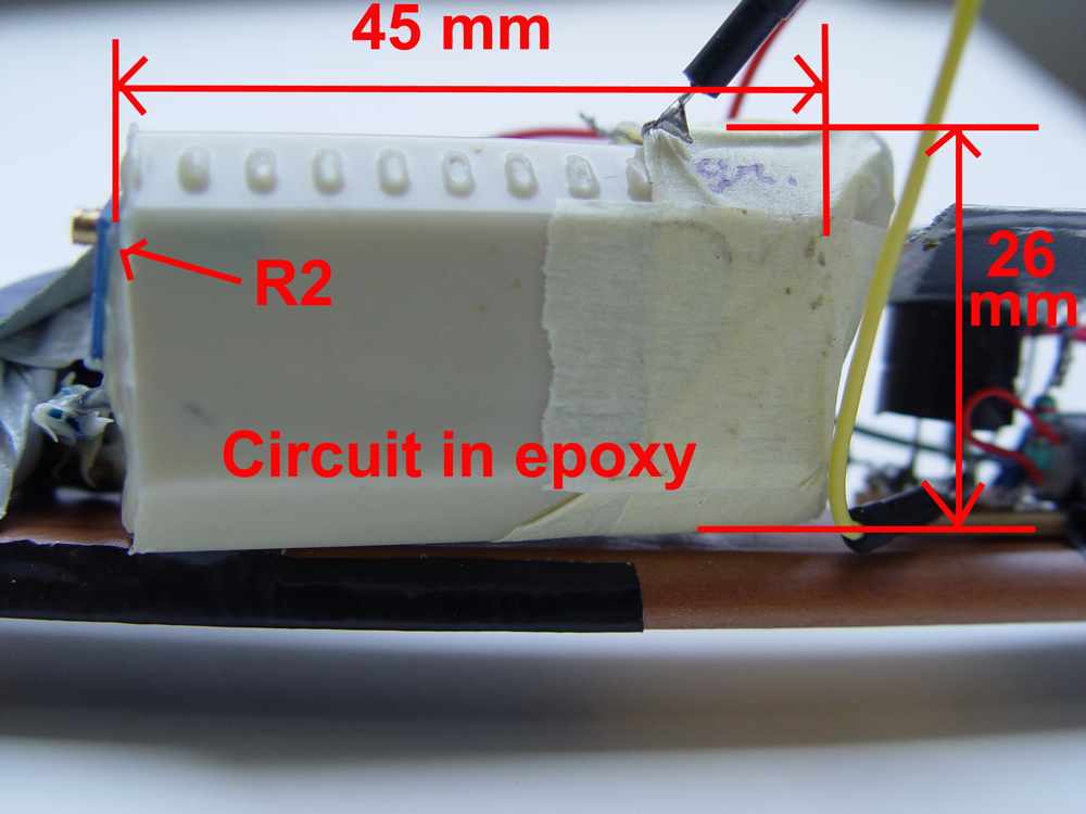

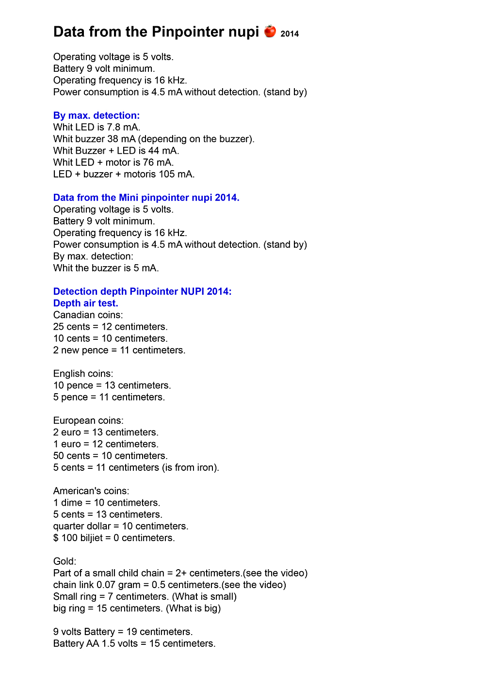

        • Data of the Pinpointer nupi.
          • Circuit in epoxy with normal parts (not SMD)
            • Pinpointer nupi and mini pinpointer on breadboard.
              • Originally posted by Nupi View Post
                > Operating frequency is 16 kHz.
                It is awesome! You are in VLF frequency range!
                It will let this device to penetrate ground well instead of constructions using higher frequencies.
                Also check your L1 and L2 inductance they matching TX and RX coils of many VLF detectors.
                I am sure you can switch your pinpointer coil with usual VLF detector coil and use it as a good metal detector too.
                So you need only your pinpointer electronic block and two coils: VLF DD or concentric and original coil with ferrite core to go to the field.

                    • 16 Khz is in the Audio Range.
                      • Originally posted by chemelec View Post
                        Yes that's right.
                          Formally it is audio but I am not sure I can hear 16 kHz freely in my age, my daughter sure can.
                          Wikipedia:[Very low frequency or VLF refers to radio frequencies (RF) in the range of 3 kHz to 30 kHz and wavelengths from 10 to 100 kilometres.]
                          Metal detectors working in VLF frequency range are able to penetrate ground better. Metal detector or pinpointer working on 100 kHz will loose more signal strength in the ground.
                          Also 16 kHz is good to find small gold targets. Lower frequencies are used for bigger or more conductive targets.
                          That is why 16 kHz Nupi pinpionter especially good to find small gold!
