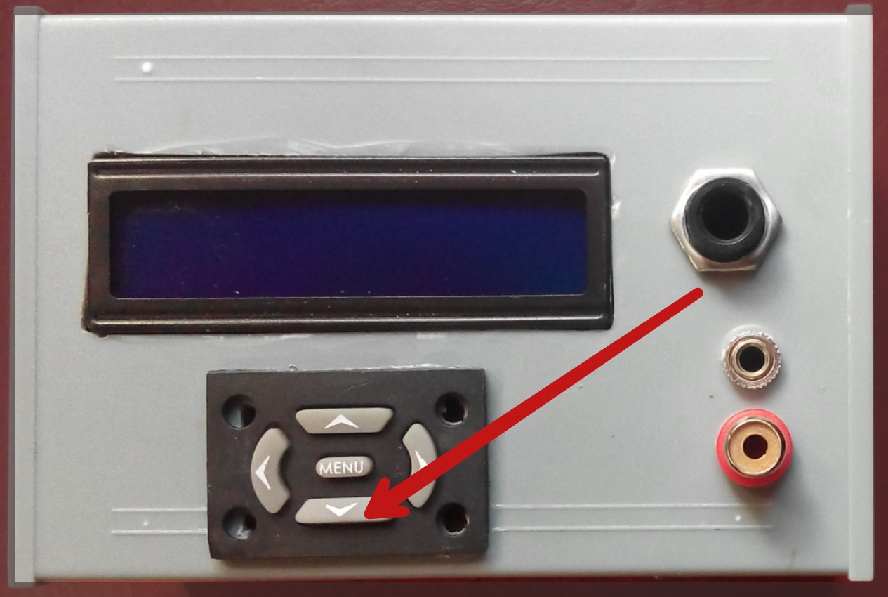

                              I completed it recently, took it outdoor with me and performed detailed tests.
                              What can i say? It is useless on mineralized soils completely, if Sense is over "12".
                              It "beeps" all the time. There is no way to calm it down.
                              Than i discovered how to calm it down for a while; set Sensitivity to "10" (maximum is "20") and than switch it Off and than back On. It is "balancing" at start up
                              hi ivconic! You dont need to turn it off and on just for balancing pupose, the push button switch for "down" direction is also the balancing key. Just push it anytime and machine will balance
                              . And about the miniralized soil yes felezjoo is over temperament on that as what i also experience but i discover that it depends on your coil.. In my case also im using 5 pcs 3.7 li-ion battery mark as 6800mAh (about 4200mah real power) it works about 3 hrs of used before i need to recharge.
