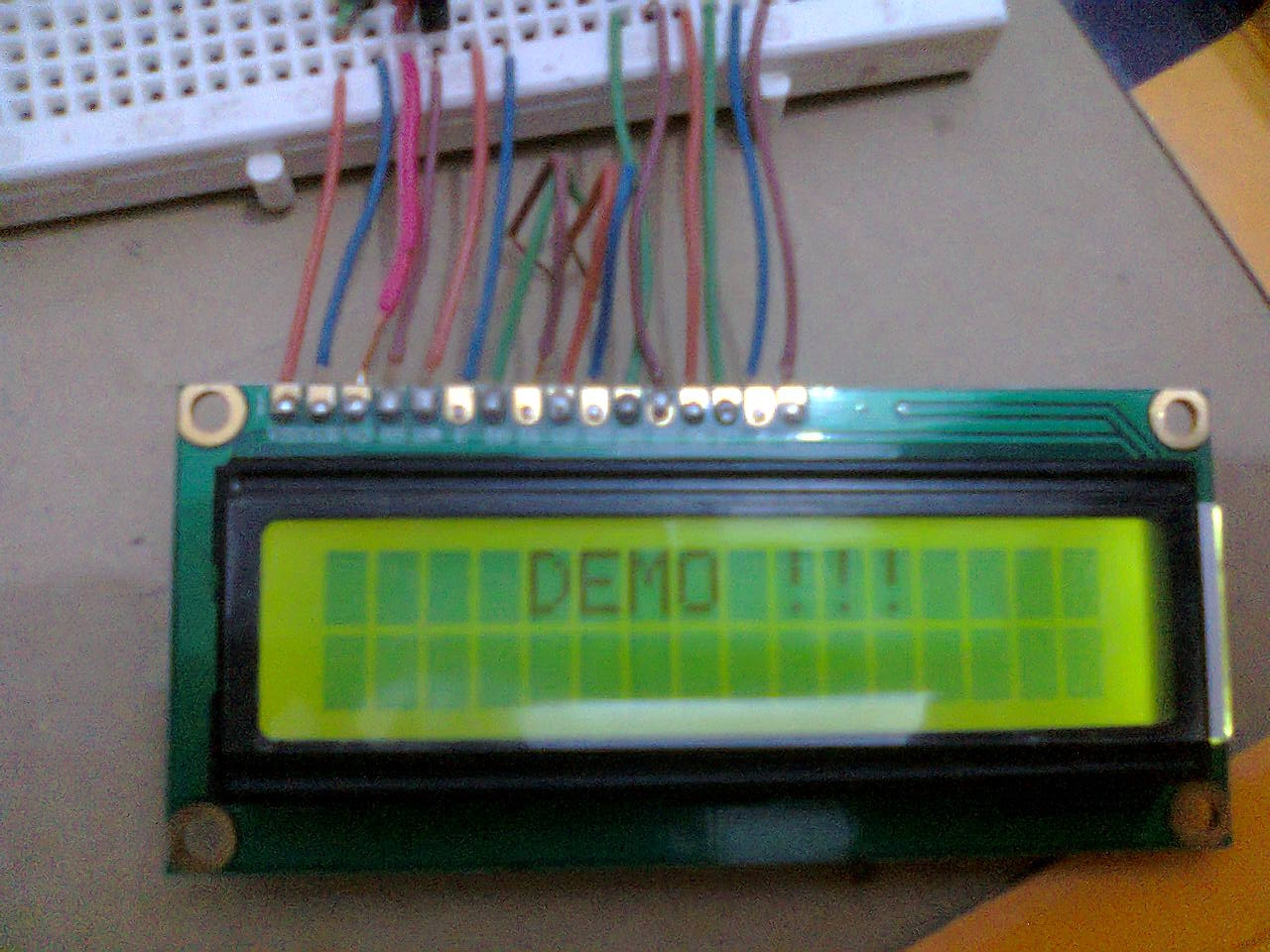

    • PLEASE I PROGRAMME THE ATMEGA WITH CORRECT FUSES BUT WHEN I POWER THE DEVICE THE LCD SHOWS ONLY BLACK BOXES BUT I M LEASING TO A SHORT SOUND FROM BUZER. WHATS THE PROBLEM?

        LCD pin 5. to GND.
        Contrast?
        Backlight?
        • THANKS IVCONIC
          I VERIFIED THE PIN IS IN GND
          BACKLIGHT IS OK
          CONTRAST: THE FIRST LINE IS ALL BLACK BOX
          BUT THERISE A SHORT SOUND IN THE BIGENING FROM BUZER

                • put reseter 19 to22k trimer and adjust it down that if u have ablack box
                  • Originally posted by basellafe View Post
                    thanks
                    but where i put this trimer?
                    • Originally posted by faycel View Post
                      thanks
                      put it in pLace of the 22 k resistor..... Remove the 22 k resistor and solder the trimer in its place and dont forget to solder the middle leg of the trimer to one of the two other legs thaN adjust
                      • THANKS
                        NOW ITS OK BUT IN THE BEGENNIG THEY SHOW ONLY DEMO!!! and stoped here

                            I REPROGRAMED THE ATMEGA MANY TIME BUT ITS THE SAME RESULT ONLY SHOYING DEMO!!!
                              Delete eeprom content.
                              Are you using regular FelezJoo HEX from author?
                              In case you try to "hack" it ; it has implemented protection and it will result with only "DEMO!!!" when you switch it ON.
                              Don't try to hack it!
                              • First program your Atmega with this what i attached here.
                                Switch it ON for 10 seconds.
                                Than program your Atmega with FelezJoo hex again.
                                Than... enjoy!
