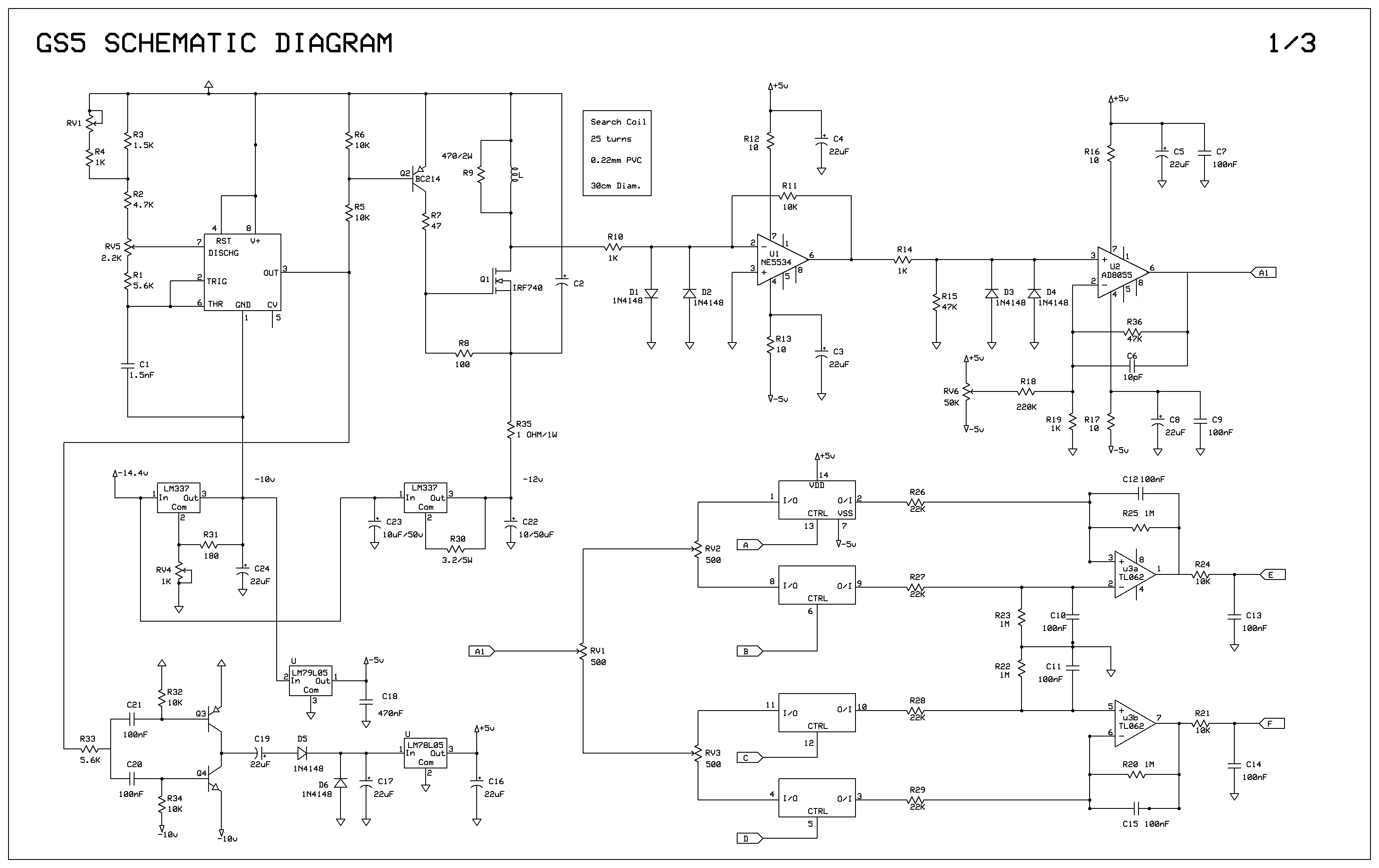

        By the way, is the sd200 schematic(the front end) accurate?
        Looking at this schematic : it is made for a 2 coils detector. The MOS in this part are small current devices, and their gate control needs additional circuitry.
        And , LM394 is very good matched pair , but it is now not available . (May be THAT300 is a good remplacement.)
        I think there is easier way to improve the front end of the GS5. Was it the goal while asking this question?

            I was looking at possible modifications to GS5. But I like the sd2000 audio circuit. LM394 is no problem. Suitable replacement can be found.

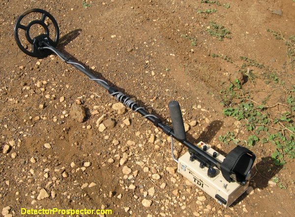

                Hi Geo,
                The first TDI's used 4538's, and later switched to a microcontroller. Some where on one of the forums Reg or Carl mention that there was a first run of TDI's with through hole components and not smd. I recall it was less than a 100 units.
                Here is a photo of a proto type just like the one I have

                  Just out of curiosity, can't someone scope out the timings of the two for comparison? This would be informative? Here i post nice schem of front end GS5.
                          The LM394 with an opamp will do nothing better in a TDI /GS5 , comparing to a modern opamp. At least the same. The noise from 1000 ohms is worse than the one of the amplifier, 4.1 nVsqrHz@ 25°.
                          • Originally posted by Idefix View Post
                            I was referring to single cap integrator implementaion or mods done on TDI (https://www.youtube.com/watch?v=s0DXQFCF8F0) for noise reduction.

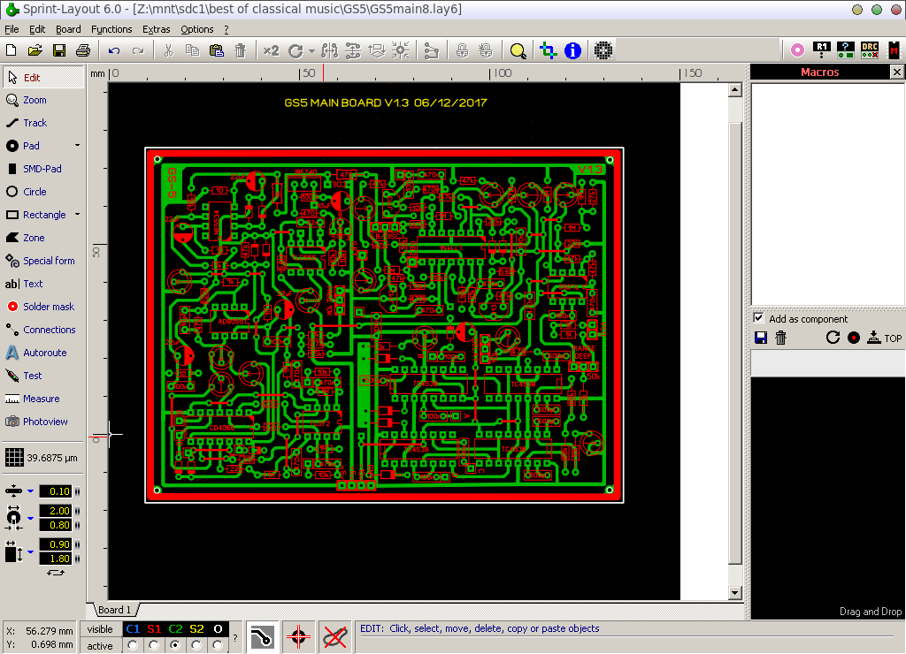

                            • Maybe someone might find this layout useful.
                              • Hi,
                                What kind of VCO do you choosen, finally?
