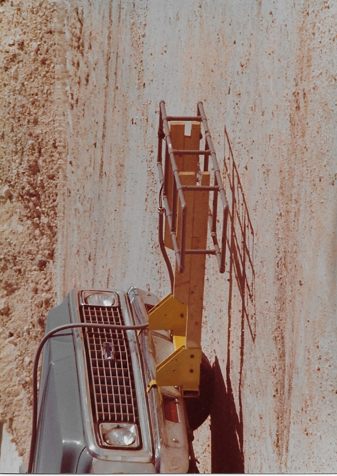

      Hi Orbit, the bottom coil is monopolar TX and RX. The top coil is exactly the same, but acts as a second RX. The electronics takes the signal from the top coil and feeds it into the other, opposite polarity input, of the front end opamp. Interference signals, such as from overhead power lines, induces an equal signal in both coils which the + and - inputs cancel. The noise coil needs to be damped like the TX/RX coil and also back to back protection diodes must be in place, as the TX transients may damage the opamp. Spacing of the coils need to be about 1/3rd of the coil diameter so that cancellation of the target signal is not significant. This arrangement also cancels earth's field effects when this type of coil bounces around, as on a vehicle.

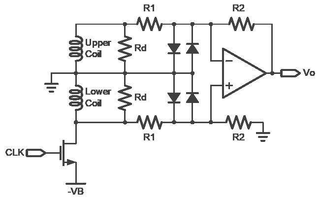

              Originally posted by liudengyuan View Post
              Is it possible to draw a schematic or image so that we can really know how to make such a coil, thank you very much
              Here is one possibilty:
                [ATTACH]49507[/ATTACH]
                Thank you. Can this coil solve the mineralization reaction on the ground? Do the damping resistances of the two coils have exactly the same resistance value? What will happen if the resistance values ​​are different?
                  Carl's circuit is the one I used. I used the same value of damping on both coils as they both have the same inductance and resistance. However, the bottom coil's resonant frequency will be a bit lower because of the added capacitance of the switching transistor. For the applications I had, there was no need to sample early, so any slight mismatch that caused overshoot or residual ringing, did not matter. The resistors around the opamp should be equal as shown. The arrangement does not cancel any ground mineralisation.

                  • #54
