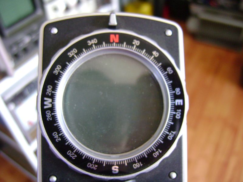

              In this morning i made a new test with PP (version without external oscillator & last firmware). Again the same problem of instability was appeared...Is not a mechanical instability. Everything is good in fixed position but when i go outside in my garden and i make a new self calibration, the PP is stable only if i hold same azimuth.
              PP is stable if i hold this first position and i walk around. If i rotate slowly left/right, the PP response with metal/nonmetal signal. Is exactly like a magnetic compass. The frequency is shifted by earth magnetic field, i don't have other explication... Click image for larger version

                This schematic not work with ferrite rod, only with simple coil. You make magnethometer.
                      Thank you Eddy71 for advice, this was the problem. Now i use one coil without ferrite core and PP is stable. The new firmware is very fast and has a good stability.

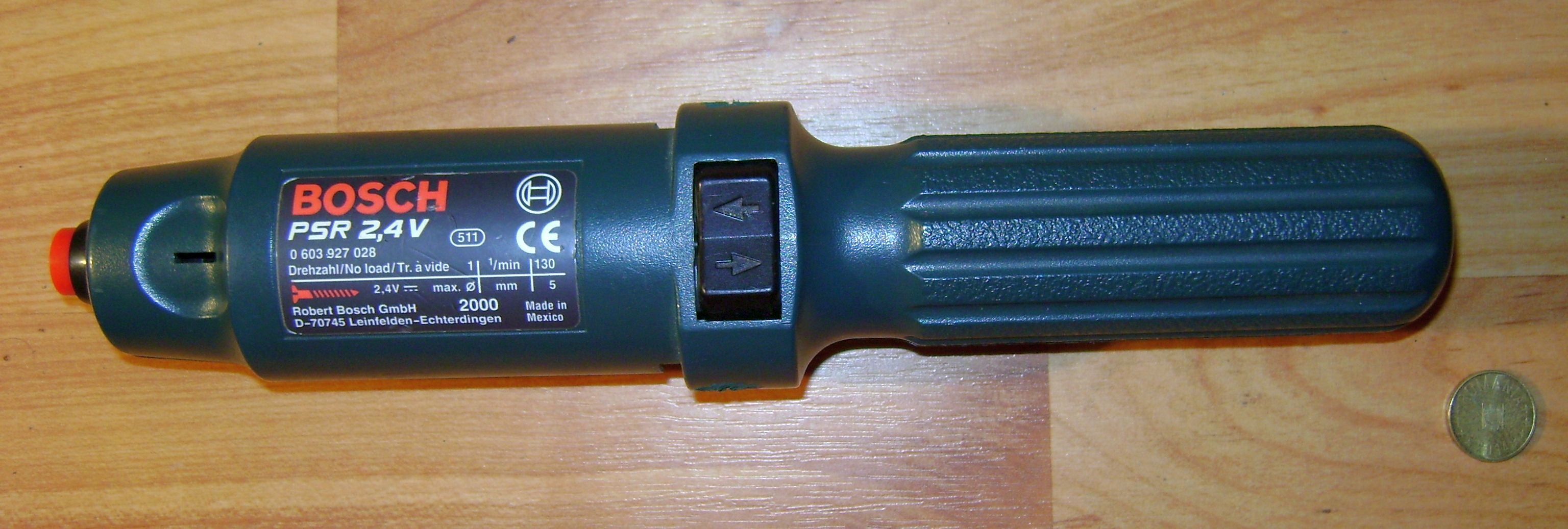

                        Bosch Pinpointer !
                        • #42

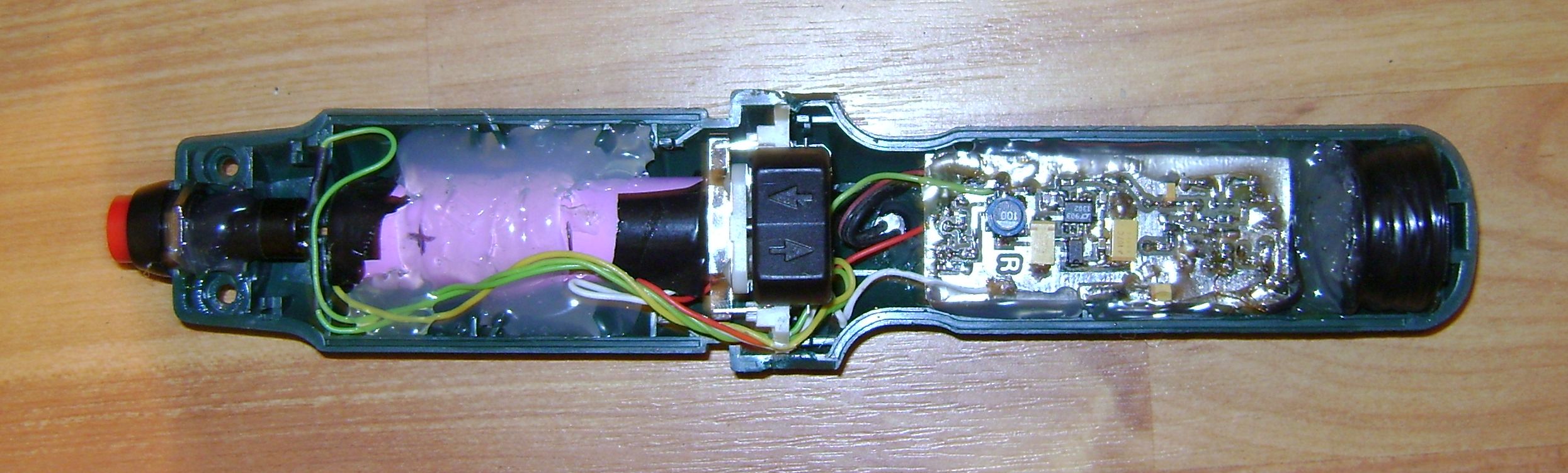

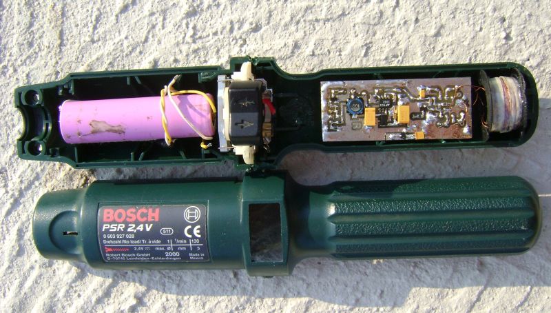

                          BOSCH PP ready for weekend hunting Click image for larger version

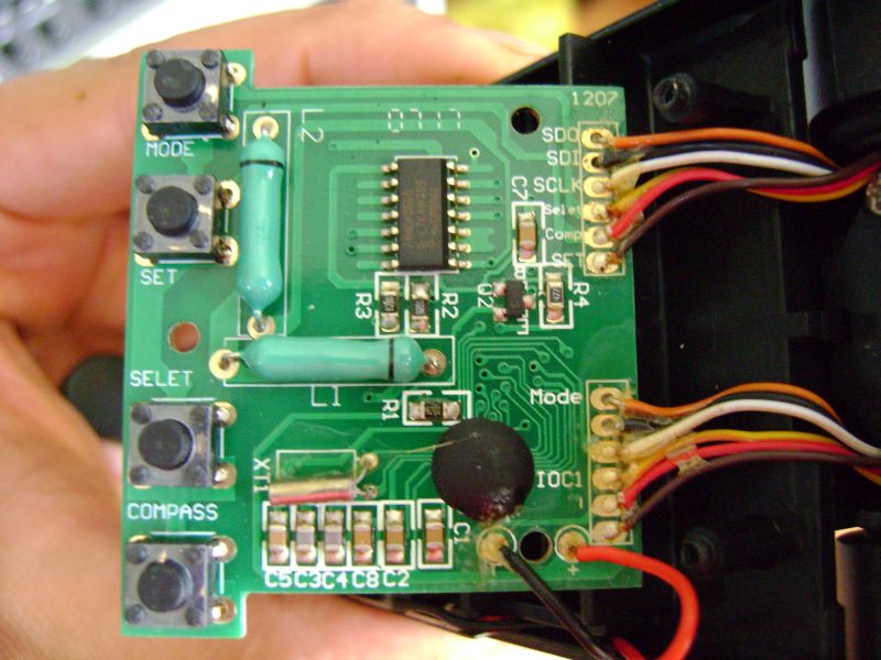

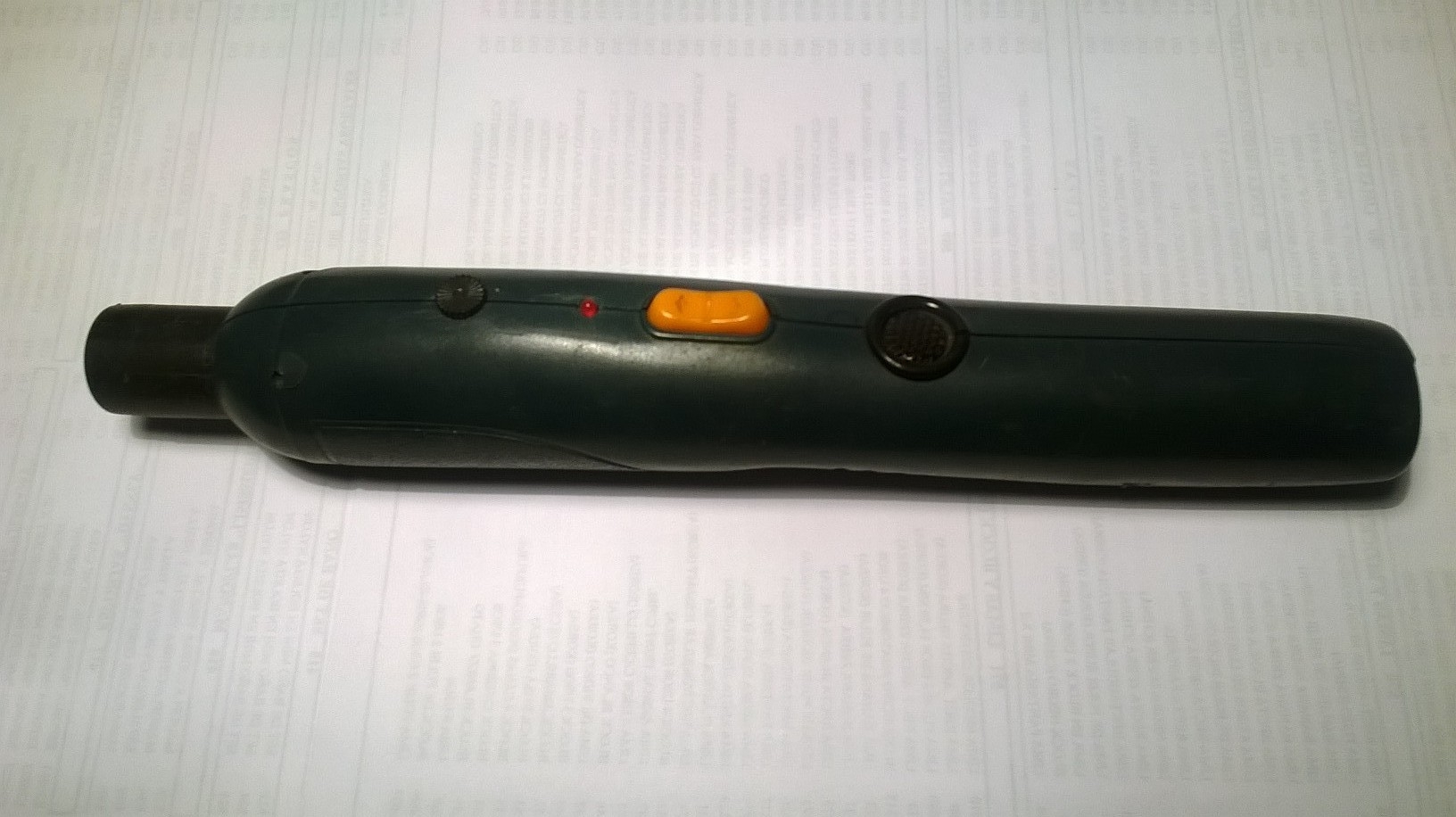

                              "Chinese" Nupi PP Click image for larger version
