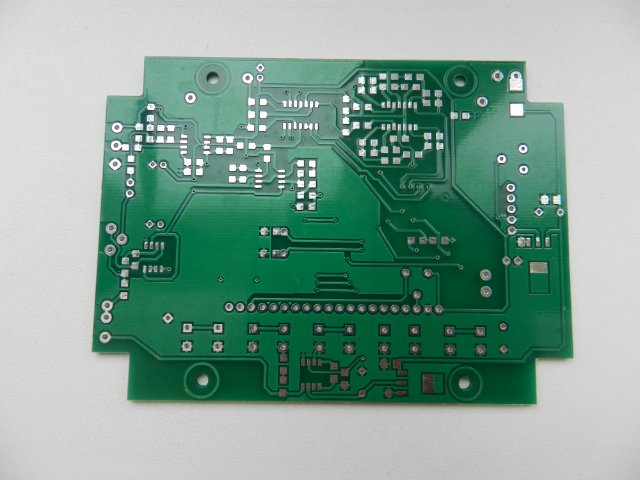

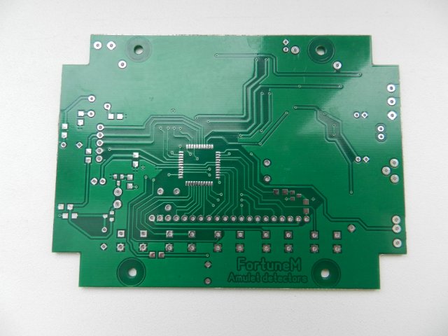

          PCB

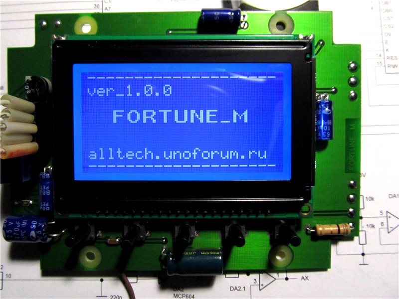

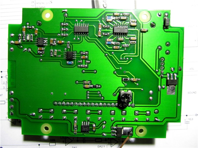

                  I built this project. It is well documented in russian (use google translatete). Firmware has some nice features to tune coils, TX coil is driven by DAC, firmware allows you to change freq and watch current in the coil. You can spot coil resonant frequency easily. I tested with Tesoro uMax coil which is not a good fit for FortuneM. The results were OK but not spectacular. I will need to build a proper coil for it to really test it well. Russian tests are on youtube. You will need PicKit2/3 to flash firmware. With the right coil it should be very nice discriminating MD. This project is being actively developed right now.
                  There is some tricky soldering required to build it.
                    asked the seller about the price - 7USD for bare board (his pics in post #5) and 4-5USD for shipping. he sends overseas.

                            FortuneM: with proper custom build DD 10.5 inch coil results are much better. 1C US copper detection: 8" - solid; 9" OK; 10" -weak; small gold wedding band: 12"; VID works well on even weak signals. For comparison: TGSL with 10x9 web tesoro coil has similar range, maybe a 1" shorter. All bench tests only.
